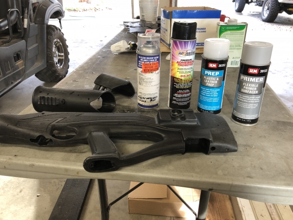

Stock parts all cleaned, de greased, sprayed with adhesion promoter, and primered. Going to let it sit 24 hours before prepping for the final paint.
