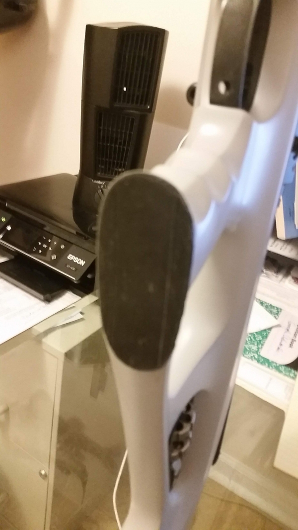

1540945607_18245526445bd8f6c7e20e44.02087045_647B6211-0750-400B-8A98-5F8BE31C47BC.jpeg

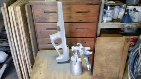

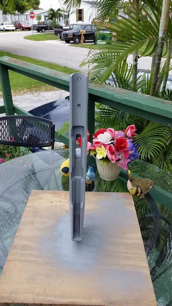

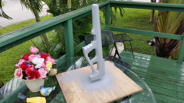

Oh, forgot to mention- after a wipe down with that ACRYLI-CLEAN, one final wipe with a tack cloth. Paint guy said to hang my parts first, then wipe down with tack cloth and don’t handle it anymore. Nothing touches the parts except the top coat.

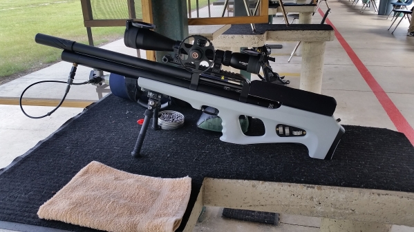

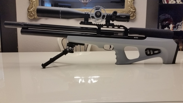

Yes that product will work fine to wipe down after sanding your primer. Normally after I sand primer I wash my hands thoroughly with Dawn and hot water, and wipe down the sanded pieces with the Denatured Alcohol because it leaves no residue and evaporates instantly. I am not comfortable wearing the Nitrile gloves so I am careful about what I touch when I am prepping a piece for paint. Eg. don't touch your face or nose and then your work piece because you will transfer oil onto it and the paint will "fisheye" and at that point you will want to kick a big dent in the garage door! :) I will show you some pics of painting my Wildcat stock...

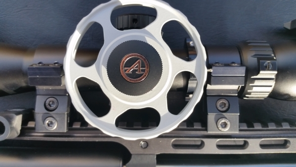

I even painted the side wheel for my scope to match my stock. It is a cheap Leapers side wheel that I made the hole in the center larger with my Dremel Tool.

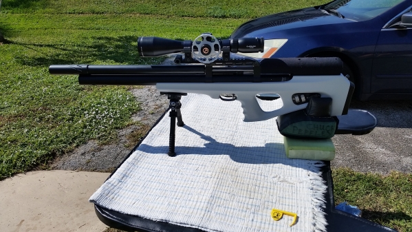

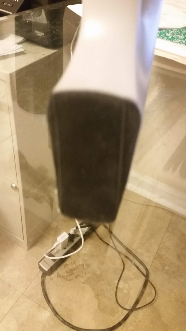

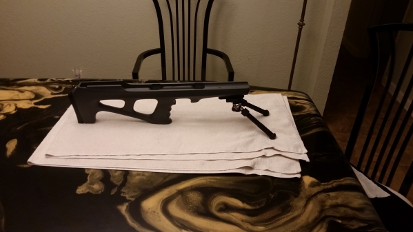

In these pictures you can see how my Wildcat sits down flush to the table on the pistol grip and rear of stock. To accomplish that I taped a couple long pieces of sandpaper to the glass top table and put the bipod feet on a piece of paper so they would slide back and forth. Then I sanded off about 3/8" from the bottom of the pistol grip and about and inch or more from the bottom of the rear of the stock and hard rubber pad. Last I used Spray 77 to glue a piece of bicycle inner tube to the bottom of the pistol grip and stock butt so they would be non slip. Now she sits with four points touching and the grip and stock butt are flush so she is no longer "tippy" and I don't have to worry about her falling over at the slightest bump of the shooting table.

Looks great so far...now touch the wire hanger or masking tape with your finger tip...if the paint is good and tacky like glue then go ahead and spray a good solid wet coat. The first one will prevent the second one from running because it will grab it and not let it run. This first tack coat and second wet coat will dry and cure in together. Leave it alone for a couple days to completely cure, and if you think it needs another coat then give it one...otherwise call it done!! :)
... and if you decide to mask around the details on your stock and paint them a contrast color wait about a week to do so. And make sure you use the right masking tape...Home Depot has the yellow Frog Tape especially for freshly painted areas...so use it or something like it and do a test spot to make sure it won't pull off your paint when you remove it!

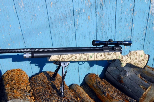

And you can make 'em look like a million bucks!!! I do suggest a good clear coat. All my guns/parts etc. are RATTLE CAN paint jobs but clear coat keeps the scratches hidden as when it does get scratched or dinged you can sand it out as long as the damage did not penetrate all the way through the clear coat with a little buffing usually. Great clear coat paint can be had at any hardware store and it comes in GLOSSY, SEMI GLOSSY, or a Matte or satin finish. Think of it as sunscreen for your paint. The added advantage is that your trigger finger is getting strength training while pushing the little button on top of the can which will make you shoot perfect groups when finished LOL.
