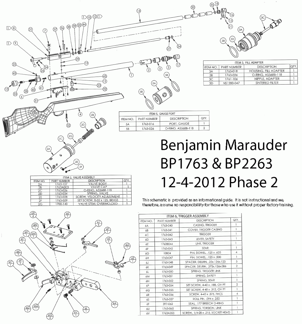

Your poppet seal is more than likely the culprit. Probably cracked or a chunk busted off. Really easy to replace and the part itself is cheap thru Crosman. Your owners manual should have a parts diagram with the part number. It should say valve poppet/valve stem.

Here is the parts diagram for a gen1, just to show you the poppet and it’s location.

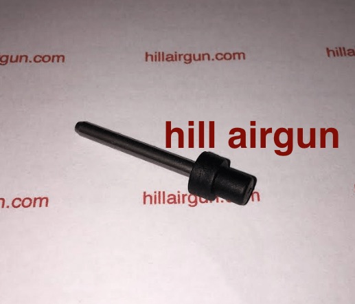

Part number 2G. If that overmolded part is damaged, it will let the high pressure air into your barrel and out. Order these from Crosman or hillairguns.com. They’re only a few dollars, and you should buy a couple for spares.

https://hillairgun.com/product/overmolded-valve-stem/
i re read your leak symptoms. I am 100% positive it is this part that failed, unless your valve is cracked which I highly doubt. My Marauder pistol did the same leak, and the overmold seal at the end of the stem was deformed, causing air out the barrel.
