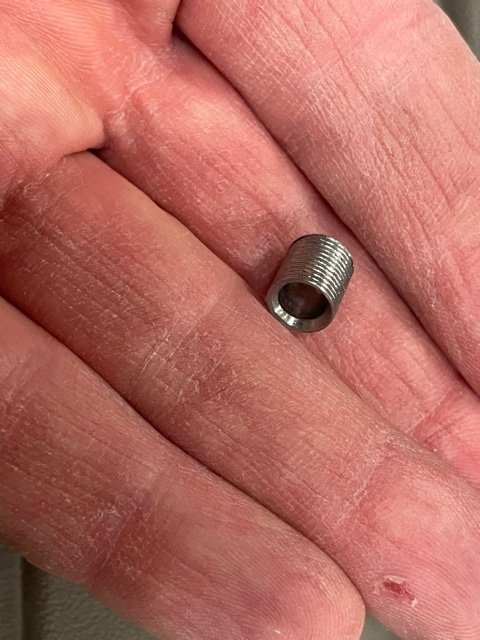

I made these inserts for the fore end screws on my TX200, no more loose screws.
