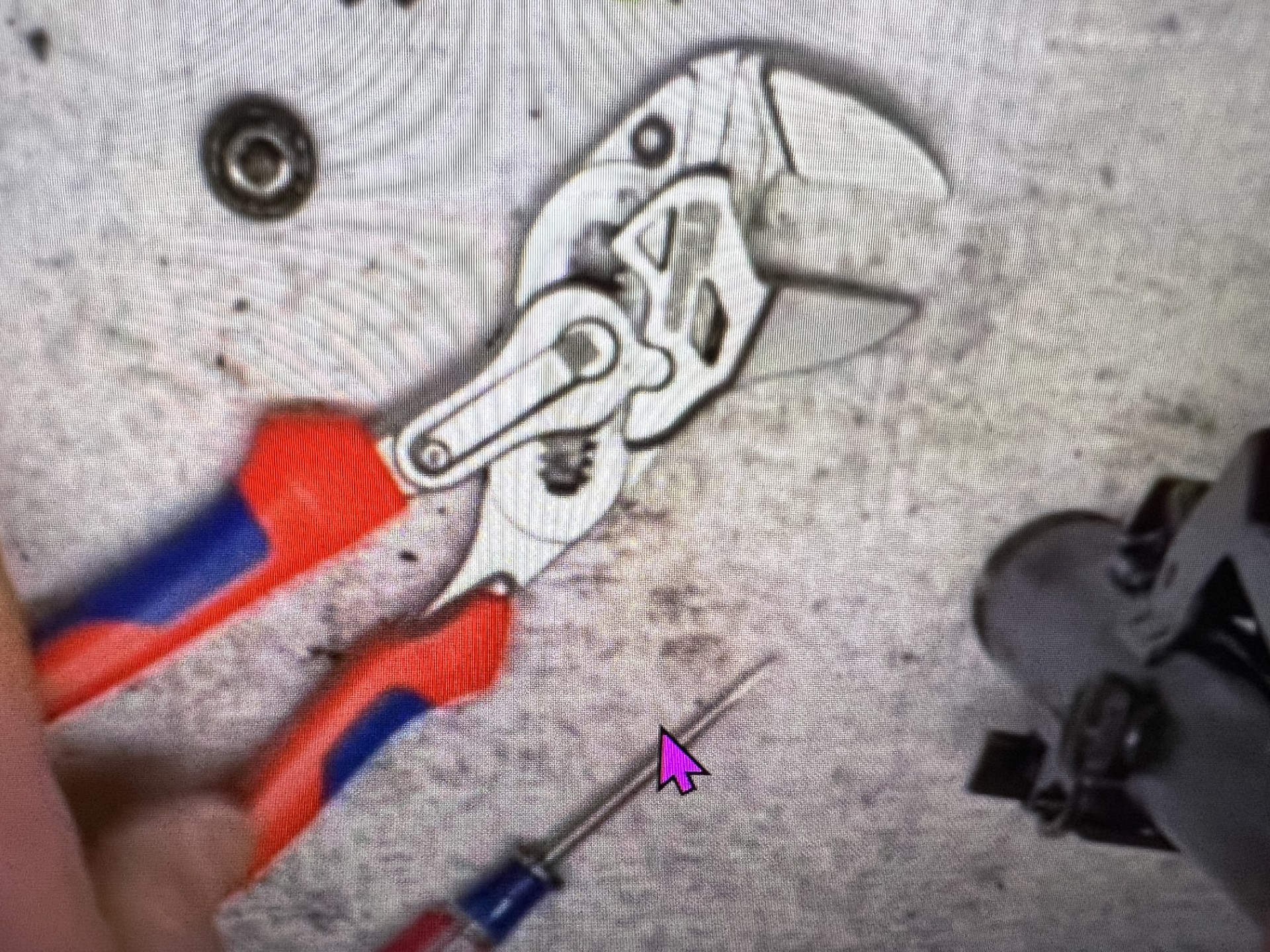

i started watching the first video that popped up just to see what would come up and it was walnut and steel and than turned it off soon after
the guy was using channel lock pliers on the side gear caps what bloody nonsense
I believe he was using smooth jaw Knipex pliers like these. What would you use?
