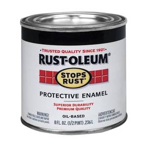

This is what I use. It comes in three sheens. I think you need satin. Mix flat with semi. Cures pretty fast for oil base.
Spray it and it lays out glassy. Rattle cans are junk IMO. Can be really nice when brushed but I am a pro with a brush. I have all 3 sheens in 8 oz cans.

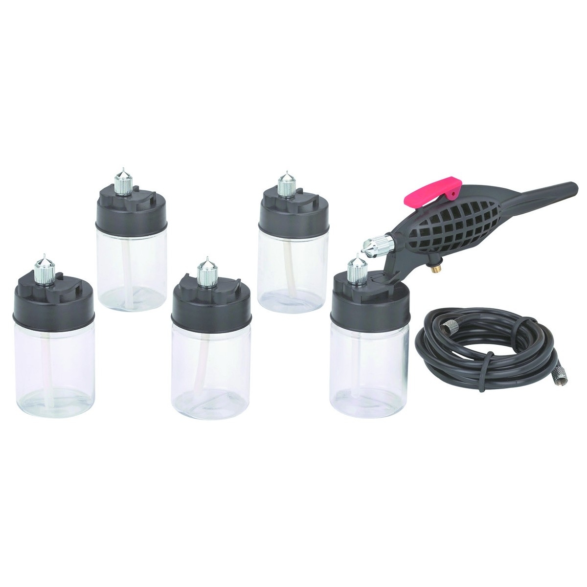

For overall painting I use the cheap little Harbor Freight gun. Blows away any rattle can job. You have to thin the paint some and adjust air pressure accordingly. The whole kit is so cheap you don't even have to clean up the jars. After 5 jobs throw it away and buy another set.
I upgraded the crappy plastic hose for their cloth covered airbrush hose. Worth it.
