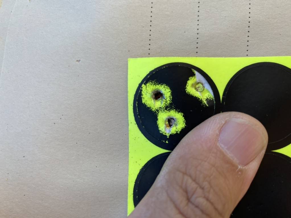

this my crown with 500mm barrel shooting nsa 12.5 grain slugs at 950 fps at 100 yards, I know it’s only a 3 shot group but it’s 0.56 inch c2c.

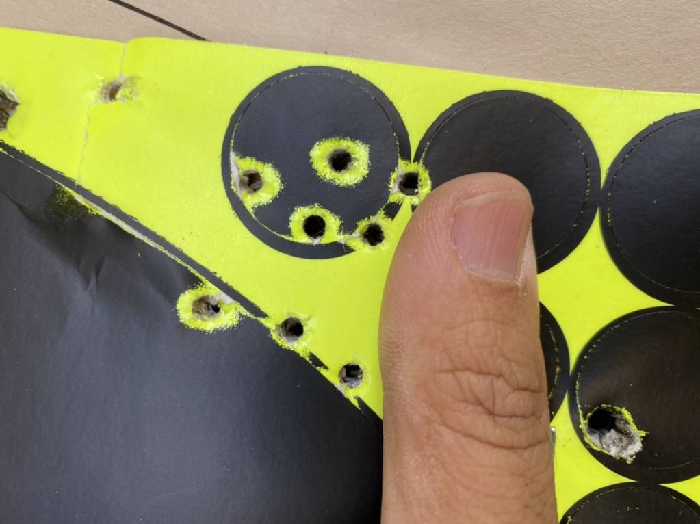

8 shot group at 100 yards, wind switched on me for 3 of the shots, 5 shots clustered at 0.6 inch and 8 shots are a touch over an inch. So yes, STX liners can shoot 177 slugs well but slugs are VERY finicky with the tune.
Once FX comes out with heavy liner with 1:12 twist rate and less choke then it will be a game changer when it comes to slugs because it will be far easier to tune.
