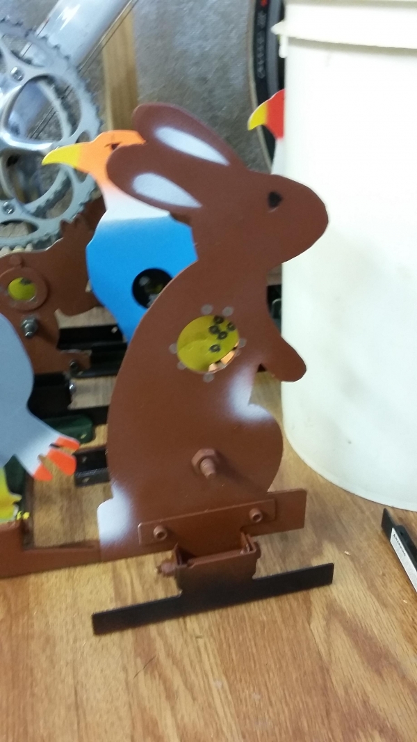

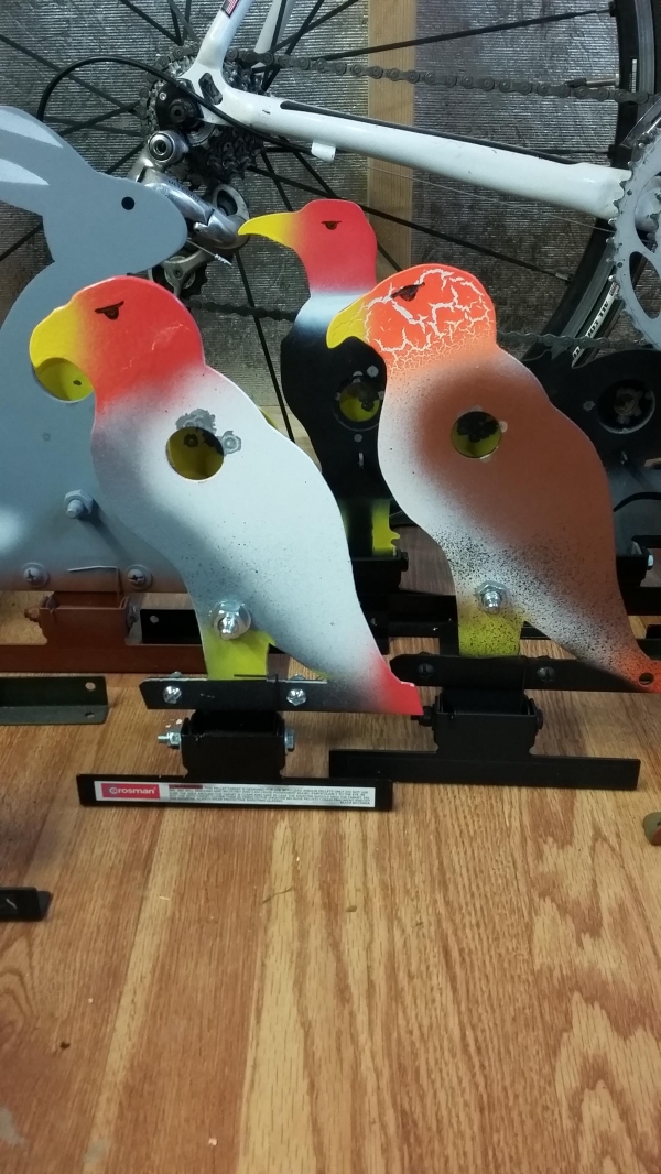

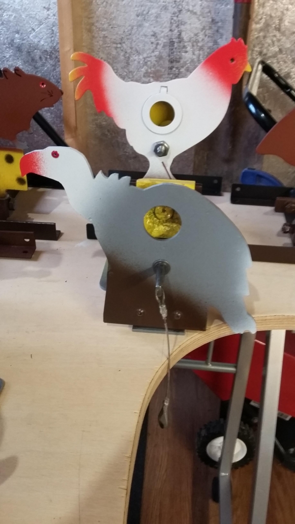

Great video and good info for those interested in buying some field targets for practice or competition. I have been purchasing targets for our range and my backyard for the last 2 years and around this time of year some of the online airgun suppliers have great sales. Last year I bought 20 of the Crosman zombie targets for 14.00 each and replaced the faceplates with ones I had made

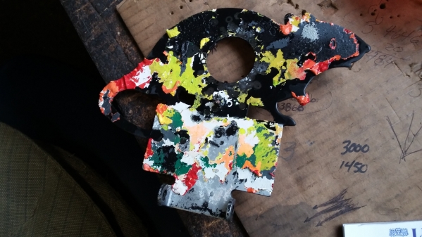

They spacing between reset bolt and kill zone is the only difference these targets and the Gamo squirrel. The Air Venturi Rat on the run is actually an old Gamo target that somehow Air Venturi has the rights to. I have 3 or 4 of the older version and they face the opposite way.

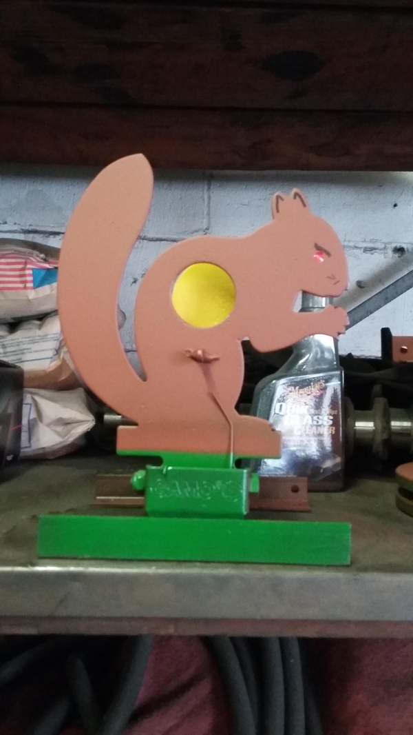

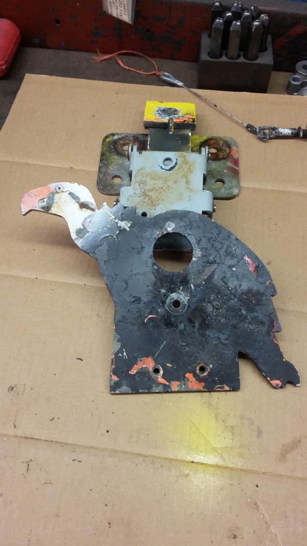

I found this one out on our field course and it has Gamo stamped on it. You can see how many different ways it was painted over the years. I love finding these targets (I have found about 15 so far in the woods on our old field target course ) and bringing them back to life.

As far as the durability of the Gamo targets our club has Gamo targets that are 20 years old and have been shot thousands of times and will continue to be shot for years to come. The Knockover brand targets are only available now directly from Knockover and with shipping they will cost about 47-50 dollars each. Our club has about 20 old ones from the late 80's and early 90's

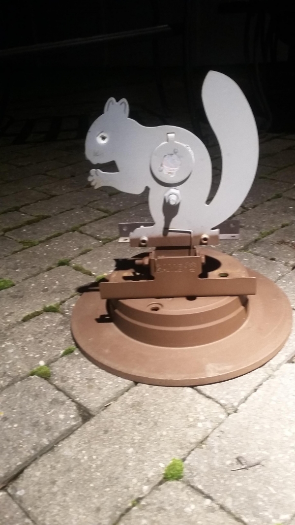

I mount them to old brake rotors that you can get for free from most auto repair shops, they usually have plenty laying around outside waiting for the scrap man to come get. Right now scrap prices are so low the shops can't get anything for them so they give them away. One 5/16 nut and bolt will hold the target to the rotor and even small rotors are heavy enough to hold them in place but light enough anyone can pick them up.

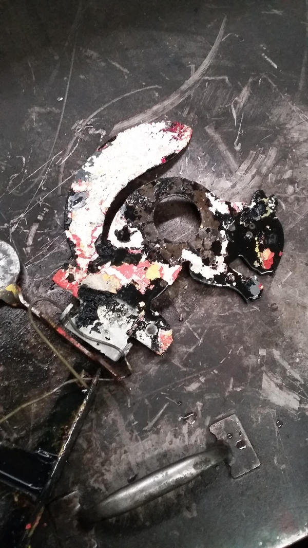

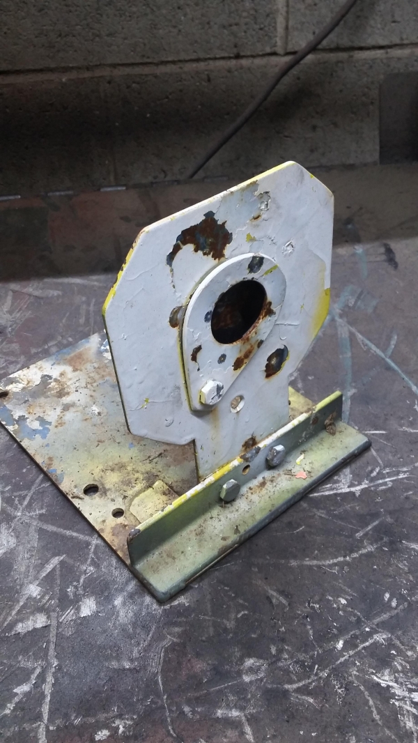

Thank you. I actually find it fun. When field target started alot of the targets were home made. I have found a few of these down in the woods also
These targets are the early history of field target

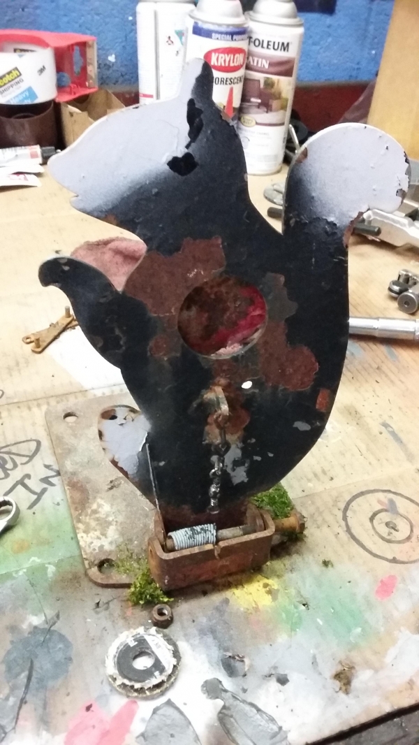

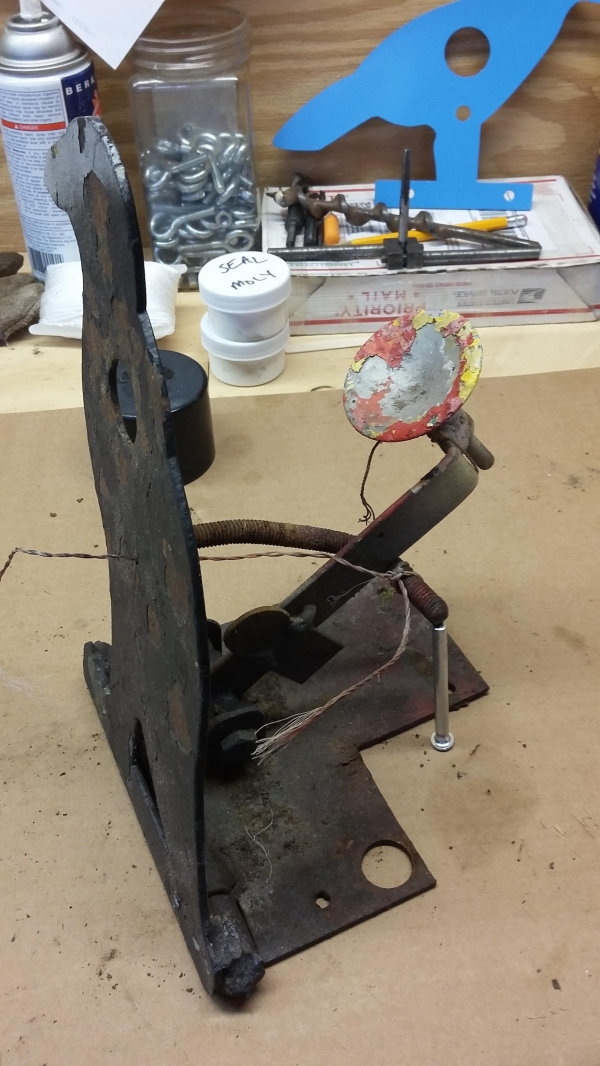

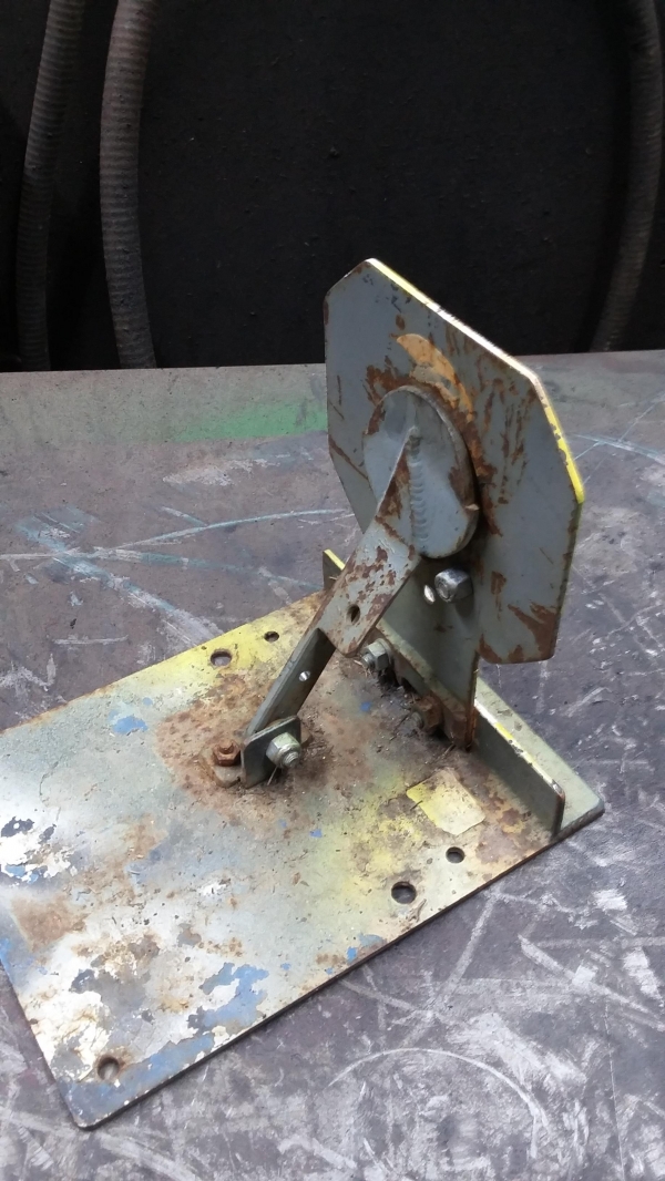

This one is made from old automotive parts. I know cause I made about 15 of these back in 1994. I found this one out on an old section of our field course that we don't use anymore.

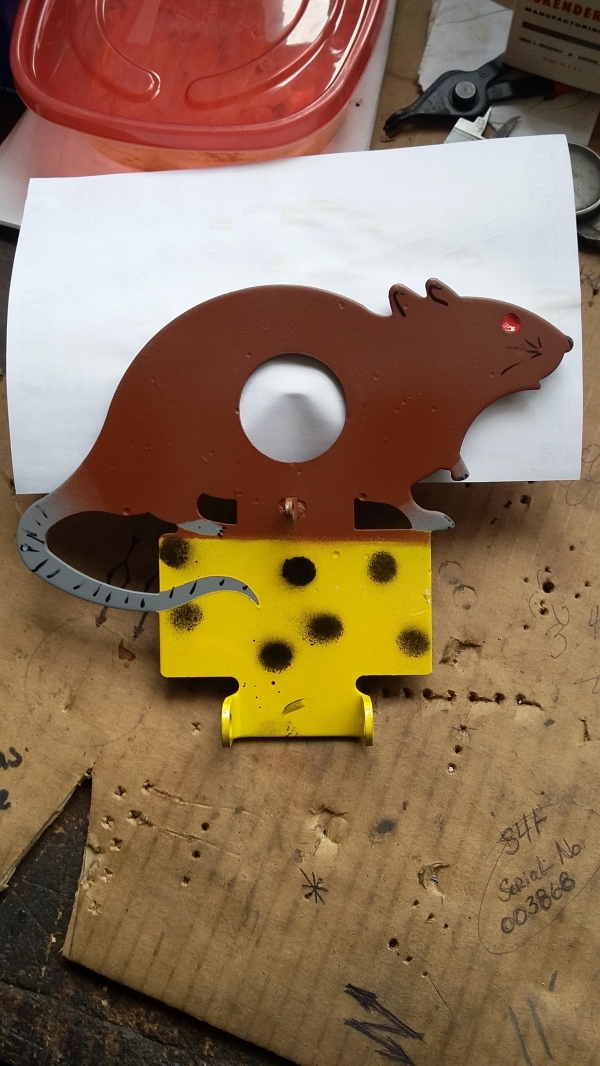

This is the one old target after an acid bath and a trip through the glass beads cabinet. Ready for primer and paint.
