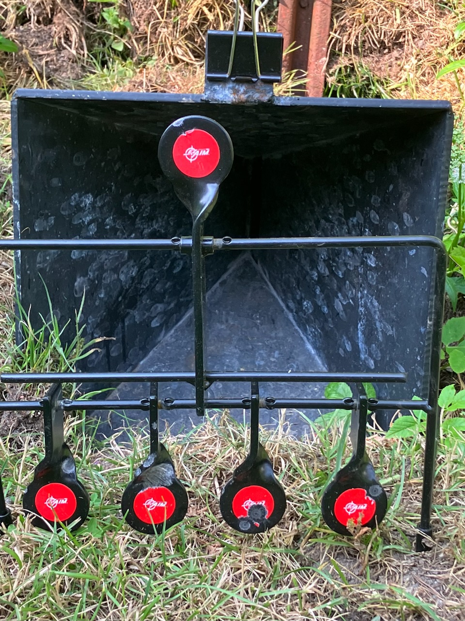

I recently purchased a spinner type target with four discs that flip up when shot and can be knocked down by hitting a separate disc. It was designed for rimfire, so the discs are reasonably heavy / thick and seems like it will hold up to abuse.
I know this is a problem that I can solve, but I figure somebody else might have already come up with a quick solution.
My problem is the spinners don’t stay up once they are hit. They either bounce off the stop bar and return to position, or if I do get one to flip up and stay up, it usually falls down when I hit the next spinner.
The trap has supports that can work at different angles - I have tried tilting the whole apparatus towards the shooting position so the the spinners would be more horizontal when flipped over and less likely to tip back when the next spinner is hit. This made it possible to get one disc to stay, but it always gets knocked down with the next hit.
I am shooting some pretty high-powered Air Force guns at or a bit below .22 LR energy levels at about 30 yds. I could always try a lower powered gun, but I shouldn’t need to I would assume.
if I can’t get them to stay by adjusting the angle, I was figuring maybe something to add a little friction where each disk connects to the axle so everything doesn’t jiggle around so much when I get a good hit.
or maybe I just got a poorly designed target on some level…
Any tips on how to quickly get this to work?

Seems like you need the rimfire version to shoot at THAT power, THAT close. The airgun version is more intended for springer power levels at closer ranges.Not sure how you could create resistance that would help and you will likely bend the spinners with hp airguns. The rimfire versions are heavier with longer stems and they have worked for us, even at 100 yds w as low as 40 ft lb. Not sure about lower energy than that as we don't use those at 100 yds much.

This is a rimfire version… at least it said so on the box. The plates haven’t bent even after multiple 130+ FPE hits

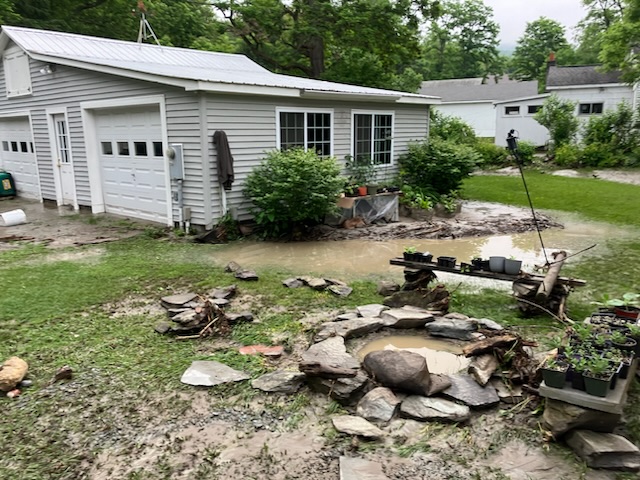

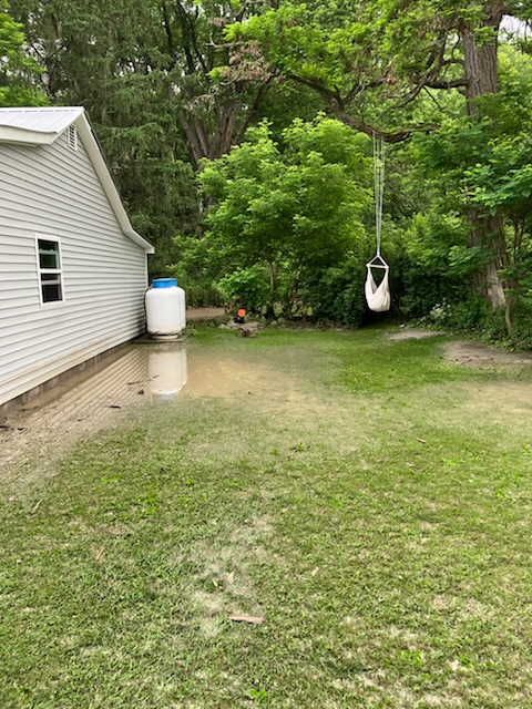

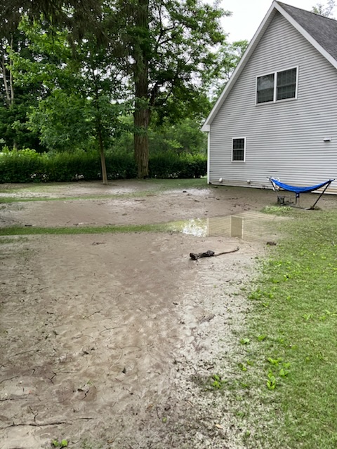

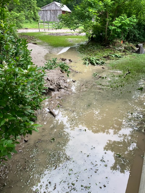

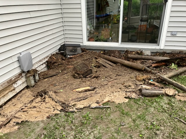

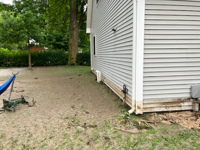

I’d be out there trying again but my yard got covered by a mudflow from a freak beaver dam break up in the hills… just came out of nowhere. I woke up in the morning and there it was it was like a two hour pulse of water in the middle of the night I slept through it. You can see my target and berm in the photo with the propane tanks. I’m just lucky nothing besides the landscaping got swept away. It’s a new house and I spent the last three months working on the yard so I’m pissed. Back to the drawing board. My yard had now a 3” layer of beaver poop and pond bottom muck judging by the smell. it is stony soil with clay and little humus, so maybe I am thankful for the free compost delivery.

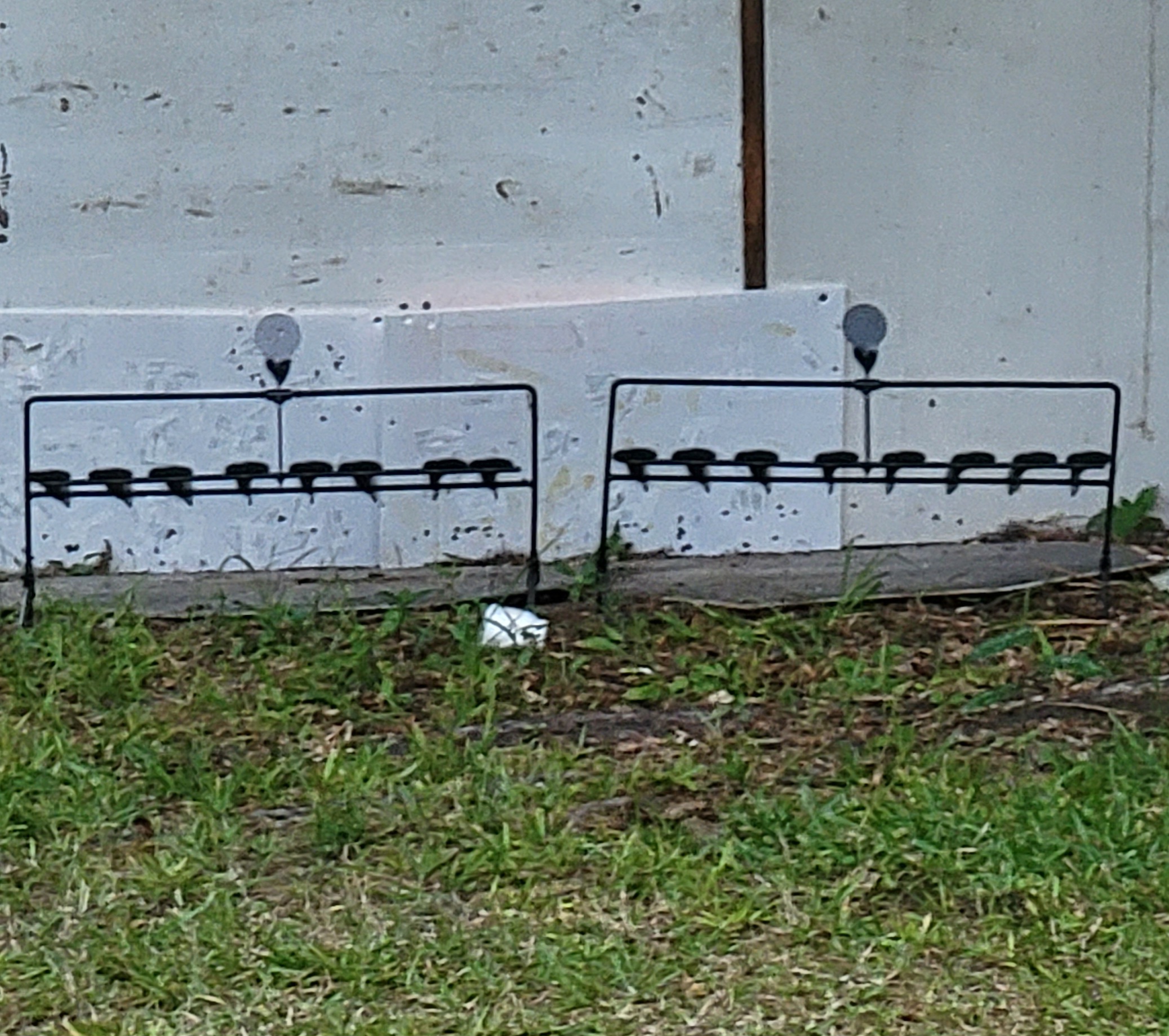

Interesting that this popped up, because I'm going through it too. My problem is four times worse! Lol I have 2 Crazy Eights.
My solution so far has been two fold. One was discovering the right power for for the hanging disks, and two was using a firing order. Those answers turned out to be my .177 Beeman Webly Vulcan, shooting from the middle to the out side.
Now, I have ti discover the proper power to release them. I've shot the release disk about ten times with different guns and only reset one hanger.
