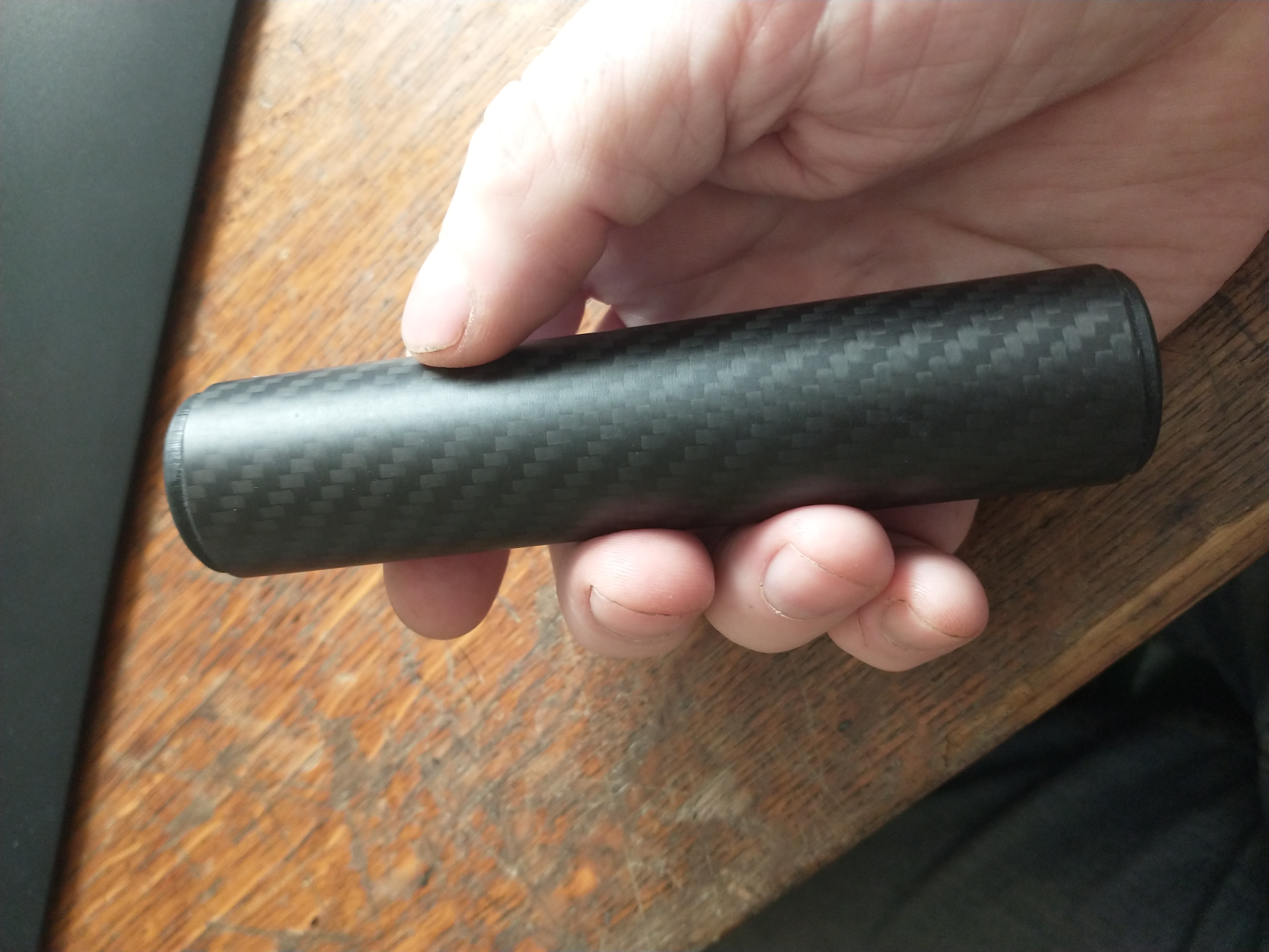

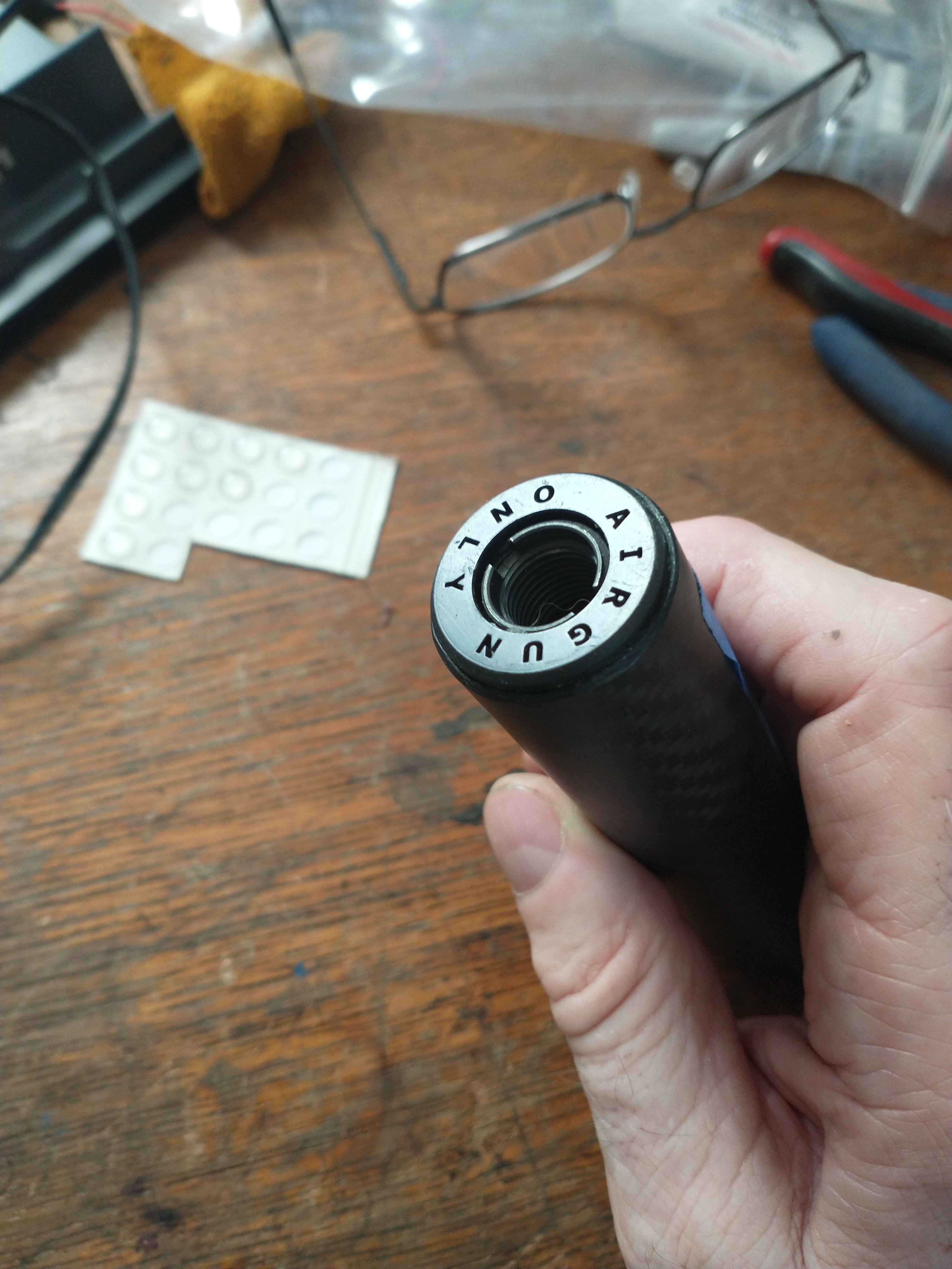

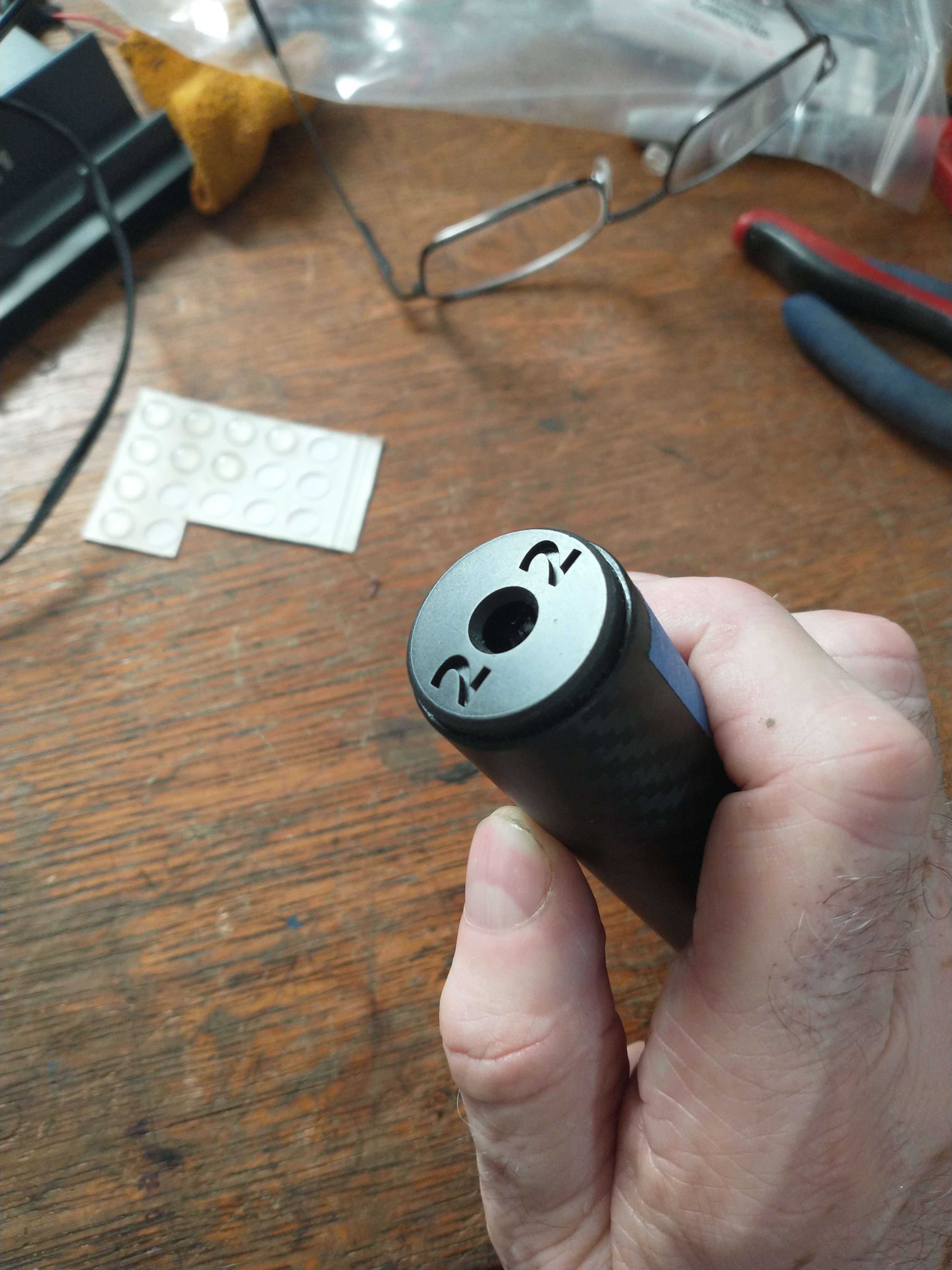

@bigHUN Want to say you were right about using a resin printer. I really like the one I just got. Still learning but I can put three of these on the bed at one time and print them in 3hrs. Just blisteing fast compared to FDM. Very little post processing. I could push six or eight of these out the door in an 8 hour shift, no problem. If I went for a one piece model I could do significantly more per day.

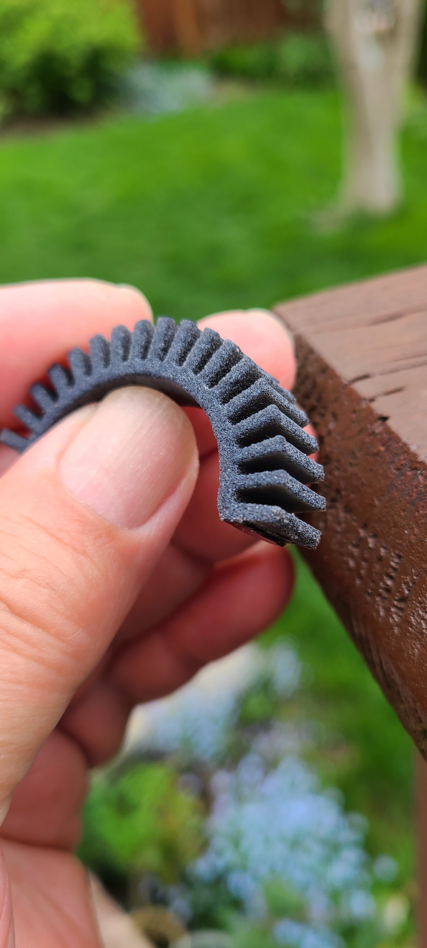

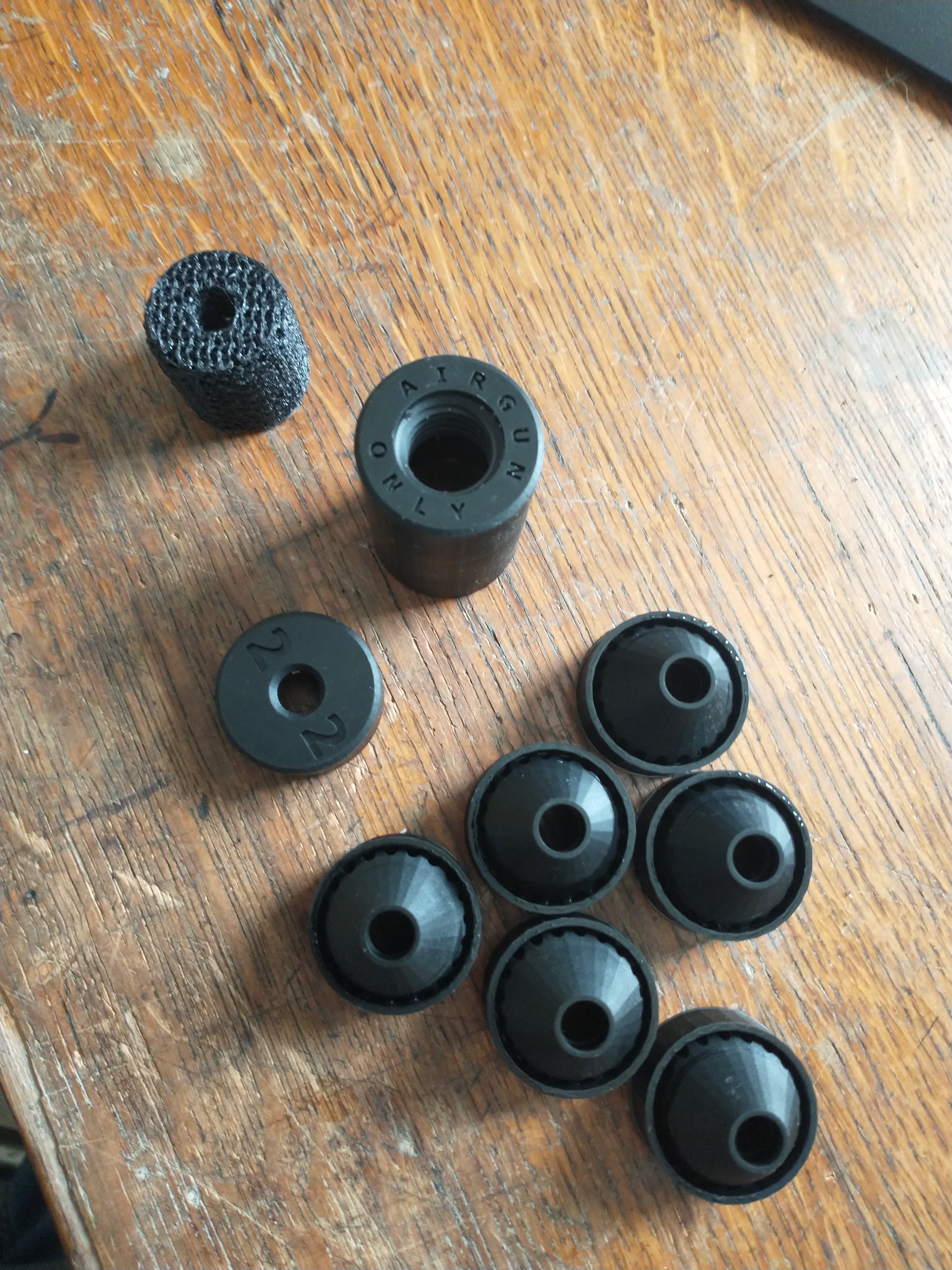

Now that I am getting some reliability with the resin printer, I am going to increase the resolution of the models. That will improve laminar flow over the tesla baffles. I'm getting six tesla baffles in 128mm with an air stripper as the first "baffle". This specific model is quite nice and the testers are pleased with both the accuracy and the suppression.
The text on the ends is beautiful!
I am finally ready to go into production but I'm selling off the test models first. They were all printed on the FDM printers and aren't that hard to look at either. I'm keeping the price on them down so that people who are price sensitive can get a good moderator. This specific model will probably sell around $55.00 shipped. I have not calculated the cost of materials yet.

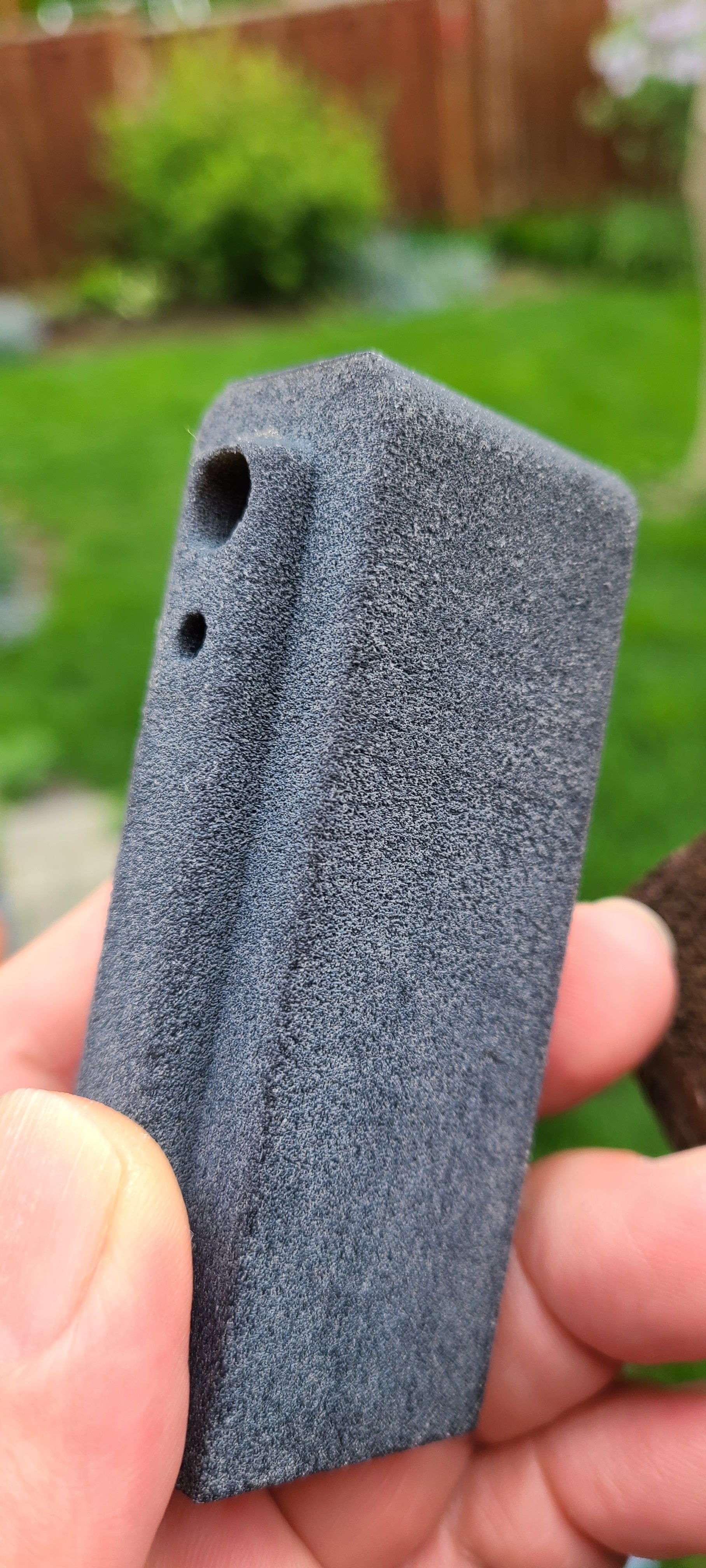

And I forgot to say, that part which looks like a sponge in OP ... yes, you can print from resin as well if you have a model for it.
If your model is full solid there is still a chance. Pre-process it in UVTools, the function is called ... cannot remember now not with my PC... something like corosion effects, removes the pixels from the surface or random pixels from entire body. That is some sub-sub menu button.
I have tried it ones some random settings, it looks like these, but need to play with numbers to remove more pixels:
