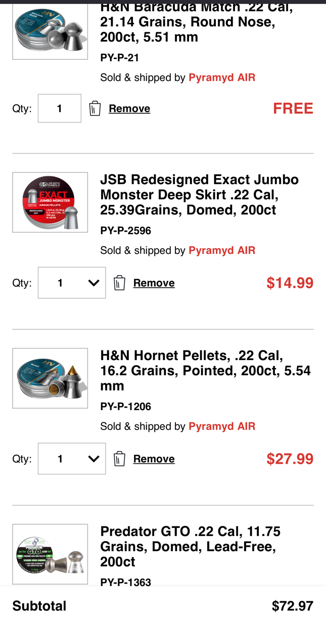

Screen shot attached. Thanks in advance for looking :)
I wanted to grab a variety of grains. the super light "Predator" will be used for long distance plinking and just messing around. The others are a variety of grains I intend to use for small/medium game. I know a .25 would have been better than a .22 for this, but if I can get myself a turkey this year then that would be really cool; that's what the heaviest grain in my list is for. My main goal here is to have something that could dispatch a turkey using a .22.
For the turkey hunting, I can't imagine I'd be more than like 8-10 meters out max. For the long range plinking, that's just going to be for shooting at inanimate targets for fun, basically just to see how far I can push the rifle.
Thoughts?
I'm trying to stick to Pyramyd because I am in the US and also their "buy four" deal.
Edit: I also forgot to mention that this specific Maurador will be the "Regulated" model with the "Lothar Walther" barrel.

*I'd skip all of them go with JTS Domed in 16, 18 & 22 grainers. I'd double up on the 18 grainer to get you to four.

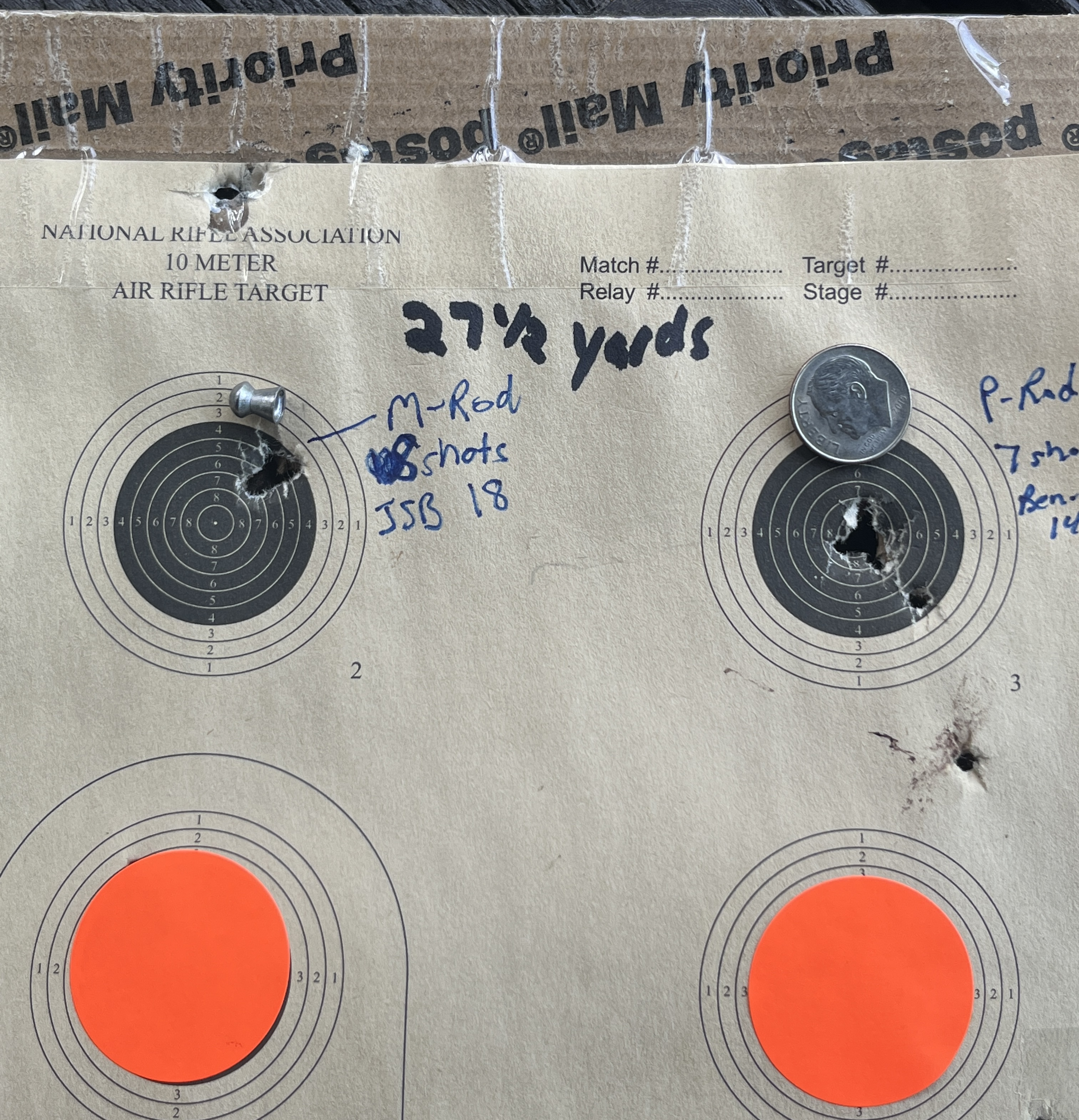

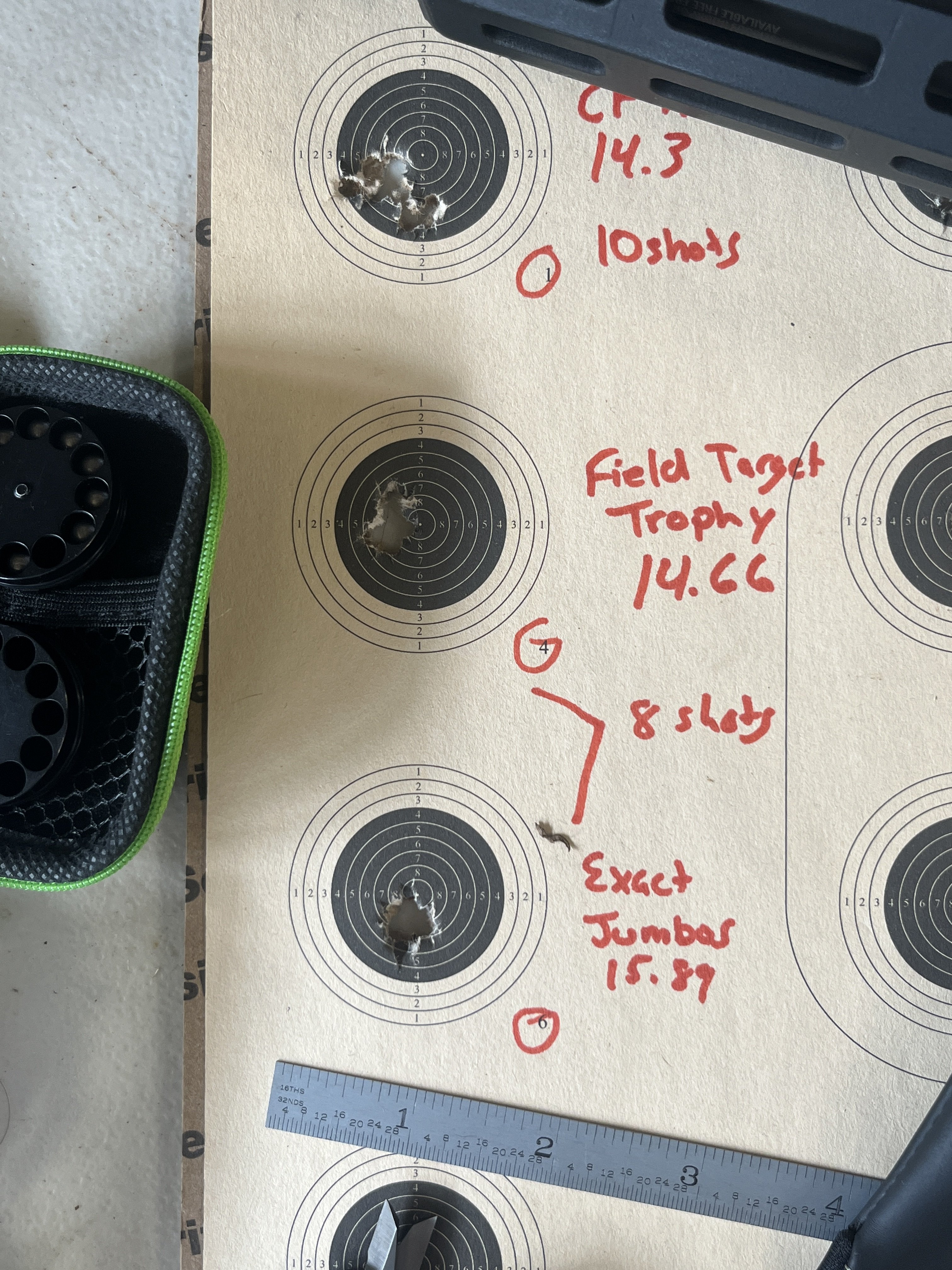

My latest results in 25 & 22 caliber show JTS & AEA more accurate and much more consistent (less flyers) than what WAS my old standard JSB. Very very few imperfections with the JTS & AEA pellets.
As you've probably already noticed==> the 'Free' tin of pellets are the cheapest ones in your cart.
I'd skip the 25 grainers as again "depending on the tune" of your Marauder I don't believe it will have enough velocity to make this a worthwhile choice.
I'd avoid the Hornets for now, too expensive, maybe later you can pick some up to play with.
I'd also avoid any 'lead free' pellets unless you are required to hunt with them in your locale.

My M-Rod .25s, all highly modded, these shoot in the 44 to 60 fpe range:
