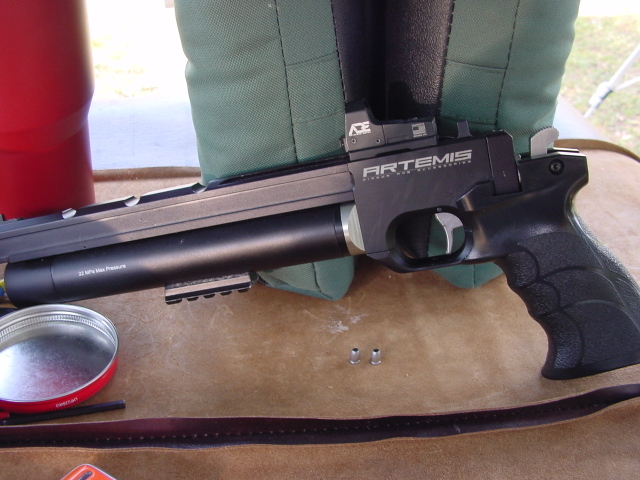

Always loved hand gunning, but didn't have a pcp air pistol. This seemed a good way to enter the type.
I have been amazed with the accuracy of this offering.. First thing I notices when it arrived from wes Bob, was the barrel looked to be lapped and polished in the bore.
Here is how it is shooting.
Equipped with an ADE 3.5 holo dot sight,
5shots with cast pellets from the NOE .22 pellet mold.With tow more shots with Crosman 14.3 pellets for comparison
. at 20 yards.

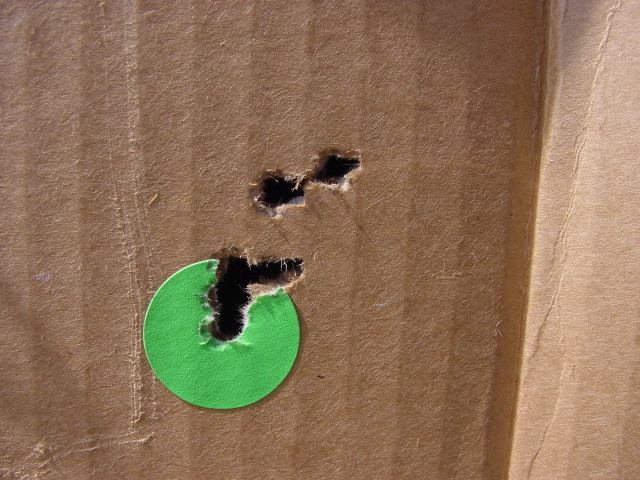

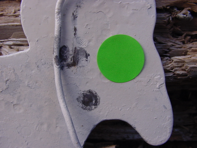

3 shots at 80 yards with the NOE modded bullet. Two touching and one 1/2 low. Green dot is 3/4" and not present for the shooting. here for size only. Of note, is the scope has no magnification, and covers the target. I was floating the red (green) dot in the air above the target.

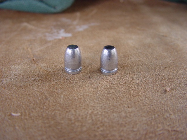

Shot with 29.2 NOE .2165 bullet I cast
from a NOE mold that I customized.

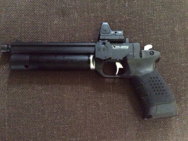

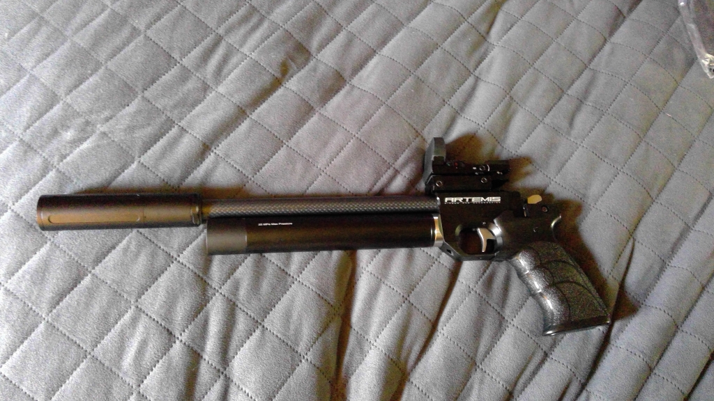

I'm still on the fence over mine, it doesn't like being a .22, very hard to insert a pellet in the breech... Mine shoots pretty well with the .177 barrel but doesn't like a LDC on either barrel... Without it my PP700S-A shoots pretty well, 1/2" groups at 10 meters... No modifications except having the transfer port opened up, it's shooting at 680-690 FPS... Need to tune it down some... I just got it, need to find the pellets it prefers... Seems the barrel shroud is an awful lot of weight hanging on the end of what otherwise would be a free floated barrel... I'm going to fabricate a carbon fiber shroud today for it and also do some shooting without any shroud to see how it groups...
Just my .02 Ken

I think my Artemis PP700S-A is a great pistol, well made, shoots pretty well straight out of the box, I think it's cranked up too high, need to adjust it down quite a bit and really sit down and shoot it a bunch at different settings... I have more experience with PBs and free floating a barrel was one way to accurizing a high power rifle, that and glass bedding the action... I will have to experiment with different tensions on the "nut" securing the shroud... I have a CF shroud I made yesterday, the pistol has quite a bark even with the LDC on it...
Edit: turned down the hammer spring tension, much quieter now, waiting for GF to bring chronograph over to check velocity and possibly adjust some more... Will shoot a few strings and follow up...
Ken
this is one gun that it is easy to check barrel alignment and ldc on. Cock, open port, point at bright back ground and sight down the bore. Any dark area showing is a clipping possibility. and easy to correct once found.

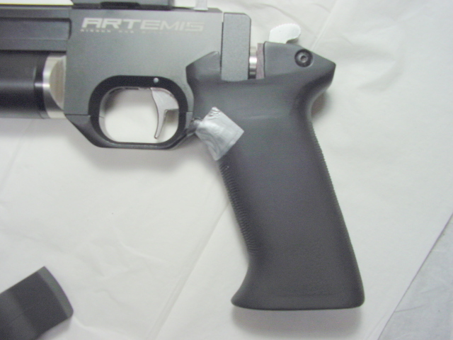

I have made a few more changes to the pistol. I am a 1911 shooter, and fund the angle of the grip far too angled for my shooting style. I don't like the broken wrist hold so popular in European guns.
I removed the palm swells, finger groves. (which only fit some people well.), changed the interior angles, removed much of the under trigger guard material on both the pistol grips and trigger guard. And removed the arched back strap area to a straight strap more in line with my 1911 .45's. There was an area in the center of the back strap that did not checker well as it was very flexible as it was almost sanded thru. Later backed with JB Steel Putty, it quite solid. I will re-cut the checkering finally it was bead blasted.
I may spray it with truck bed liner as after bead blasting it is still too slick. Possibly I will stipple it. We'll see. ;<)
Before the mods, the green dot of the Holo sight was way up in the air at first presenting the ag. Now it falls exactly in line whit where the sights would be if not blocked by the Holo sight. this make the pistol much quicker on target.

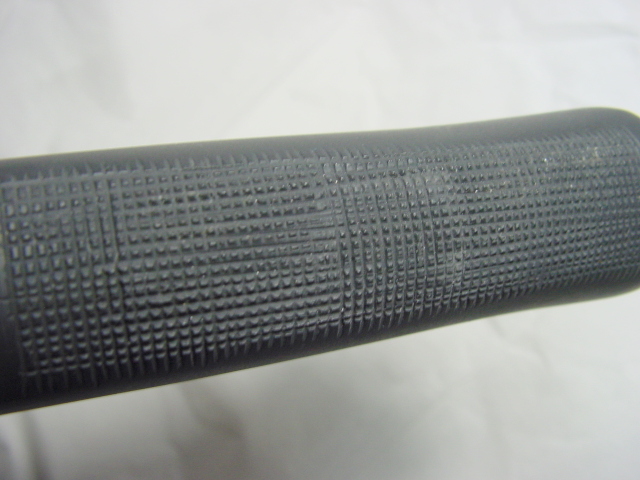

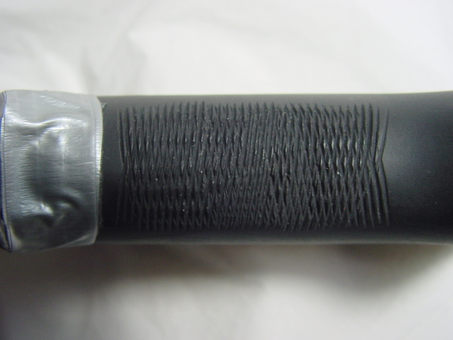

the grip has been checkered both on the front strap and rear straps. As you can see, I'm not there yet wit my checkering I will get better eventually.
The tape is there to give the JB Epoxie a wall to adhere to while it cures. Under neath is glad wrap to keep it from sticking to the grip frame.
