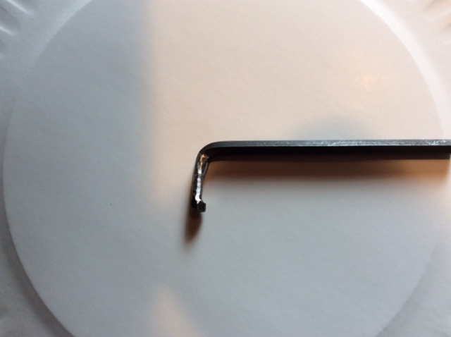

On the PP700 you adjust the reg or semi consistent valve through the front of the trigger guard. I no longer use the stock reg but when I was trying, I had to mod a hex wrench to make adjustments easier. Very tiny movements make changes. Just like a Huma.

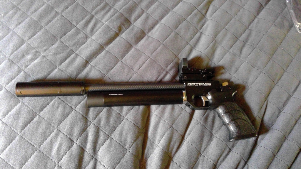

I think my Artemis PP700S-A is a great pistol, well made, shoots pretty well straight out of the box, I think it's cranked up too high, need to adjust it down quite a bit and really sit down and shoot it a bunch at different settings... I have more experience with PBs and free floating a barrel was one way to accurizing a high power rifle, that and glass bedding the action... I will have to experiment with different tensions on the "nut" securing the shroud... I have a CF shroud I made yesterday, the pistol has quite a bark even with the LDC on it...
Edit: turned down the hammer spring tension, much quieter now, waiting for GF to bring chronograph over to check velocity and possibly adjust some more... Will shoot a few strings and follow up...

Be careful with the tension nut. When JSAR was first making the aftermarket system for attaching ldc's, they found that just a little too much torque will separate the threads from the barrel. VERY Thin there. GRRRRR!!!
