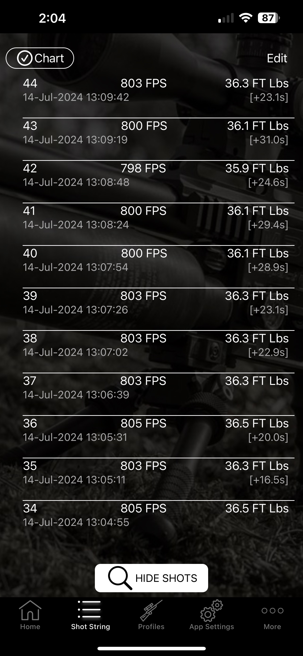

Results with Brocock/Brk Commander XR (not Magnum) in .22
Of 25.39g pellets, JTS was marginally more accurate than JSB. The JTS were cleaner and no damaged skirts. My choice was JTS which had a FPE of apprx 36 ft lbs at 803 fps as you can see from chrono image. Very accurate (both of them at 30m and 50m) although JTS accuracy was a little tighter/better.

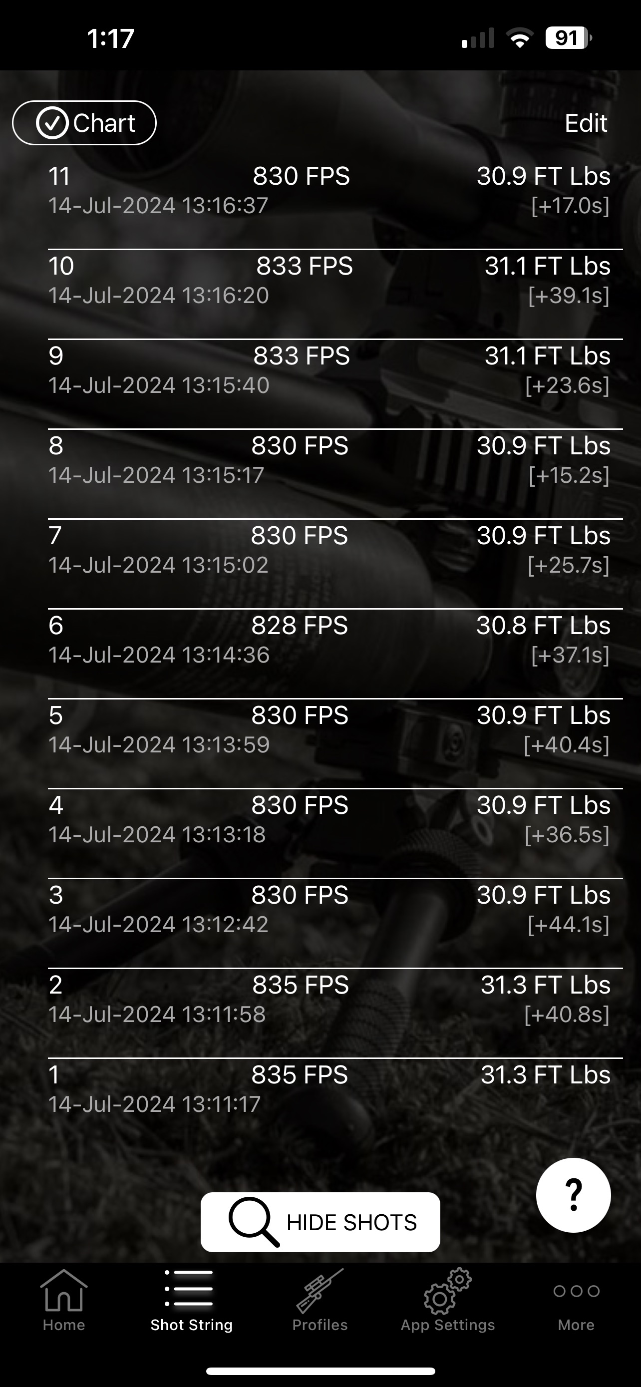

I then tested NSA slugs .217 20.2 at 830 fps and 31 ft/lbs. Interesting... had identical POI as the JSB and JTS 25.39g pellets, but the slugs produced less energy. These slugs were extremely accurate at 30m and 50m.
On the images, 803 speed is for 25.39 JTS pellets and 830 fps was on NSA 20.2g .217 slugs
