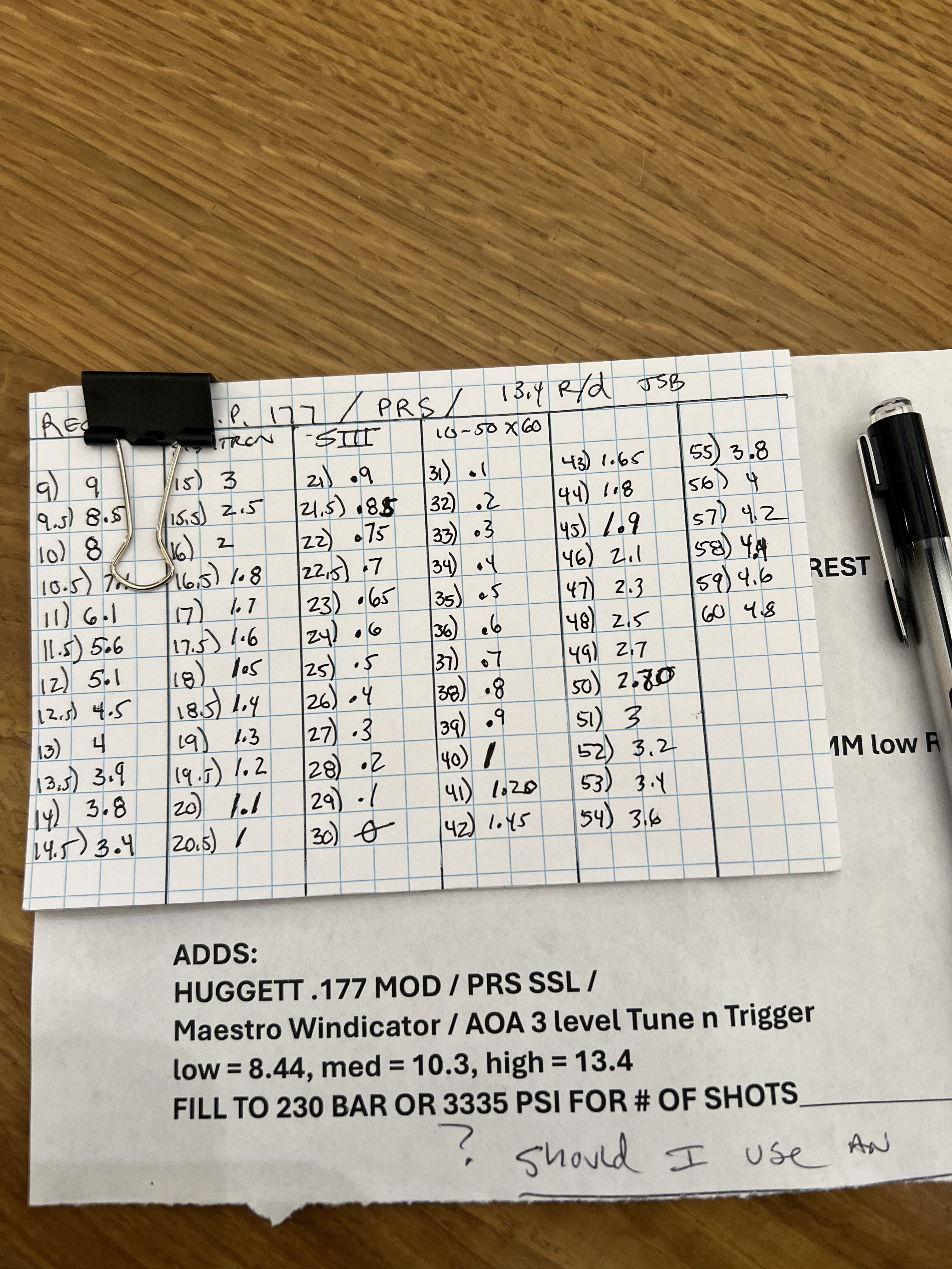

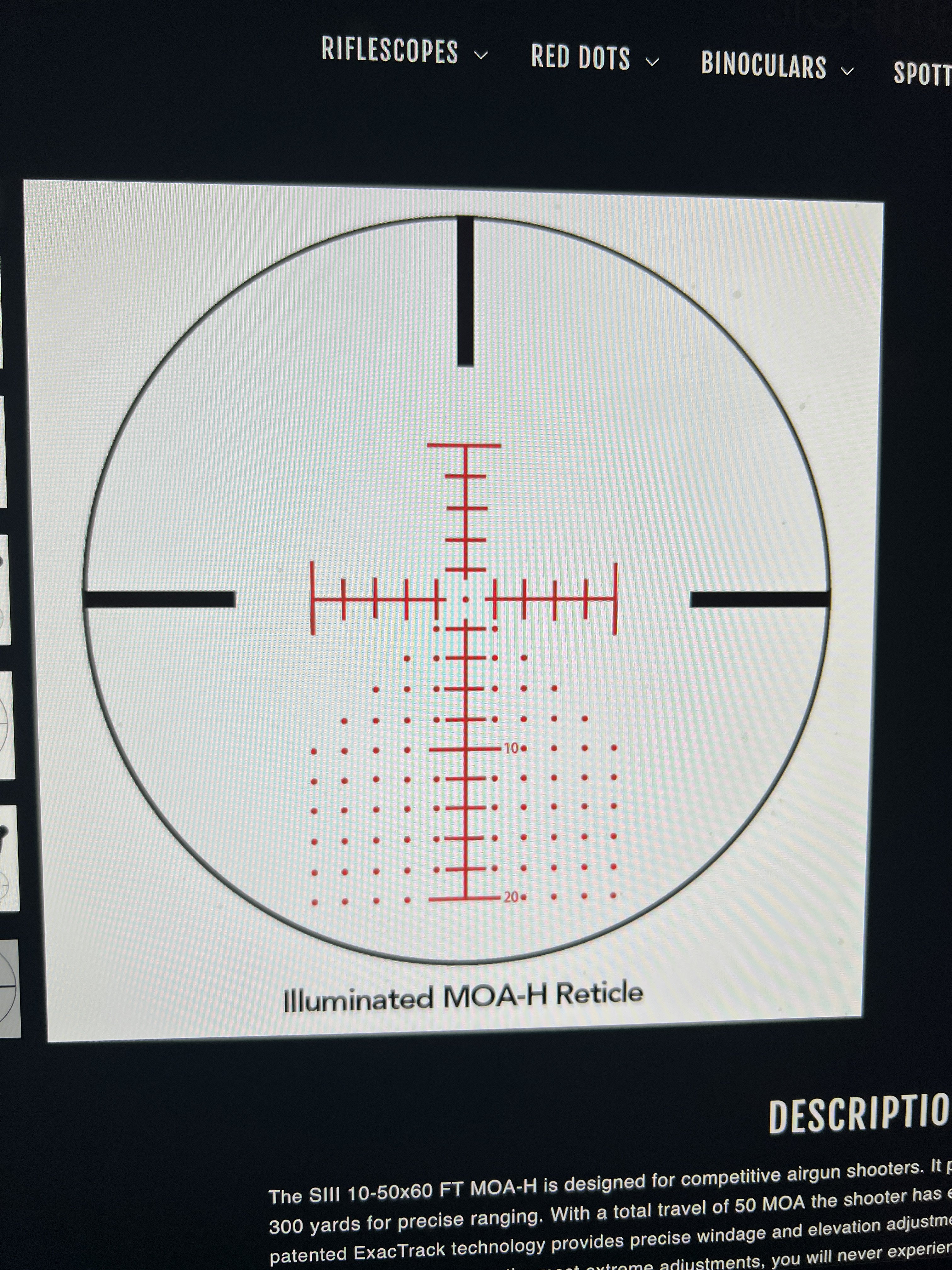

I’m torn by choosing #1 and #3 as my primary and permanent HFT scopes because #1 ranges the best but the reticle requires i guesstimate some holdovers because it lacks sufficient numbering markers Between zero and 1. This affects my 21-29 yards and 31-39 yard Shots.
I really like the Element Titan too because it spreads the numbers out 270 degrees on my wheel. #5, the s-tacs are fairly compact but also lack some useful holdover markings.
Athlons like the Element have Christmas tree reticles thus more holdover details.
See photo.
Thoughts ?

I should add that I do have a higher KZ success score with the S3’s but I’ve also been practicing more with them.
@cavedweller are you sure you’re not over thinking this? At 25 yards, one division on the Sightron SIII at 16x = 1.5 MOA which is equivalent to .39 inch and 1.5 MOA at 39yds is .61 inch. A good shooter should be able to discern 1/2 division (.75 MOA) [or even 1/4 division (.38 MOA)] on that reticle. That means you can hold a POI of between .19 and .30 inches at 25 and 39 yards. If you are shooting AAFTA Field Target and the MD is following the rules, the smallest KZ at 25 yards is 1/2 inch and the smallest KZ at 39 yards is 7/8 inch, meaning you should be able to hold a POI that is less than half the size of the KZ. When you add the POI accuracy of your rifle and the POI accuracy of yourself in an FT position to these numbers, the result should be that you are able to hold within the KZ.
The AAFTA rules were setup long ago when scopes, rifles, and us shooters probably weren’t as accurate as we are now, and the distance limits are based on what seemed achievable at that time. Course Troyer levels have increased because we are better shooters but the limits have remained the same.
If you had finer demarcations on the scope, do you believe that you could sit still enough to accurately hold to that smaller MOA? I cannot! I also usually find that I am thinking about wind holds that cause me to move left and right to account for pellet drift, so I’m not on center of the reticle where the marks are anyways.
Shooting in the woods where I do most of my shooting means my emphasis is on good glass that is bright with a fine reticle that stands out against the background and also sometimes a lighted reticle. Snappy ranging using parallax is important for close targets, and then using bracketing with the windage demarcations on the reticle on known object sizes (the concrete block or the diameter of the KZ) for targets past 40 yards. I find that the SIII fits my needs perfectly. There are other scopes that may also work equally well, but I don’t usually think of the reticle demarcations as much as clarity, brightness, and parallax ranging when selecting a scope.

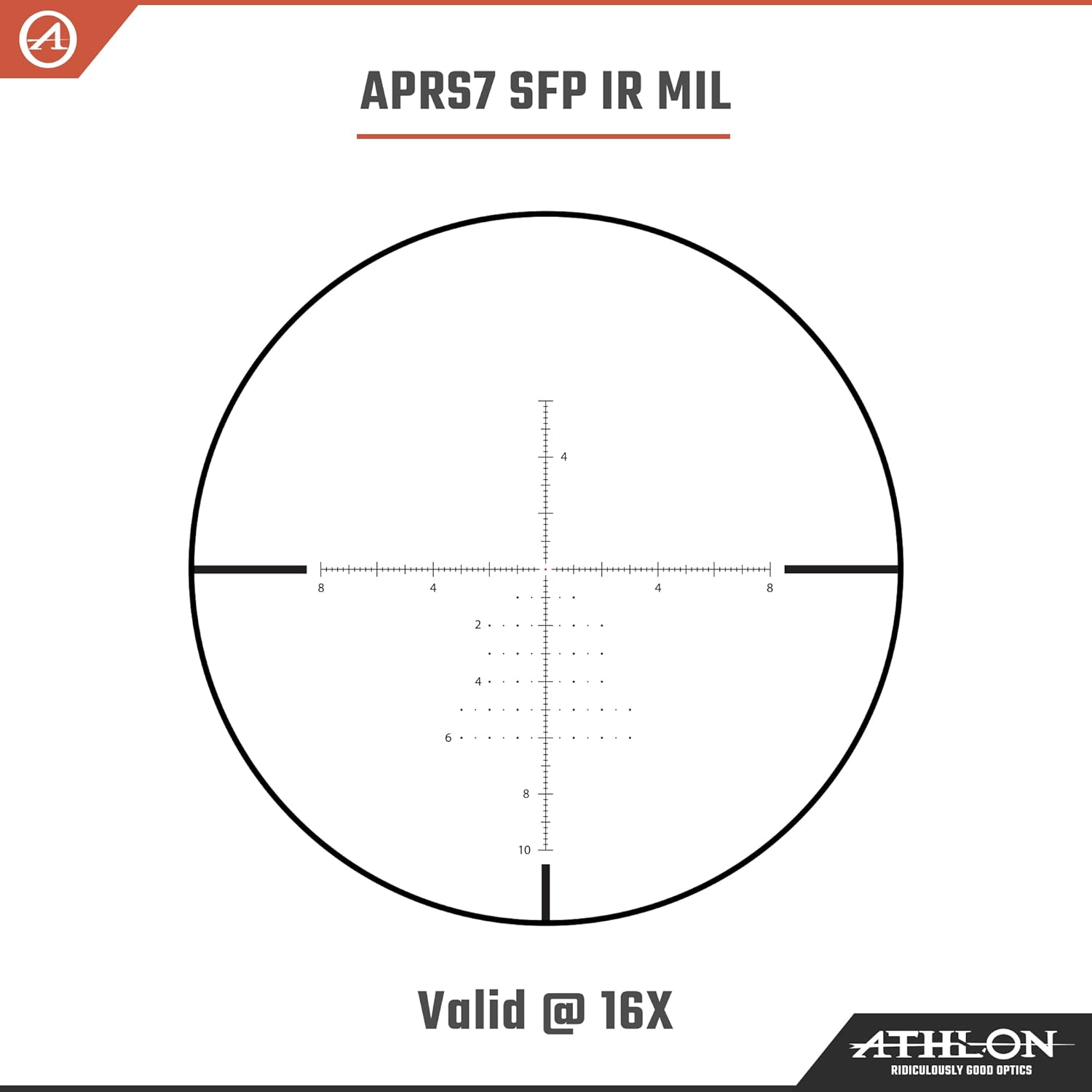

APRS6 gets my vote but you know how it is - I am a bit biased.

I have #1 and #5 on your list but I use the Athlon Heras 6-24x56 SPR with the APRS9 reticle for my main HFT rifle. I wish I could get the Sightron SIII with the Athlon recticle, I do like the .2 markings for < 15 yards and > 40 yard shots. Plus, I like pronouncing "Heras". ;)

ATHLON 16x Mil-dot in .2 mil hash .... SUPERB !!!

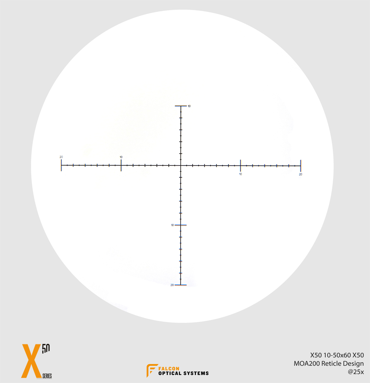

Take a look at the Falcon X50 MOA200 reticle. For Hunter class, this reticle is awesome! I Iove mine.
The scaling between fixed MOA positions is still too wide and no better than a 1/2 mil reticle. as is say a precise .7 hold, guesstimate whats a .5 hold, then . a .75 hold and hold a tad less .... been there & done that for years and it's kinda difficult.
Scaling with .2 Mil eliminates that kinda close guess work.
