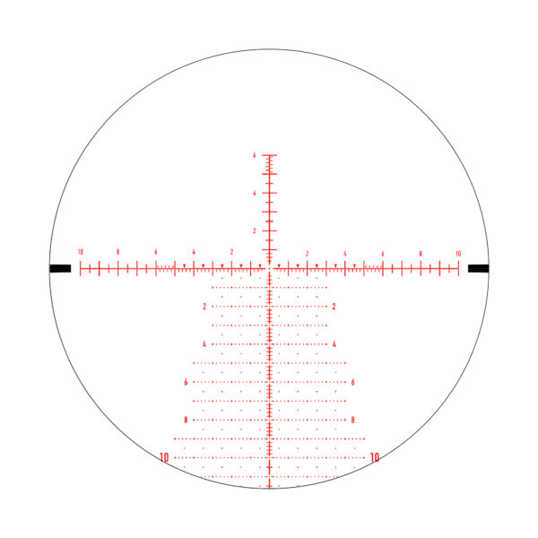

This weekend i was having great success with my Sightron 10-50x60 ft scope SFP / IR with ther MOA-H reticle on my Redwolf LP.
So i figured "lets try a different gun Daystates' Wolverine Sapphire, with a different scope, the Element Titan 3-18x50 FFP Mrad AP"R 2D reticle.
I have this scope in both MOA and MRAD. I went with Mrad for more detailed holdover points. These Titans range very well and spread the #'s out 270 degrees on the 5" wheel..
I quickly validated my dope from my bench to make sure nothing had changed (spot on) then Inmoved outside to the bucket and sticks.
I immediately began to struggle.... on all my "darker shots".
why?
I had plenty of Mil Holdover points of reference with the reticle, which i thought would greatly increase those dicey shots, and thus help.
But, the reticle at 16X was too fine to my 68 year old eyes so I got visually lost in the further darker shots - just couldn't see the reticle well enough past 42 yards to place it properly on a darker targets KZ's..... I turned on the reticle and yes it helped a bit.... but it was still tough.

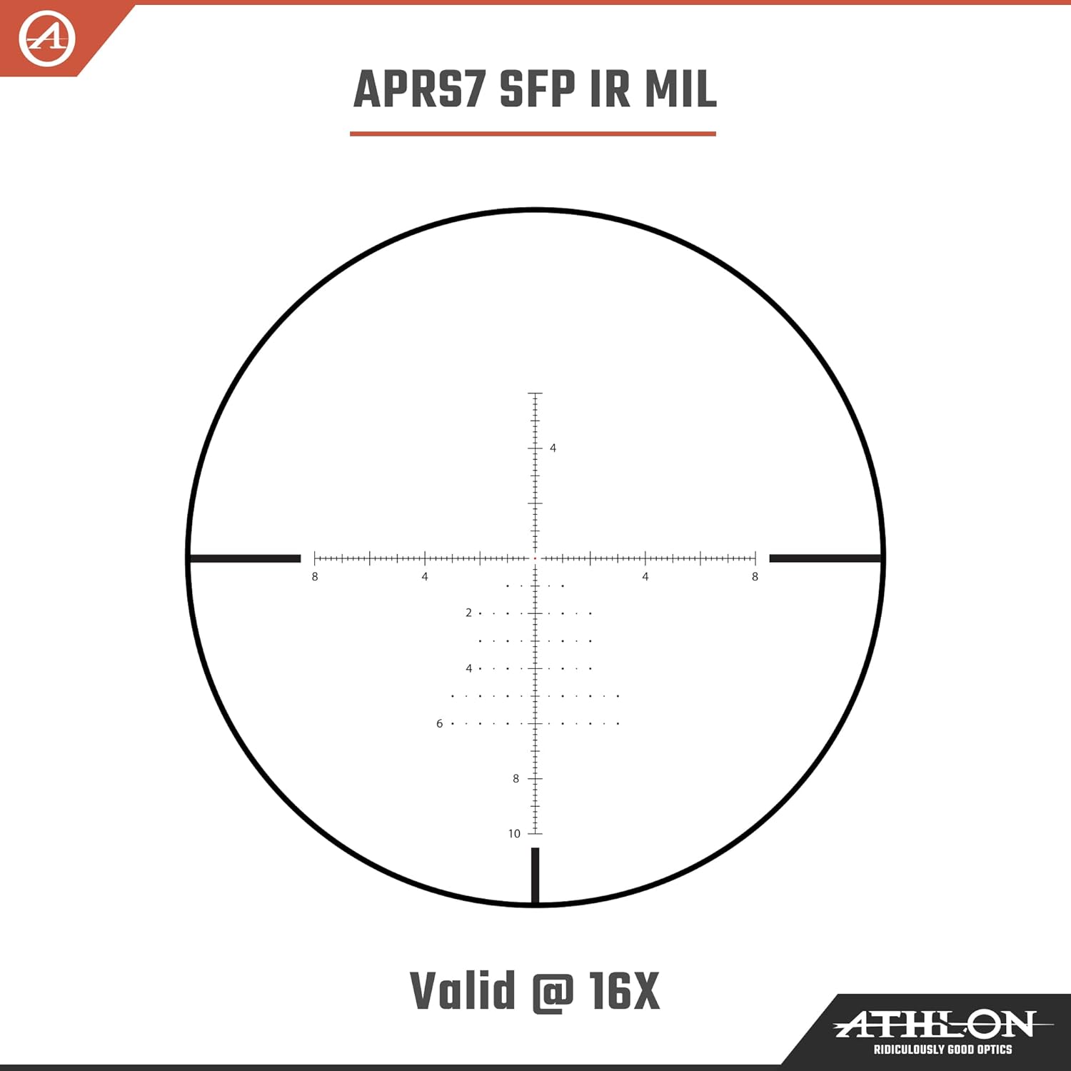

Next week I am going to try a similar experiment, but this time i will shift to an Athlon Heras BTR Gen2 6-24x56 MRAD APRS7 reticle or APR-2D in second focal plane.
I have this Athlon in both FFP and SFP and I think @Motorhead is using the same scope in SFP and likes it.
This is what the Athlon SFP APRS7 Mrad reticle looks like at 16X
Great scope, it works on my .30 for UFT but I personally find it way to busy for HFT and not spaced out enough to easily find my hold. Also I believe the it is only the center dot? That’s the fun thing about this sport everyone’s perspective is a bit different😃
in SFP only center dot illuminates... if my FFP the whole reticle will light up.
