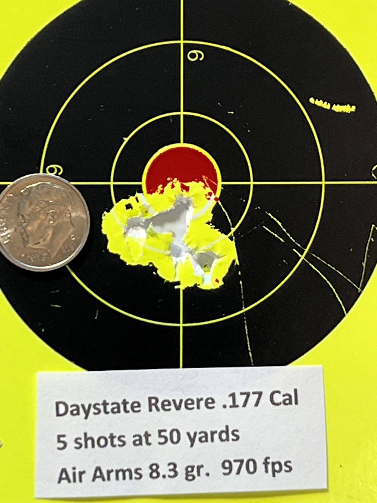

OK, here goes:
Daystate Revere .177 cal.
JSB 7.87 gr-1001 fps
AA 8.3 gr-969 fps
AA 10.3 gr-909 fps
JSB 13.4 gr- 790 fps
I did not test accuracy of all weight pellets, but as you can see, it really shoots!

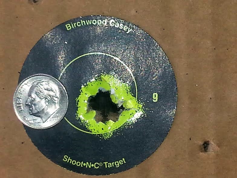

I used to have a Daystate Regal (the old bolt action version) in .22 caliber. I didn't like the bolt action so I sold it, but it was quite good too: I wish I could find a .22 cal Revere, but those are long gone!
JSB 15.9 gr-888 fps
JSB 18.1 gr-848 fps

Very helpful!
I had a bolt action unregulated Regal XL, and it shot just as accurately as my regulated Revere .22 caliber. Your velocities with the 15.89 and 18.1 JSBs for the .22 cal are very similar to mine.
Your information ( and Joedirt199) for the .177 version tells a good story.
