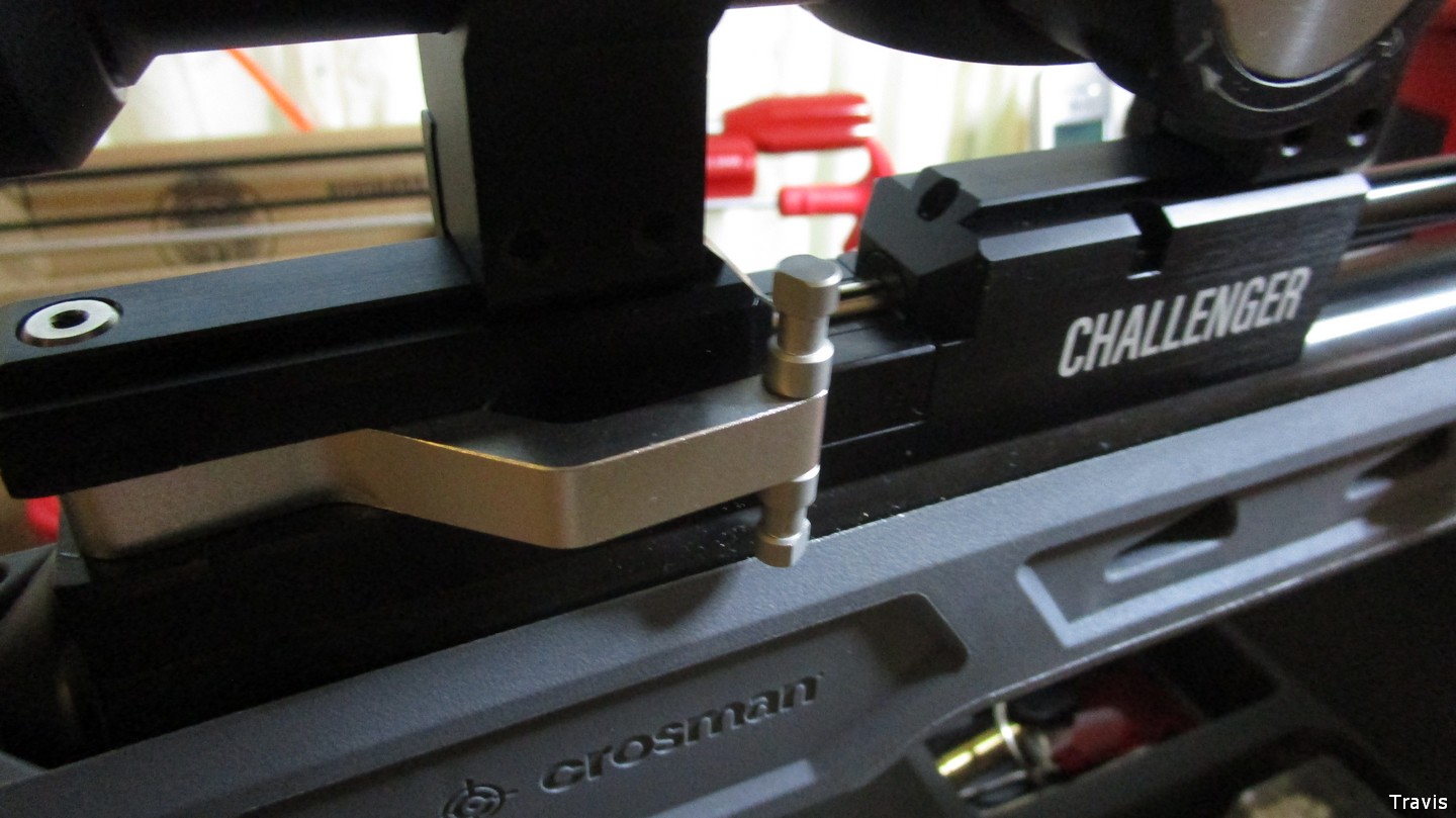

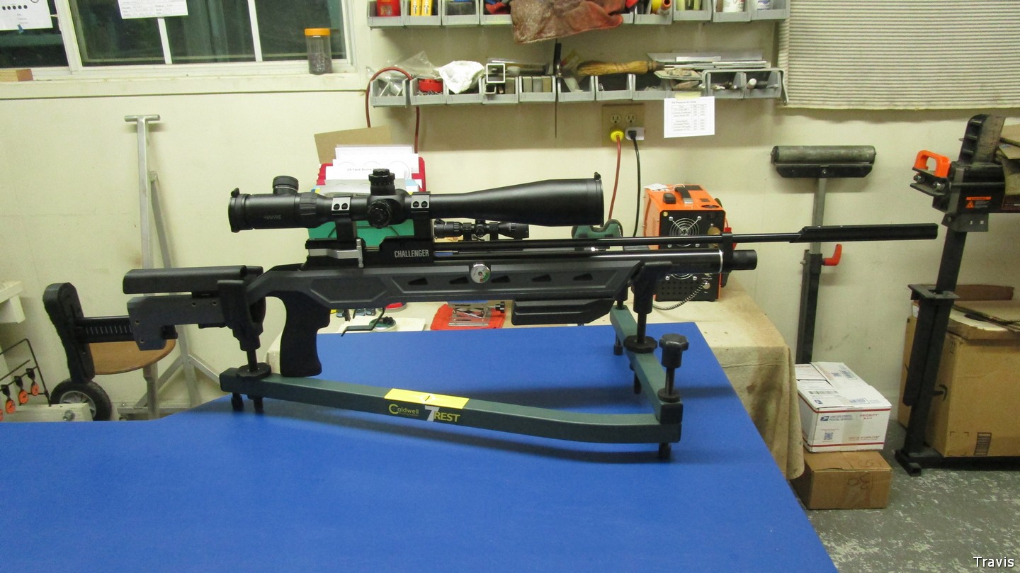

View attachment 346179View attachment 346180View attachment 346181View attachment 346182View attachment 346183

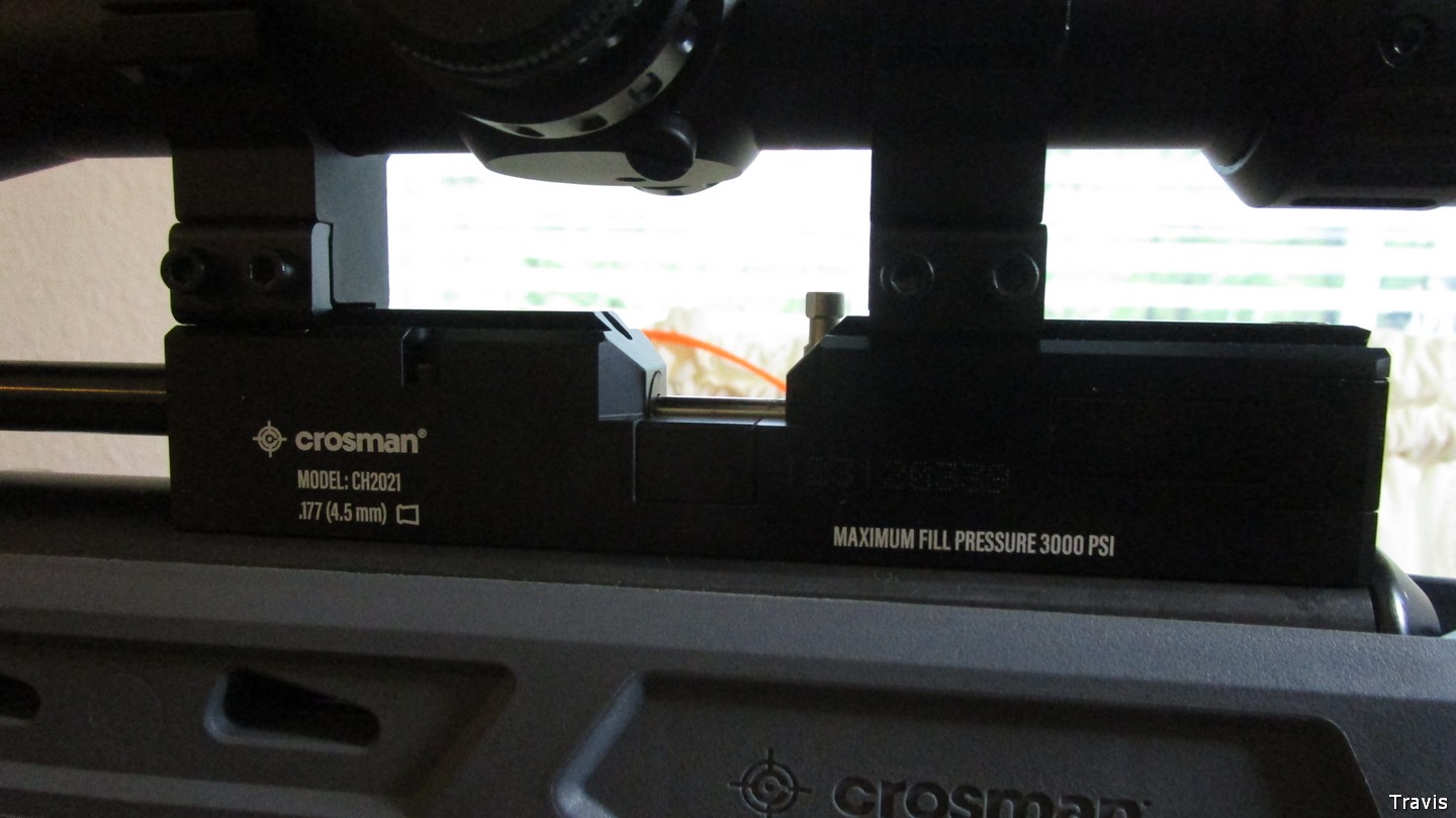

Thanks for the great detailed review Thomas. How would you compare the trigger to your RAW and Crown? Is it adjustable? Can you post a close up picture of the breach area? Do you think it's possible to have someone print a SST for it?

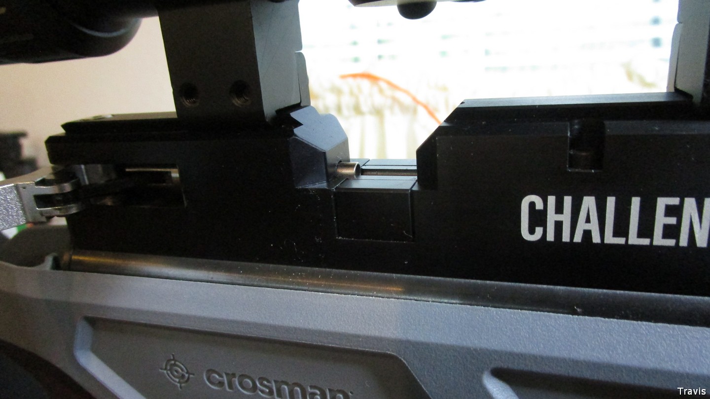

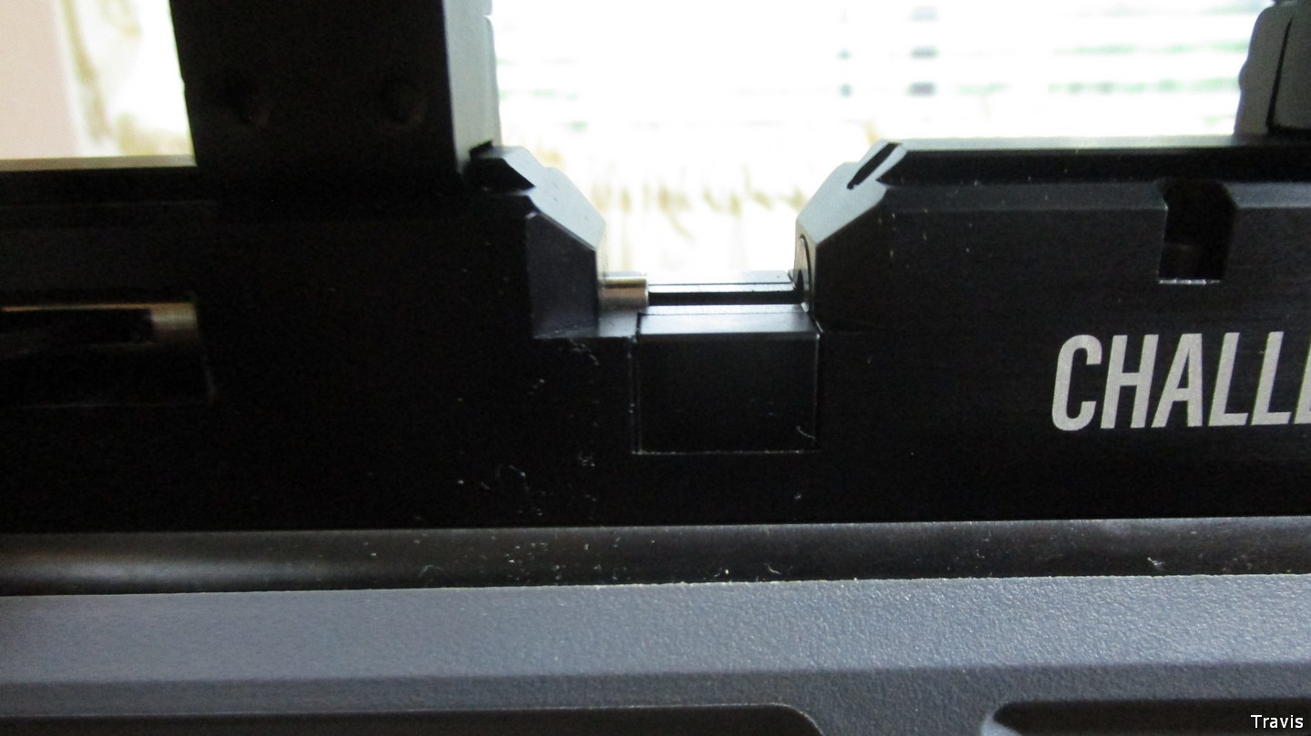

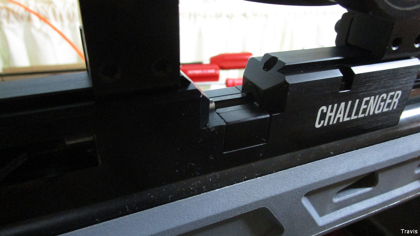

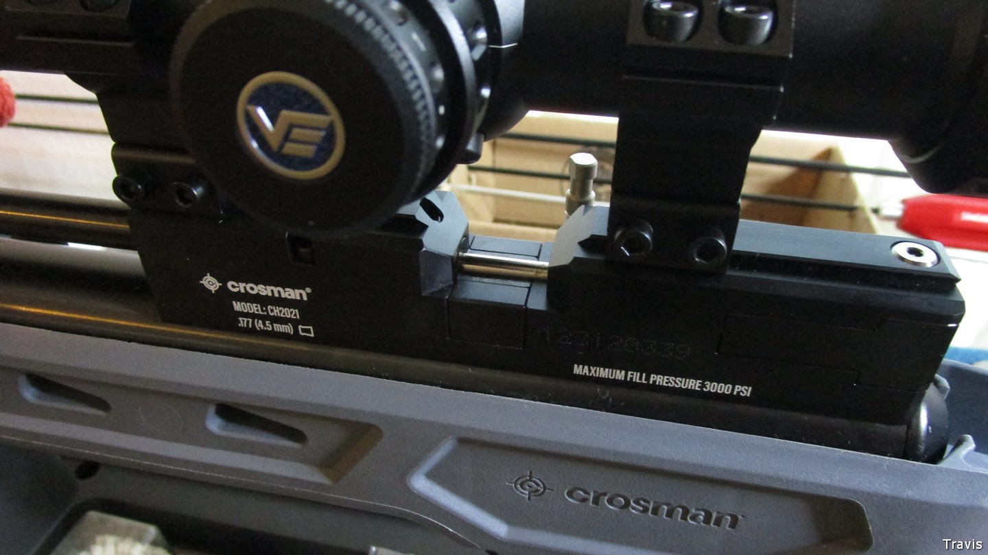

Is that a hollow probe I see in the photo?
The earlier Challenger used a Mrod gen 1 trigger. Is this one the current Mrod trigger?
Hello @Struckat
I really cannot tell if the Probe is hollow or if just the first section is drilled out. It could be the "airway", my manual does not tell me. Good question, I will do a bit of research.
