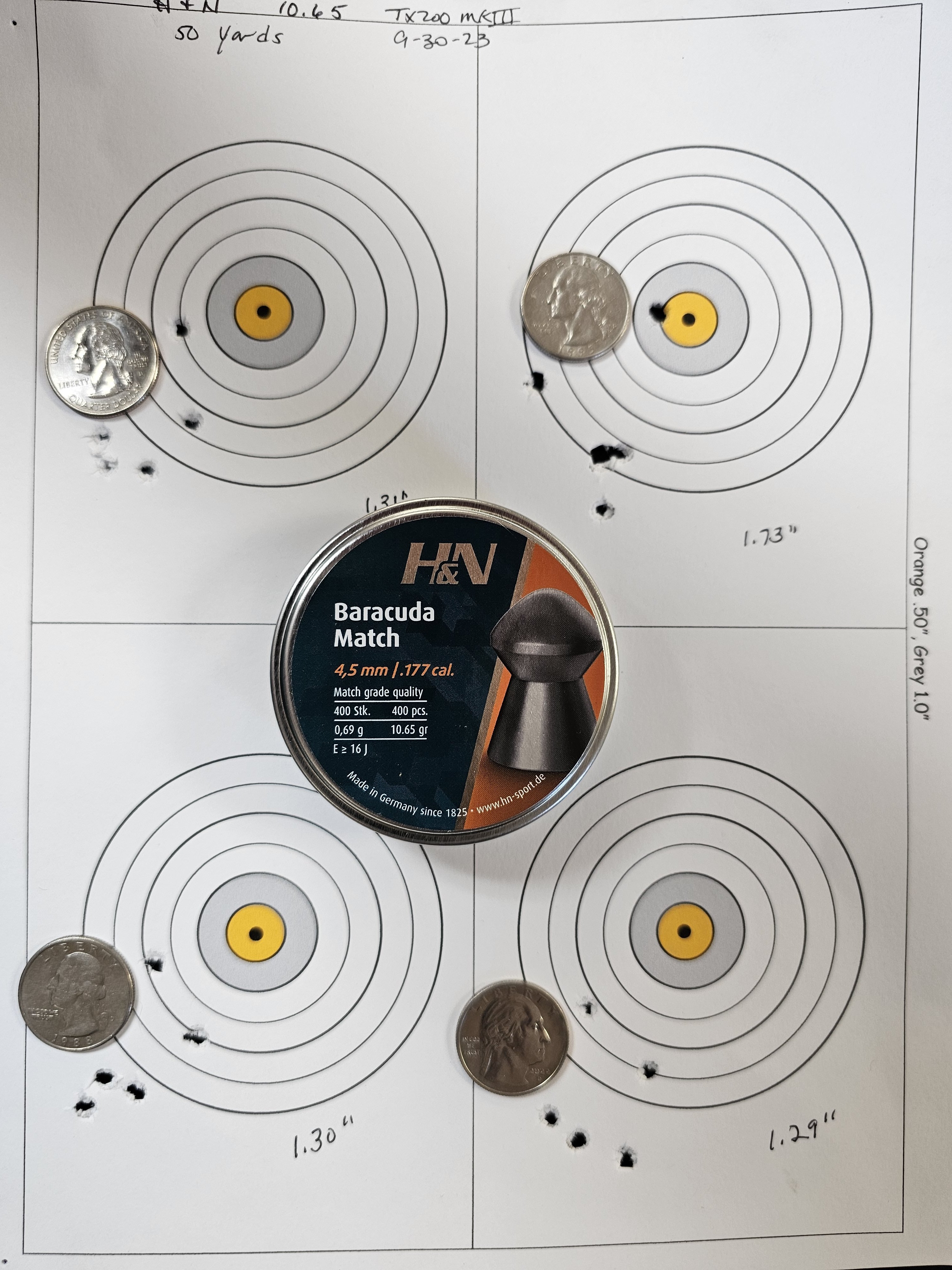

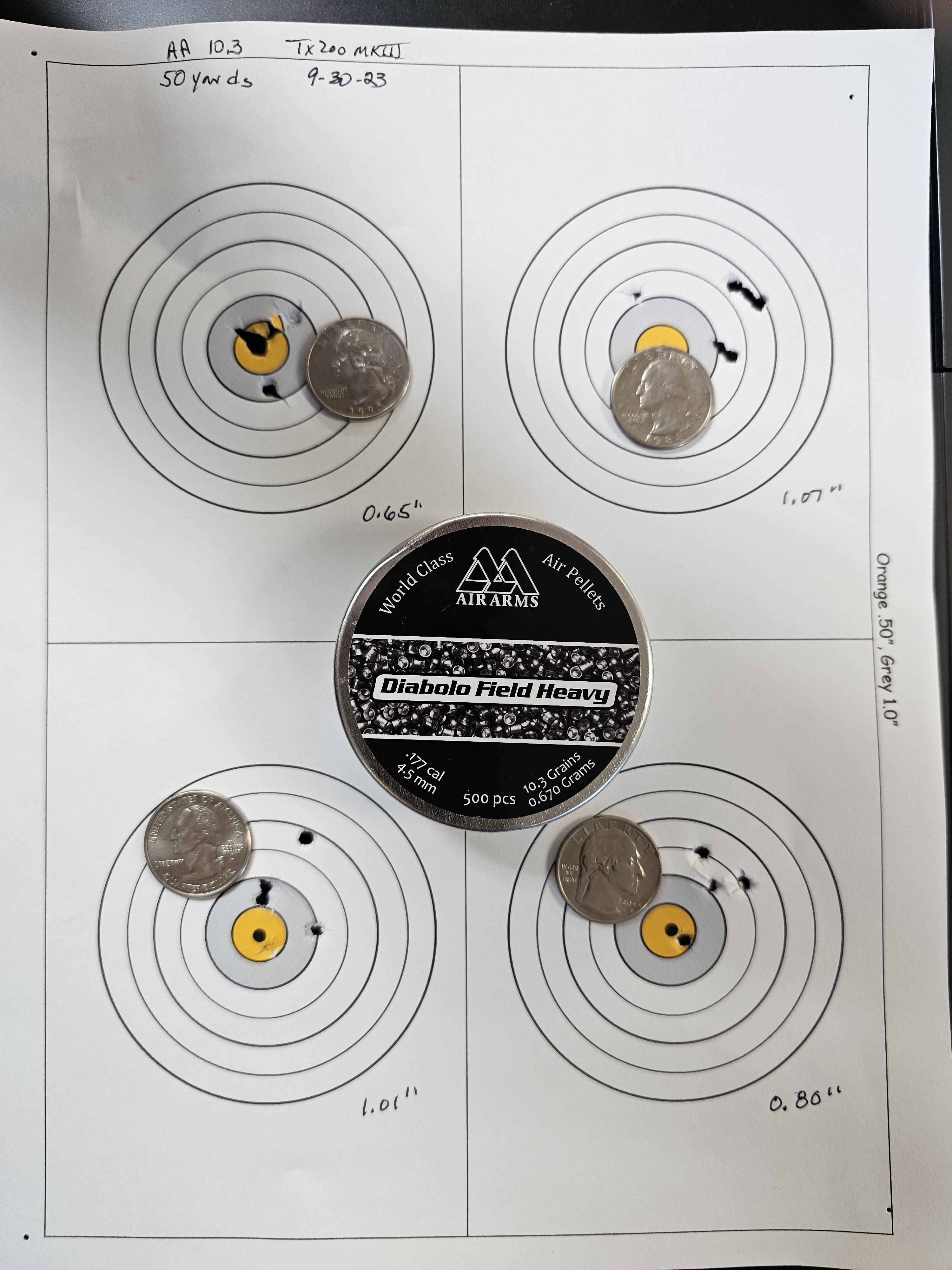

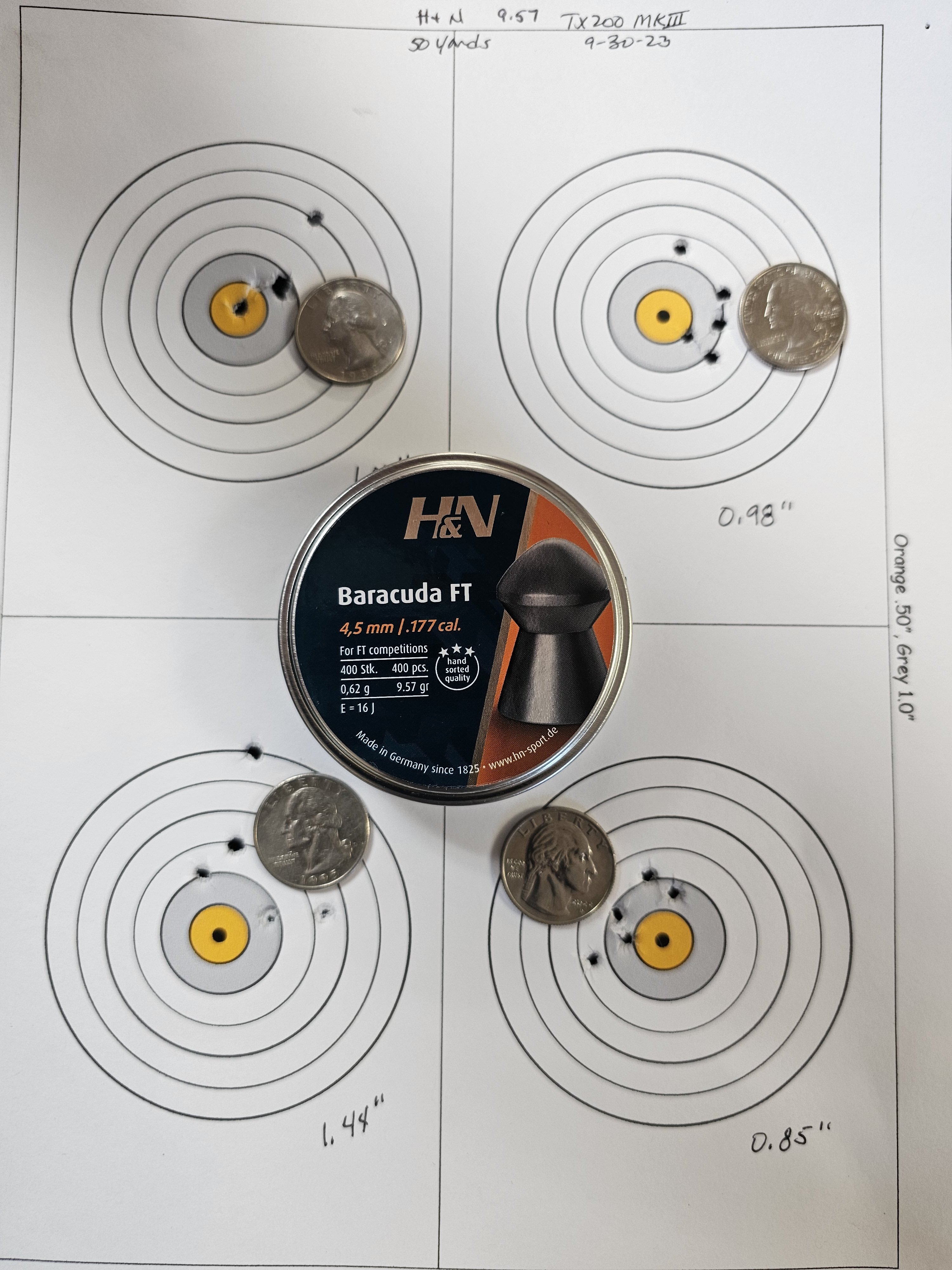

Here 2 types of H&N pellets were tested. The H&N FT 9.57 grain (4.50mm) and H&N Baracuda Match 10.65 (4.51mm). Their performance was compared to the AA 10.3 (4.52mm) pellets that I regularly use. In this instance the H&N 9.57 provided solid accuracy compared to AA 10.3 but shot slower and with more trajectory. Future testing with H&N 9.57 is suggested.
