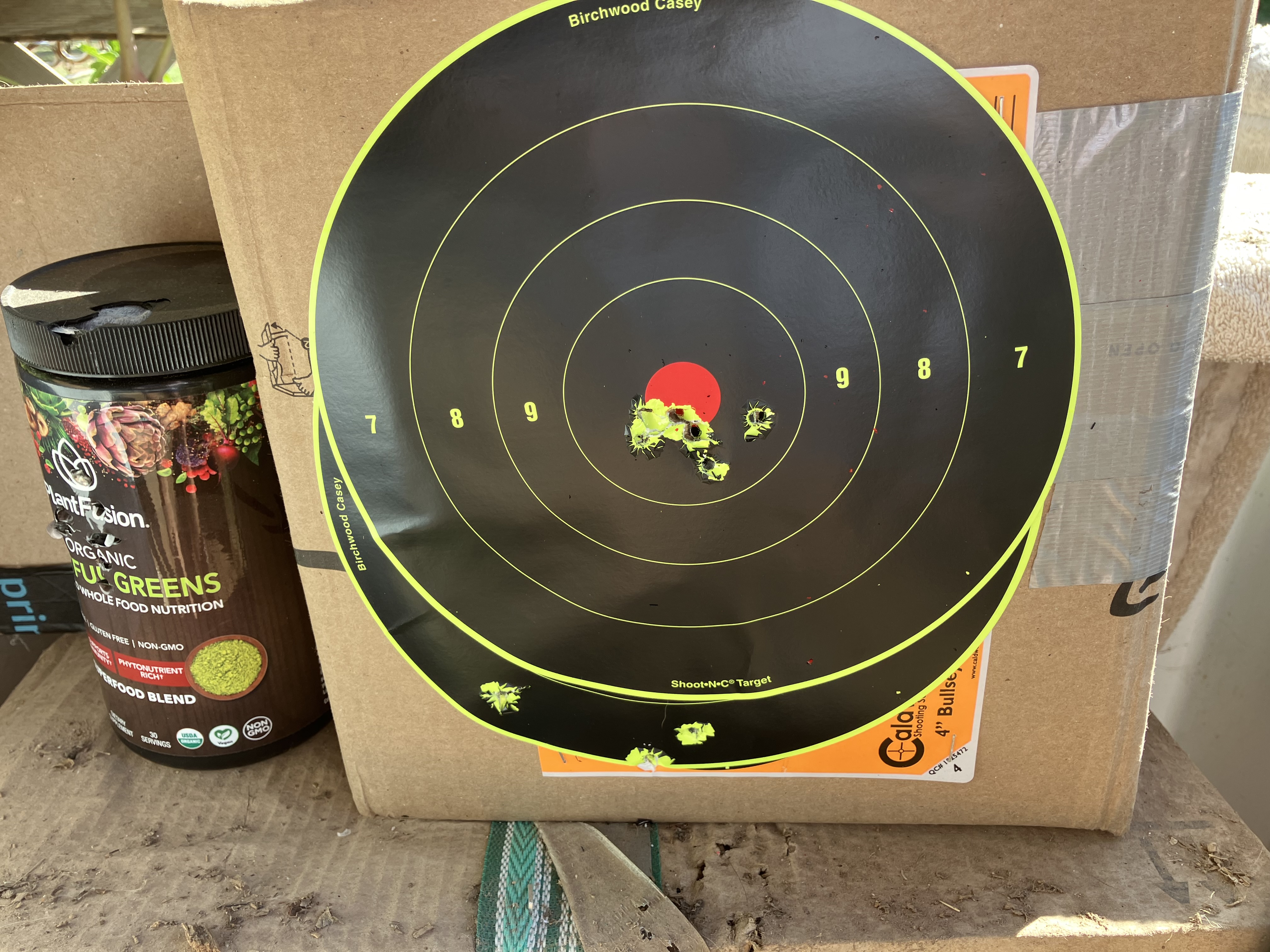

OK, Got my 3ed Reximex Pistol in today, Trust me if PA wasn't so easy to work with I would have thrown in the towel on the 2ed gun, I did ask for a 10 for 10 leak test on this 3ed gun but PA did drop the ball and did not do the leak test,, ()()*%$#$@#$#$%$_) , I cleaned the barrel , Sighted in with my red dot , air the pistol up with a well lubed probe, (silicone) , Its a shooter for sure , Very impressed with this light PCP pistol and very accurate ,, Spent about 4 hours shooting this pistol aired up about 4or 5 times or more, Looks like I got a good one for sure this time , The morning will tell .. Oh it loves the Crosman Premier 14,3 gr 22 domed pellets , Wow another big plus , I got to give PA 10 stars I gave them hell sent the guns back and they sent me new ones with there $$$$ and always were good to work with,, I am sure they lost money with me on the Reximex deal,But they have a customer for life,,,,

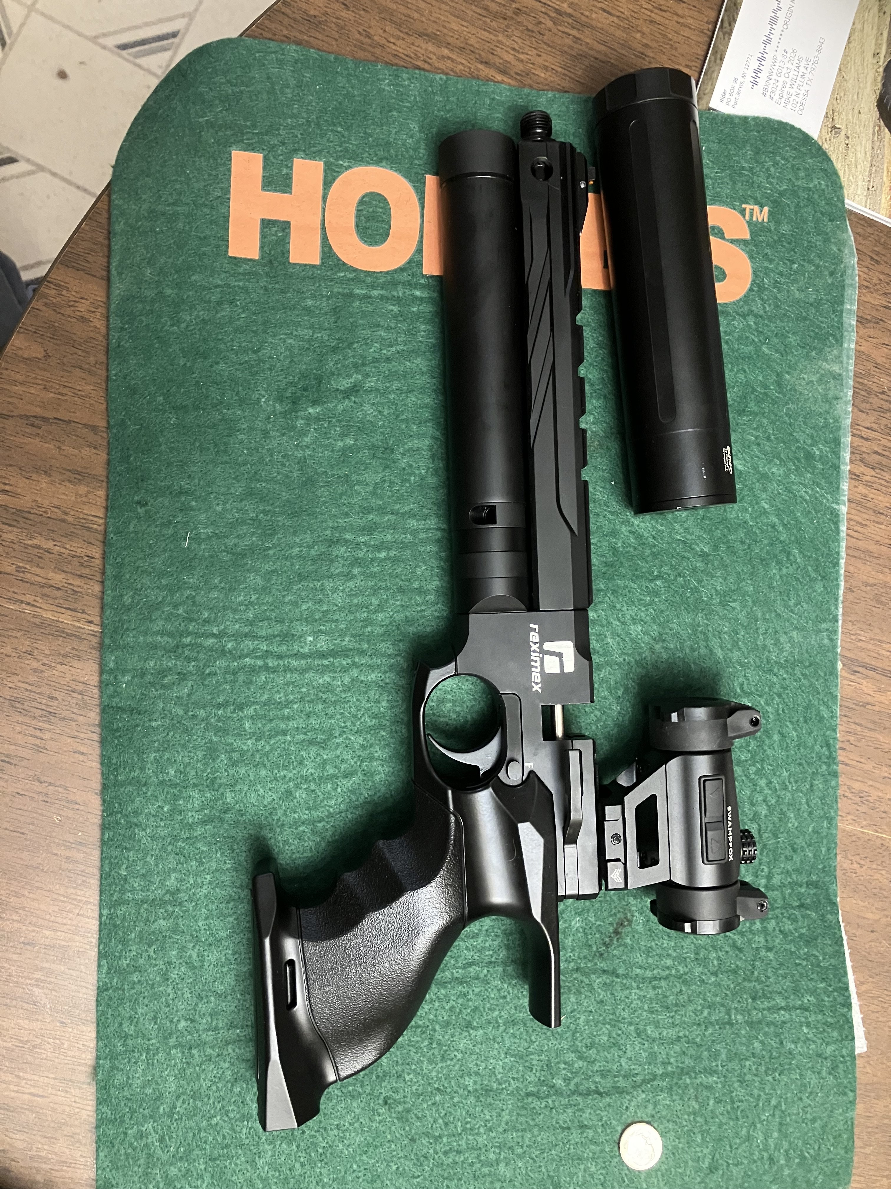

I will say the Reximex , Pistol is my favorite pistol , PP750 and PP700 , P17, P11, zoraki, Can't really throw the GKl in the group its a semi auto and that just throws the rating system off by a mile or to,, But the Rex is my lightest pistol of the PCPs ,,, And quarter size groups at 25 yards with a red dot and a blind shooter, Not bad.. And another big Plus for the Rex is it likes Crosman premier 14.3 hollow point and the domed pellets ,, And another Plus is The cocking handle is on the left side, The magazine you have to really watch while loading it in the gun, Got a aftermarket magazine coming that may fix that..
