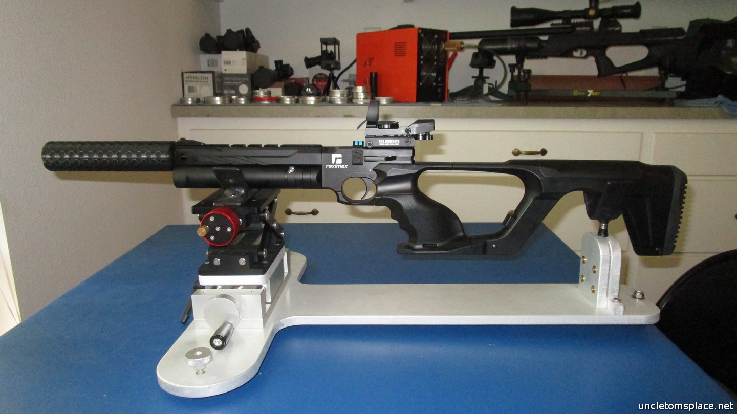

Hey again @AJ_Roberts
This is a full scale squirrel target that I shot this morning at 10-Meters after mounting the Red Dot. The Blue ring shows first three shots with no adjustment to the scope. The Star shows eight shots after adjusting the scope.
ThomasT

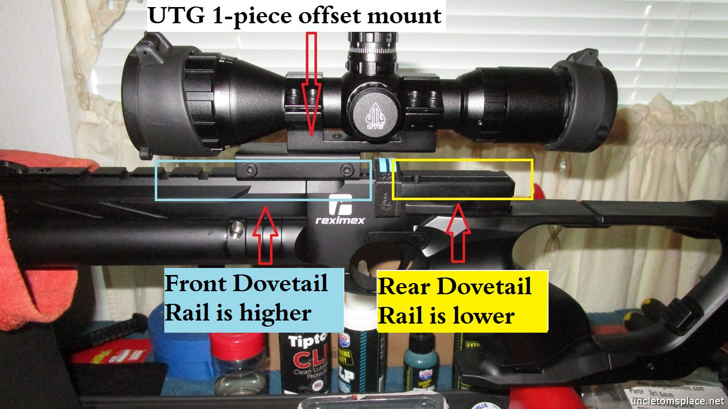

Hello everyone,
IMPORTANT:
If you buy a Reximex RP or RPA it is Important to know that the Front 11mm Dovetail Rail is HIGHER than the Dovetail Rear Rail. ( see photo )

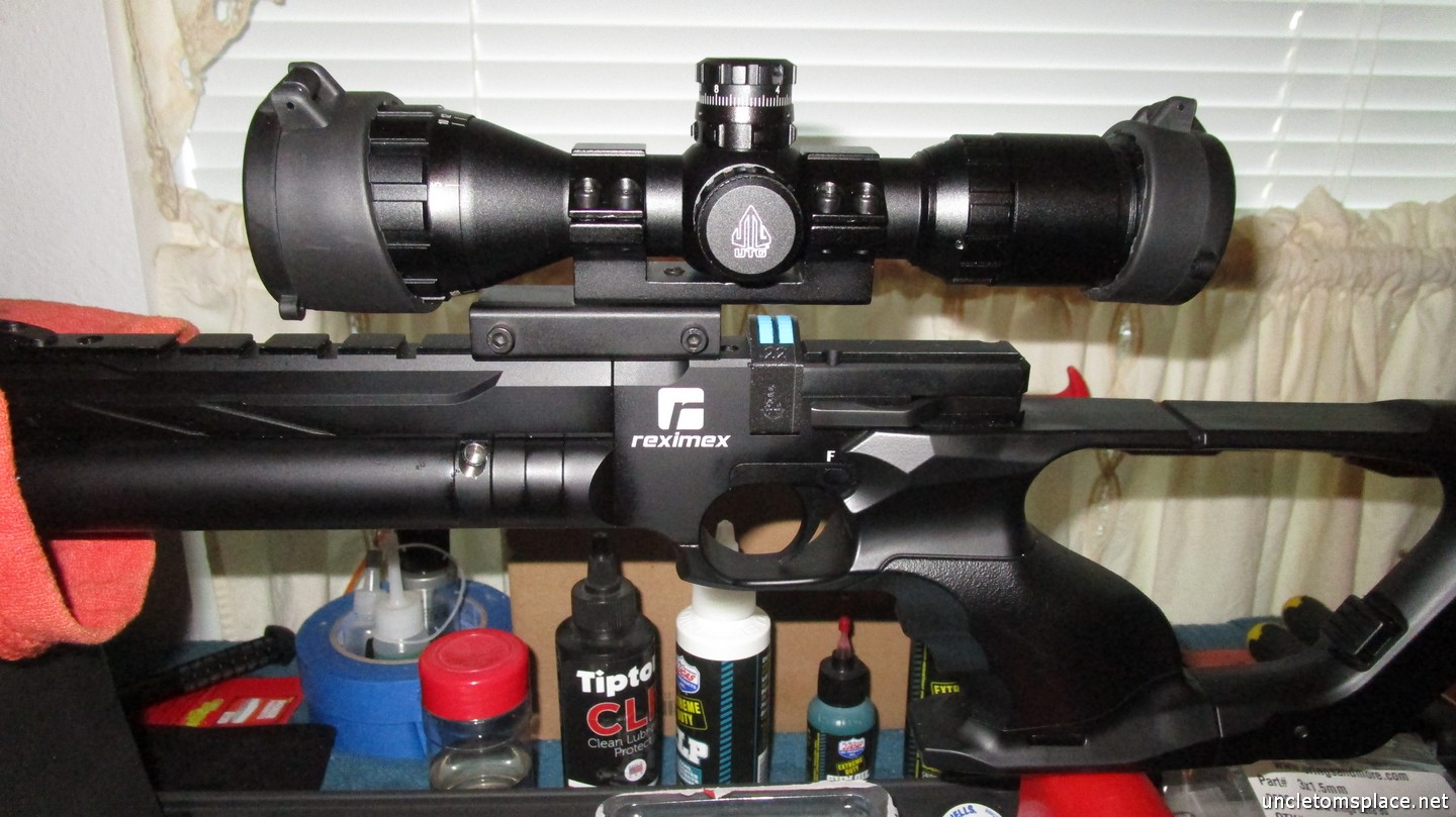

@AJ_Roberts pointed this out to me and I now have a UTG Bug Buster scope mounted using the UTG Single Offset 11mm Dovetail Scope mount. ( see photo )
I have on order some Adjustable Scope Rings that I will use to mount any other scope when it is necessary to use one ring on the front rail and the other ring on the rear rail. This will then allow Full adjustment of the Elevation on the scope.
Hope this information will be helpful, and thank you AJ
