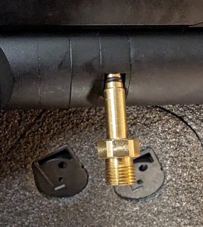

I received my Reximex RP and I ran into a couple of hiccups when looking over the components. The fill probe is super tight, to the point that inserting it completely into the pistol causes the brass to shave off and it cuts/shears the first fill probe o-ring.
The bigger issue is that I am trying to determine the thread type on the fill probe so that I can add a quick connect male Foster fitting to fill it with air. I thought it was a 1/8 BSPP except that when I thread the pieces (probe and male foster fitting) together I get about 2-3 turns before it stops threading. I didn't put wrenches to it as I want to confirm the thread type before forcing or mangling them.
I have not run into this issue with my other fill probes as everything threaded together hand tight and easily (only requiring a snug down with wrenches for final tightening). None of my other fill probes are close in size and shape so I have to make sure this one works until I can find some spares to purchase. I know there are some folks that have the RP on this forum and I would appreciate any insight on the thread type.

I will reply to myself.....Haha.... Reximex RPA fill probe is not even close to fitting..... It is so far off it is a joke. I reached out to ask for help but I think I will probably have to find one that fits aftermarket or look into having one custom made.

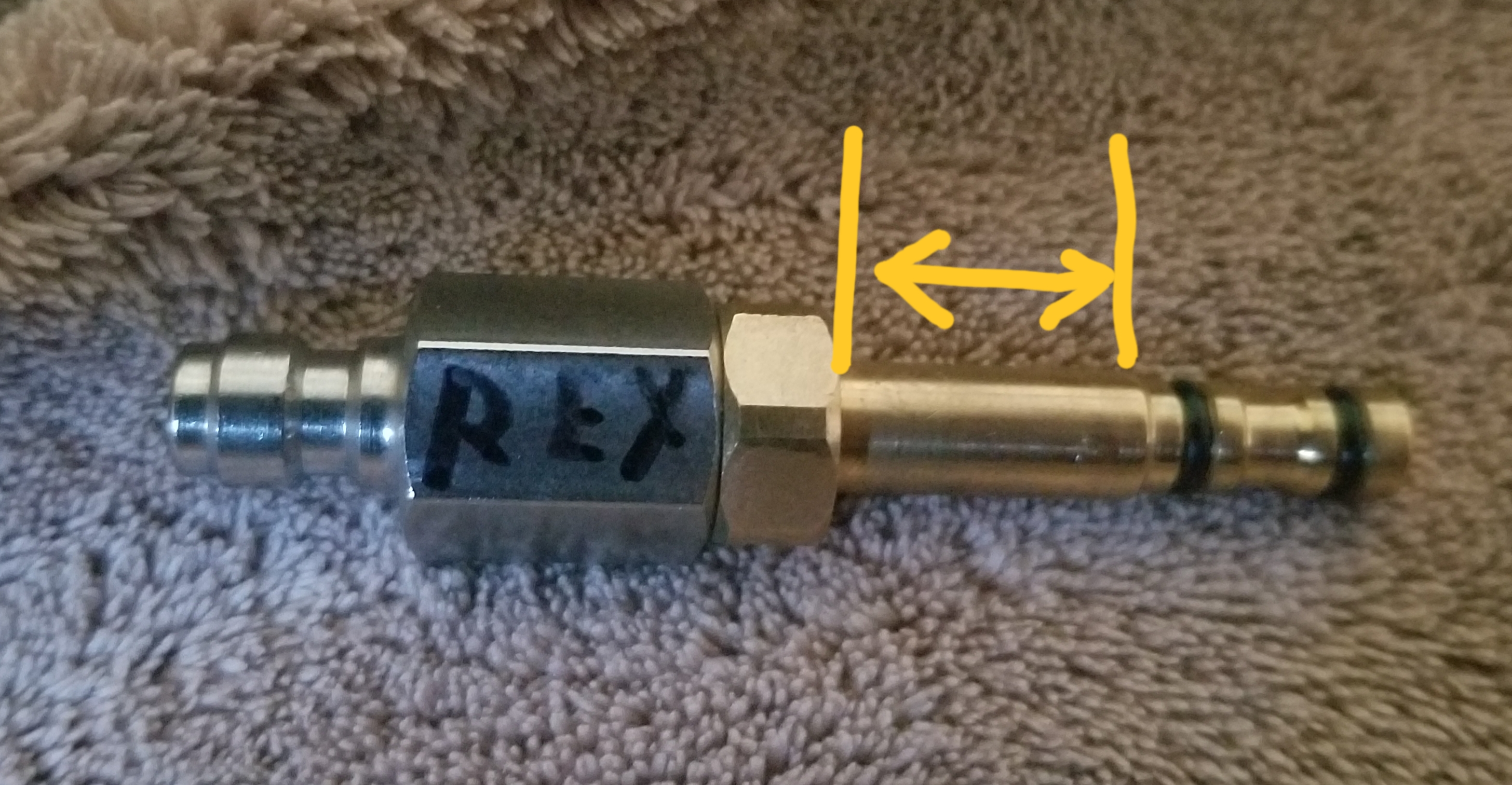

A Human
I only sanded the area between the yellow lines. I also broke the sharp edge at the insertion tip of the fill probe:
-PJ
