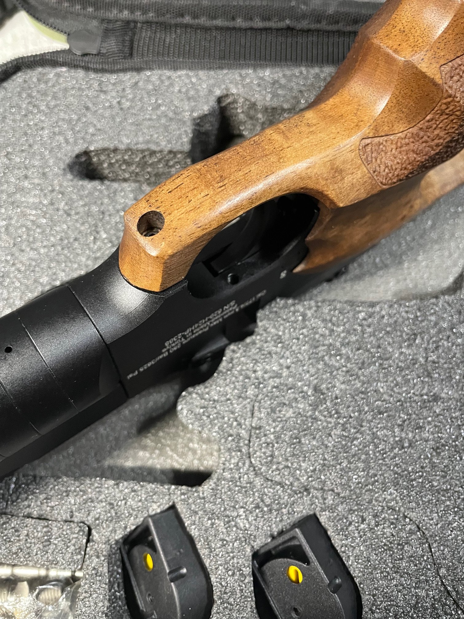

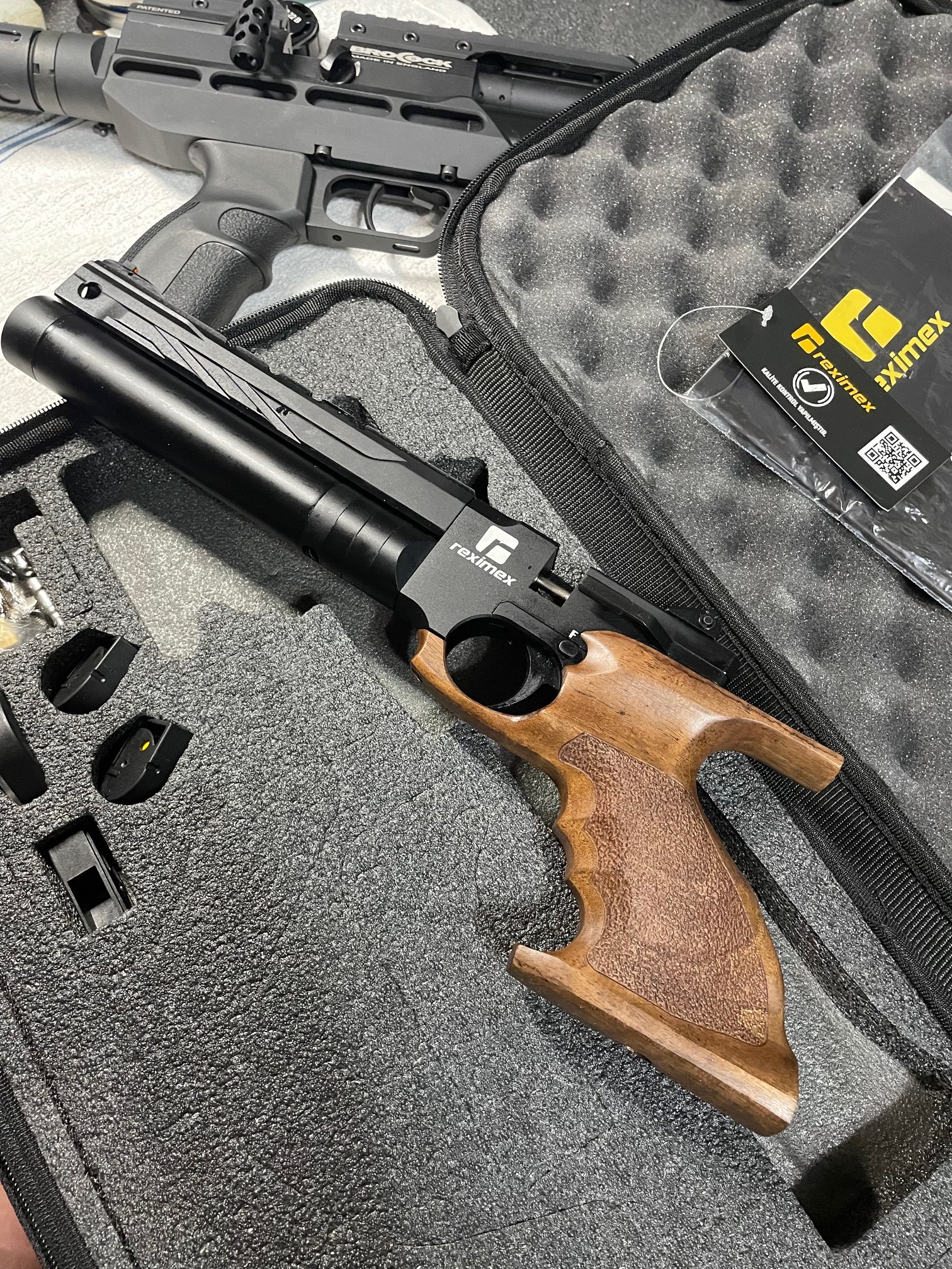

Well, after several delays PA being on back order I finally got it. It was scheduled for Thursday, but for some reason it required my signature and UPS came too early than normal. I tried to pick it up at their DC, but it was shipped to a UPS store, WT#! Picked up today and I'm not happy with the fit and finish, the wood trigger guard is warped and no air on the tank, just hope it's not a leak. Have to wait till Monday to speak with a customer rep from PA.
Well 10 days later and PA did me right. Got my replacement grip, I opted for the plastic stock and it fits a lot better.

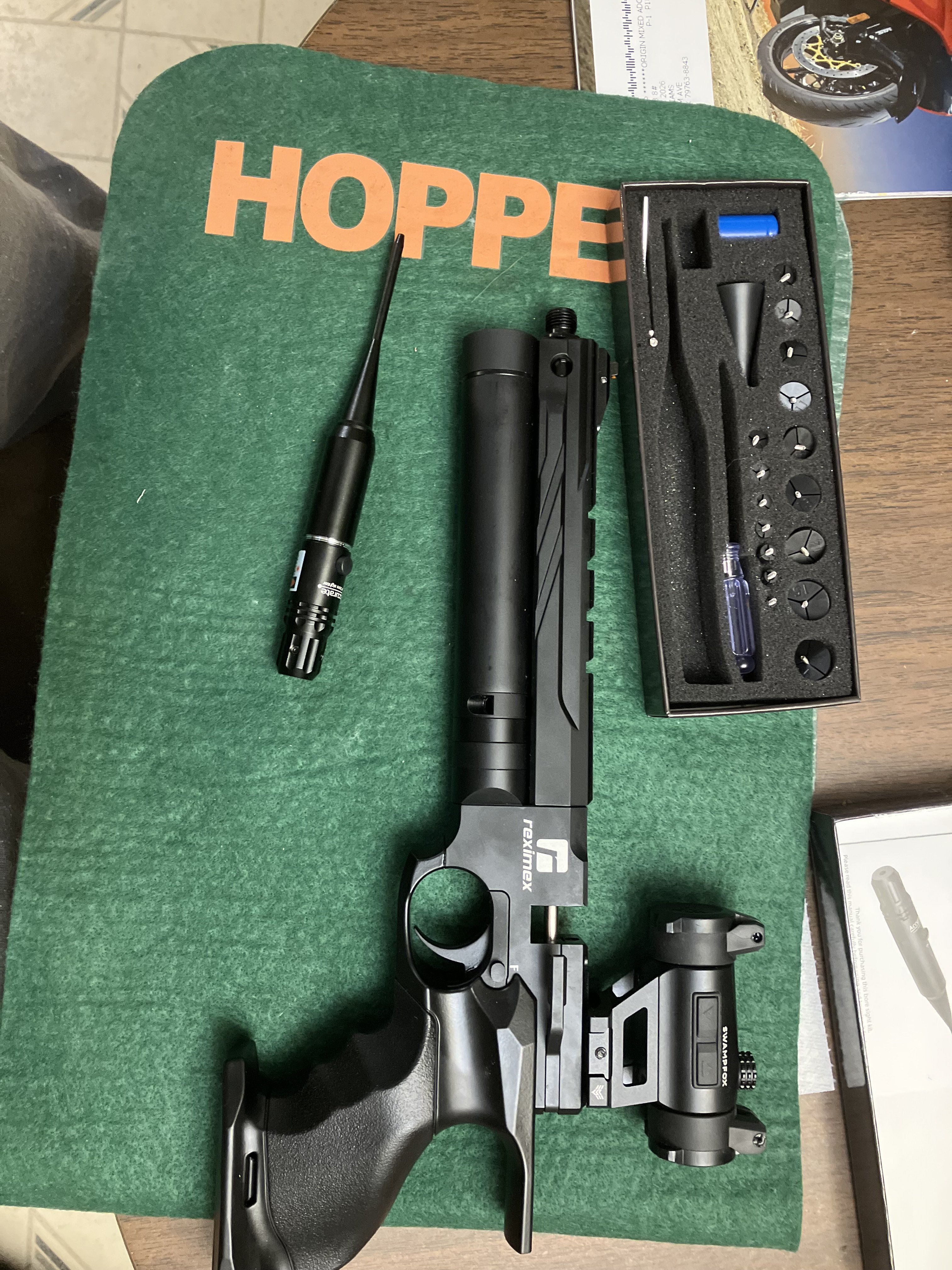

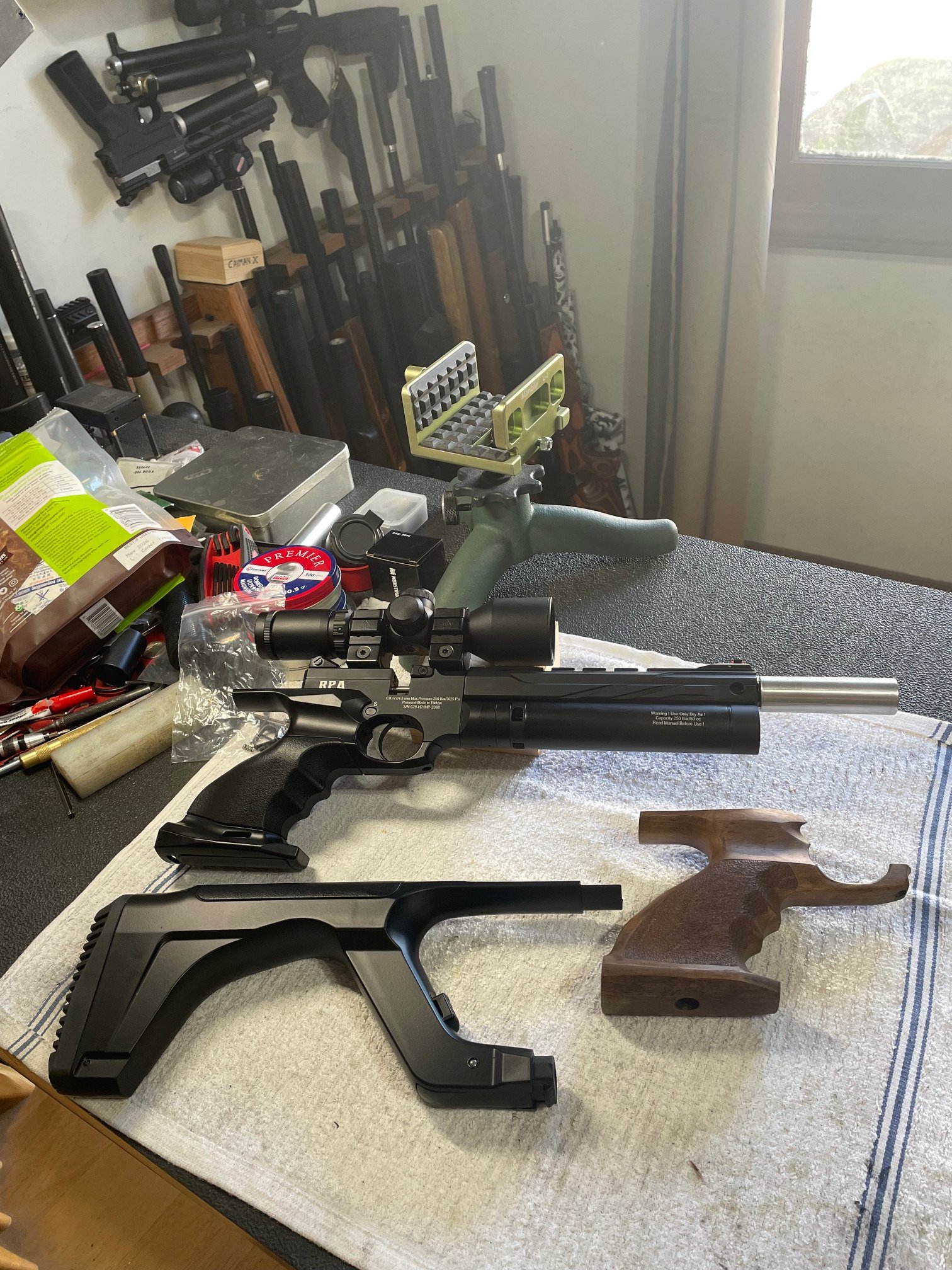

I like the gun enough to try one more time for a good one, View attachment 512442

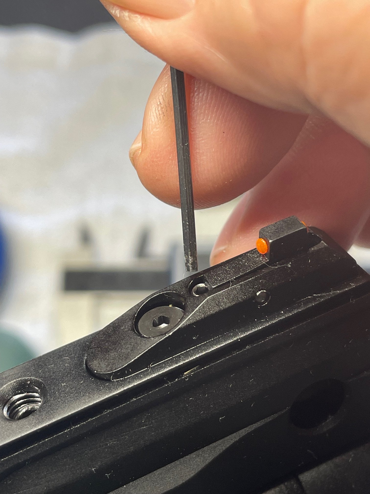

Mine is holding air good since last night. Did some trigger work today to lighten it, lighter trigger shoe return spring and lighter secondary sear spring also. Now down to 1# 3oz. Strill have lots of creep, only way to minimize this is to grind secondary sear so it drops quick. Not ready for this as I want to be able to return it to stock just incase I have to return gun.

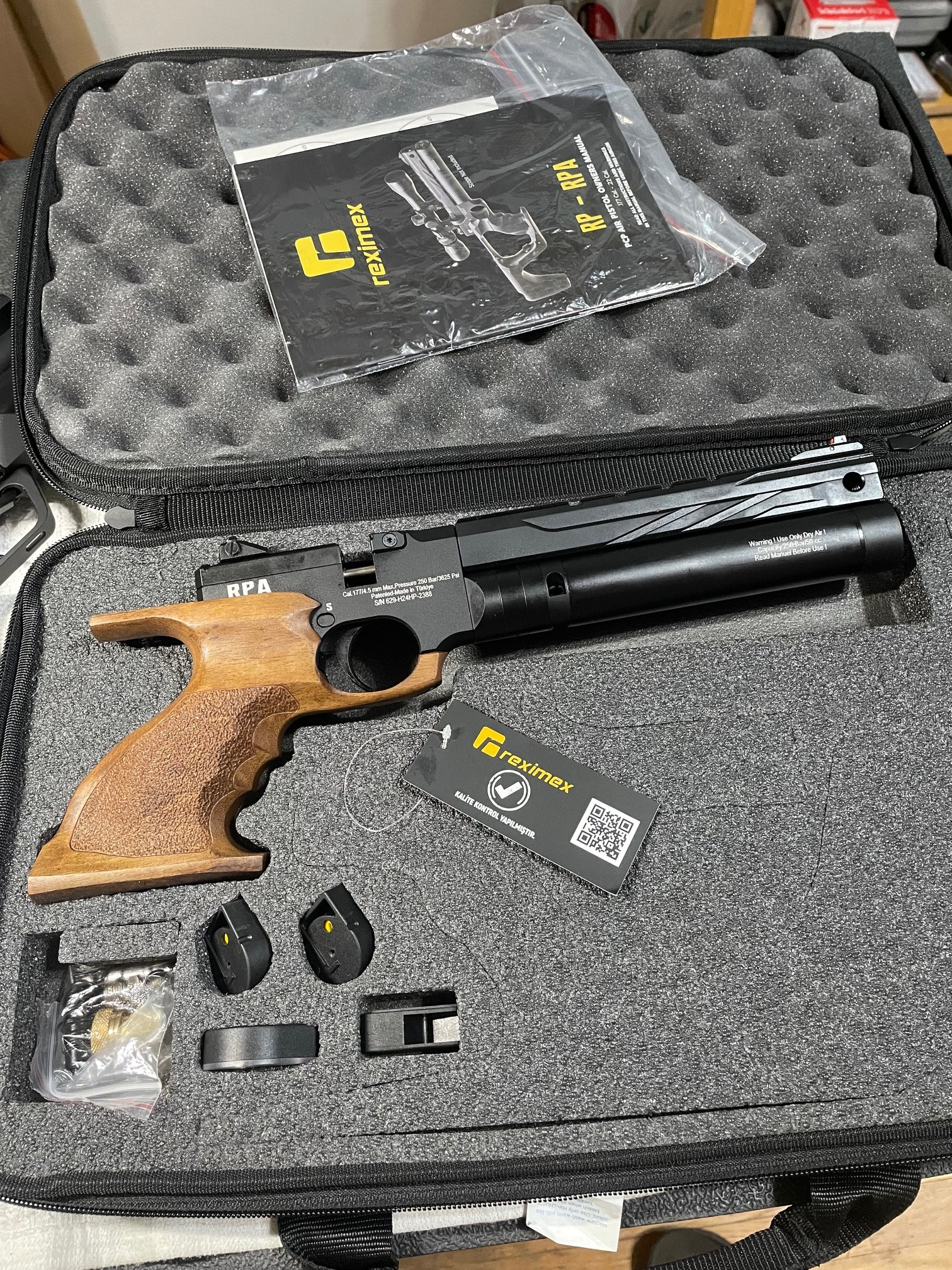

Now this is a test of the national broad ,, NO NO just kidding , But this is a test to see how fast Pyramyd air does on there returns.
Got the box off UPS ground labeled with a free Pyramyd label,, The people I dealt with were very nice and helpful.. Any way Box off
11-12-24 at 2PM Texas time, I will post when the new gets here,,, A TEST,,,,
