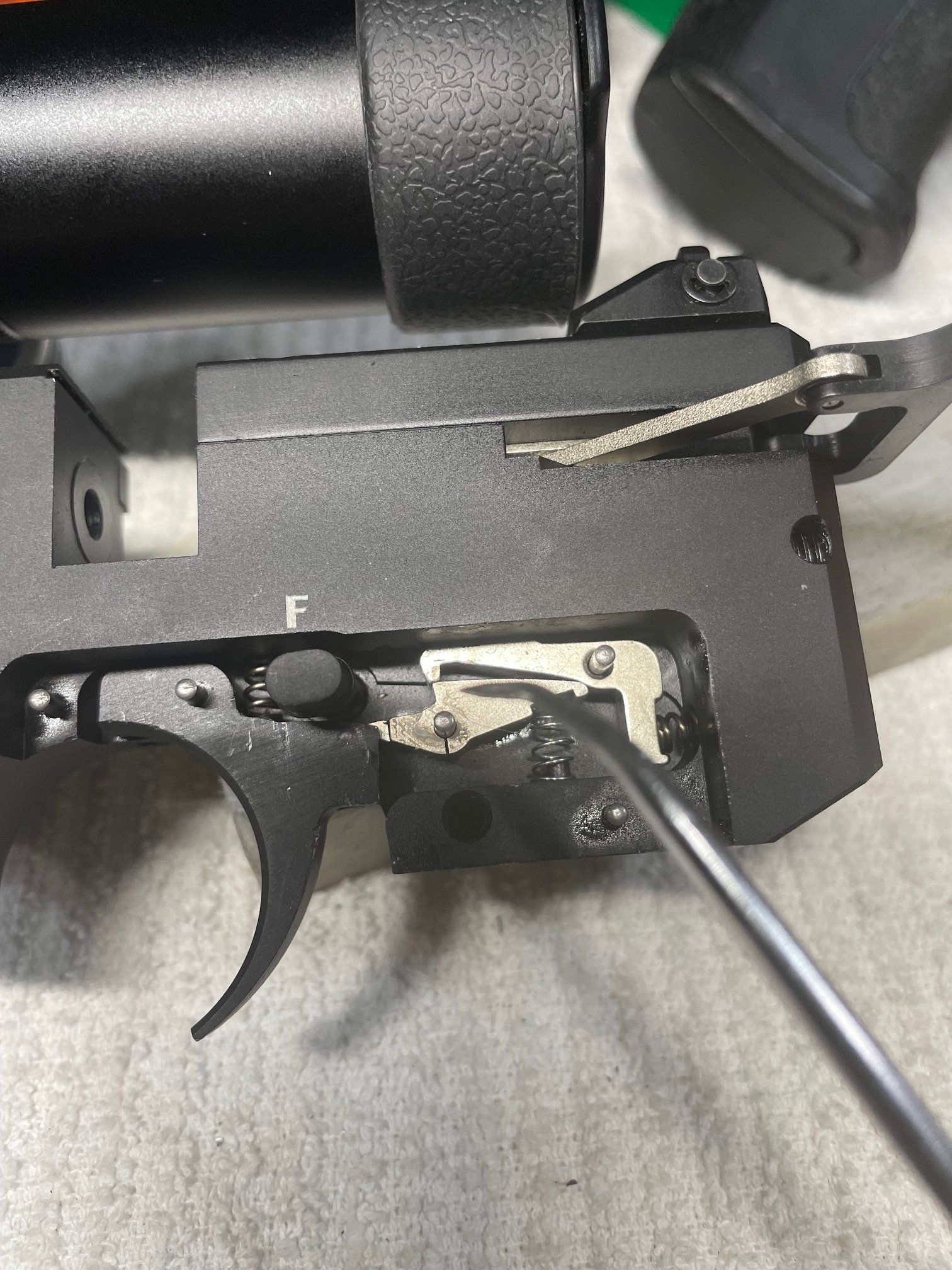

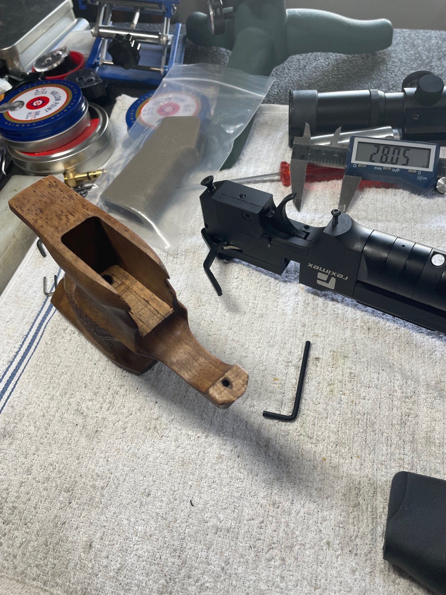

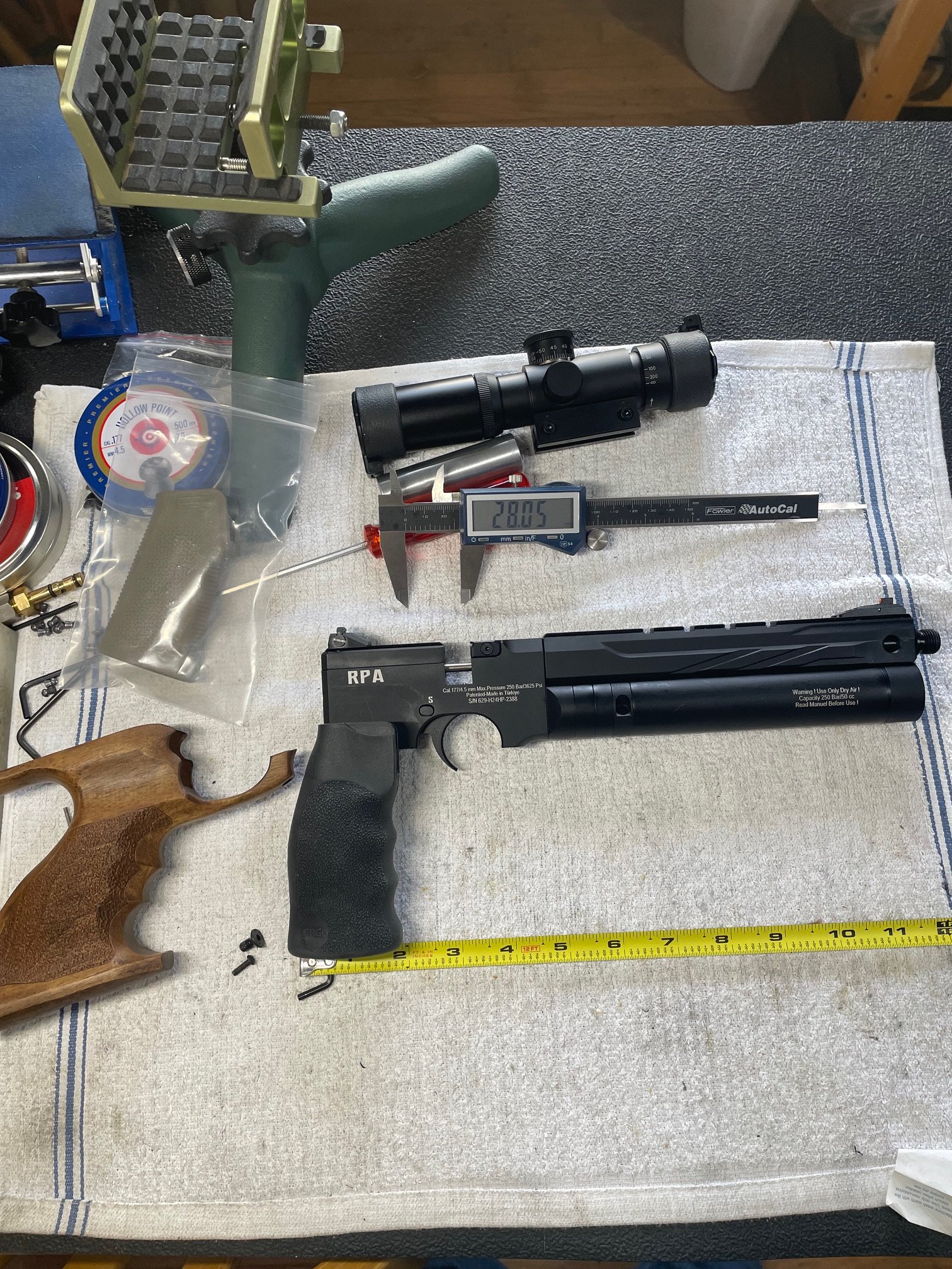

Is there a better way to get the trigger springs than Ebay, Someone said something about a pen spring, Just took a pen apart and spring is 4.2 mm dia, and its plenty long, to make 8mm length, May need another spring for the 15mm spring , anyone else try this ,, I am pretty all thumbs working on guns , but it seems simple,,,
Mike
Yes, I did that first. Was not enough tension for reliable reset on the trigger. I ended up just clipping 1.5 turn off the spring and this gives me about 1.5 lbs. on 1st stage. For the secondary sear, I found just the right spring in one of my carb rebuild kit ( quadra jet). Overall it's breaking under 2#, but I don't like the long creep. I may grind the secondary sear so it drops earlier.

Thanks, I think my silhouette pistol is more elegant, lol.
