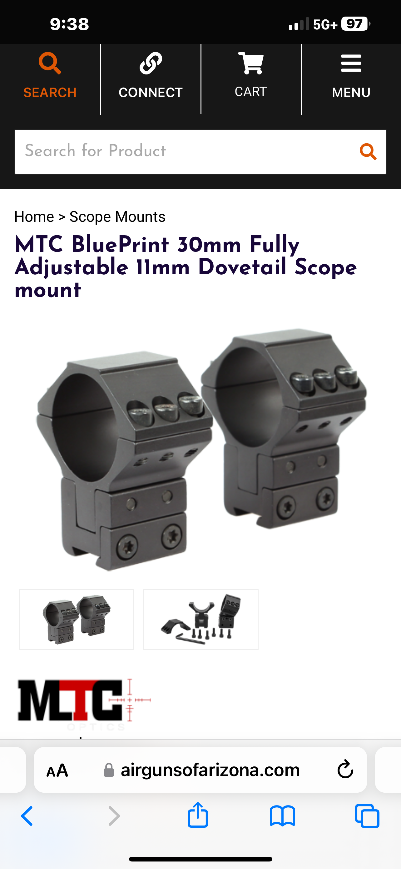

Sportsmatch, Hawke, and BLK usually have good options.
They are highly, but I am using these on my Revere and S200. Both need room for the magazine systems.
