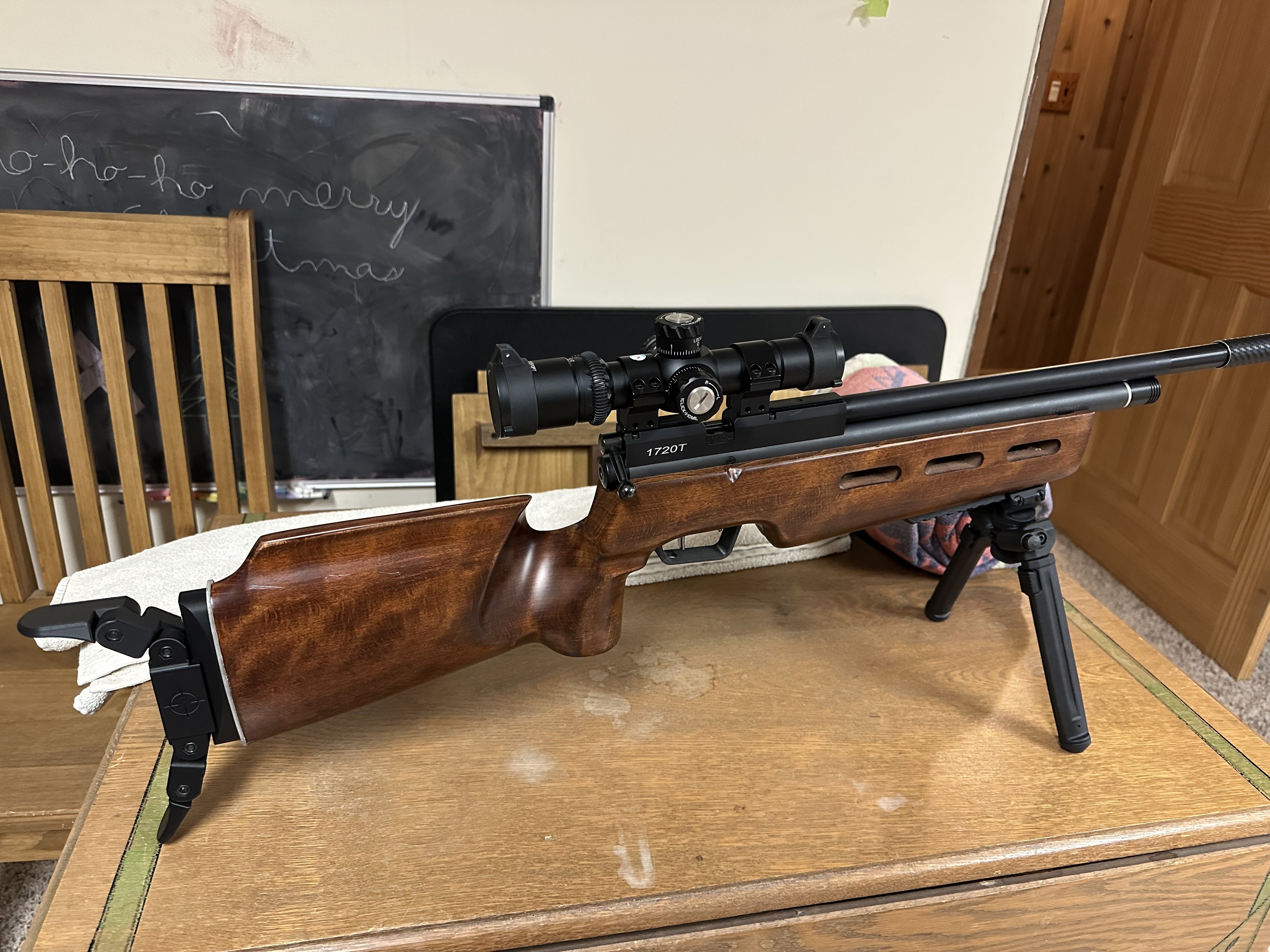

This is a nice one for under $200
Discovery 2-12, side focus illuminated.
