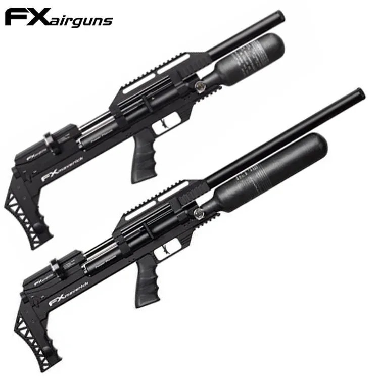

Rock solid barrel, FX Maverick
I think the longer the barrel the easier it would be to bend the shroud. The compacts have a short tube that screws into the frame and would be more rigid. I don't have poi shift on my 600mm barrel. And how could you group all FXs together when the models are so different ?

The shrouded barrels have been used on rimfires for many years. Volquartsen , Kidd , Magnum Research all use them . The main reason is weight savings plus way better accuracy vs a factory 10/22 barrel. I would like to see a carbon moderator shroud vs the aluminum one used on the Maverick.
You can get those shrouds at Bullet Central. I now have one on my Maverick and it really does stiffen things up. Also have the carbon liner, but mine is unglued. Yes you really can pick them up by the end of the barrel and I have seen no real POI poops on it since installing. I can say that I could force a very slight change in POI before by moving the barrel around, but it would have been maybe like 2 clicks on the scope at 35 yards. Oddly, my Wildcat BT I literally moved the barrel til it hit the tank and the POI on that did not move one iota.
What length barrel? Just curious, I've got 3 different barrels from compact to Sniper, haven't had any real issues but, heck it's fun playing in the Rabbit Hole® These shrouds look stiff as heck.
I know a lot of people are scared to bump their barrels in fear of a POI shift. However I did some testing today with my .30 Maverick and even after grabbing the gun by the end of the barrel and shaking it violently in between shots it still held it's POI Grouping. Mods done recently include epoxying the carbon sleeve to the liner, installing a bullet central tensioning kit, and installing a black arts design bottle/barrel band. I think the barrel band definitely has the largest impact. This is a very good quality product and the owner even sent me an extra fastener after I dropped one and lost it. Now I'm not so worried about POI shifts day to day or after I bump into something. Just thought I would share.
