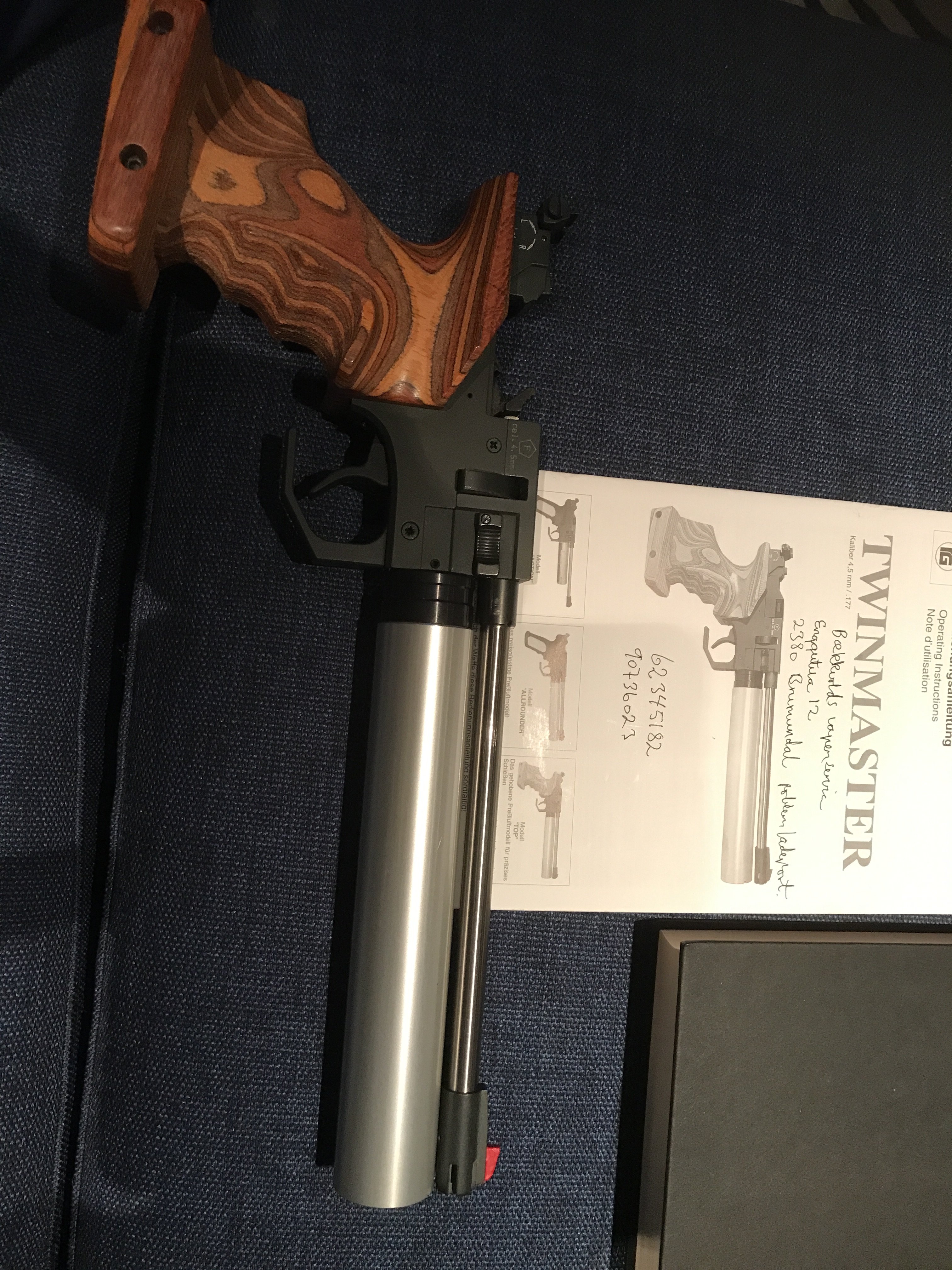

Hi!
Bought this without doing my homework. It’s a 2001 produced Twinmaster PCP, but even if it is (claimed to be) barely used, the cylinder should have been replaced many years ago. I have searched high and low (worldwide), but no help out there.
It seems that there is no after market for spare parts for this gun, at least I am not able to track any.
So I take a shot here:
Anyone know who to contact?
Or if there is a way around this, a converter or something that could be used for an alternative cylinder?

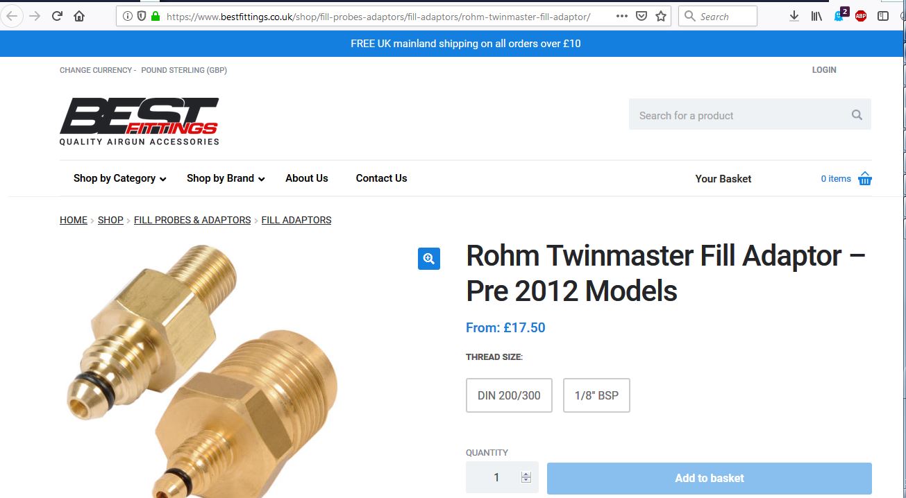

Will test the hand pump solution. Awaiting a new fill probe from Best Fittings. UK

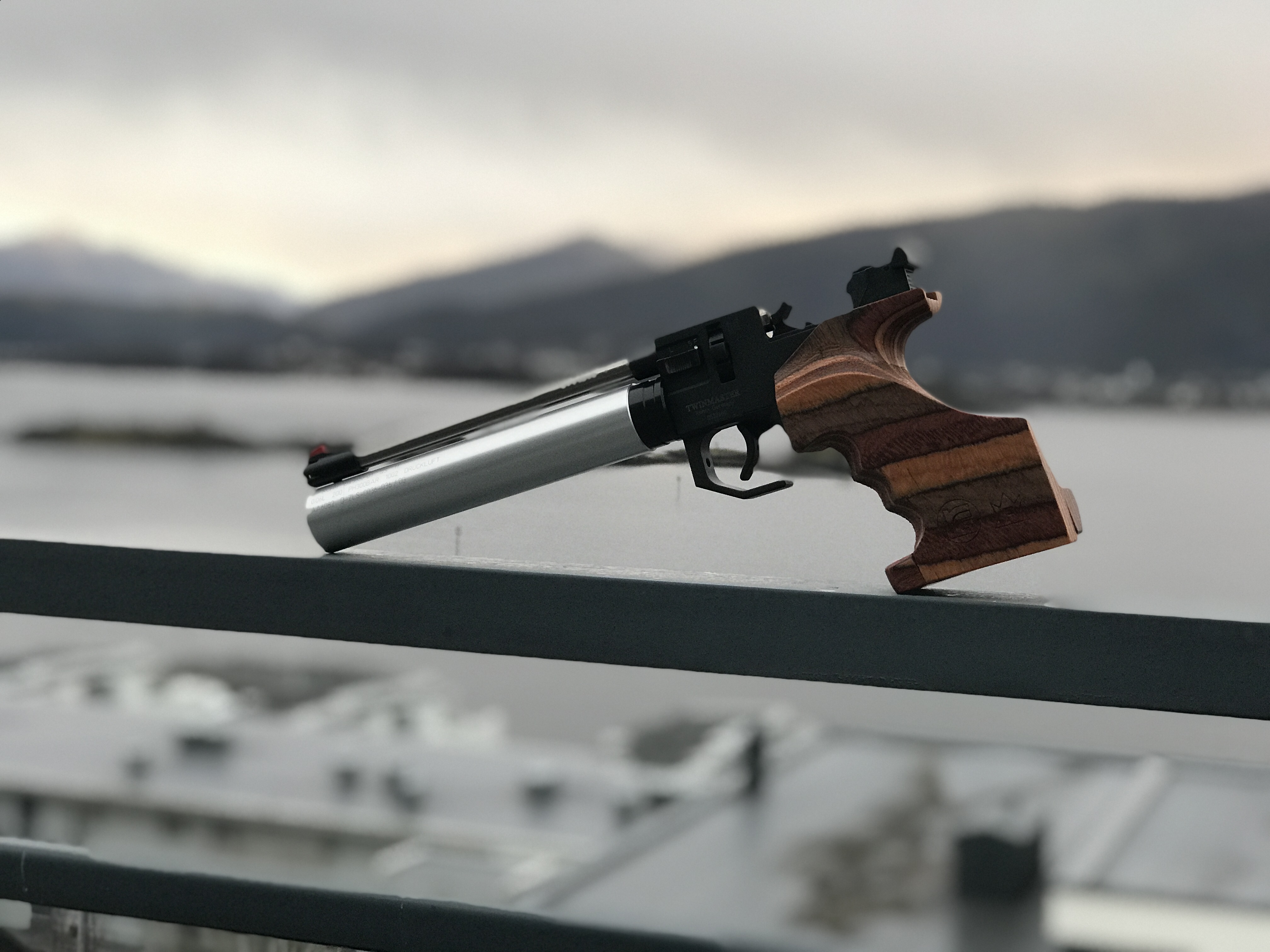

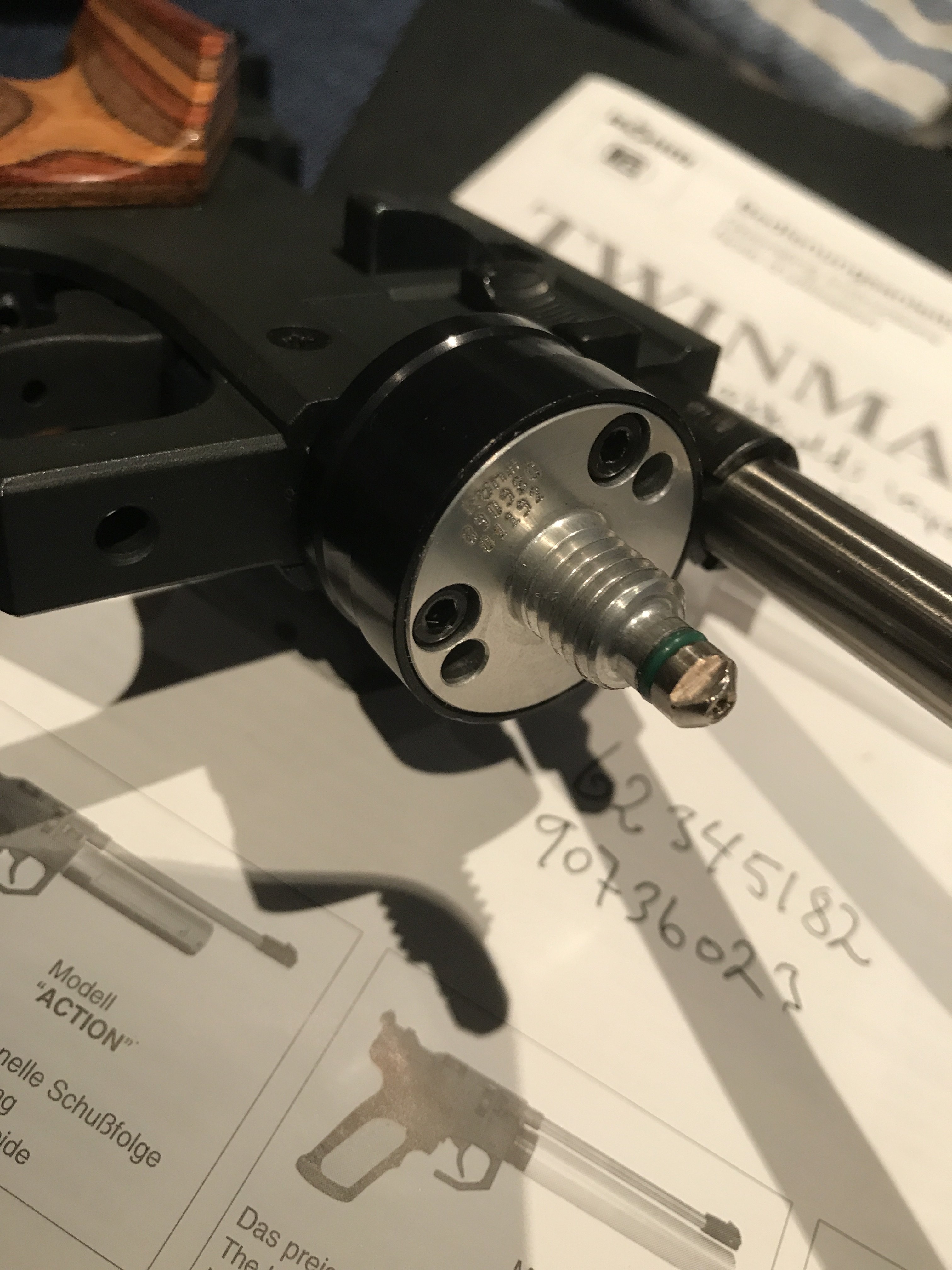

The correct fill probe came in earlier today, and I filled the Twinmaster to about 175 bar. After running 4 mags through it, I am very satisfied. The pistol works flawlessly, and cycles the magazines perfectly. And the precision seems to be good to. The single and double action choices are very appreciated. Suddenly I feel good about this buy. 😎

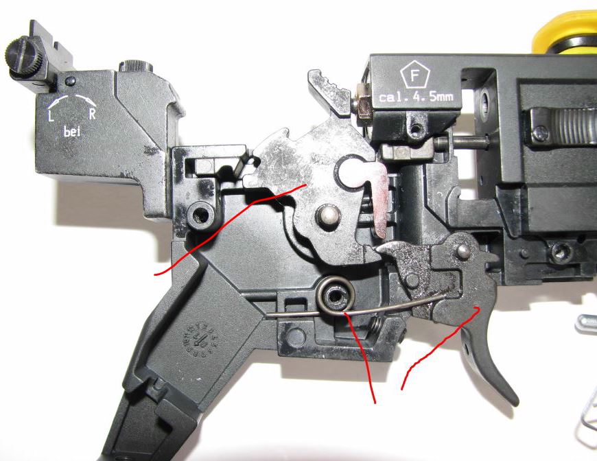

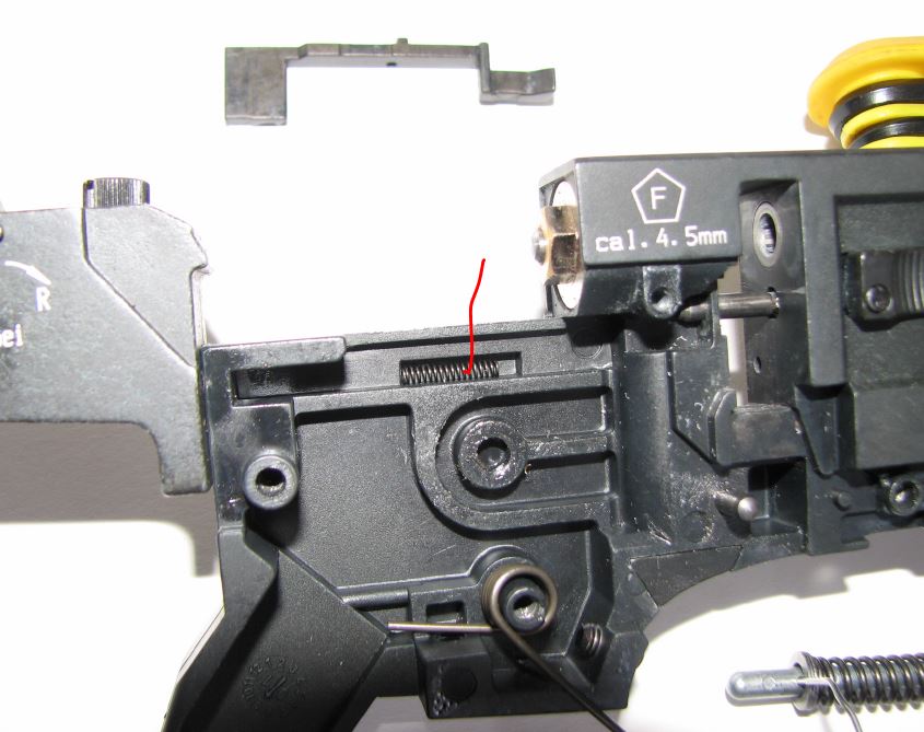

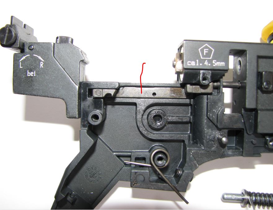

I have lots of picture of the internals (will find and post later), basically the same as a S&W PB, I was so impressed by the design and finish that I had to buy 2 more after the first impression

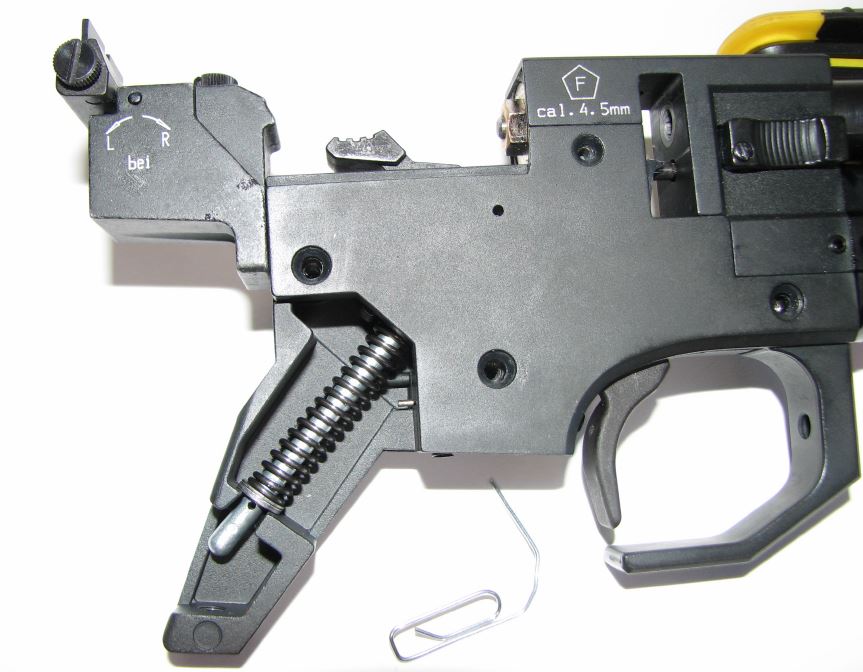

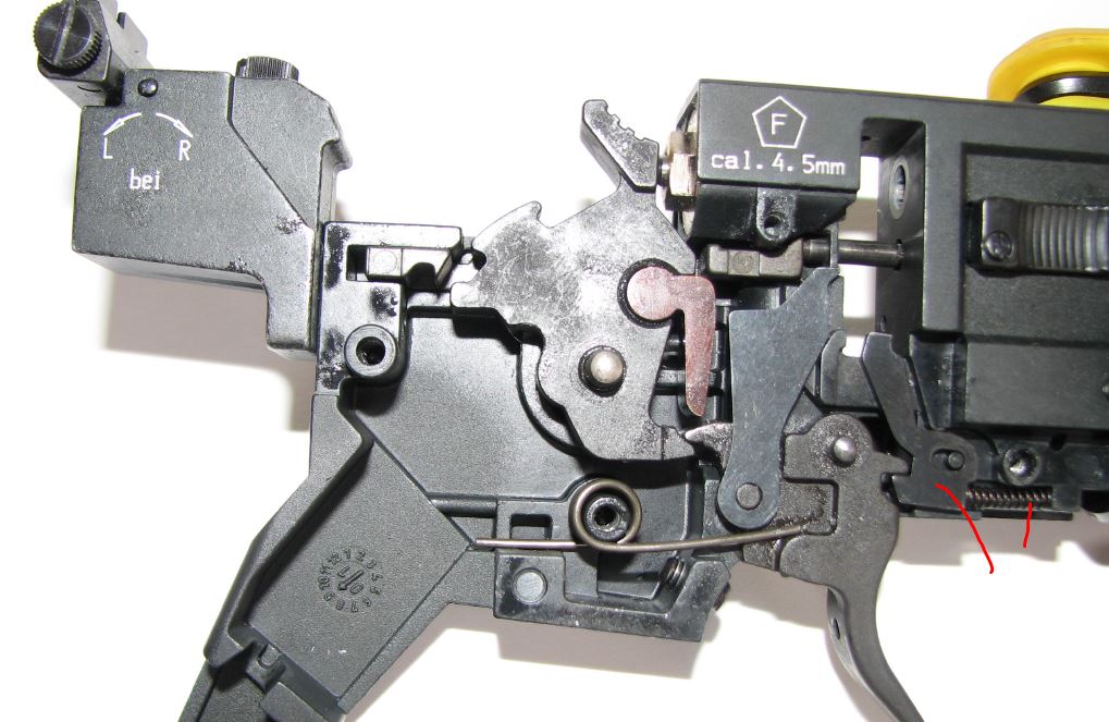

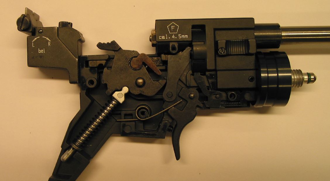

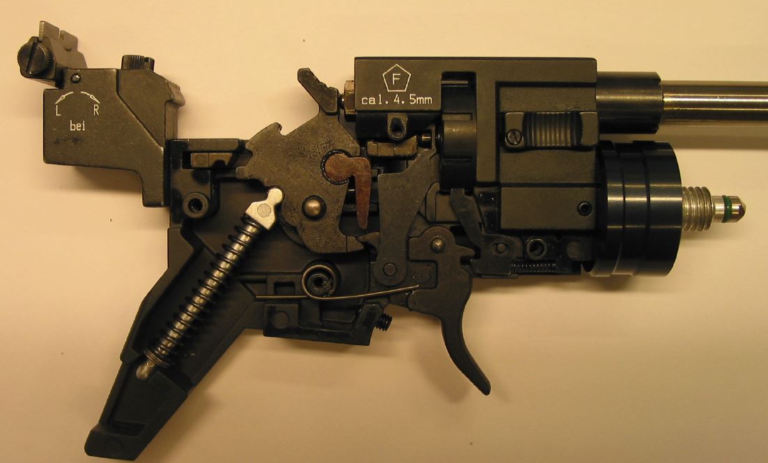

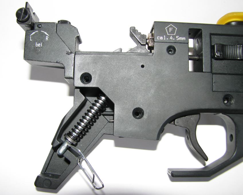

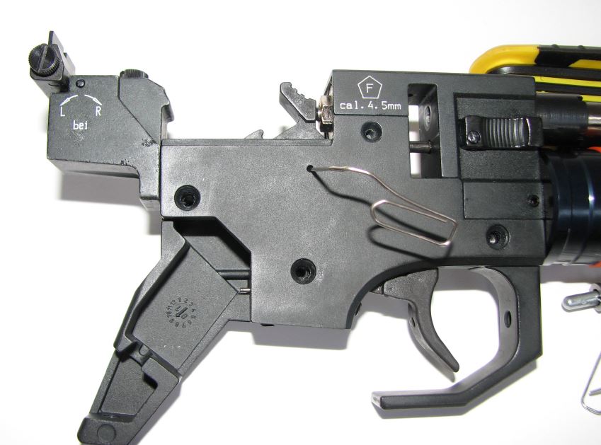

Pictures from takedown, a paper clip is your friend

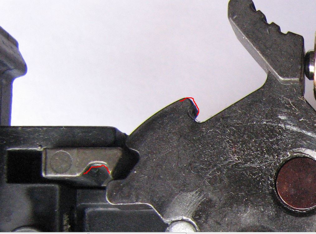

The action in single action

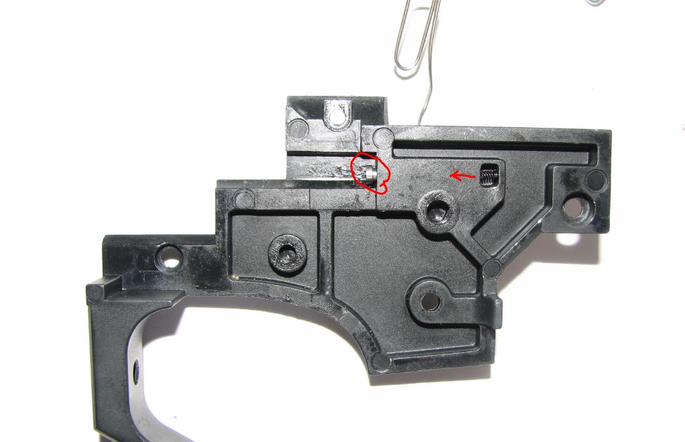

Dry fire notch

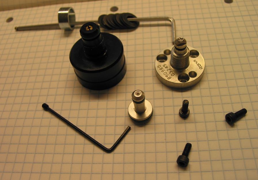

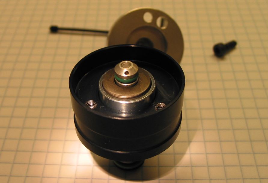

Regulator

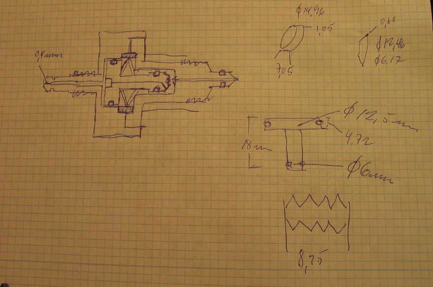

My notes

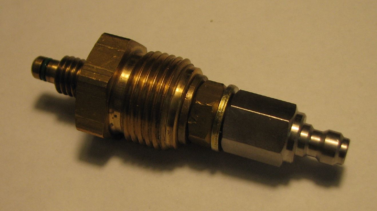

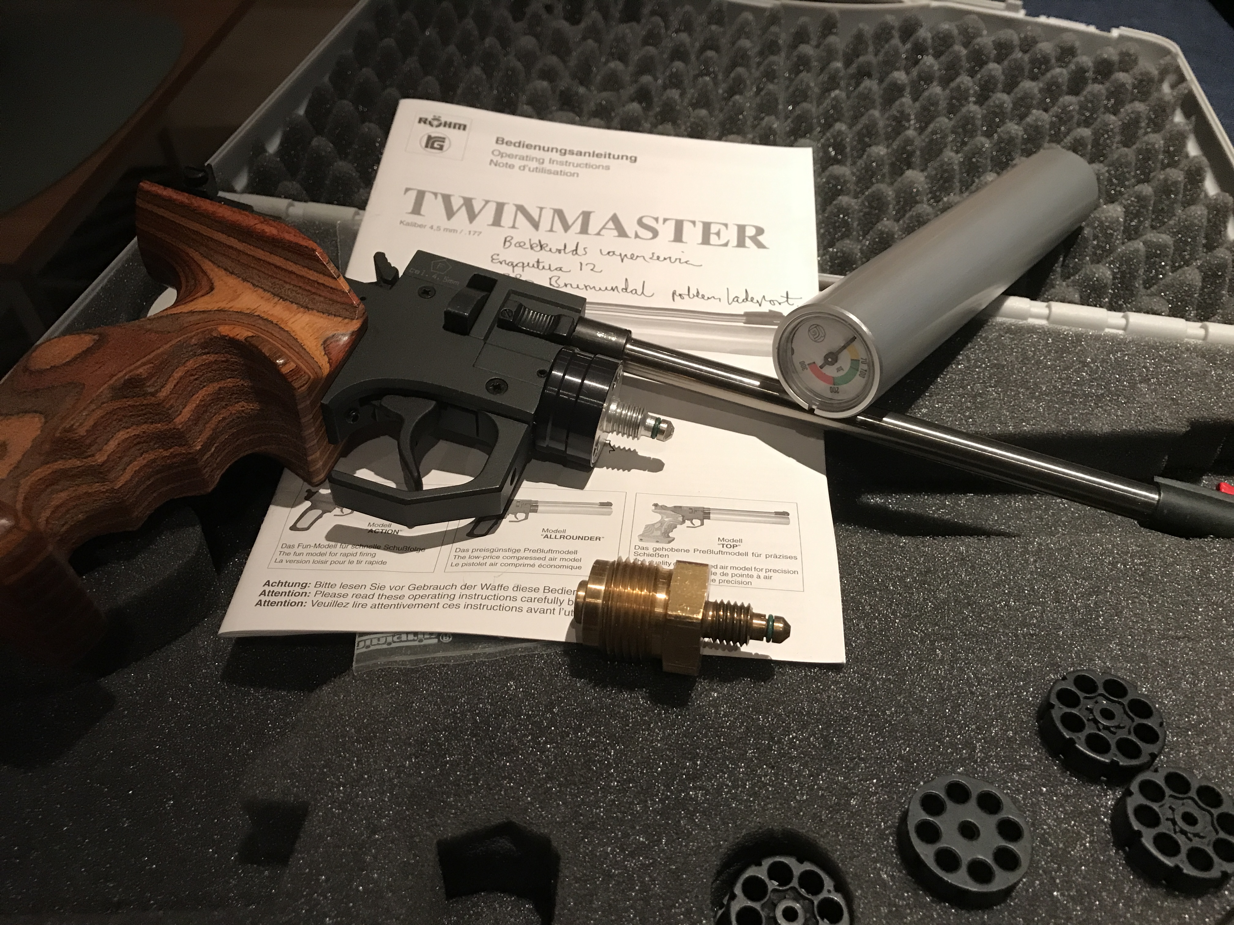

Fill probes
Original fill probe modified for foster coupling

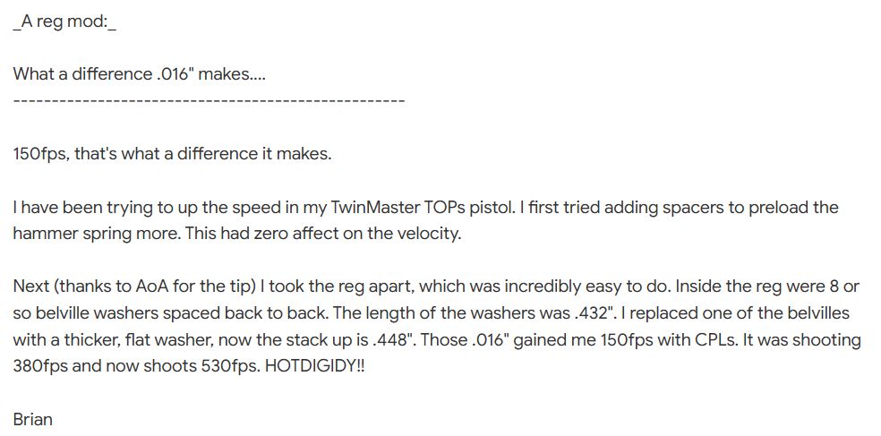

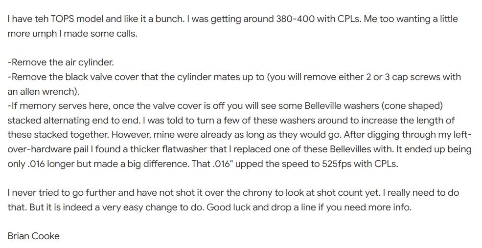

Screenshot of mods I picked up from another site

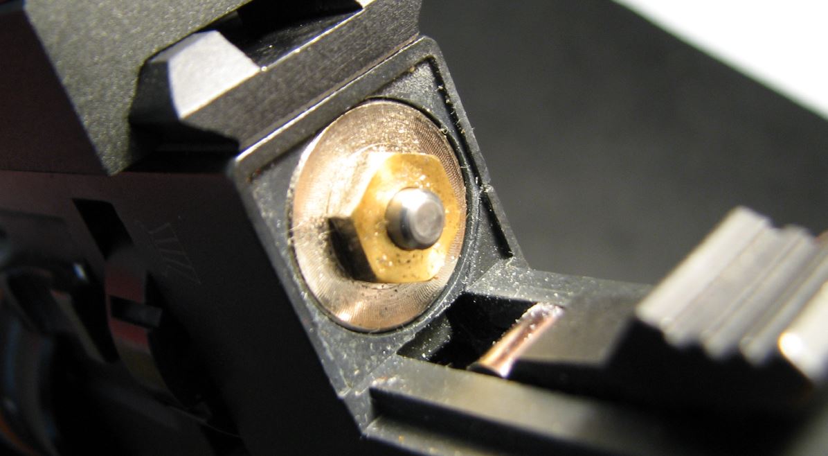

My memory was wrong, did not flip one of the belleville washers but replaced one with a thicker one, also removed a small amount of material from the valve housing face, this allows the valve stem to go deeper for added air flow
