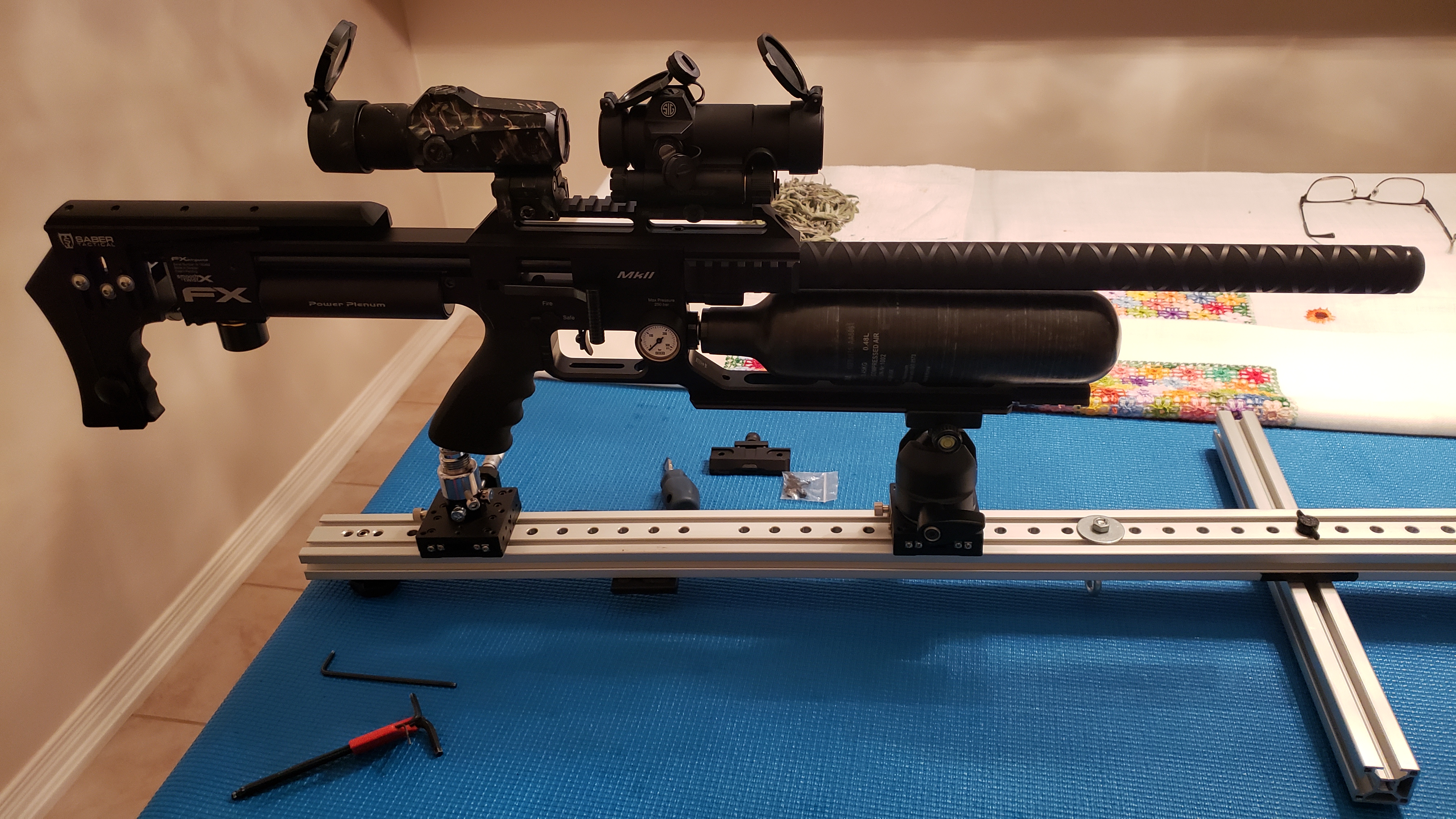

A first problem I had was the height of the red dot and the height of the magnifier was not a same centerline... to center the dot in the magnifier I needed the elevation screw to very end of a travel. Neither of the original boxes had a shim or a bracket solution to level the two optics together.

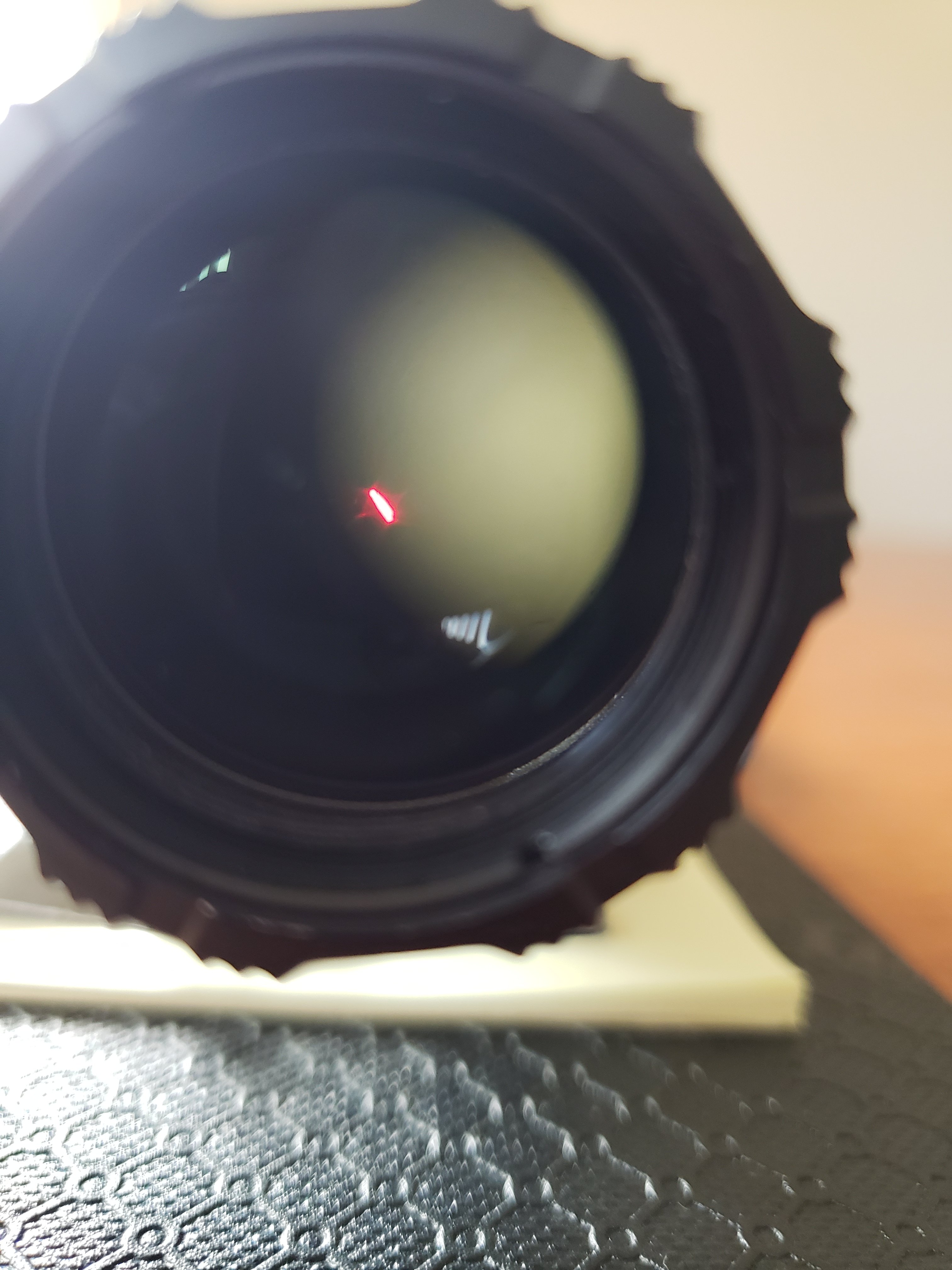

The second problem was the optical coating on the red dot lens... resulting not having a dot but a little line, which got magnified x6.

Here is the picture from a dot that is not a dot, also the next picture will be self explanatory:
Romeo7 + Juliet6 mounted on my Impact (Aug.2020)
