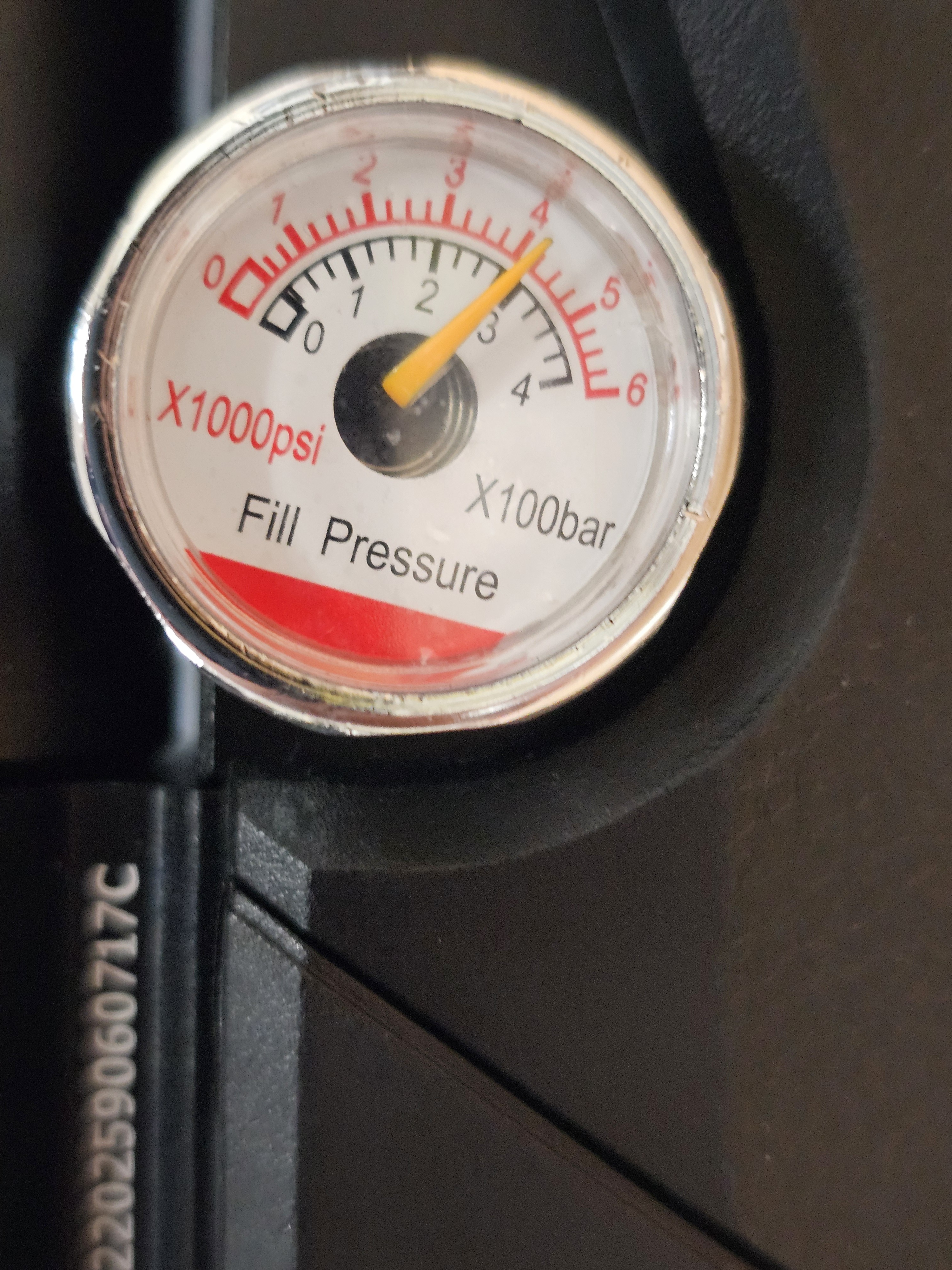

Air Pressure was kept 3000 psi or higher throughout. This setup was made using "high" power. It was averaging over 950 fps. While there was only about 2.8 fps SD it seems pretty fast. The next run will be tried on low power.
The weather was 75-degrees Fahrenheit with about 90% humidity. There was a slight 0 to 5 mph wind. It varied in direction but was largely a cross wind.

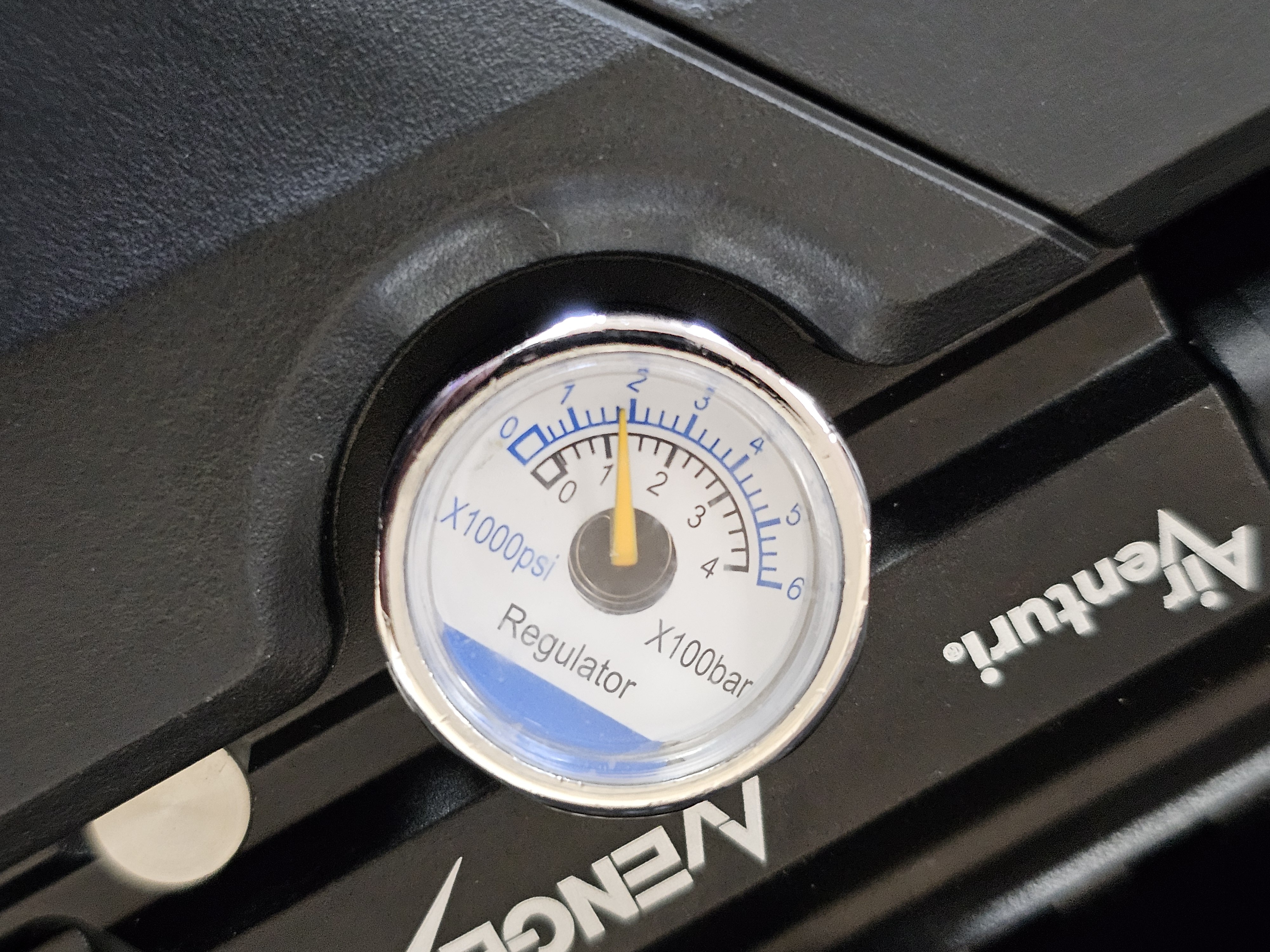

The rifle is stock, and there are no tweaks to the gun. The bottle started the day at full capacity. I took a couple of shots to sight in the rifle. The shots all remained on the regulator. The rifle was kept with a total pressure of 3000 psi or higher. The regular remained just under 2000 psi.

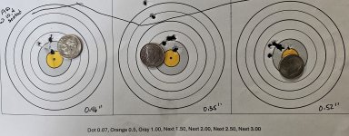

The best shooting was the Benjamin 10.5 match which were consistently under one inch at 50-yards. Several pellets showed potential so it may be that pellet sorting and preparation might make several pellet options viable.
Average muzzle velocity with AA 10.3’s on the high setting was 953.4 with a SD of 1.8 fps (excluding 1st 2 to level regulator). Extreme Spread was 5.8 fps. One low setting was 827.3 with an SD of about 1.3 fps.

I was out shooting part 2 today using the low setting. The performance I had today on low setting was very encouraging at 50-yards. Small SD's were there. I have one setting that was shooting 0.50" at 50-yards. There were 2 groups under .50" and 2 just over .50".

I am getting at, or a little under, 0.50" at 50-yards with a gun shooting at 1.5 to 2 SD in fps in .177. It is running at about 820fps with 10.3's. How much better is it likely to get in .177?
If your .177 is shooting that, Leave It Alone!
I fought mine in.177, in the end never got those kind groups that far out.. Now in .22 and .25 I am getting stellar results..
