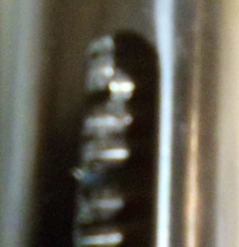

As I remember, when you take the action off the stock, you should be able to partially inspect the main spring through the cocking slot. You might be able to get a glimpse of the broken spring (probably towards the bottom of the spring guide)

chances are , broken spring, at the rear about two coils up..
Pull it apart and see... No point grinding away making whatever it is worse worrying about it .
Like here just pulling the stock you can see the broke spring , but with a compressor and a few hand tools total disassembly is a few minutes to inspect it all.. you may just find a good cleanup and fresh prooer moly relube is sll you need in a older gun.. ( maybe a new piston seal for good measure wile your there)
