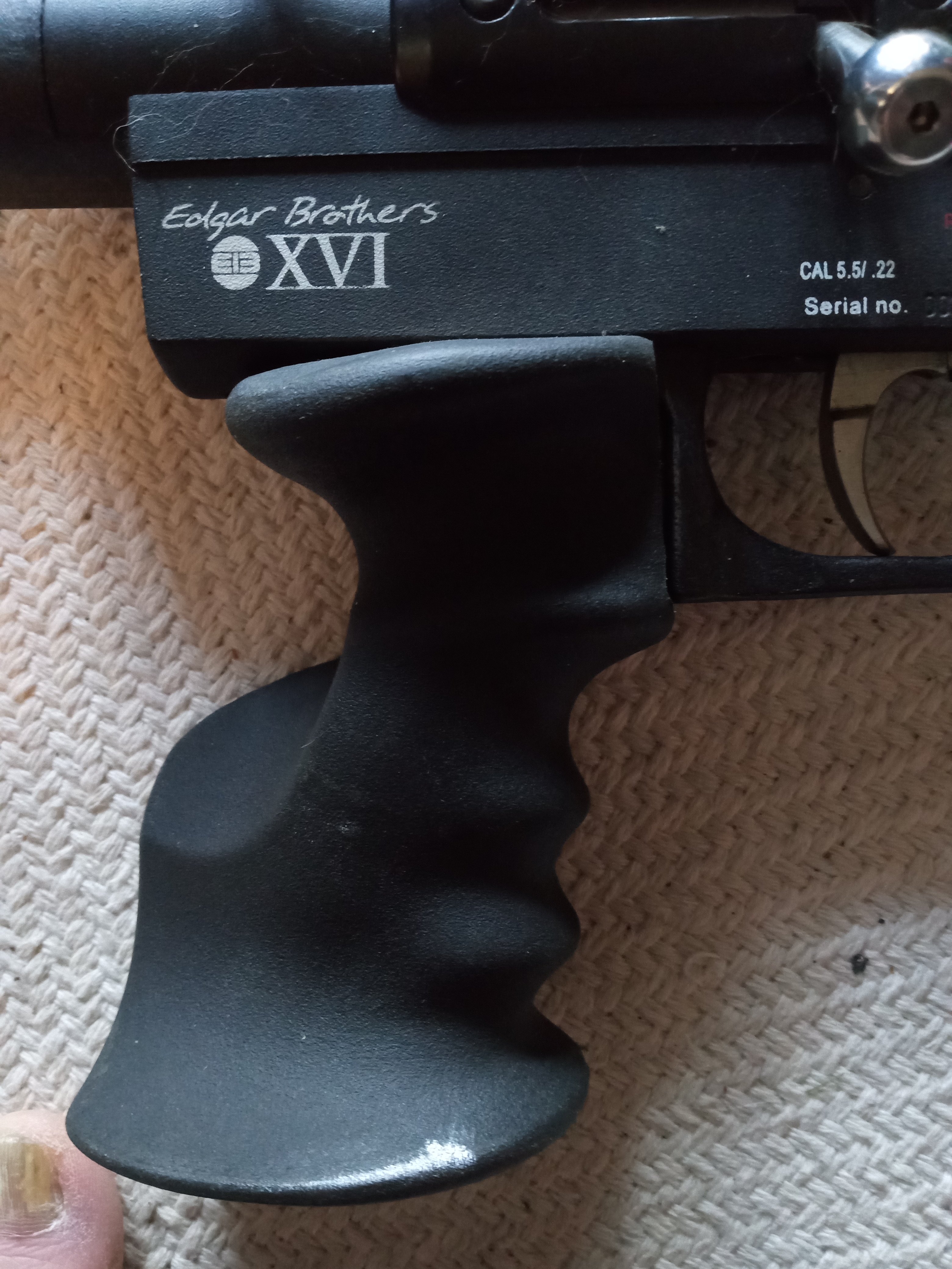

Today, I took the RA grip off the EB XVI and got pictures. This was a really straight forword modification with just a bit of grinding to fit.
The bolt that comes with the grip worked perfectly as the EB XVI has a true AR style mount.
I'd doubt there's many of the EB XVI's in the Colonies as they were never mass imported but other versions of the Logans were.

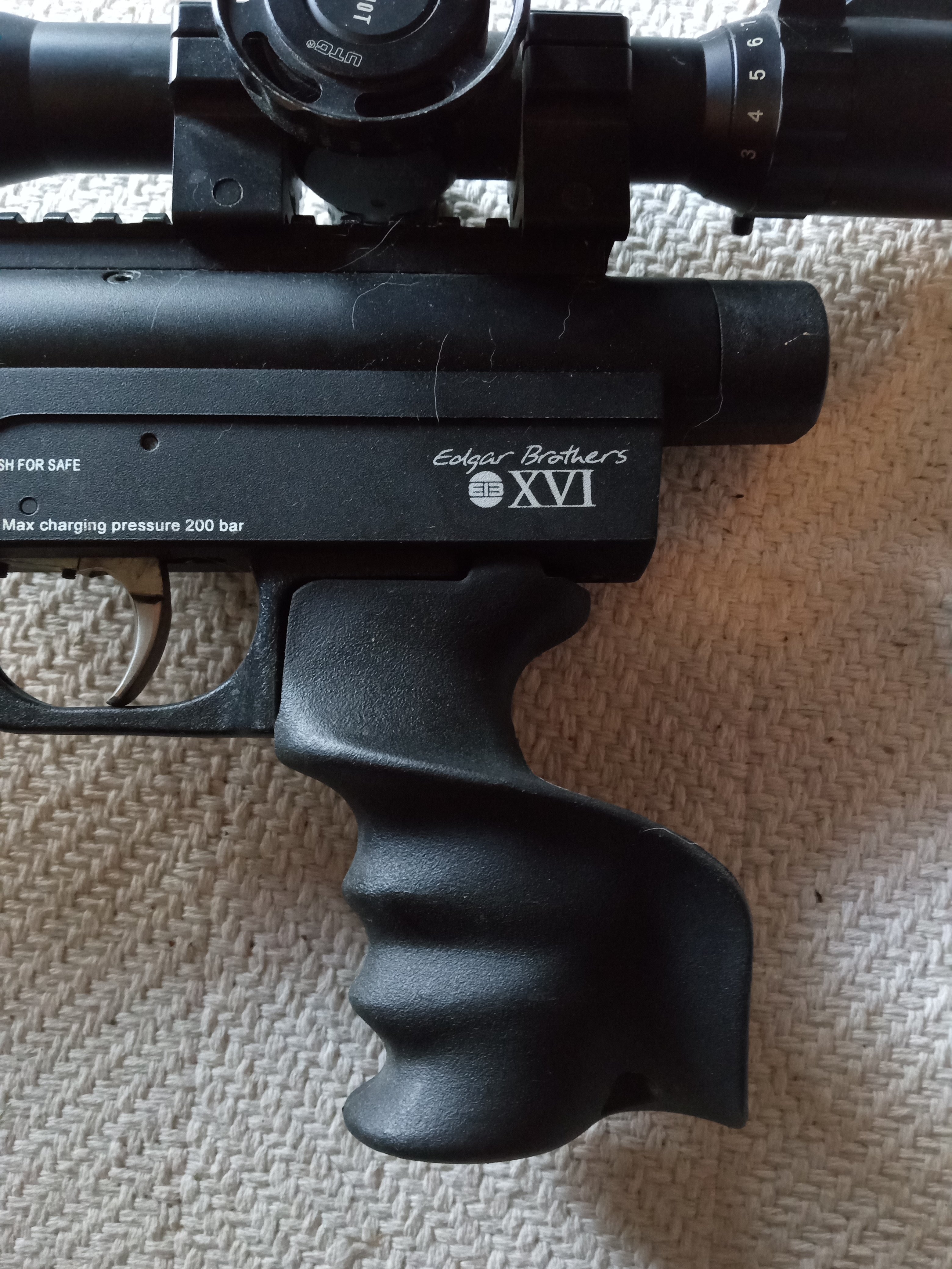

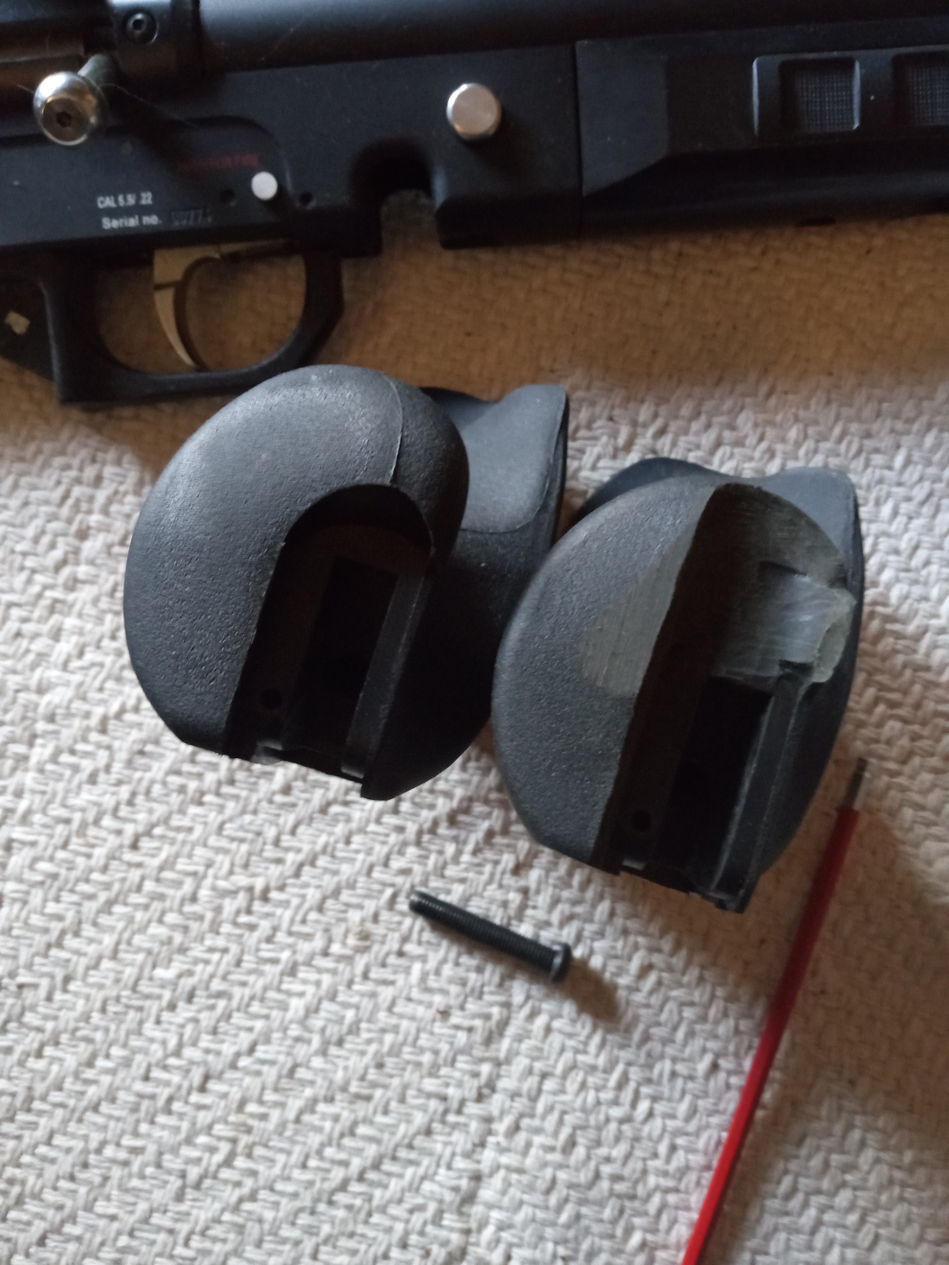

This is a brand new RA grip next to the modified one on the XVI.
Only some rounding near the top and a bit of a notch was needed. I use a ball end 5/32" Allen for the bolt.

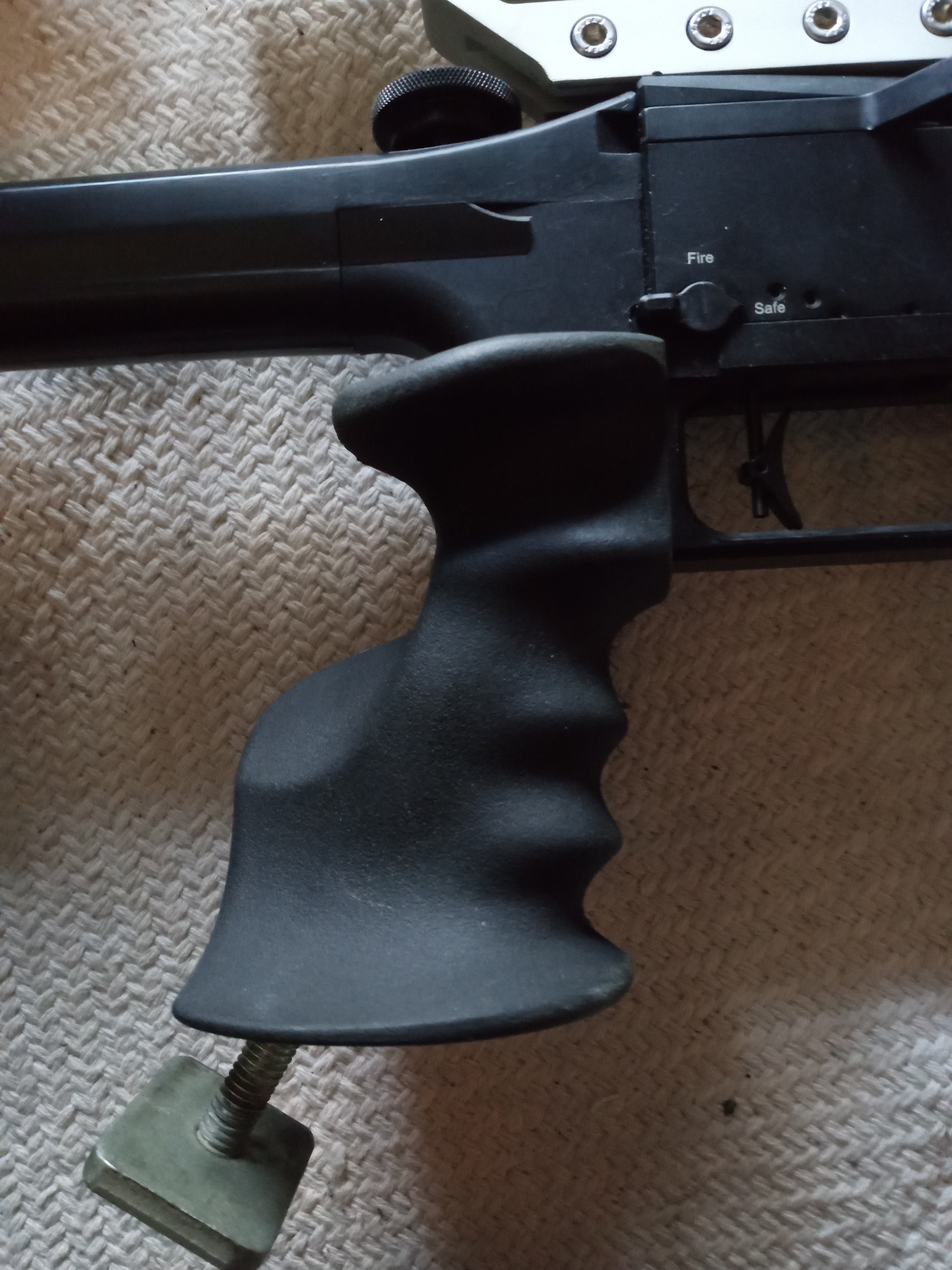

Let's look at the FX Dreamline Lite.

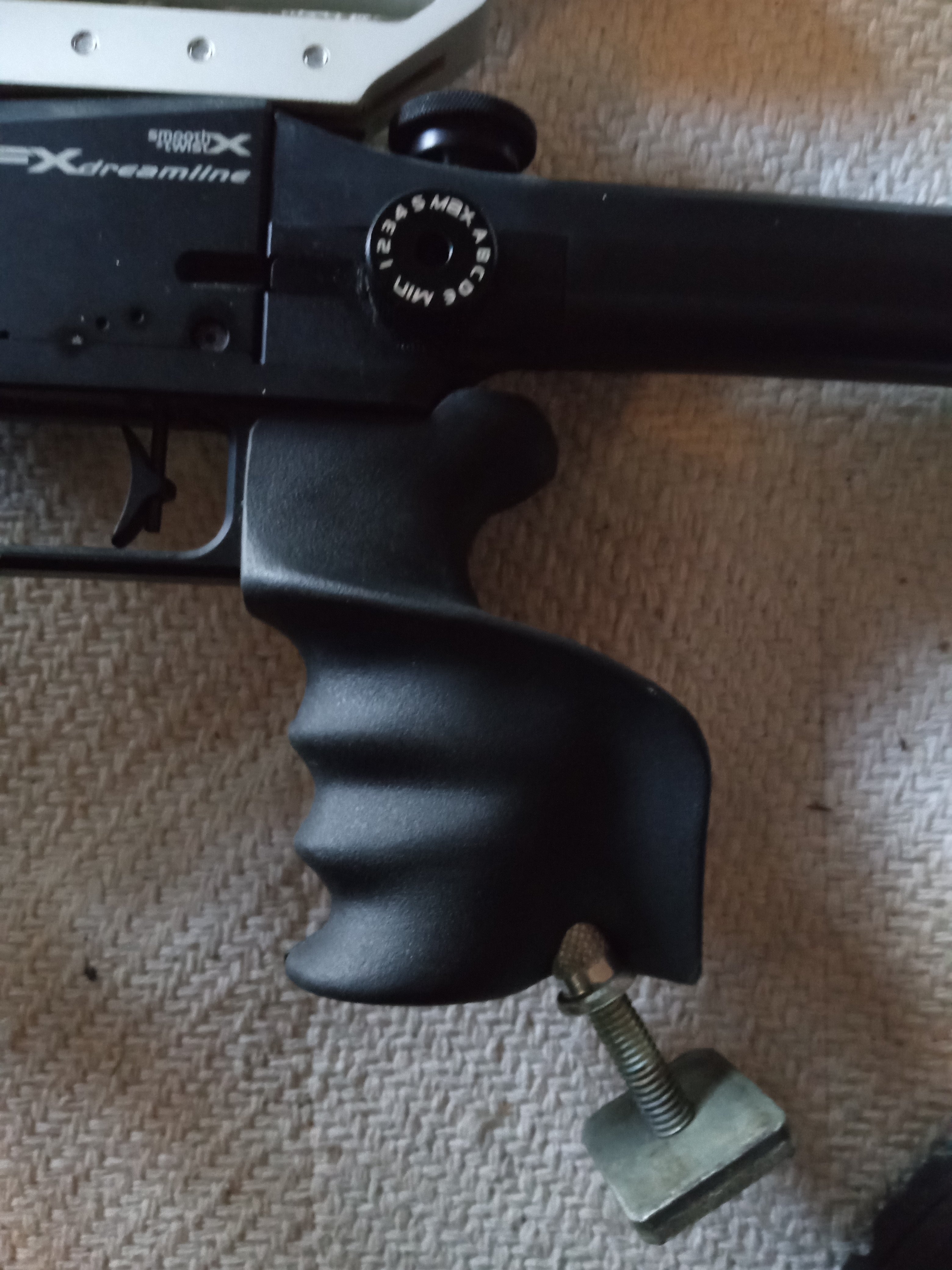

Now the FX grip next to the stock RA grip.
You'll need a bolt to fit the FX as the bolt with the RA Grip won't work. Metric compared to Us that hate metric. :LOL:
A little grinding but really not that much! Notice the rounded area. That's for the DreamLine Lite safety to work.
I've changed to the Classic style safety lever as It's much easier to use but that's personal choice.
The parts I used for that crude adjustable part you see were spare parts around the shop. Not pretty but free and works for me.
