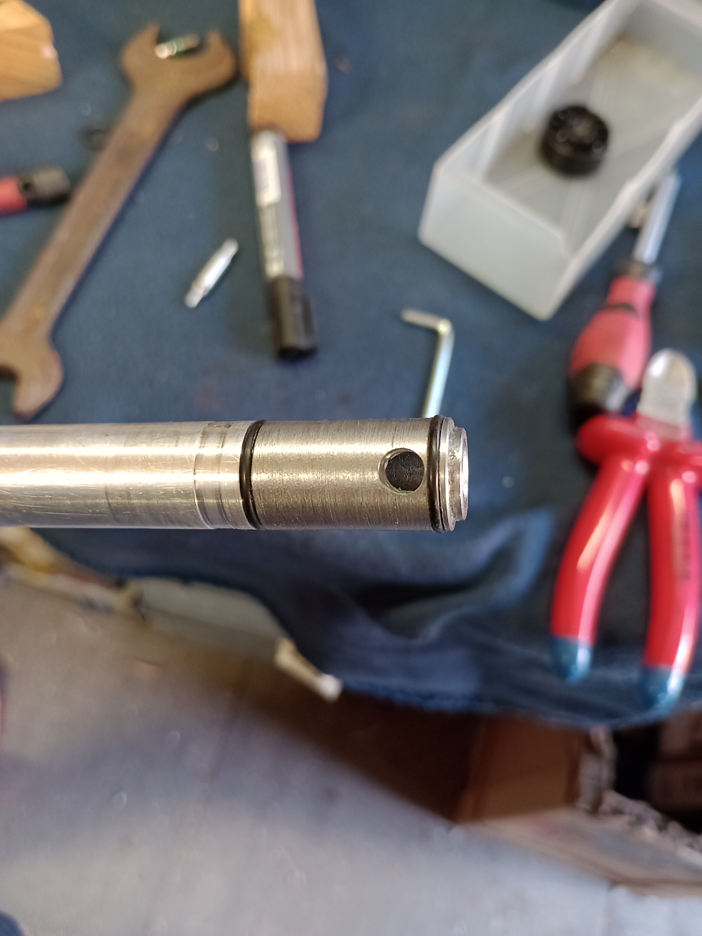

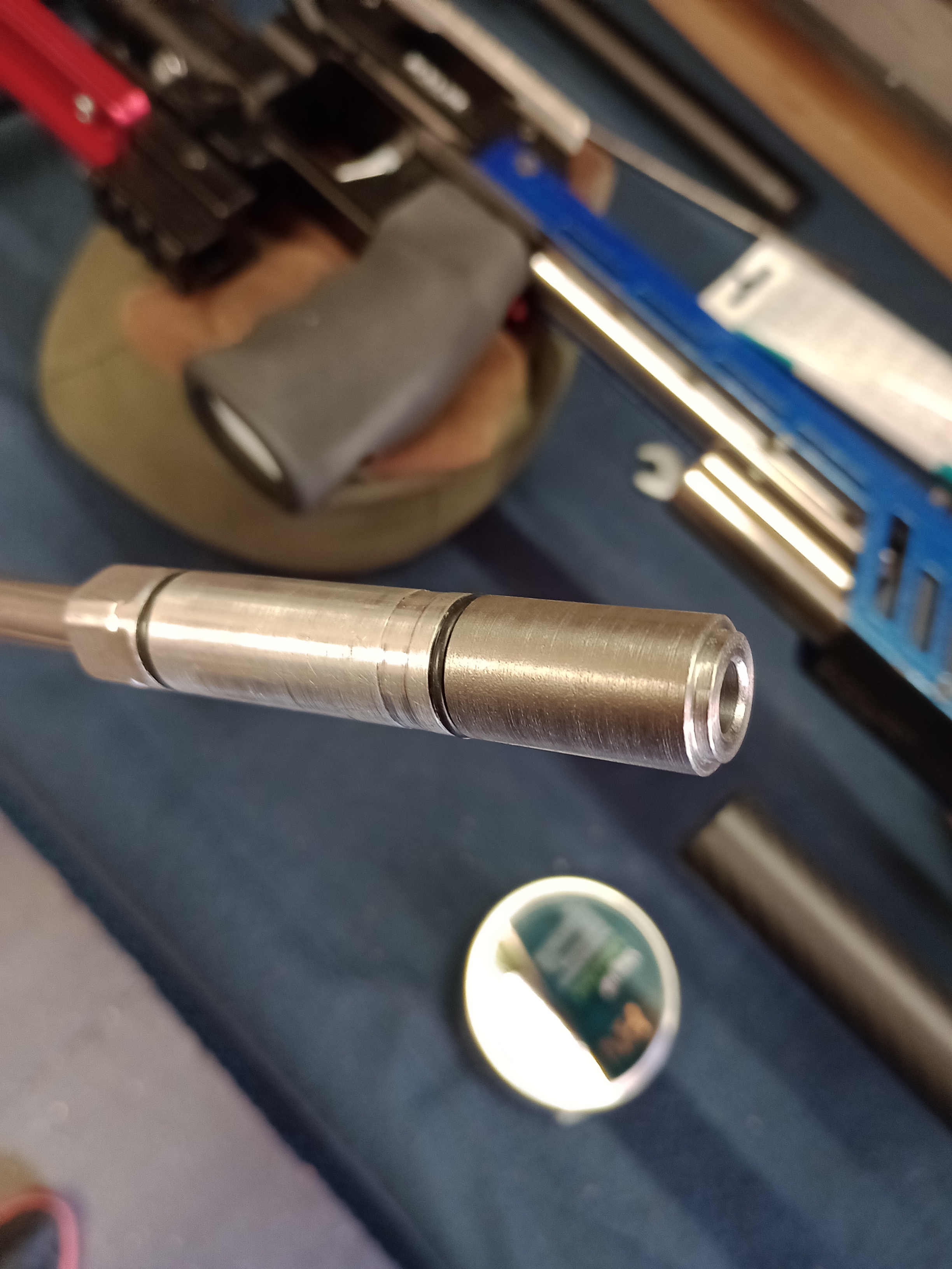

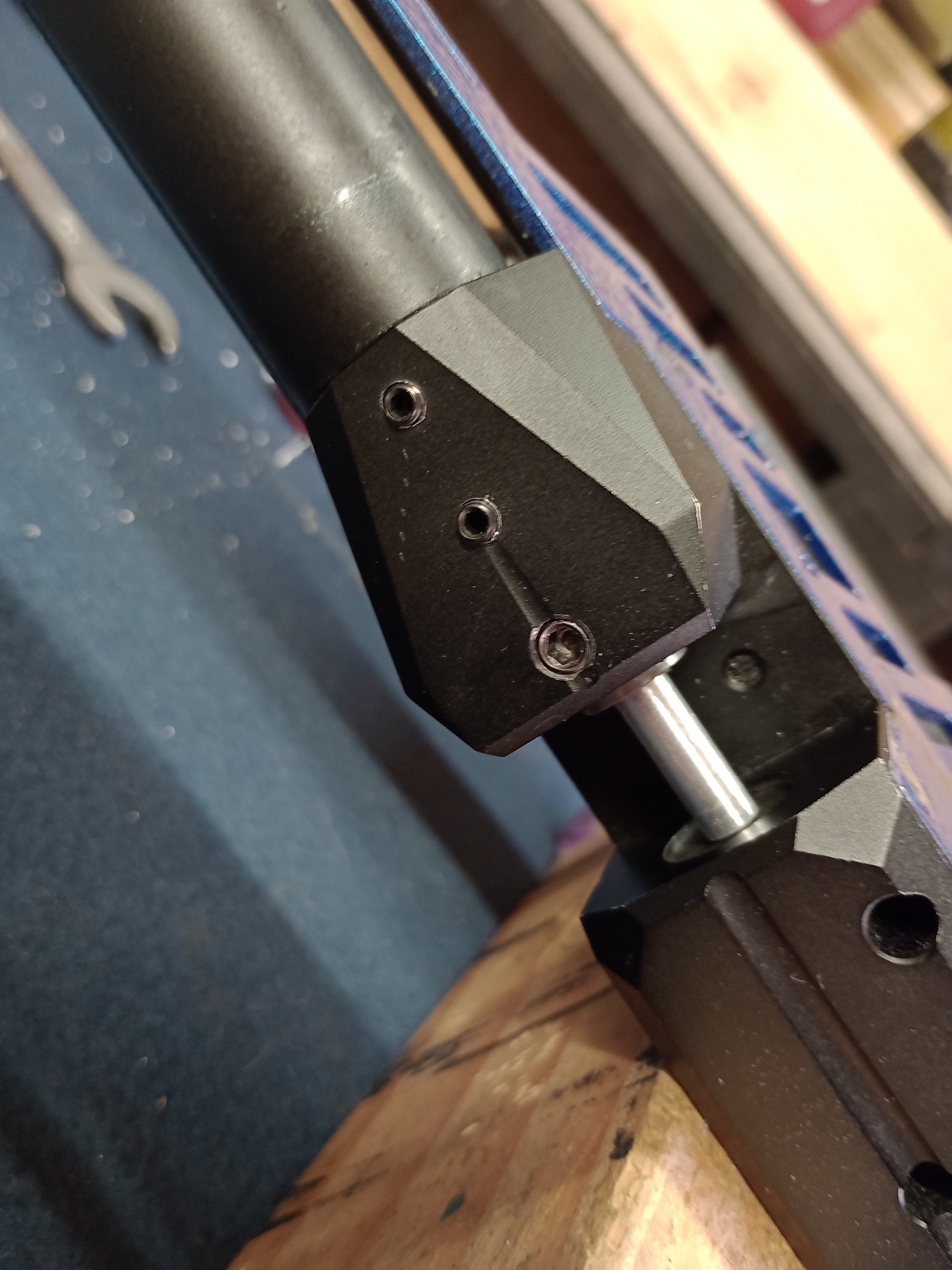

I had to make a new chamber because the original tp from FX is huge with a tiny bit of material in the middle… that was knackerd:cautious:.. so i made a new one from a piece of .177 barrel i had lying around and got the same speed just bij drilling a 5mm hole… just like the P3 i drilled and tapped 2 additional set screws.. for the fun of it!
So tomorrow we know if this payd off! (The hole looks like ik was attacked bij a rabbit with rabies:LOL:
But we smoothed this afterwards!

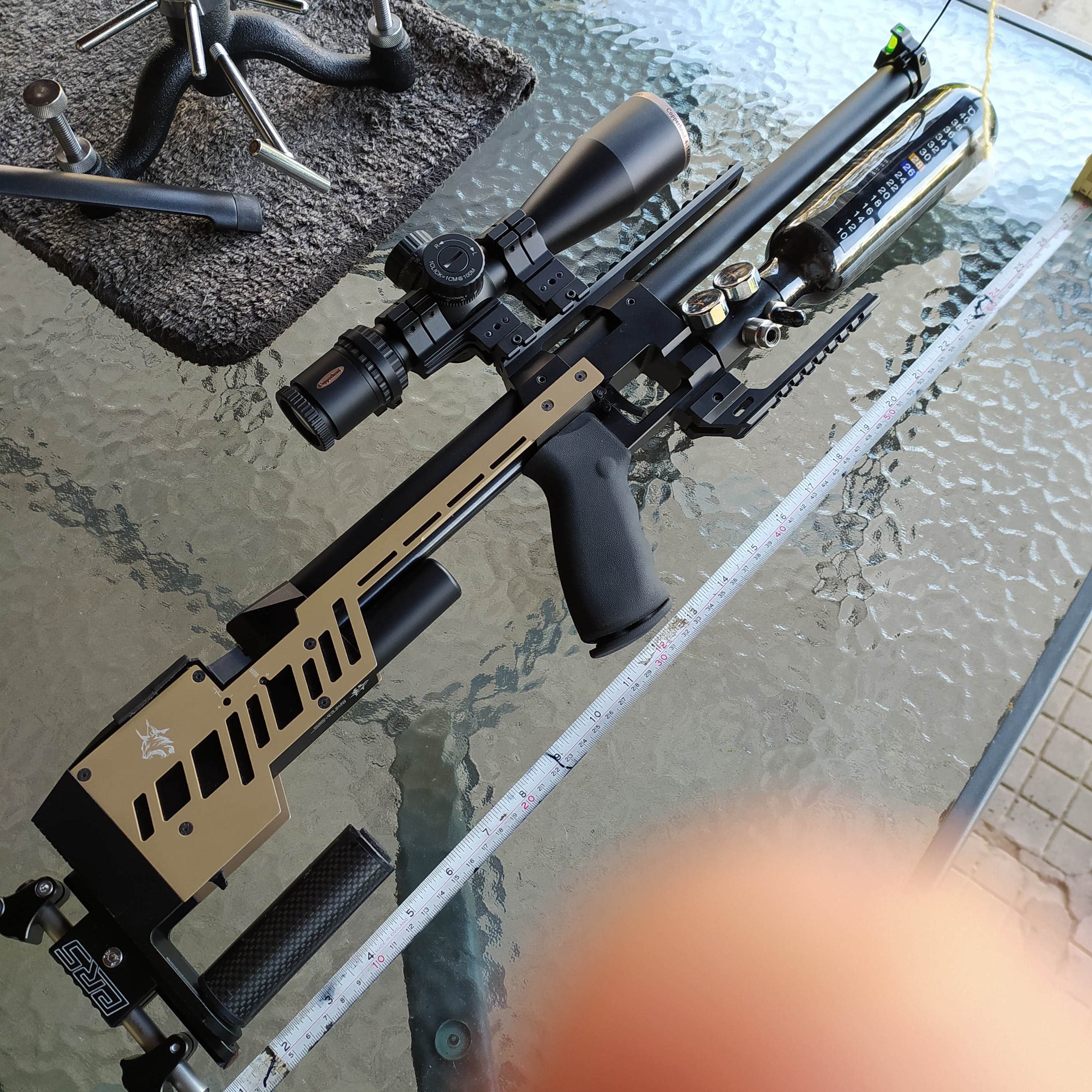

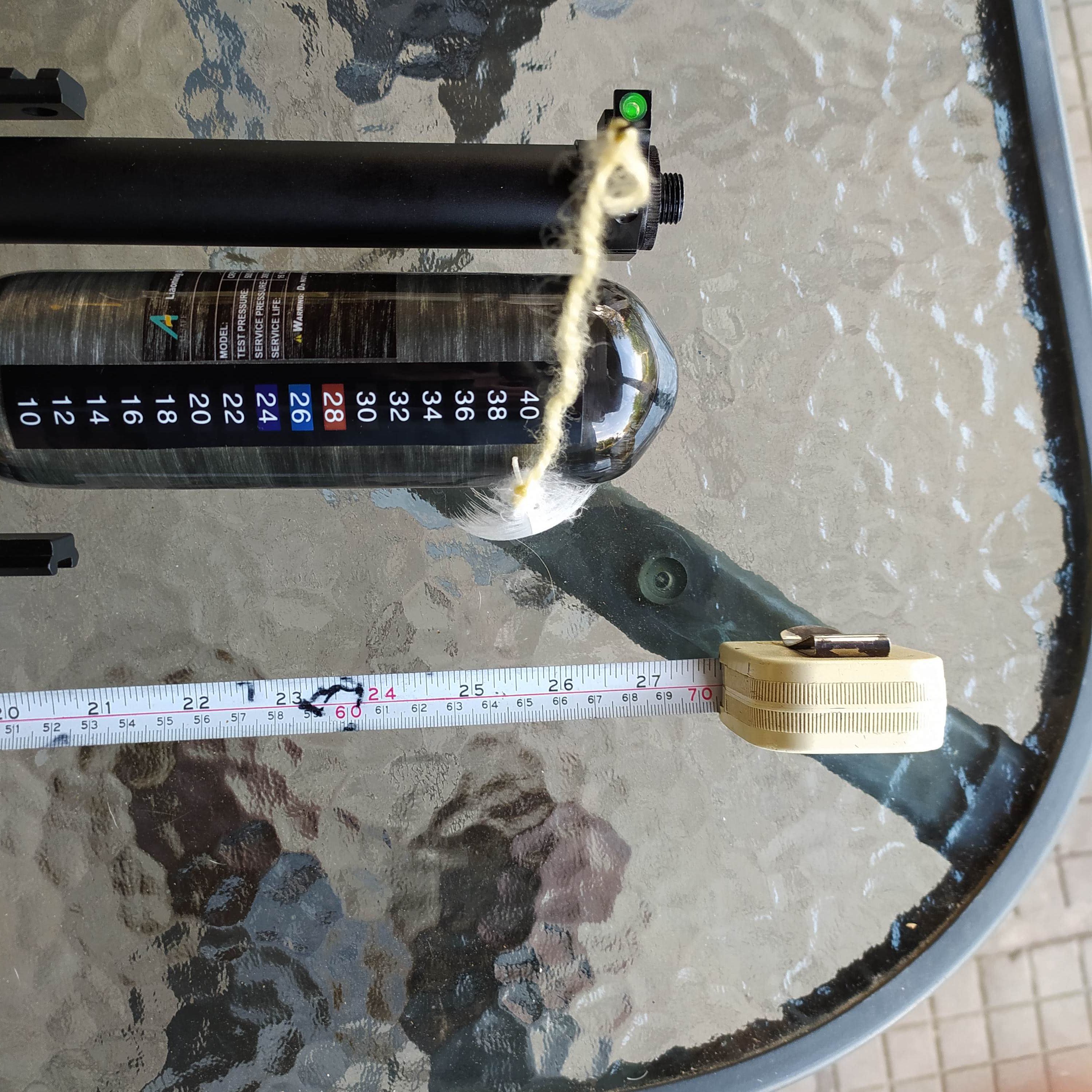

Just this afternoon, set up a prophet in compact format.
510mm .177 barrel, shooting well at 18.5 ft lbs with Zan and JSB heavies. 10gr.
Tomorrow we will have a walk in the woods 😉.
It's light, compact and a delight to shoot off hand.
Just for you, Trilav.

O man, it almost looks like mine! :D
Except mine comes in a form of a 3D model for Fallout New Vegas, I'm making a mod for that game, which will include several airguns. I'll post a thread on it, once I'm finished with it, right now I've got some studying to do, but when I'm done, I'll get back to that mod.
I don't really know, if you know this, but you've also got a pair of "hidden" dovetail rails on the receiver, the two fins just above the bottom slot for a pic. rail. I suppose the bottom rail is for a bipod?

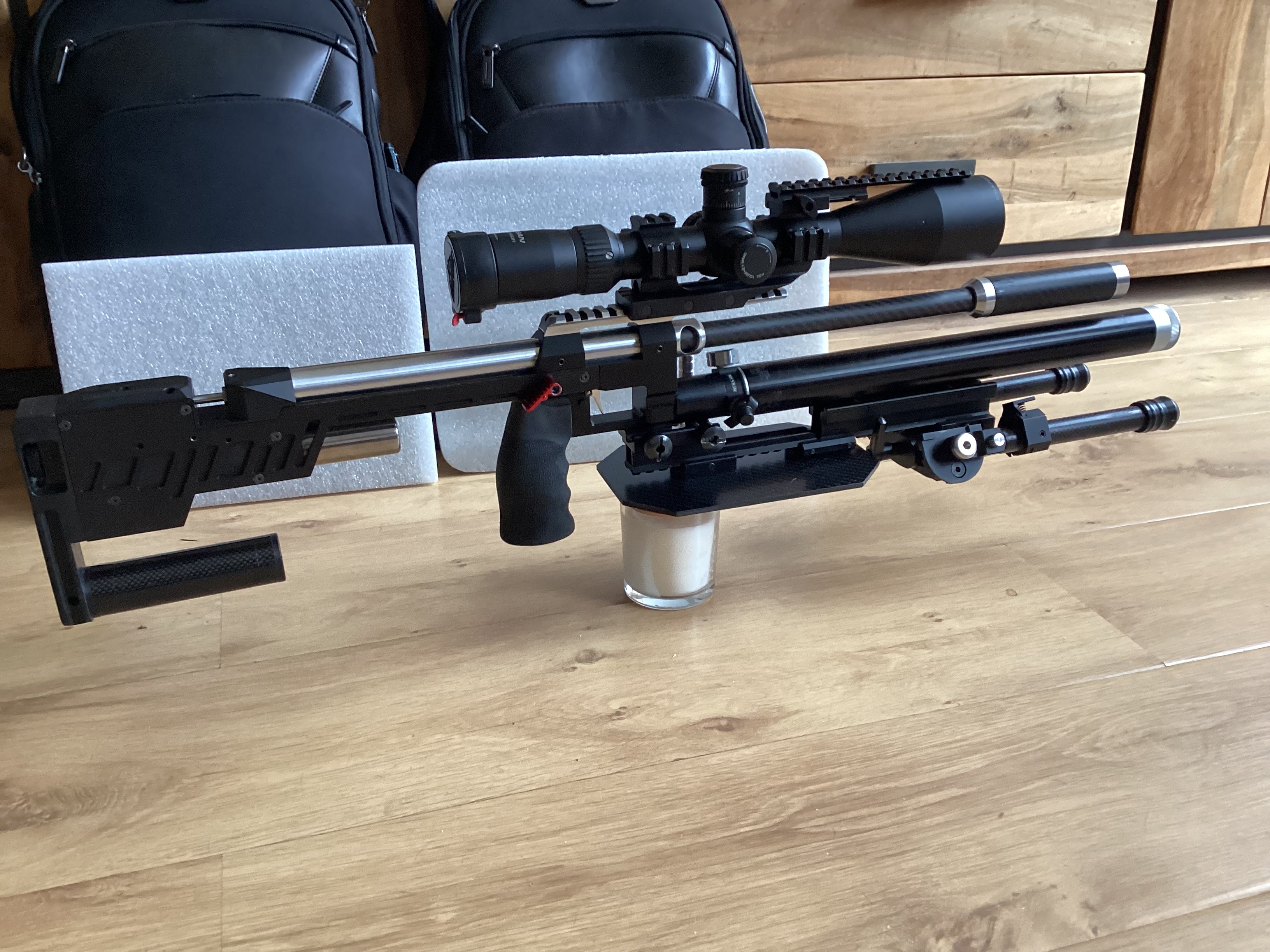

I like the top pic.. Mora? Would def buy one! Good solid metal construction between the front block and the back block.. unlike the Prophet where if you take the shroud off the barrel moves when you touch the grip.. not cool if you dont want to shoot with a shroud.
Yes, but you have to take into account, that the shroud also works as a tuner and therefore a dampener for harmonics.
The shroud is more than that, the treaded breech end of the shroud is 15mm, a solid attachment, the shroud actually becomes part of the breech block. Stability.
The barrel breech fitting plus the crown centralising ring on the barrel add further stability. Very tight tolerances.
The shroud is a integral part of any RTI.
A simple but effective design.
