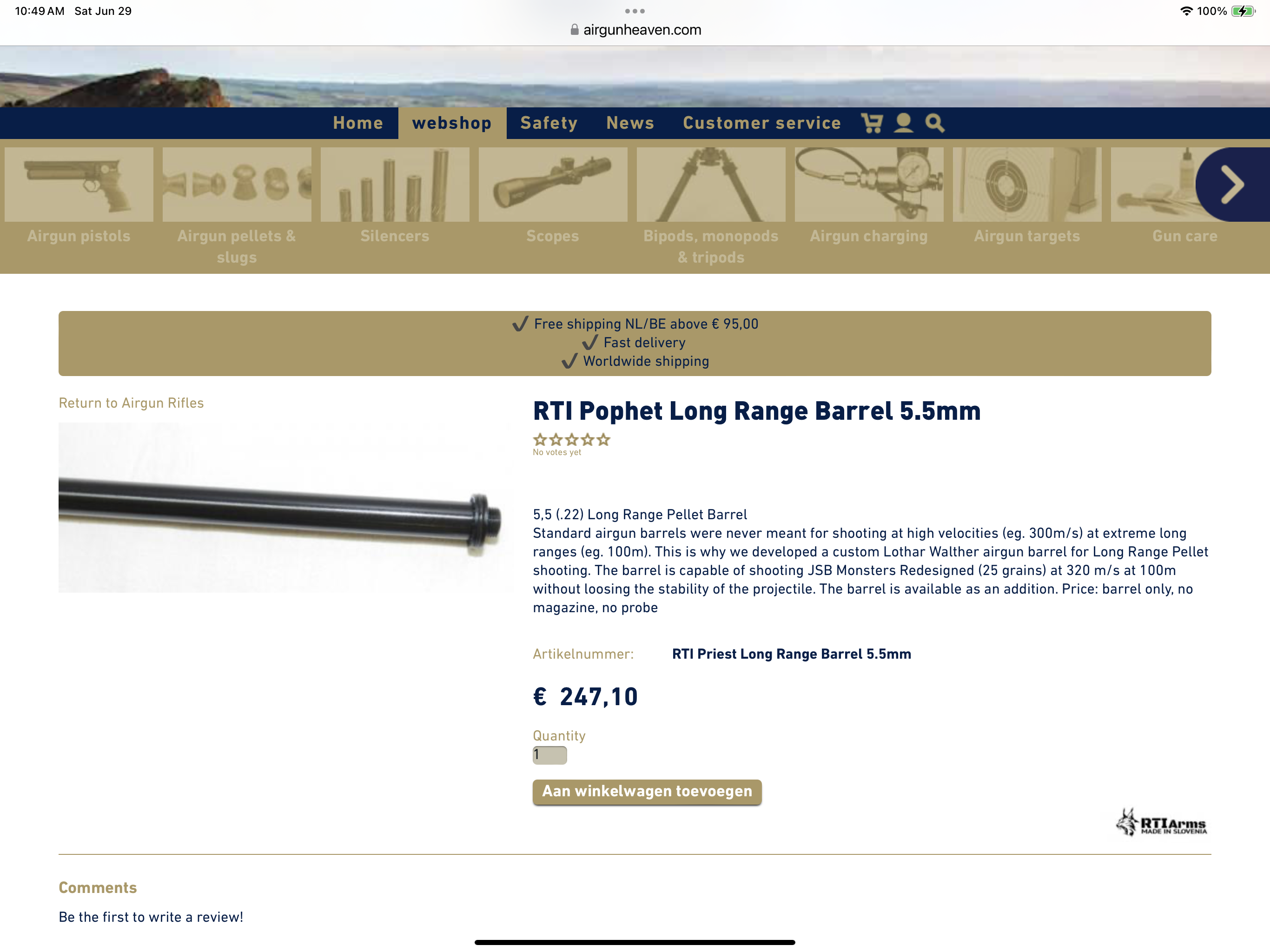

Airgun Heaven has the LR barrels for under $300, takes about 10 days to receive from the Netherlands.

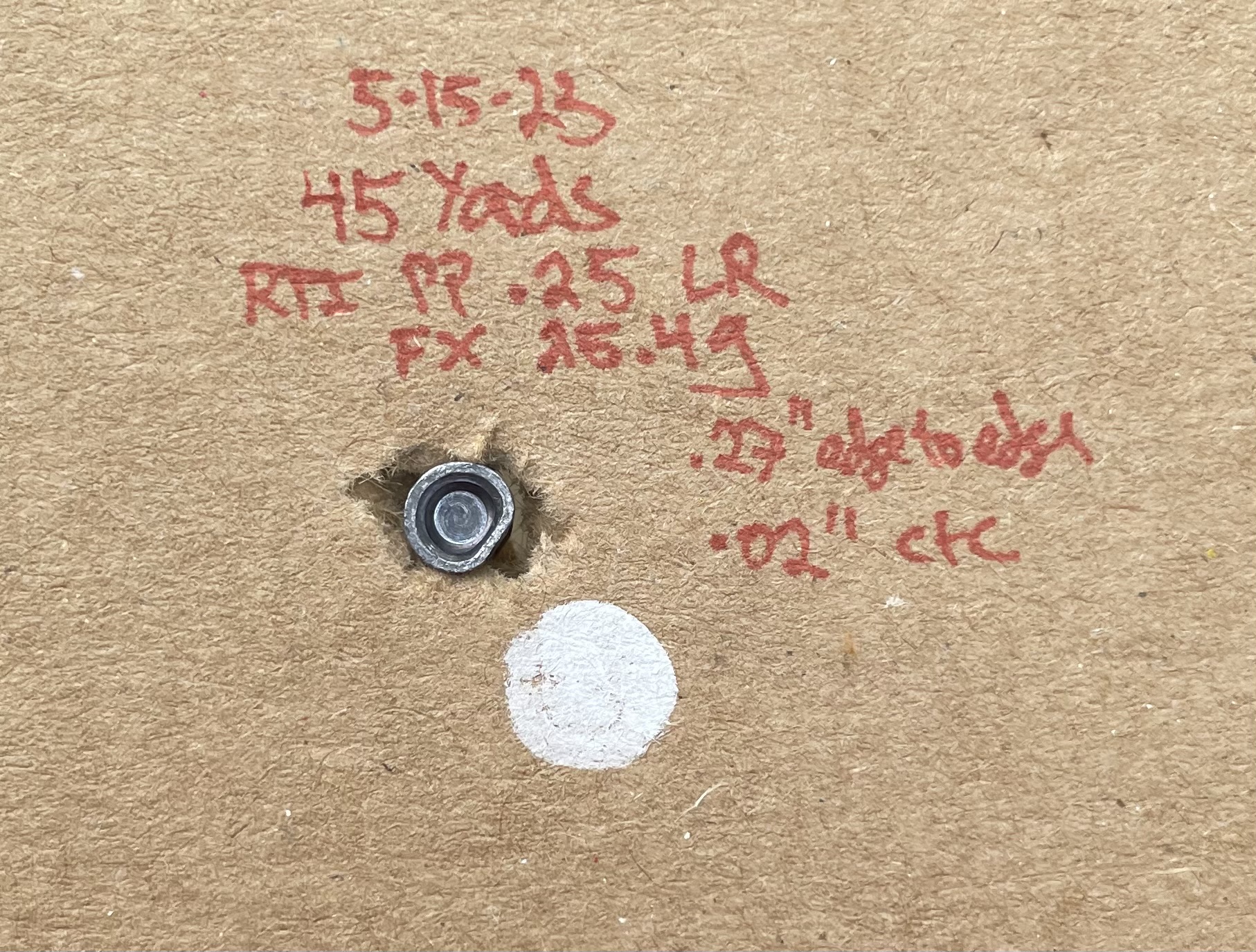

Yes, the .25 LR barrel is excellent with JSB/FX 25.4 and 34g. It also shoots the 30g H&N Baracuda extremely well.
My opinion… if you want to shoot 16-21g pellets get the .22 barrel.
If you want to shoot 25+ grain pellets, get the .25 caliber.
The 25.4g .25 pellet is excellent, and more air efficient (milder tune required) than the .22 25.39g MRDs.
Not that cherry picked groups are relevant, but I can tell you that I’ve done this multiple times with the .25 25.4g. The distance is actually 49.3 yards - I later measured with a laser.
Reactions: lbc_PSI

it was $ 322 total to be sent to Ca. Compared to the $900 from the RTI website ...No hesitation on my part.
Airgun Heaven responded last night and hope to have it in approx 10 days

The RTI Shop is not RTI, but a look-alike site that has crazy prices. They also have a similar site with Edgun and others as well.
Reactions: Spinach
Yep..you're correct..i think it's the Wolfiek group that owns the website.
Some of their info is helpful, but i have noticed a lot of misinformation regarding AEA pellets on their sites
They are way over-priced on that barrel, as well as other items
Glad i was directed to Airgun Heaven
