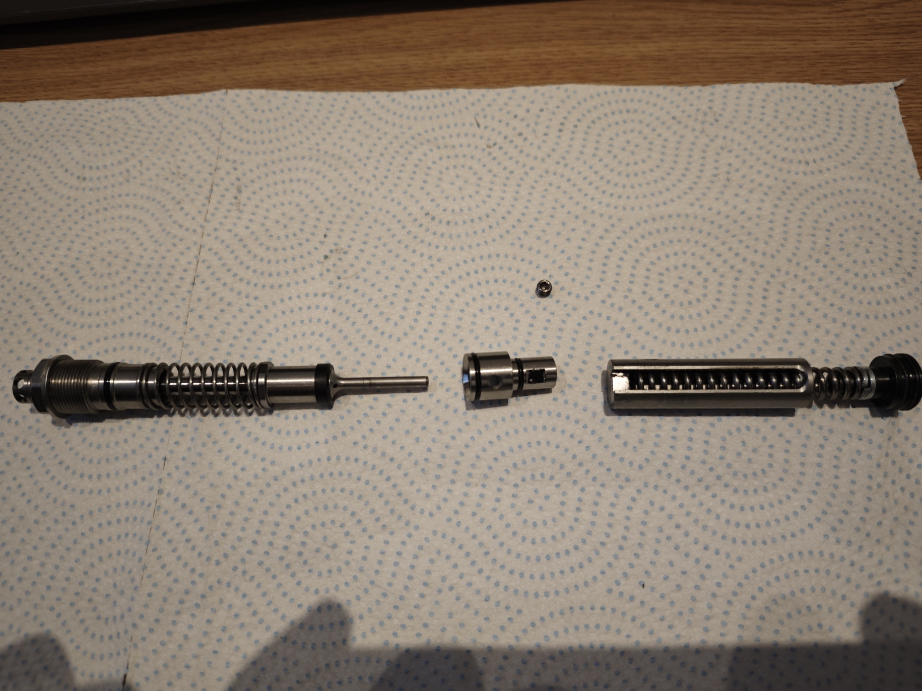

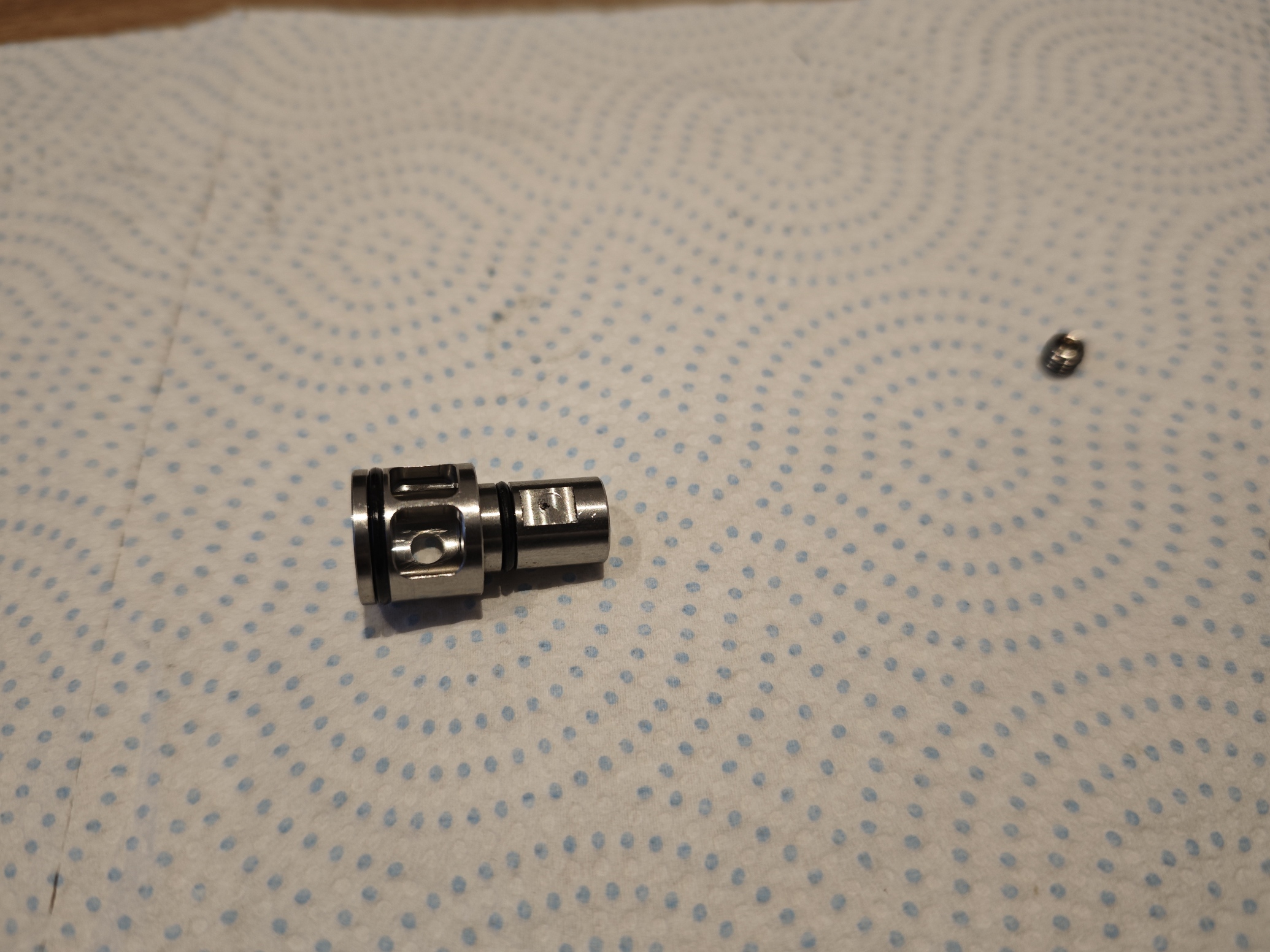

Hi mate I have same issue how have u resolved it..found the issue,looks as if the importer has indeed put a part sub 12 tune on it.by turning the valve seat to the restrict side.
thanks droogmole and Rok for the help and suggestions
the valve train looks as if its been modified in the newer versions compared to your one droogmole
so quick retest and its in ballpark of where it should be,just need to work on the consitancy now.
