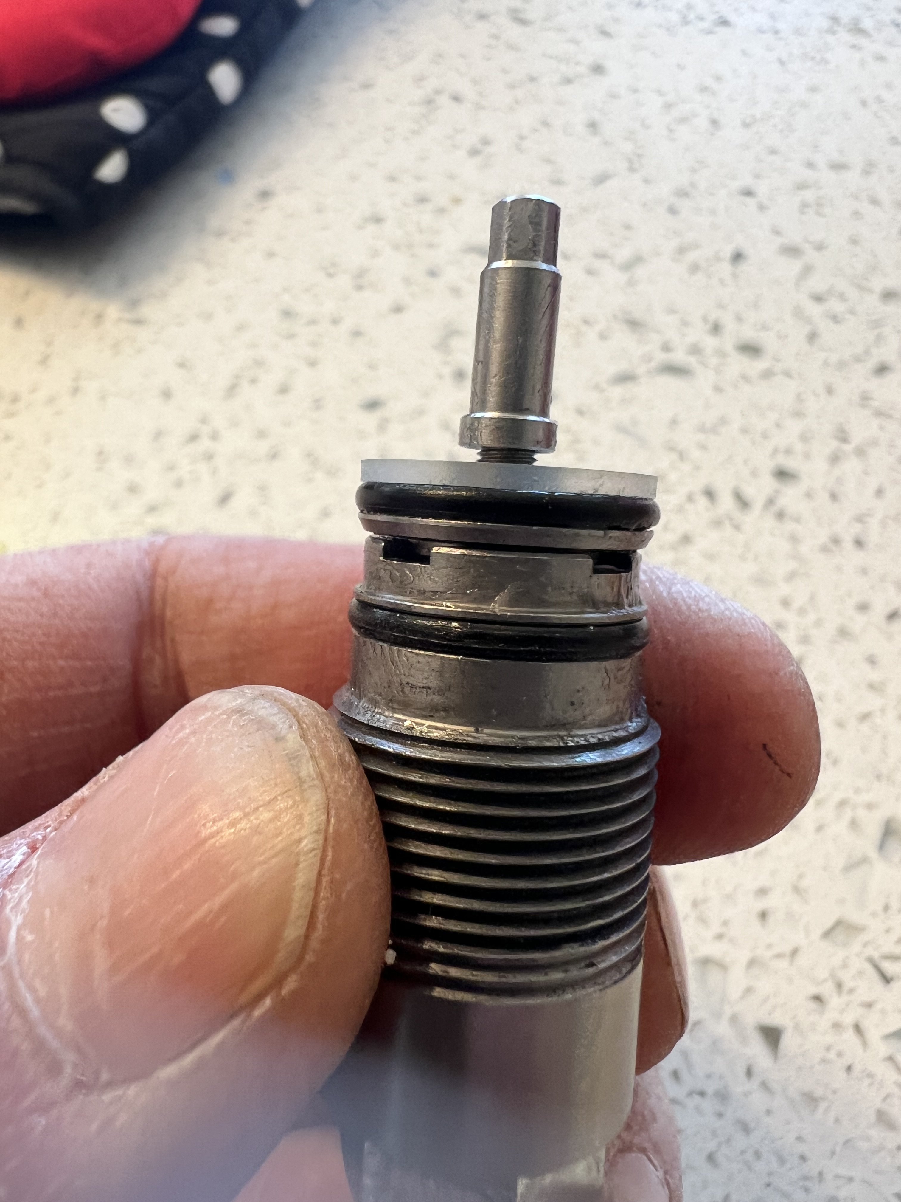

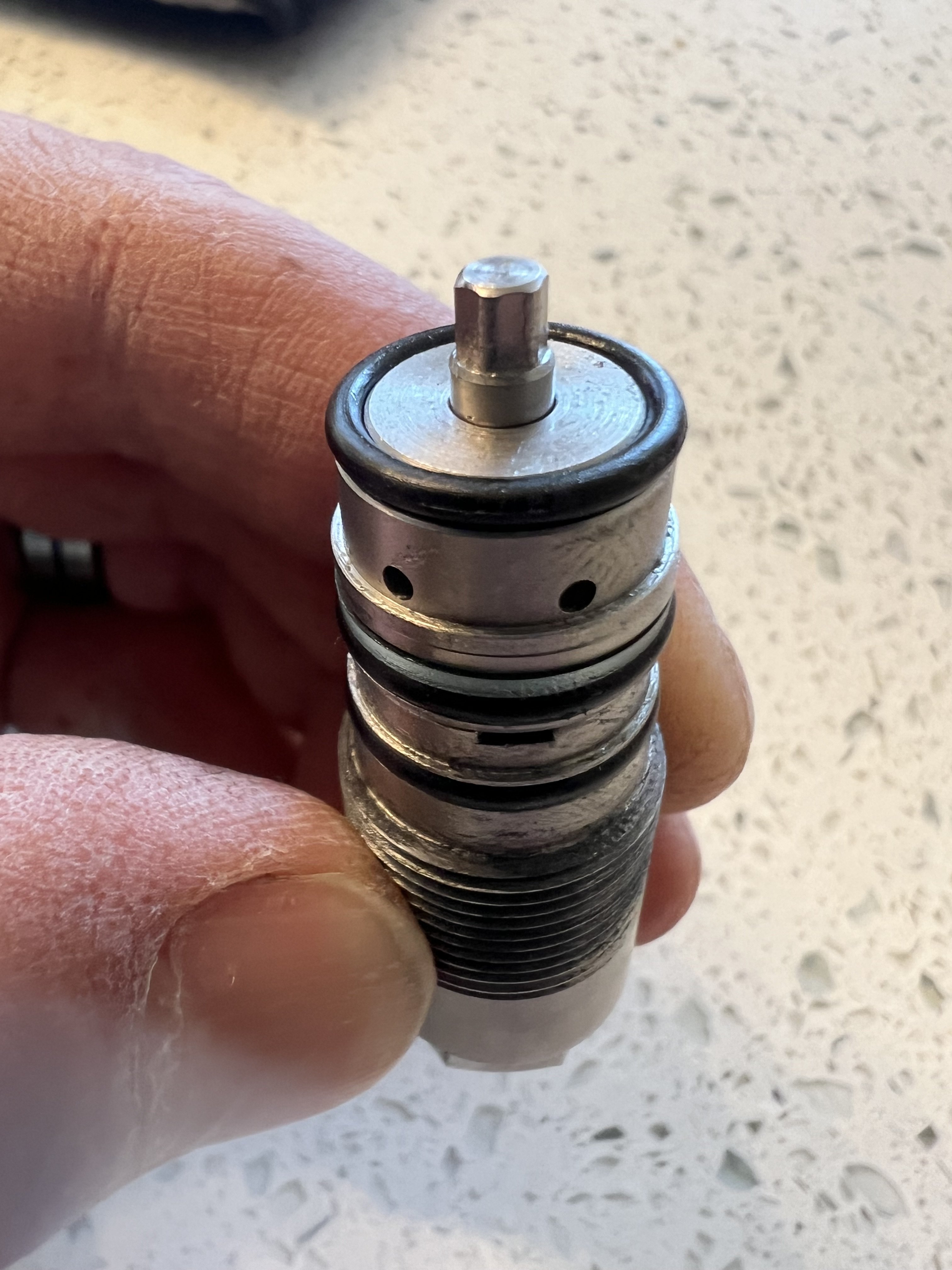

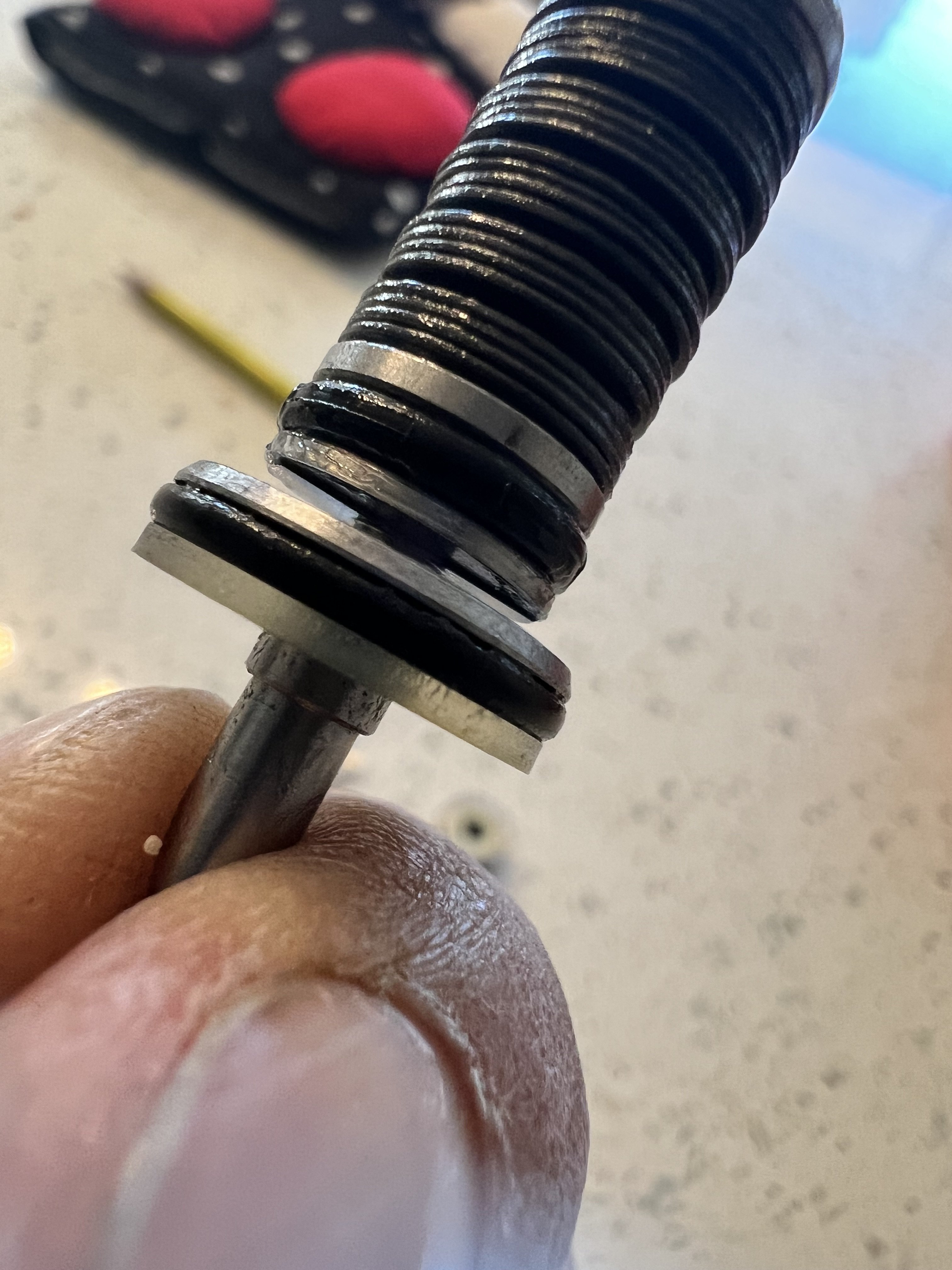

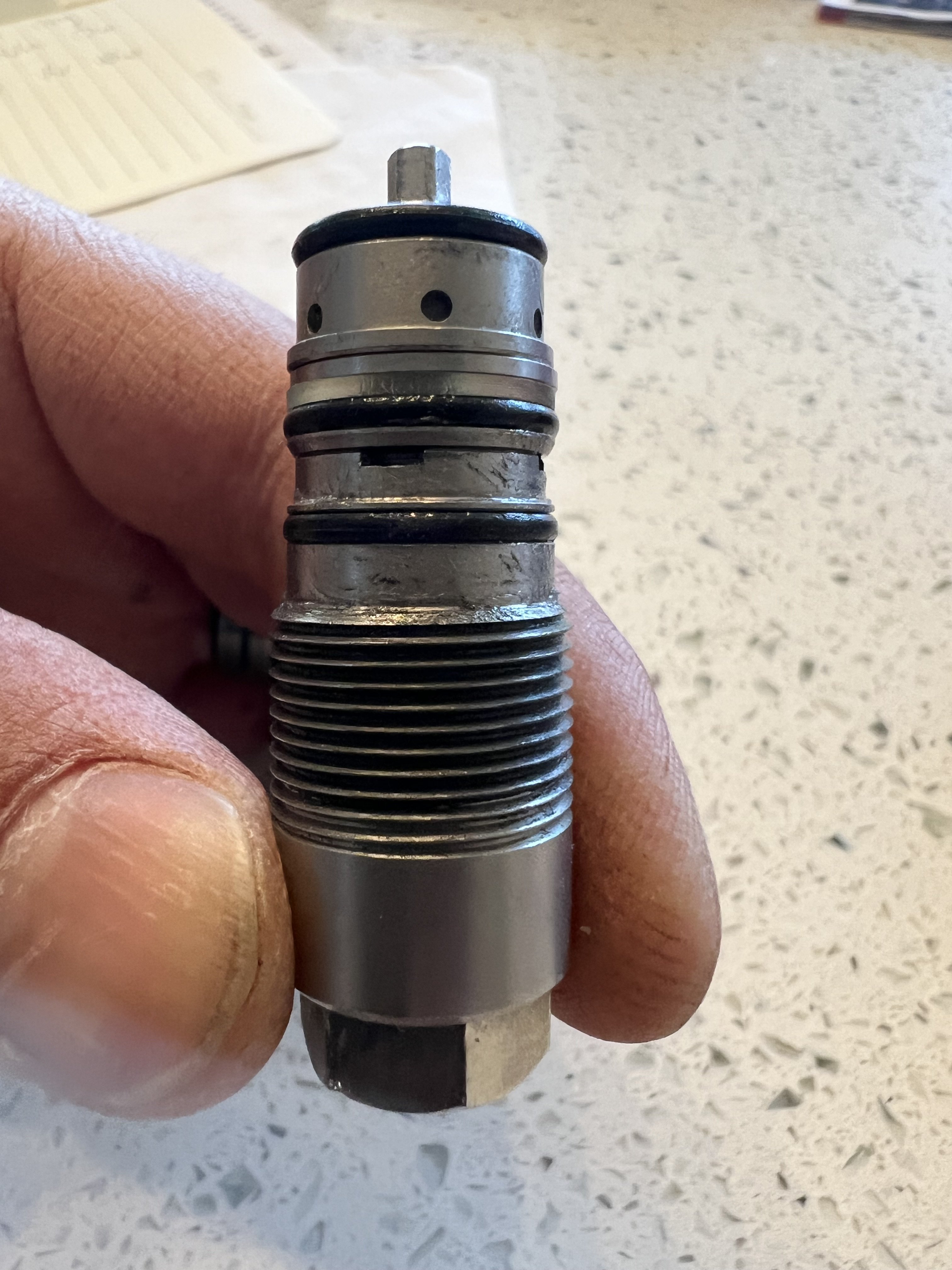

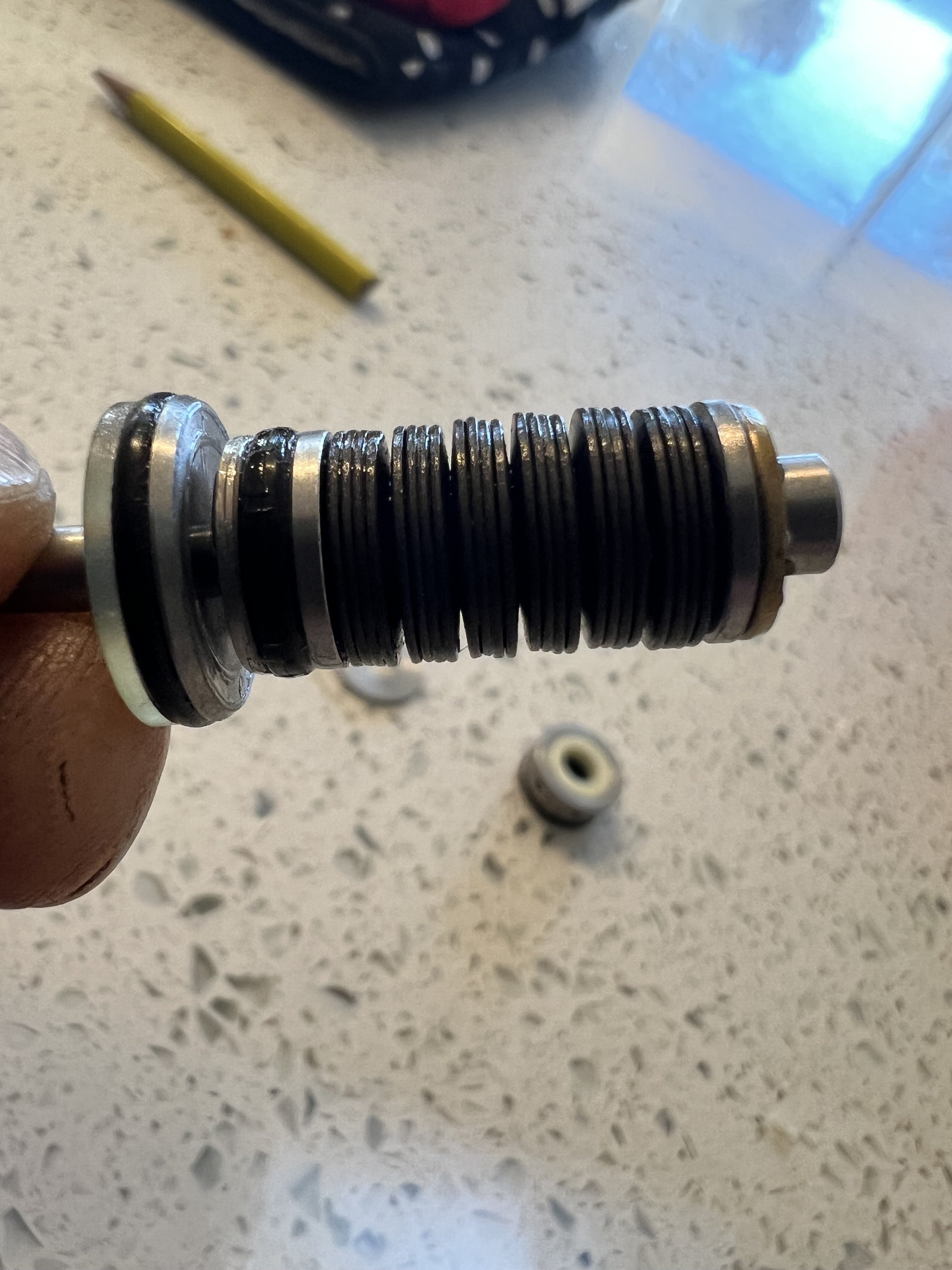

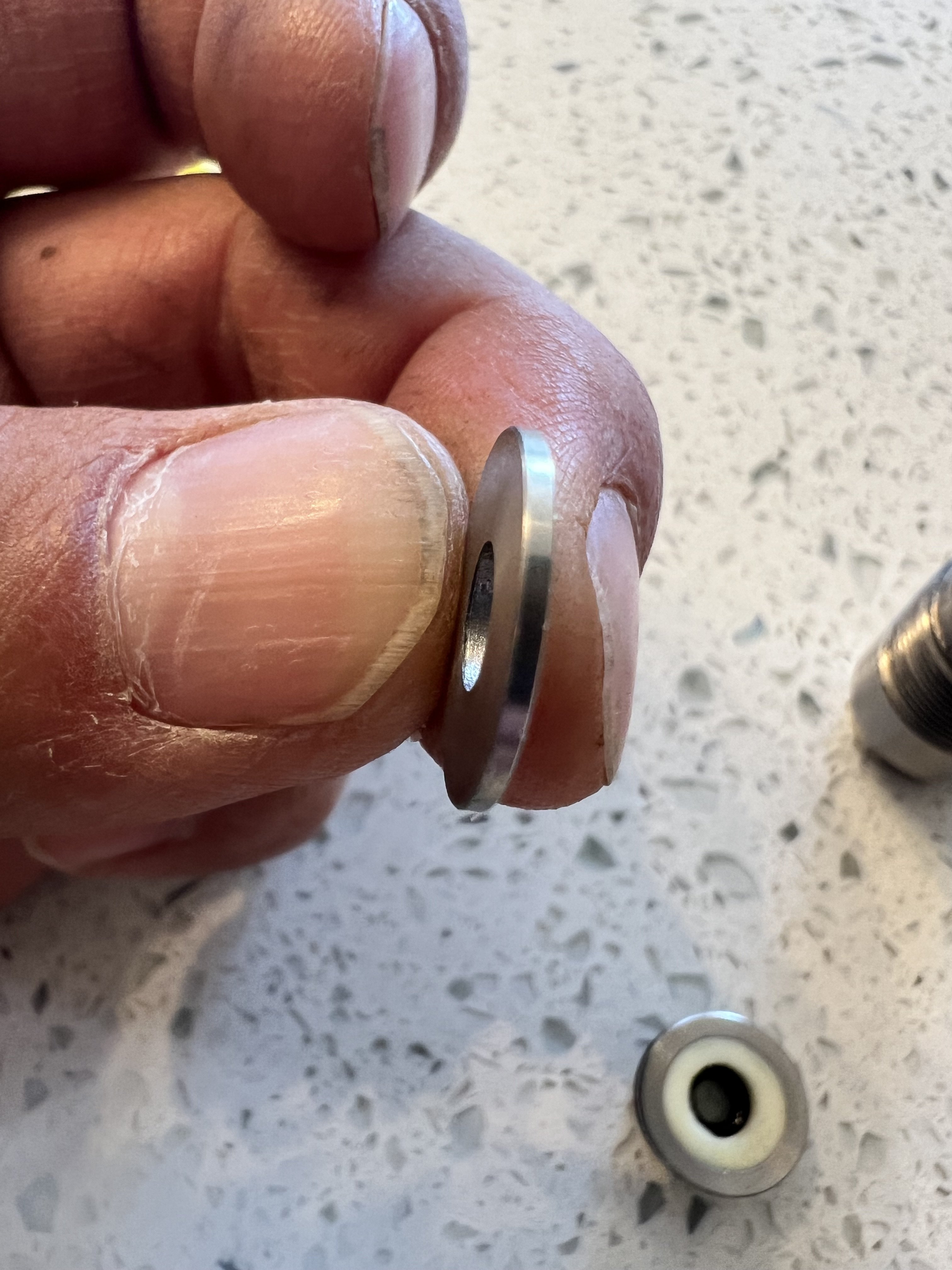

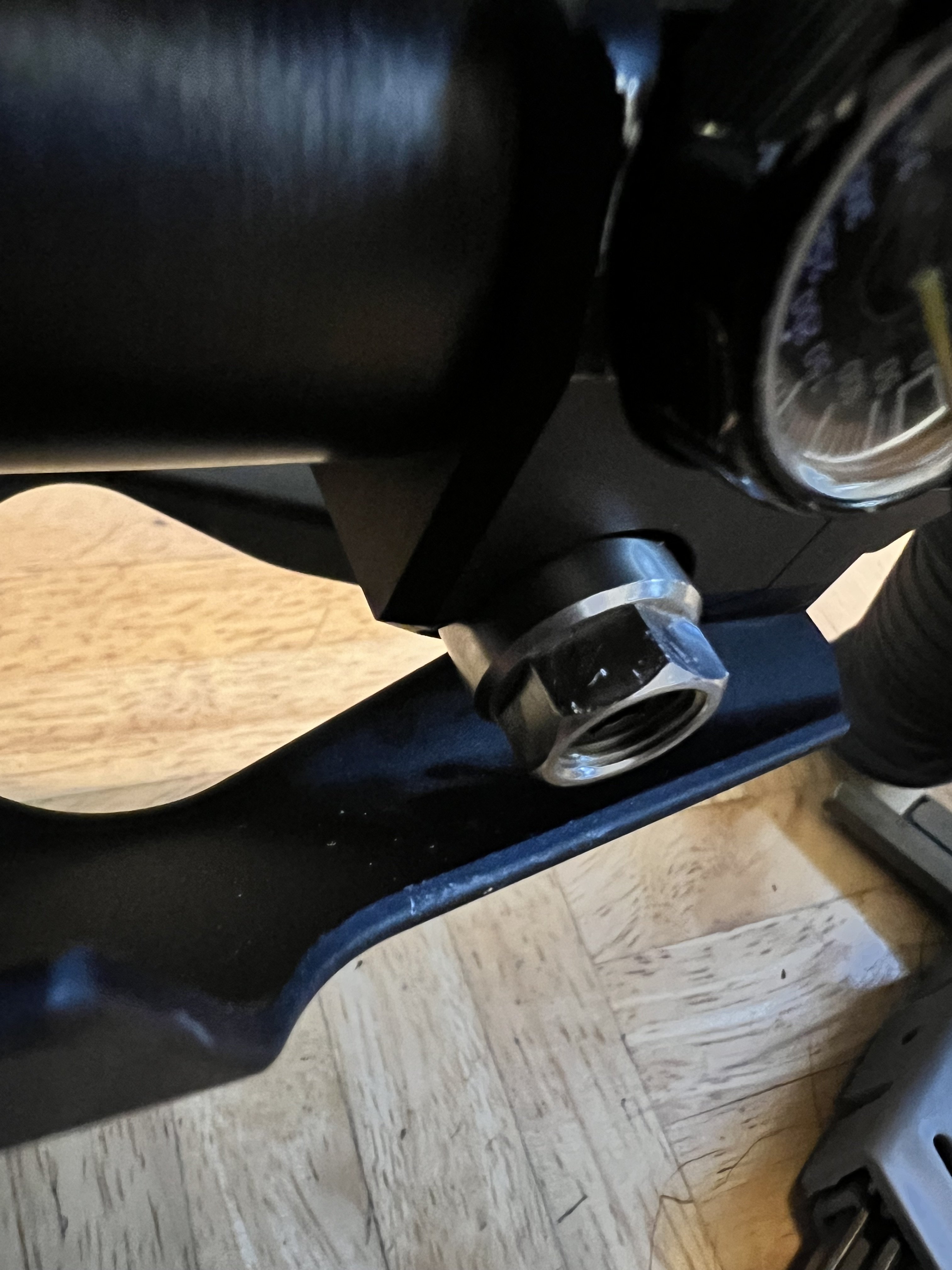

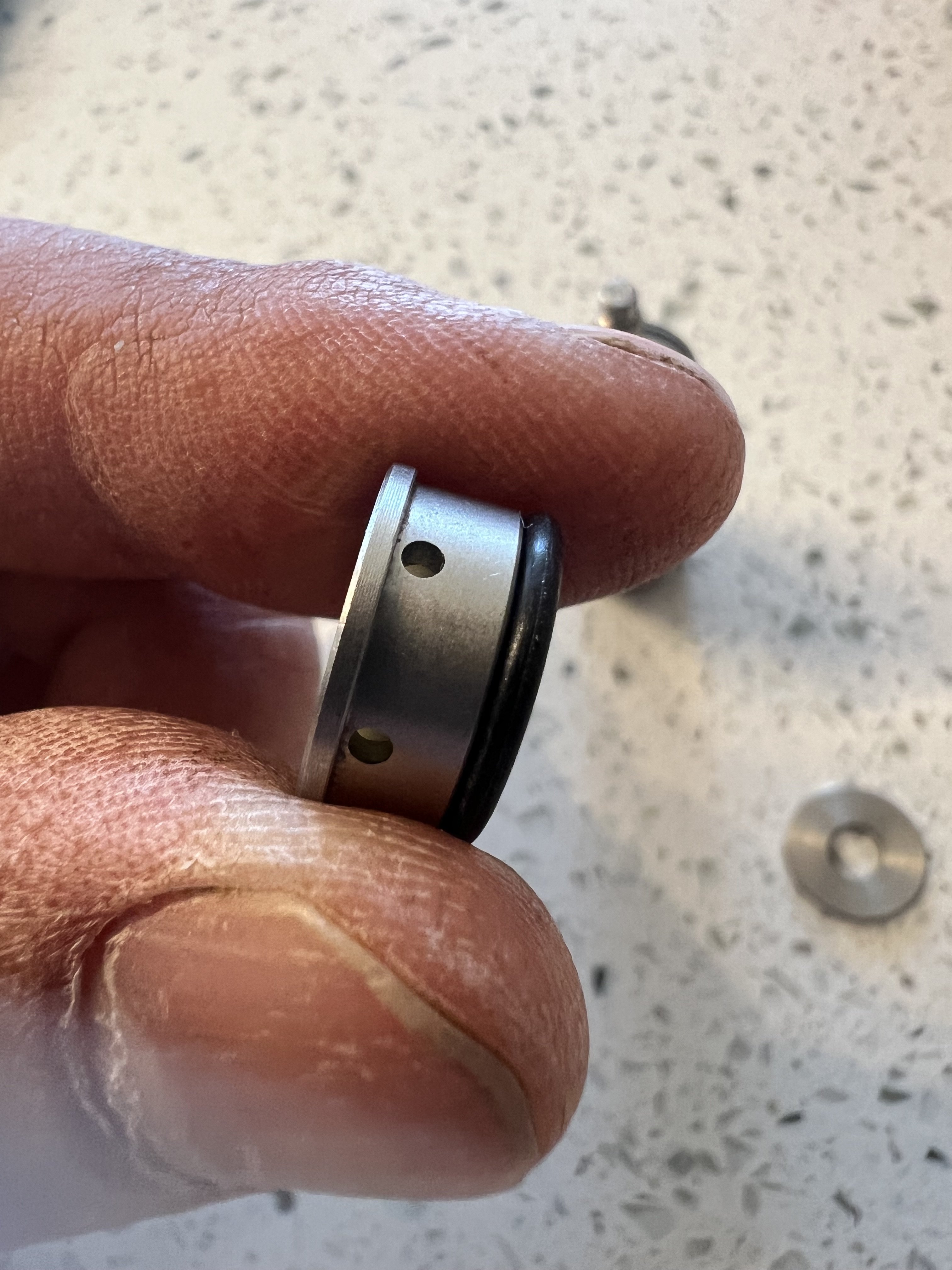

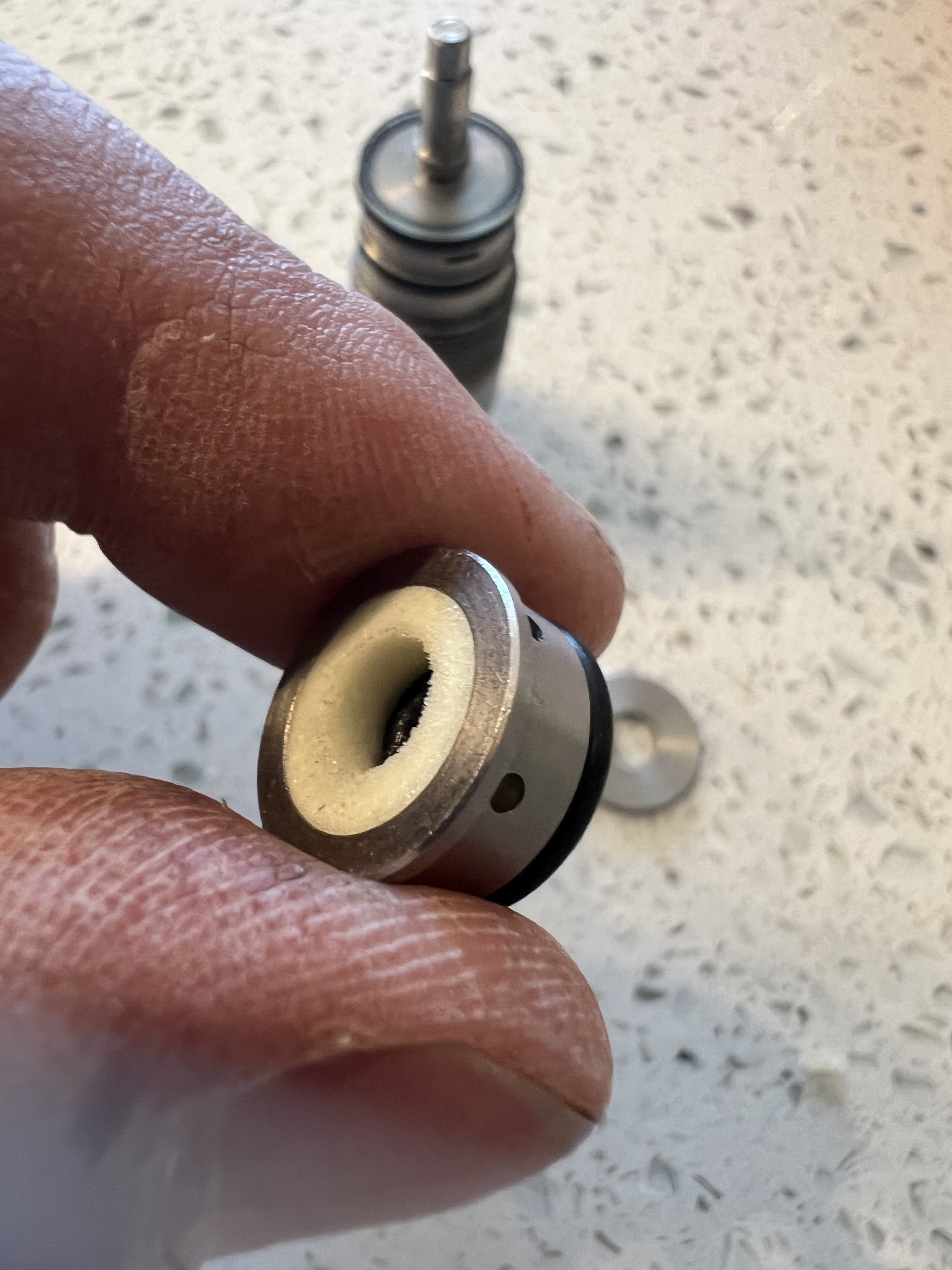

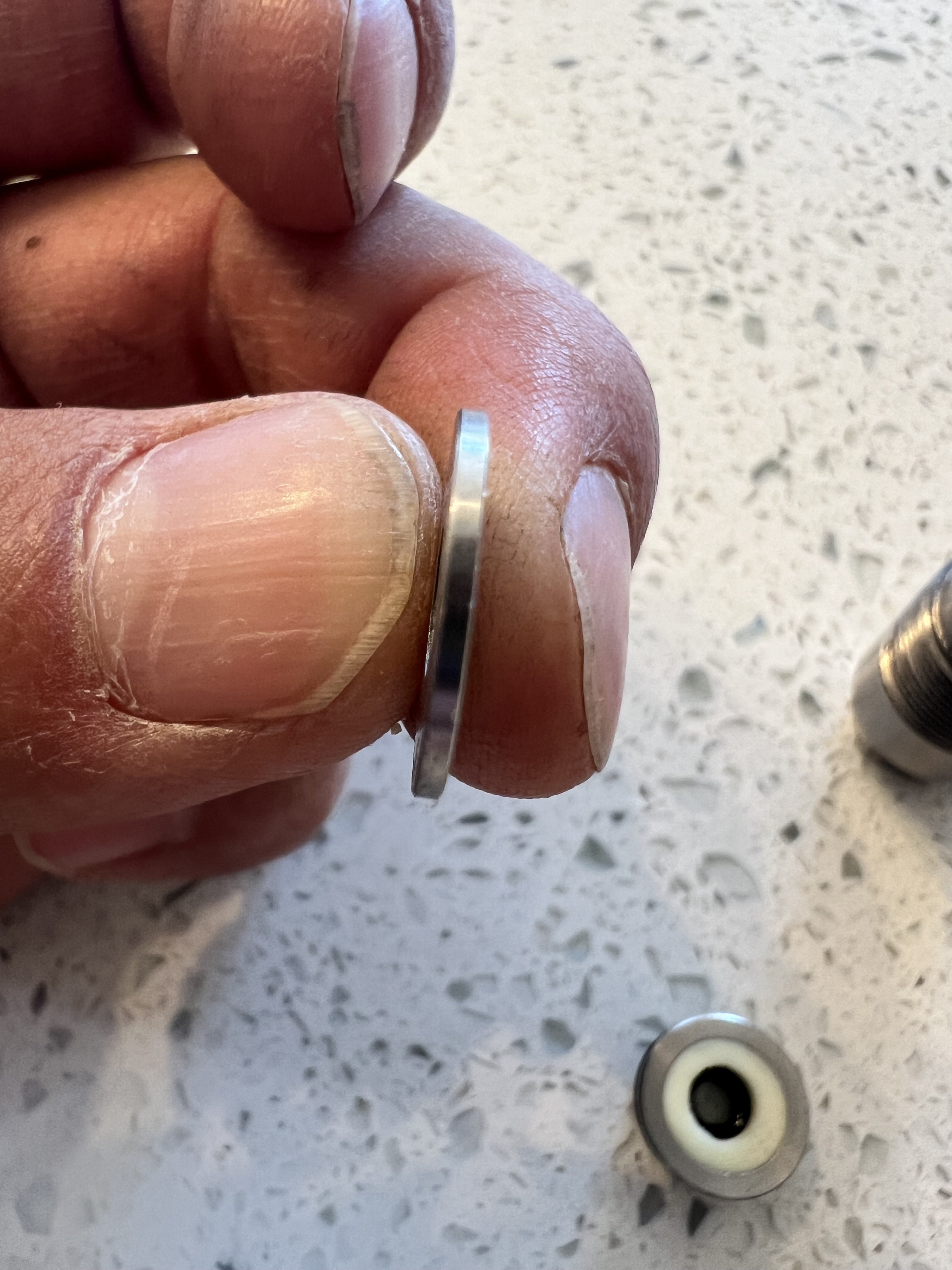

The Mora is easily more accurate than my impact and Panthera. The issue at first was the speed would drop and after filling the speed stayed the same and continued to drop. I took the regulator out and cleaned it. The big issue now is the gun will not pressurize and the gun reads zero on the reg. I set the regulator to max pressure and same issue. Any ideas? I also set the first stage reg higher and same issue.

No leaks. I literally fill the gun and zero reads on the regulator. Not even a tiny bit of air comes out when I shoot. It is like the stage two regulator is blocking something. I literally just took the stage two regulator out and cleaned it and the gun is getting zero air. I’m starting to think maybe the air transfer tube got miss aligned when the gun got degassed at this point
It’s difficult to know what is going on. I’d guess something has a bit of dirt or water somewhere. May I suggest that you try draining your air. Then clean the regulator, also silicone grease the bevel washers before assembly. Set the regulator in the low pressure side. Then refill the air slowly while you watch the gauges. Hopefully you will see the tank gauge fill up full and the regulator stop somewhere in the 70-100 bar area.
From there walk your tune back in.
Pm me if you need any help. I’ll be happy to take my mora apart to help you out.
