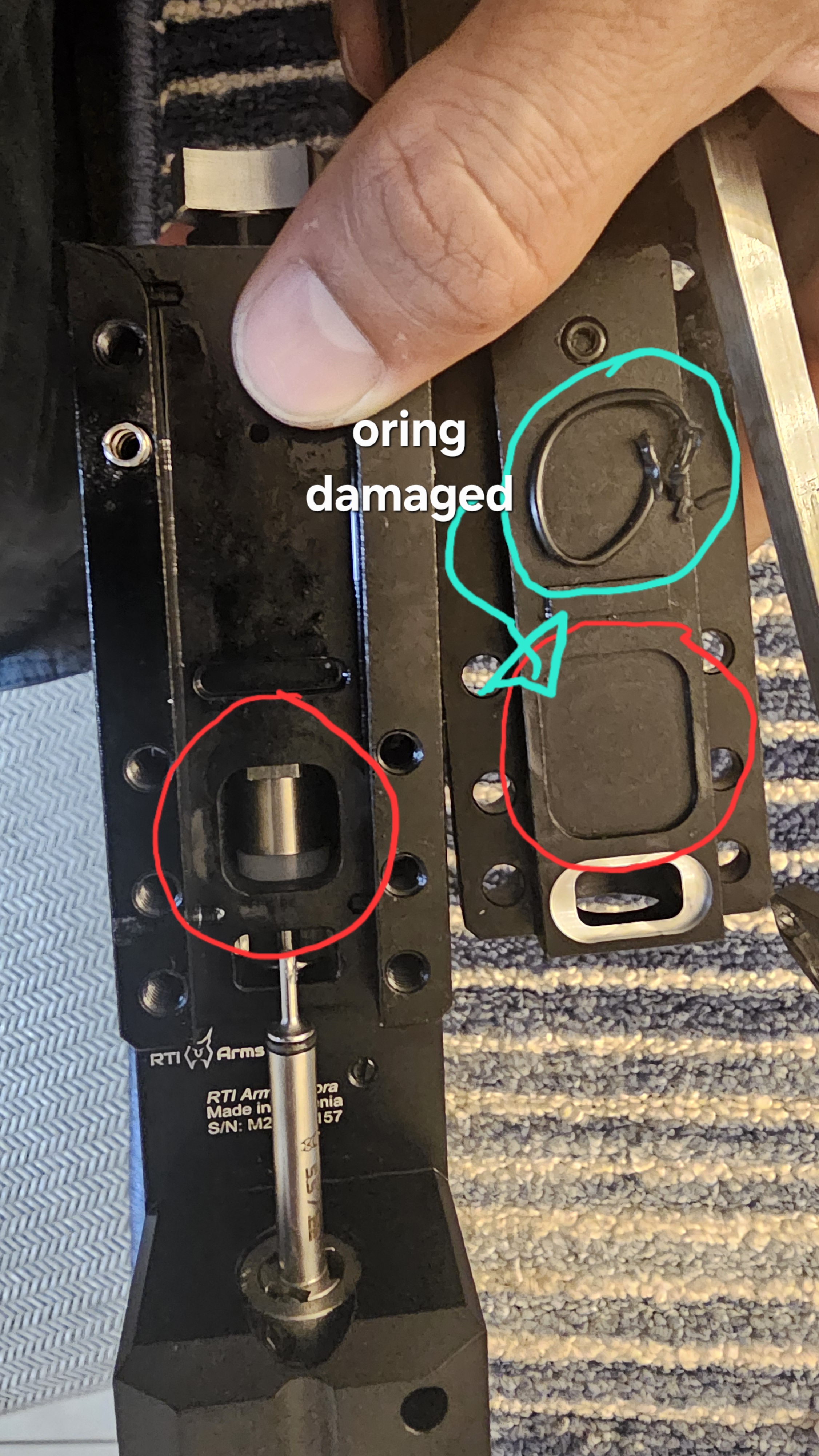

What's the oring size in the picture and where can I buy it if available?
Mora lost all air by night and when I tried to air it up it does not hold any air.
Disassembled and found that oring damaged that goes into the square sized part.
Thanks for the help.
J.H

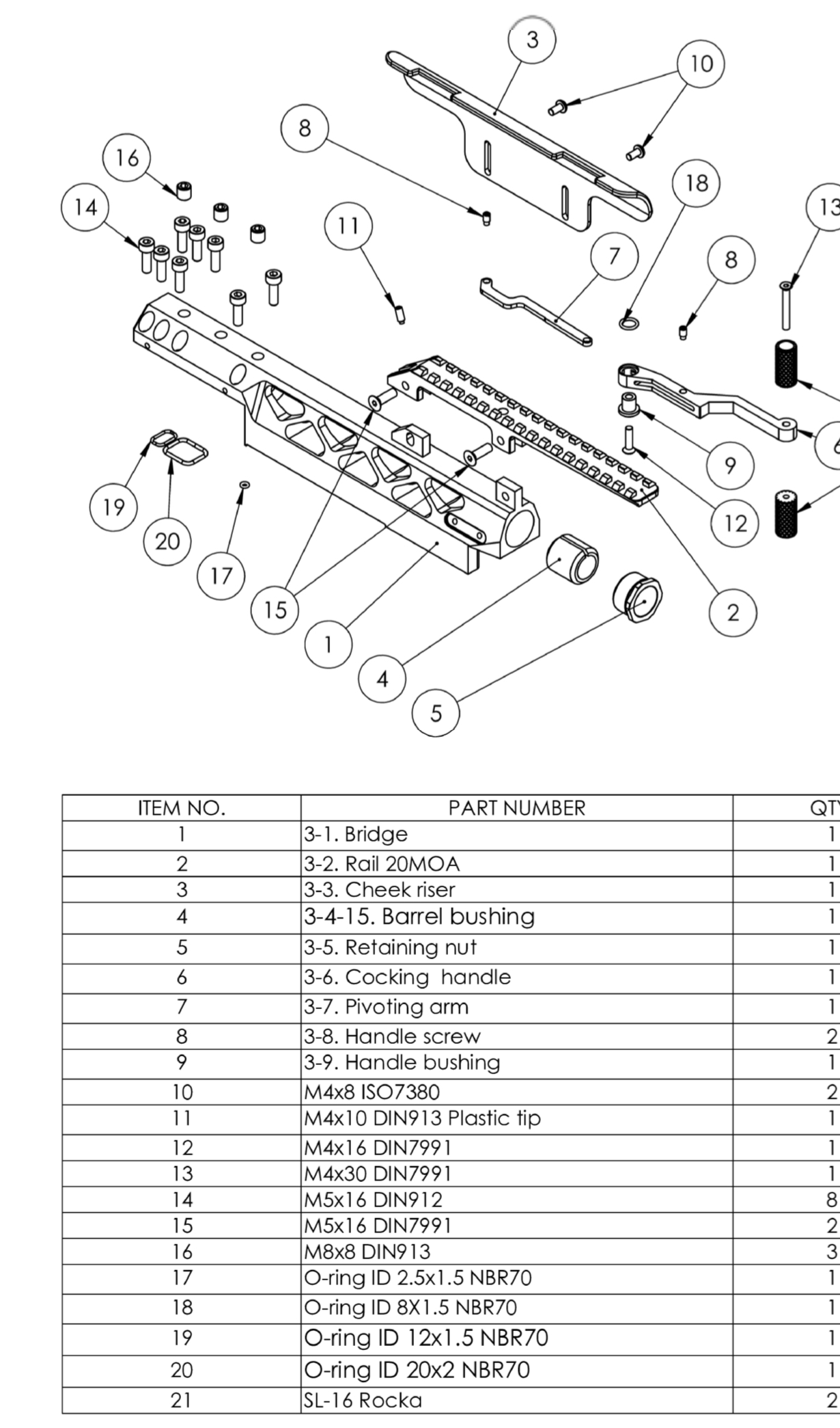

looks like O-ring 20 in the diagram above. ☝️
