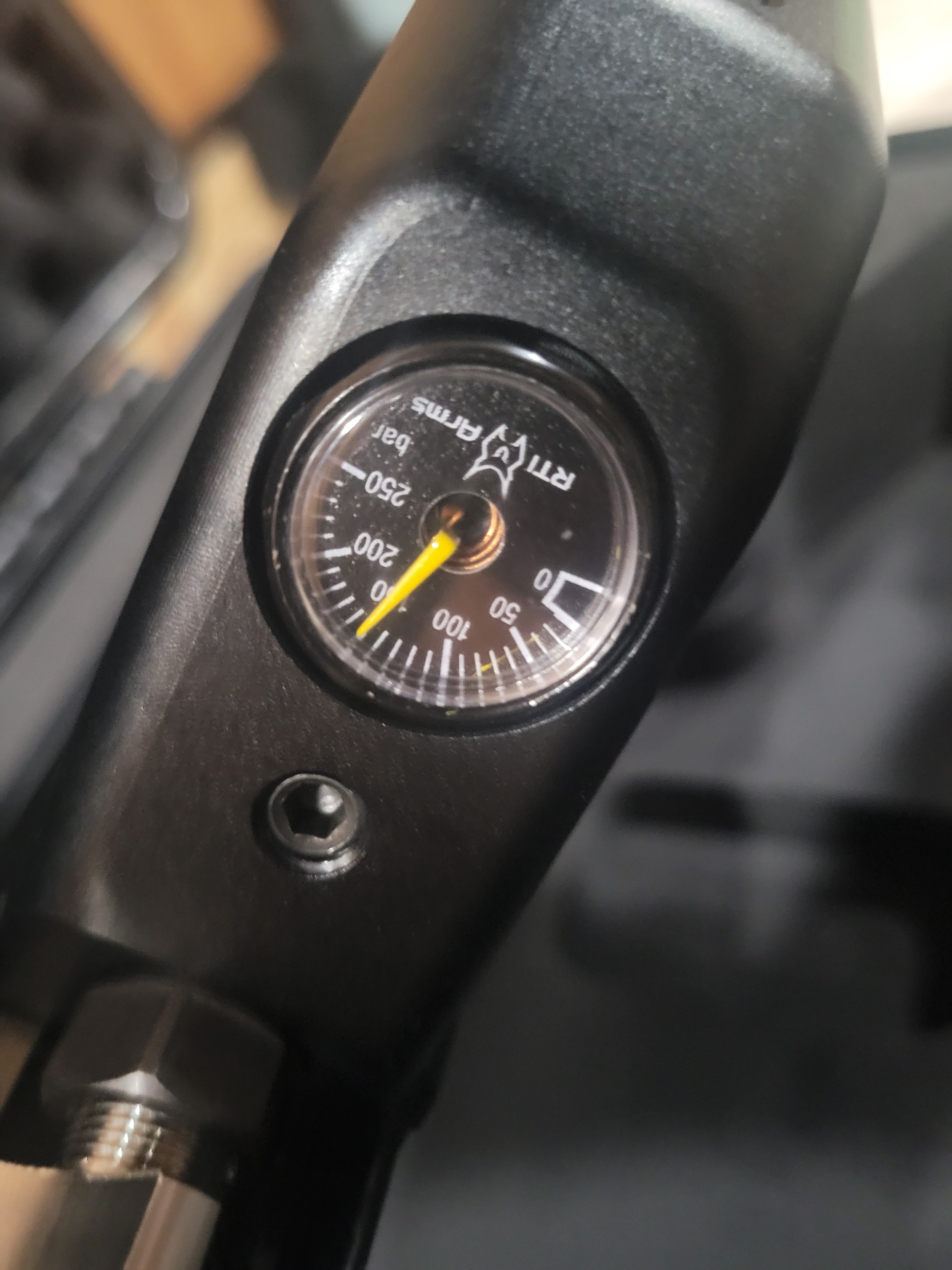

I didn't think to test but I guess I should've. I'll test tomorrow if the FPS changes with the turns. I'm going to guess the gauge is fine though, as when I've opened the drain plug it'll drop to 130 bar, close the plug it comes back up to 140. It'll also smoothly go up and down when emptying and filling the bottle.

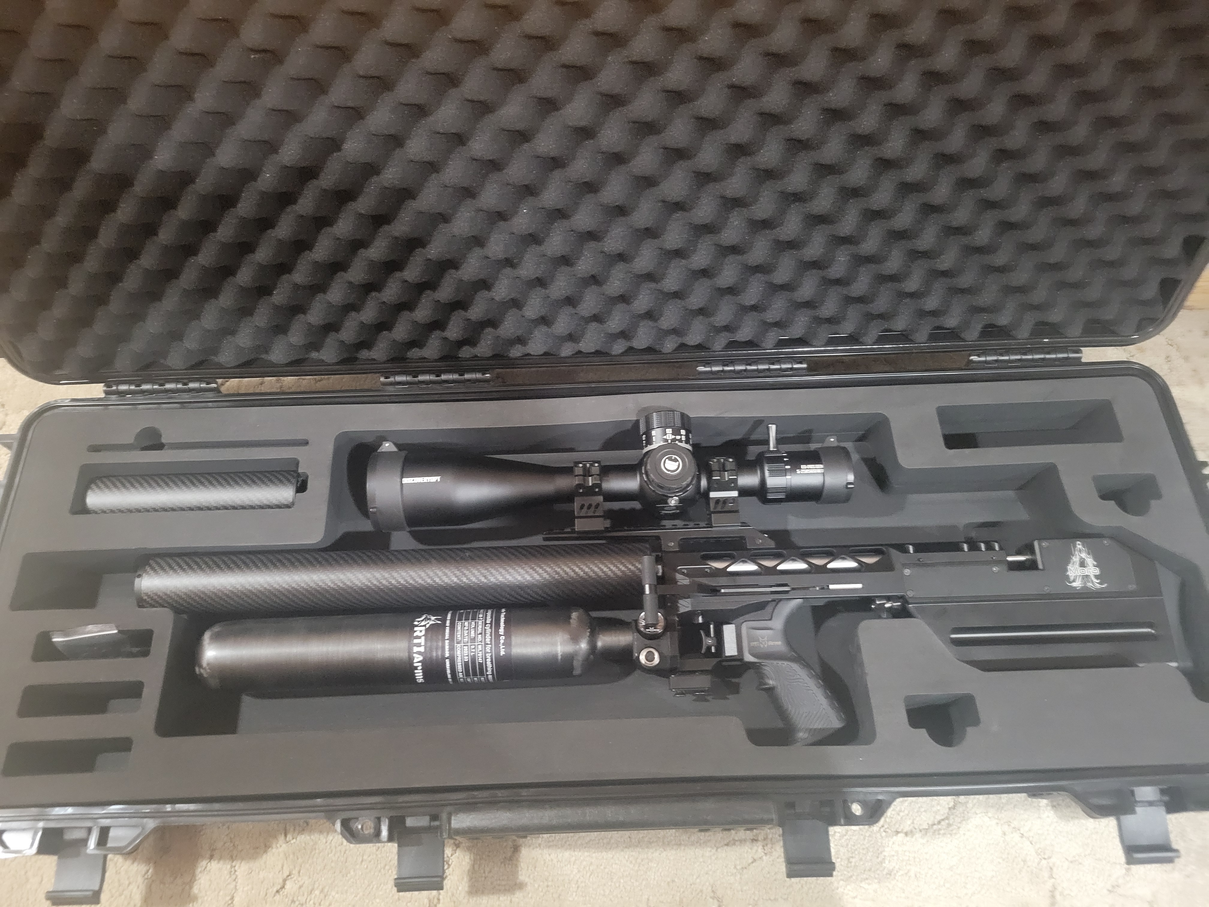

What caliber and model is yours? Post a picture. I’m a huge fan of RTI rifles - they are rifles for shooters, made and designed by shooters!!
-Ed
Reactions: Rizz01
It's the standard, 600mm version in .25 caliber.

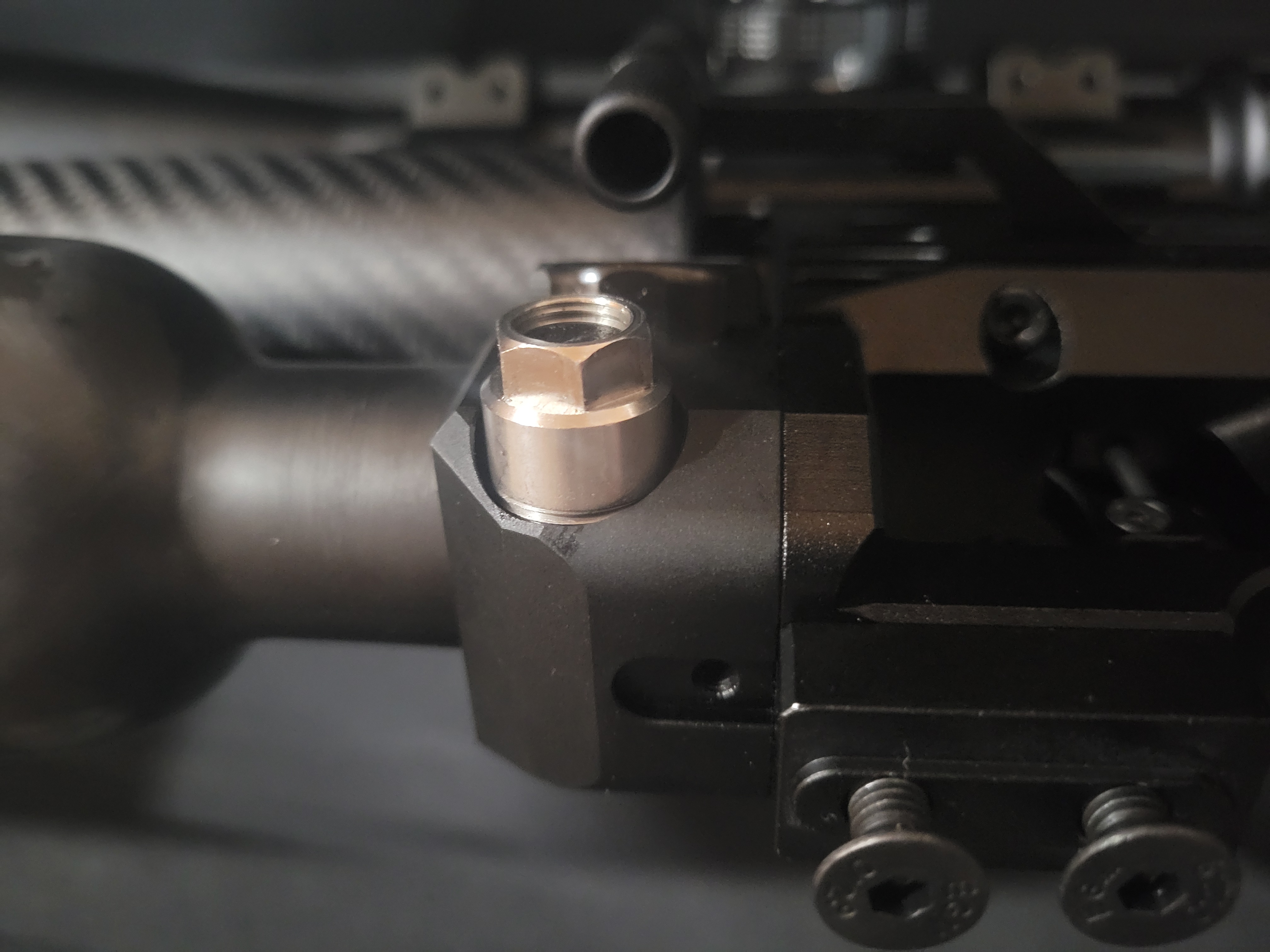

I've unscrewed the regulator and checked the o-rings, they all seem good. No nicks or anything. Anyways, here's some pictures
Appears to be the regulator. I've gotten the chrony out and have done some testing. With the regulator in CW and backed off 1/8th turn it's sitting at 150bar shooting a 33gr mkii JSB pellet at 1090-1100fps. Turned the regulator 1/4 turn CCW, dry fired three times, turned another 1/4 and dry fired three times, still sitting at 150 bar shooting the pellets at the same speed. I am watching the regulator when dry firing drop to 130-140 bar and creep back up to 150 by the way. I repeated this a couple more times, same speed.

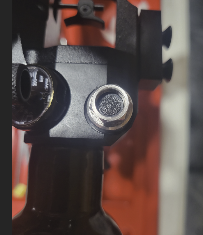

Ladies and gentlemen. I believe I have found the issue. The thing to adjust is this thing that is inside the regulator. The black thing. NOT the big, shiny, juicy hex bit to fit on a wrench with. I've pushed it all the way in and taken it all the way out - both times needing to purge of air, I can't move it with pressure. Wouldn't you know it, the pressure has gone from 200 bar to like 20 bar.
This is why we need manuals :(
Also, how am I supposed to adjust this? There's nothing to gain purchase on? I suspect they sent it without changing the screw thing. I'll update when they reply to me tomorrow.

There are visible threads in there. If that's made like the other RTI regs is should take an allen wrench to adjust it. That pic looks like it has something like foam stuck in it?
It feels like hard plastic, doesn't come off. Tapping it with a metal bit sounds like plastic. It's on the inside as well, like a filler almost to make a cap. I am perplexed.
