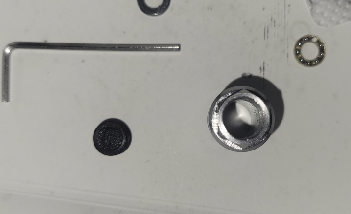

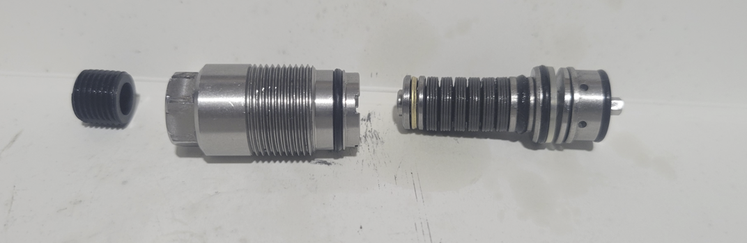

That black plastic in the hex screw hole hides another allen hex screw that adjusts the pressure.
You could have been sent a sample non adjustable regulator. Suggest you talk to ROK. He might ask you to drill a small hole in the center of the black plastic piece and pry it out to access the 6mm allen screw for the adjustment.
Or Rok could ask you to send it back.
Saying that, the seller should have checked the functionality if the gun before sending it out. Its cool to be amongst the 1st few to get the gun but it sucks big time to get a flawed product with no instructions to guide a newbie owner.
Since I am handy with mechanical things, I would ask Rok for guidance to get it working or he might send you a new regulator but sending the gun back would be my last choice. So do what you need to at your own risk.
The plastic is like bonded to it. There's no other screw bit under it.

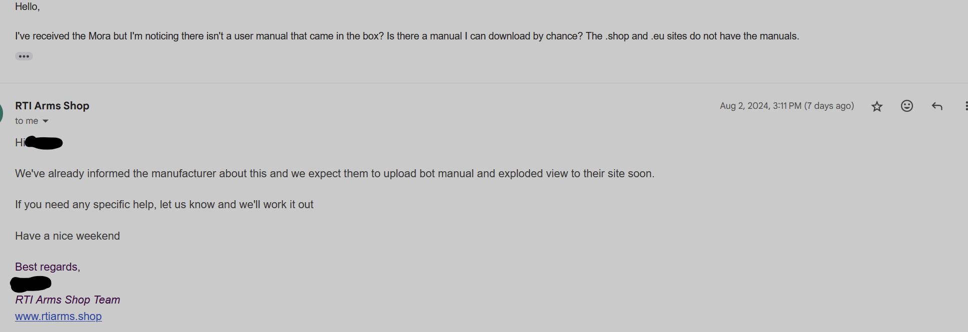

Isn't selling a gun without a manual putting the cart before the horse? Leads me to wonder about what other shortcuts the company may take in releasing products to consumers? I was interested in the gun probably still am, but I will wait until it's in the hands of many people in the bugs are ringed out and get an accurate hopefully not bias assessment on how the gun really works.
The black plastic piece is suppose to be the 6mm allen adjustment screw. Saw the thrust bearing in the previous pic that was suppose to be between the adjustment screw and the base of the belville springs.
Does the black plastic piece have a hex cutout in the hole side? If it does then just drill a small hole for the belville stack post to pass thru , turn it upside down and use an allen wrench to tighten.
You need to get the missing part from RTI.
Wonder if his rifle was accidentally fitted with one of the non-adjustable ones they make for countries with rules and limitations such things.

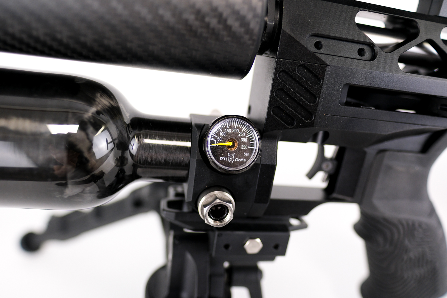

Pic is from RTI's gallery of the mora, can clearly see what an adjustable one looks like.
This is a regulator from the P series, but the adjustment is supposed to be the same on the external. 1/4 turns, dry fire, move again (yes, I know this is only supposed to be for lowering but better safe than sorry). Also a You Tube vid about adjusting the MORA but not going to rewatch them to find it.
To this day FX is still shipping guns with the wrong manuals and they've known about the issue for years. My WIldcat came with an M3 manual and just recently someone put up a thread about their DRS and one of the complaints was a wrong manual. Both are potentially dangerous but at least no manual would make some look to the manufacturer website for answers.
Not defending them as I agree, just don't know the deets as it could have been the distributor that shorted the materials. FWIW, RTI doesn't have a manual on their site yet but there are other valuable resources on there that would help.

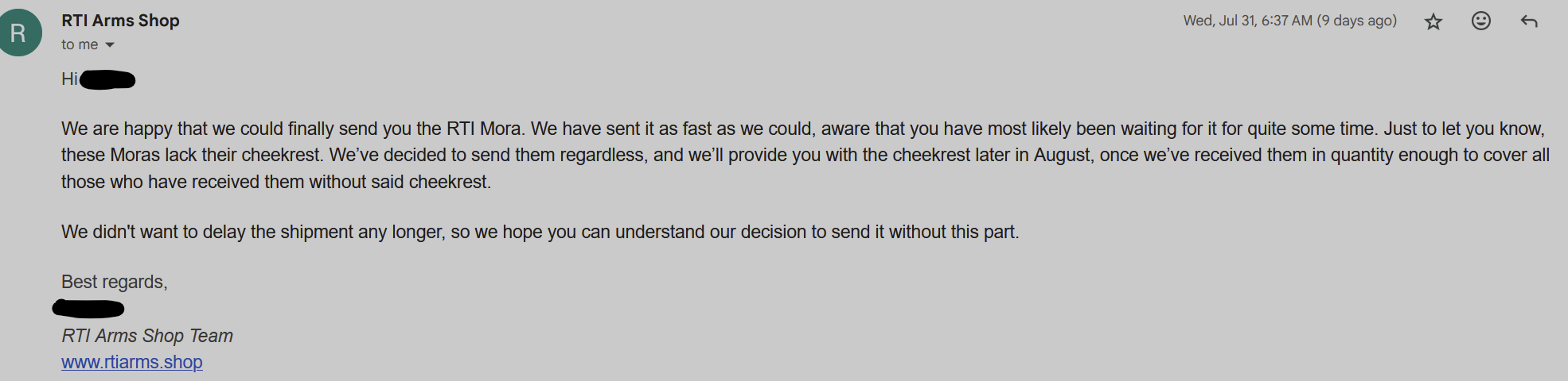

This is most likely the distributor. Here's the email they sent about sending it early:
Just confirmed with Rok this morning this is what happened. It came with one that is supposed to be non-adjustable. Didn't mention he'll send me the correct screw so I've asked him about it as I don't have the correct screw.
This is most likely the distributor. Here's the email they sent about sending it early:View attachment 486998View attachment 486999

RTI seems to be very good, especially with Rok putting up with all of my emails. Even answered me from his phone on the weekend. The .shop however, eh. They're not able to send me the correct adjustment screw apparently. I'm still waiting to hear back from Rok on my previous email from this morning.
Is the problem already sorted? if so, how is the accuracy of the rifle? :)
The problem is sorted, yes. Just had to pop out the plastic bit by inserting 4mm allen wrench from the bottom and give it a good thwack with the hammer.
