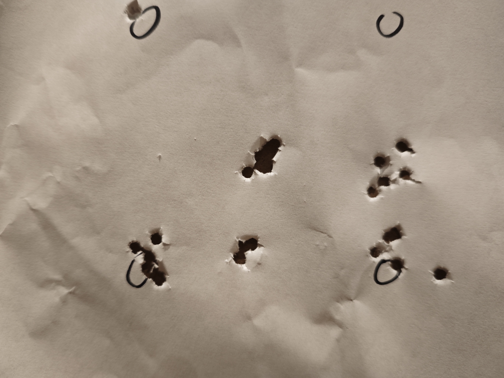

The accuracy is pretty great it only likes the H&N slugs. I've tried the FX Hybrids, Javelin, JSB Knockout, NSA, and Zan slugs from 850 to 1000 fps giving a good three groups at each speed at 50m. About an inch group each, but the H&N slugs were the only one to give a one hole group. It has potential to do a one hole group at 100 meters but I'm still waiting for a cheek rest. I'll get a one hole about every 5-10 group attempts.
