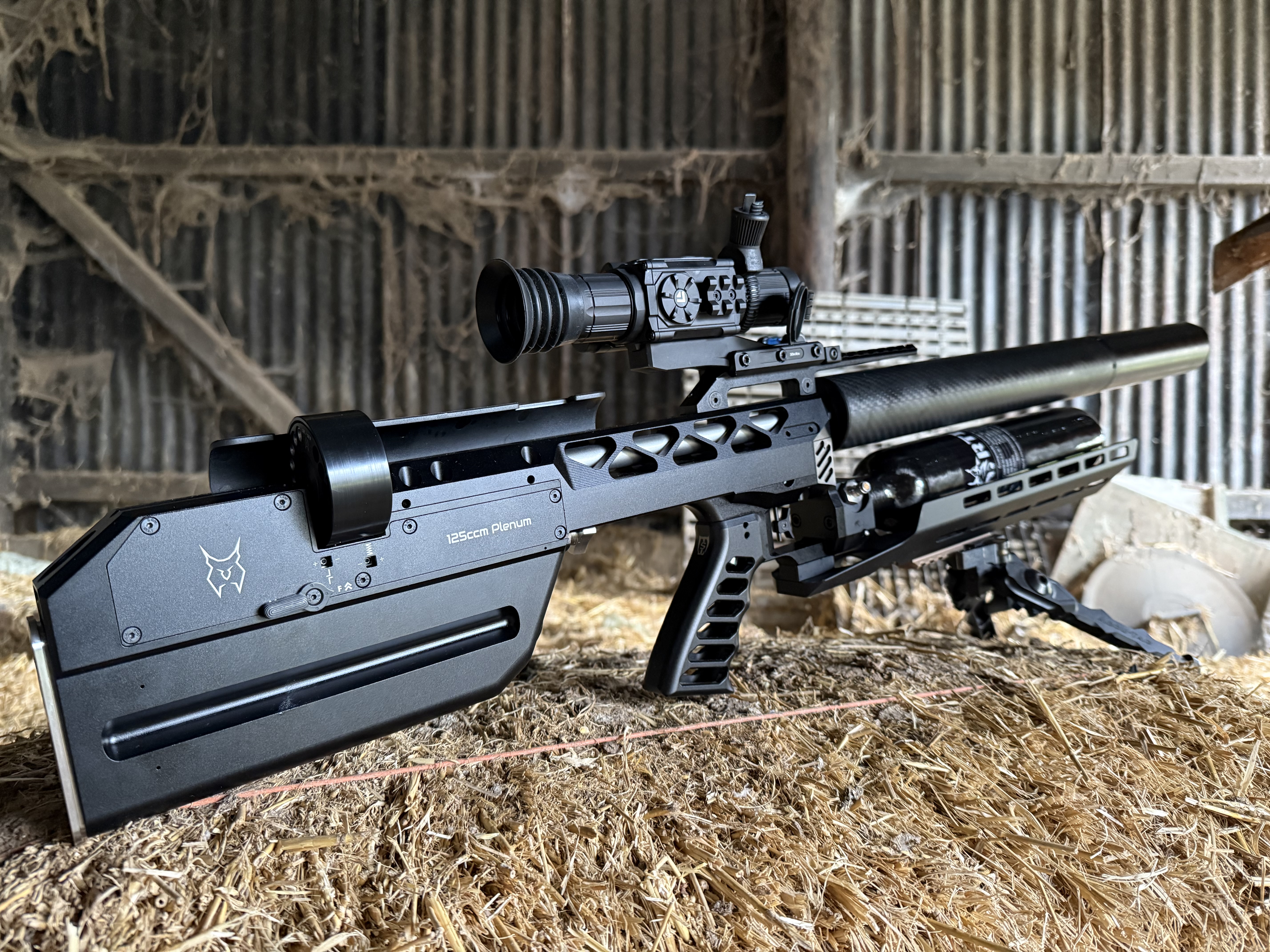

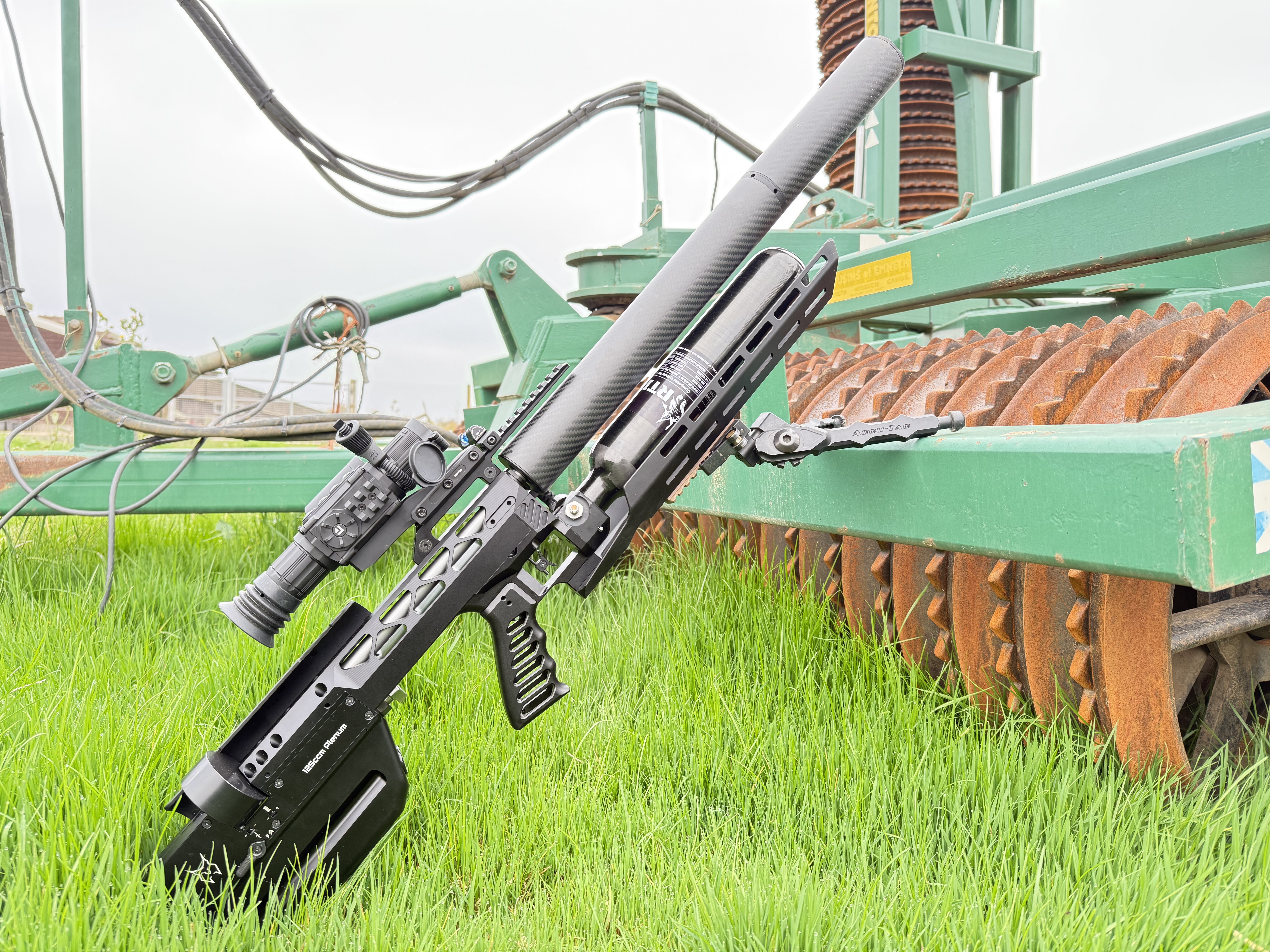

I just thought I would share my experience so far with my newly acquired RTI Mora .
I opted for the compact in .25 cal as I already have the FX king which is on the longer side.
Firstly on my rifles arrival I noticed the heavy duty case it arrives in , wheels for transport and heavy duty clips ! Winner , finally a case I can use and I wasn’t disappointed when I opened it !
the case has foam cut outs for its two included mags various other cutouts for other items and plenty of room to have the guns scope on in the case too!
The rifle come with 2 mags , a rail for attaching a bipod with its mlok grooves , a Hush 50 mod , T-shirt and stickers. What a package for under 2k !
Now for the rifle - picking this thing up I instantly felt like it was built to last ! Whilst on the heavy side I didn’t mind that at all as it’s testament to the quality materials used and also it’s a slug gun so I won’t be carrying it far .
The cocking is slick and really is an improvement on previous models. the two mags built solid and let me tell you after 600 rounds so far I haven’t had one issue with them or the gun itself .
The cheek piece is nice with two adjustable bolts to set the height giving a perfect cheek weld.
The barrels carbon shroud is chunky and looks the business and it conceals a mod underneath so with the shroud and the provided hush 50 moderator this thing is quiet !
Tuning - I set the reg using 5 bar increments to get where I wanted.
Easy ! 960 with 41gr zans perfect .
I then used the hammer to set it just enough that it opened the valve and then added a turn. This added turn gave it a bit more and also ensures when it settles and wears in it won’t go too low. That’s my theory anyway . I then used the valve whilst taking shots to see the effects on targets. It can take some speed away but I let the accuracy do the talking. This gun I have got out of the bag and never loses zero. Solid throughout .

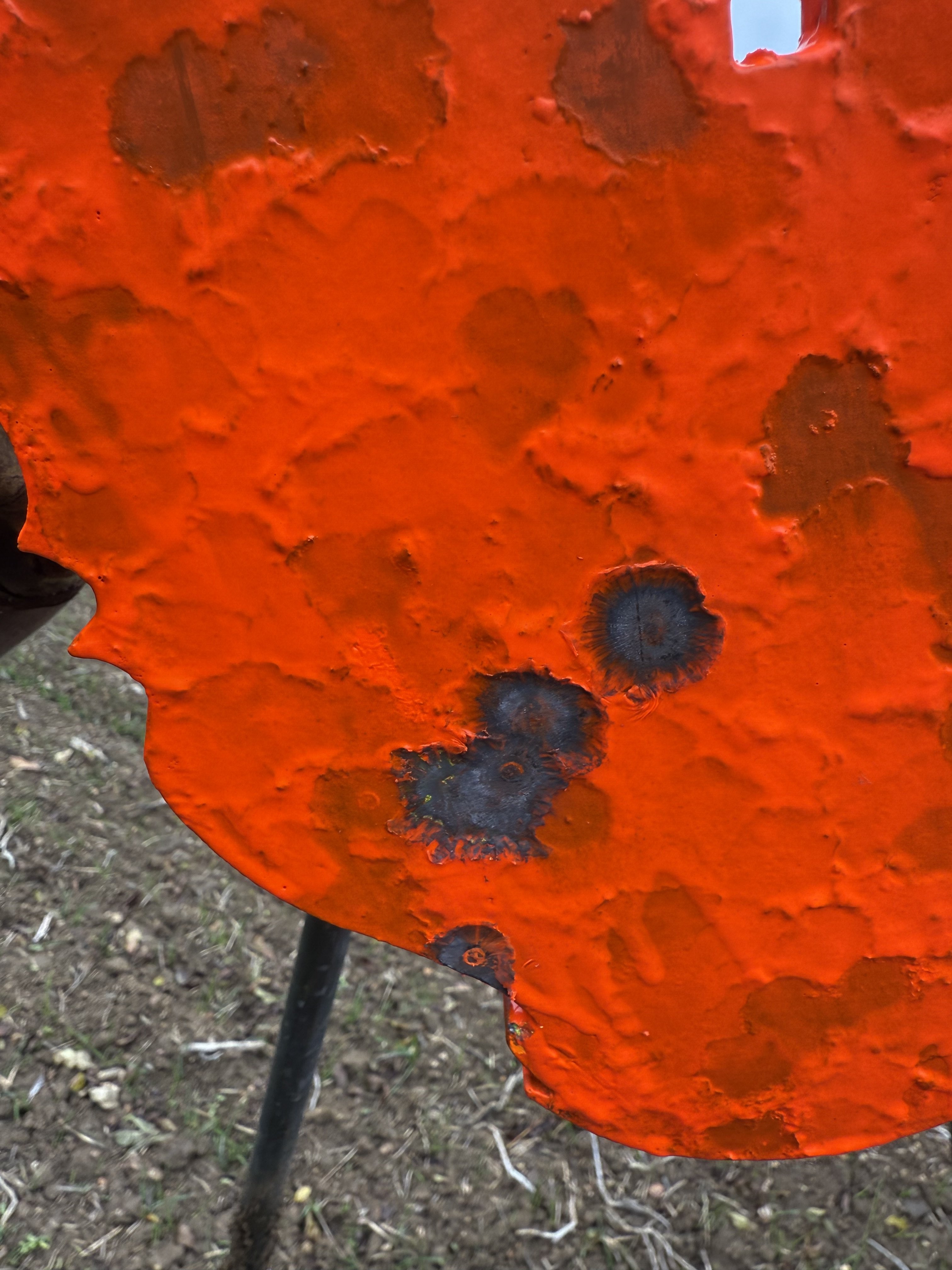

Slinging 41gr zans at 960fps I’m getting sub moa groups at 100 and close enough at 200 !!! Yes 200 with a compact.
Pics below of 200 group and vid if it will let me attach.
Overall thoughts on this gun are its off the charts good ! Consistent as hell , power in abundance , built like a tank and loves slugs !!!
Well done RTI you nailed it
