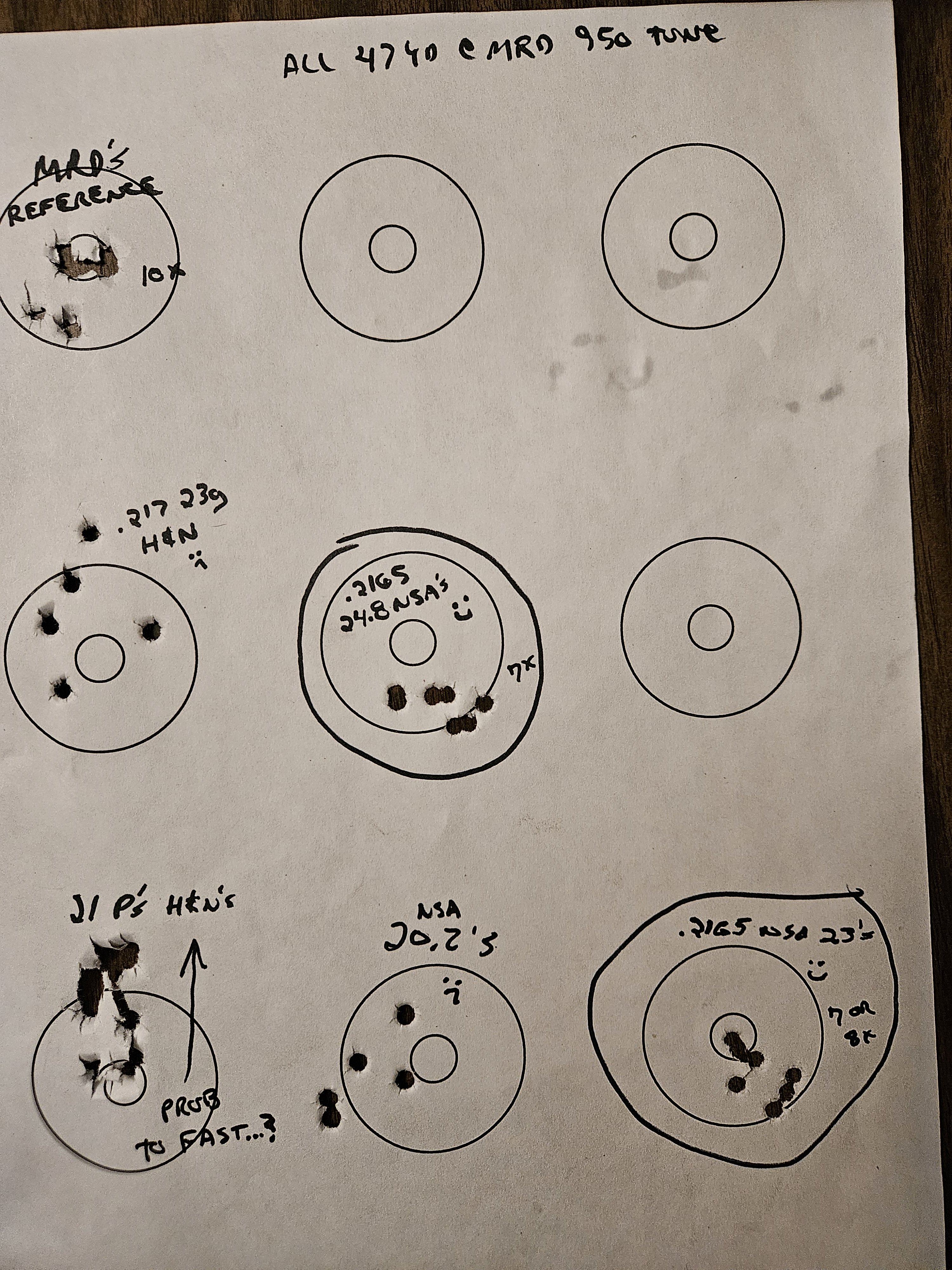

So . . . purely out of curiousity I decided to play a little bit just now in the back yard with a smattering of lighter slugs that I do have kicking around. 'Twould appear that the barrel prefers .2165's as the two that did do reasonably well were both that diameter. Picture says it - 47 yards. ( there is a tree stump in my back yard - it's 47 yds from my shooting table - it's kind of my defacto test distance ) The 21 grain H&N pellets were probably too hot - those thing DO shoot GREAT out of a couple of my other guns - but at more sane speeds - upper 800's, low 900's. The .2165 NSA's in both 23g and 24.8g did 3/4" groups which I'm thinking might be worth looking more into. I've no idea how fast they were going - I made no changes to the gun - I tested everything at the "MRD Tune" - which is 950-955.
Long winded - sorry. So - just out of curiousity - have any of you with this barrel found any kind of joy with slugs? I'm 99% sure based on what I know about the barrel and from hanging out in here that lighter slugs are all that it may(?) sling with any joy. The barrel isn't designed for slugs and as such - not surprising that it doesn't like (most) of them - but I believe I've seen in here and on youtube where some have found happiness with lighter ones.
. . . . not sure what I'm going to do with it - it was my .177 slugger. It may become that again or . . . . . ??? ( if I can get these .2165 NSA's to tighten up at this distance and then hopefully hold a decent group at 100 - or more - maybe . . . it'll just become a "lighter" .22 slugger . . . ? )
Oh -- now that I've uploaded the photo below. The 20.2g NSA's - they were .216's. I wasn't sure at the time I marked up the piece of paper. Again - looks like the barrel prefers the "in between sized" .2165's. Aim point with all of the targets is the center circle.

I tried some slugs from my 1:32 RTI and it was no bueno, couldn't keep em on paper @ 100 yards. Seems like I tried some NSAs in the 20-28grain range, some Varmint Knockers from 22-28grains, and some of the 32.? Gr Altaros. None of those were joy.
BUT, the 1:32 RTI barrel is the best barrel I've ever had for .22 Monster RDs. After a five year long fight with the MRD, something like 35+ barrels, multiple different platforms and multiple rebarrels for most of them, I had concluded that i was divorcing them. I even sold something like 50-60 tins of them at a nearly giveaway price. So, bought the 1:32 from the classifieds here and a friend in LA machined it to fit my Veteran Long. I was hoping it'd like the Grands or maybe even the new but not yet released 21grain JSB. Tuned up my Veteran and the 1:32 RTI for Grands, a nice consistent 925-930fps over the Chrono in the garage late one night. Next day decided to try some MRDs from it, just cuz. The Grands tune produced 960fps with the MRDs, and absolutely amazing accuracy. Soooo good with the MRDs that I haven't even bothered with the Grands from it, partially b/c a different gun is really rocking the Grands well.
Anyway, I did lap the 1:32 RTI barrel, which may or may not have helped. And I'm using old stock MRDs with an FX label on them, they were probably bought in 2021ish? This same batch of FX MRDs never shot this well from any of the other barrels. And by shoot well I'm talking 100 yards. I put ten into about 7/8" a few weeks ago. EBR cards are averaging around 230-232. With this 1:32 RTI barrel, GONE are the typical MRD flyers 2+ inches away from the desired impact point.
