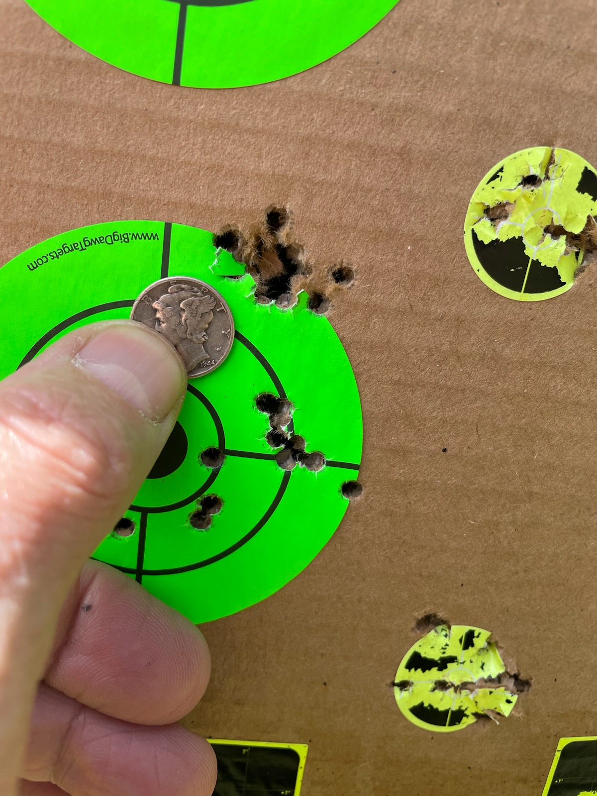

The best " short range " results i have gotten to this point is with the FX Hybrids 22gr.
The group below is a 5 shot group at 33 yards using those slugs.
I have tried Many others, Howler .217 20.2, Zan .218 23, Zan .218 25.5, H&N Slug HP .217 21gr, H&N Slug HP .217 23gr, AVS .216 20.2gr, Avs .2165 17.5gr
as you can see i covered the Gamit in lighter slugs, some were much worse than others.
The gun shoots the 25.39 RD a hair better than the FX Hybrids, and i do Not have to touch the regulator or hammer spring swapping between them, just 2 clicks on the scope elevation knob.
Needless to say I Really like this gun!

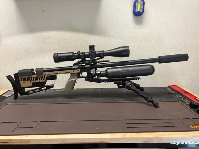

The Gun responsible
RTI Prophet 2 Performance Tuned by Francisco 2.0 Edition (RPB Select Barrel)

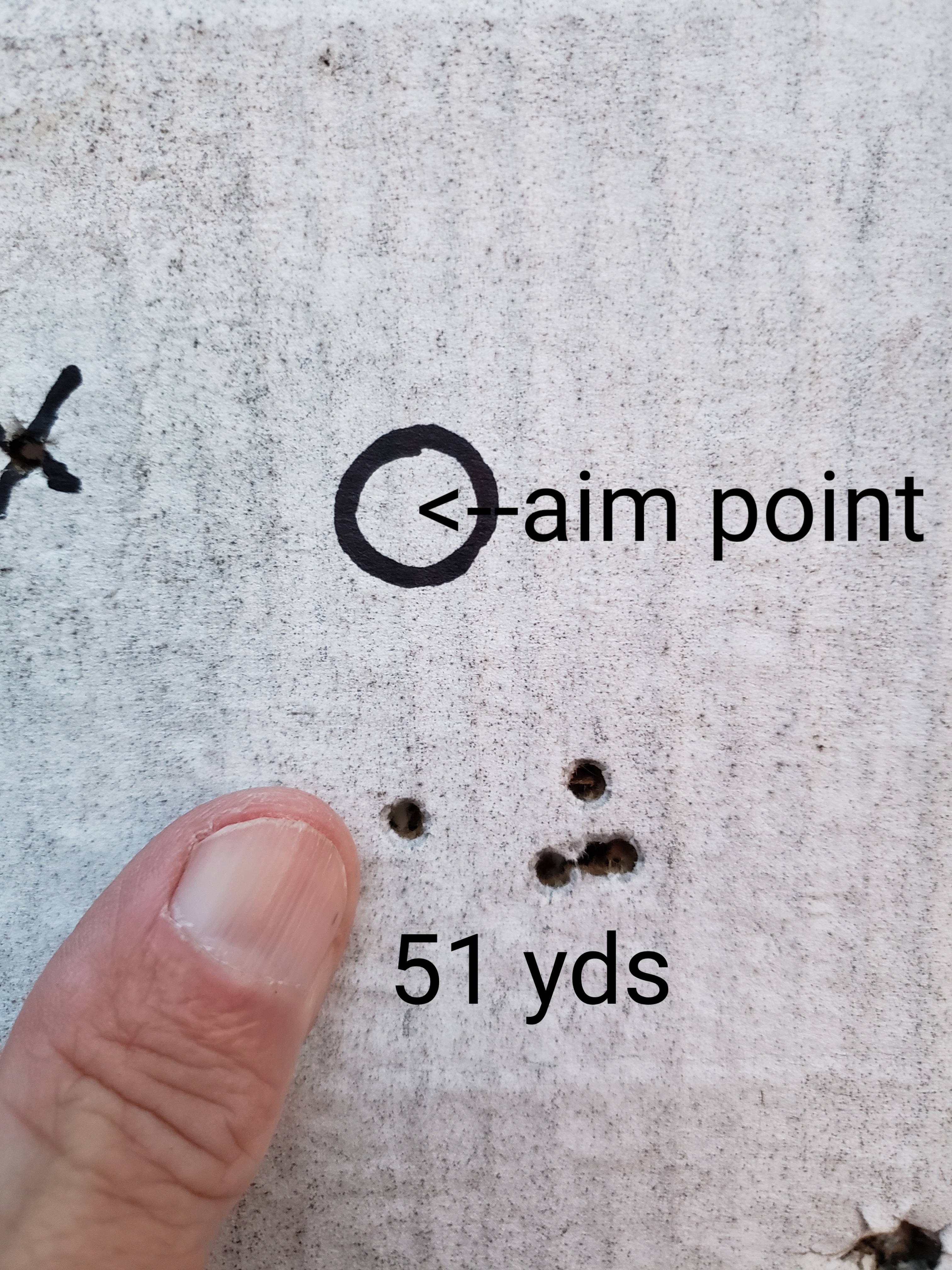

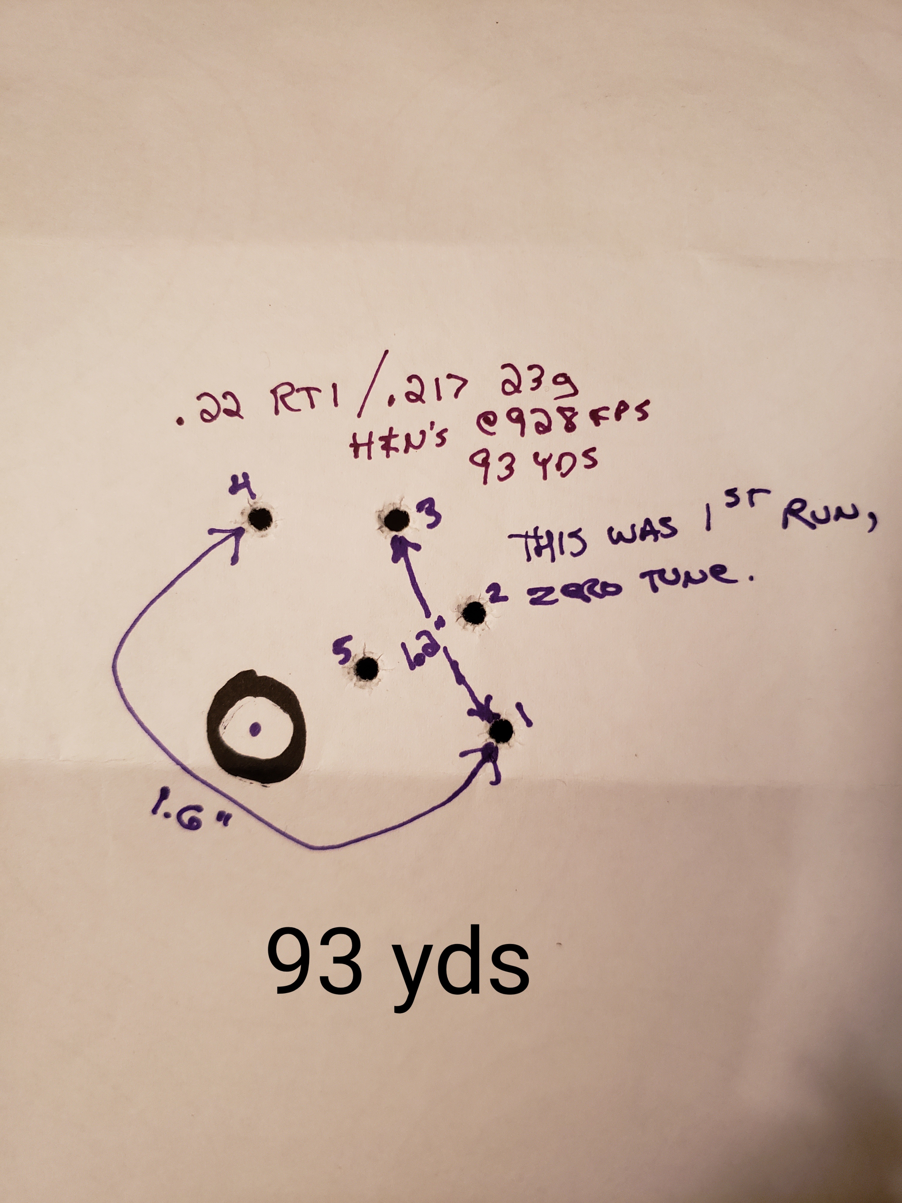

I've been playing a little here & there weather and time permitting. Just yesterday I stumbled on a slug that surprised me and will be getting tested further - .217 H&N 27g. I've no idea how fast they were flying - the last "measured" testing I had done was with 25.39 .216 KO's and they were cookin' @975'ish. At 50 yds they were good - not great - but not bad either - some fine tuning and tweaking - they might tighten up. Or not. I had this unopened tin of the H&N's sitting upstairs and figured - "What the hell . . . give 'em a go." And go they did - they grouped ~really~ well for 1 1/2 mags when suddenly they started wandering. I was coming off reg. It's only 35* today and our neighbors to the north (Canada) are generously sharing a stiff wind with us making it feel much colder. I ain't going out there to do any testing today . . . unless the wind eases up later in the afternoon. :)

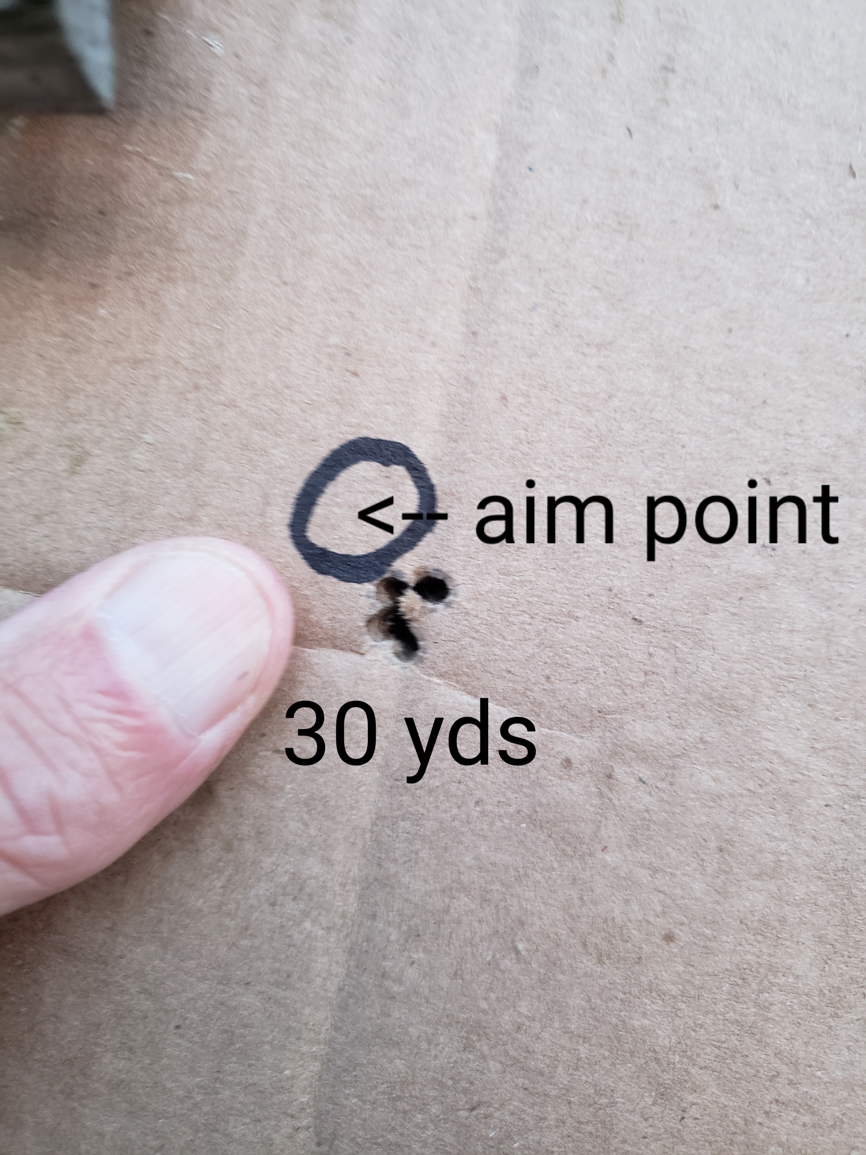

Still trying to figure this thing out ( slug rabbit hole - yeah I know ). I see the results you guys are getting with lighter slugs . . . I kinda wanted to shoot heavier ones - buck the wind, better bc, etc . . . but whatever at this point. 4th and long - punt. ( lol ) I dropped the reg down to about 125 and even put a different scope and rings on it as I hadn't been digging the one I had been using. Me and Molly the dog went out to the range with only an hour or so to kill before it got dark - first thing with different scope - see if I can hit the side of a barn. Get speed first - I figured I'd start out with 21g H&N pellets and get them up to 900'ish. I attached my fx chrony and after 5 or 6 shots -- 915 - close enough. Now to find the barn. "Barn" @30 yds ( big piece of cardboard ) - 7 or 8 shots later - pretty much pellet on pellet. ( Soooooooooo easy to tune for pellets . . . aiy . . . lol ) Now that I can hit the barn - lets try some slugs - start out with the trusty H&N .217 23's that my Taipan Vet (long) likes. The Taipan ~loves~ those things at 923'ish. A couple 2 or 3 more shots over the chrony and adjust hammer spring just a little - 928 - close enough. Send 'em. Not bad for essentially zero tune. I ran out of light - more testing to come. H&N makes a 25g slug I think - have to look - I might grab a tin or two of those - one in .217 and .218. These 23's look promising - if not a little on the light side.

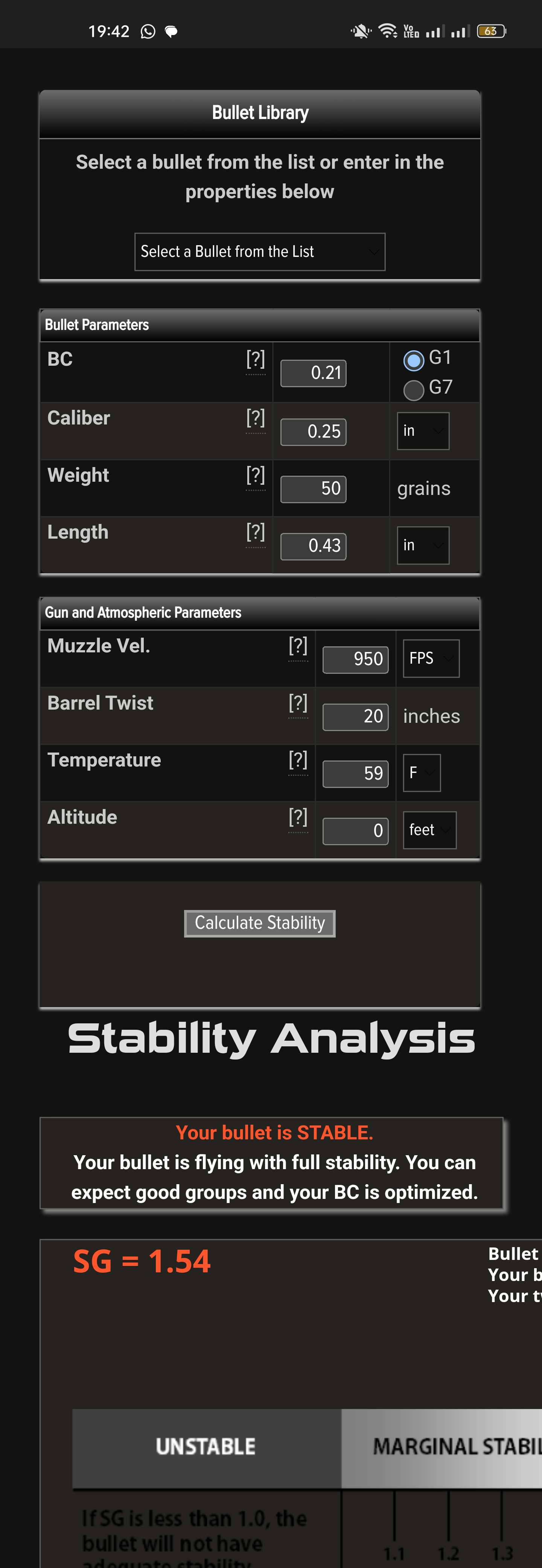

RPB-1 .22 is a 1:16 with (super) light choke and a .217 bore (± factory consistency).
This twist rate works best with 35-40gr projectiles, from ~950 to 1050ish fps.
RPB-1 .25 is a 1:20, same choke. 50gr is a good weight to start with (Altaros Smooth .25 for example).
