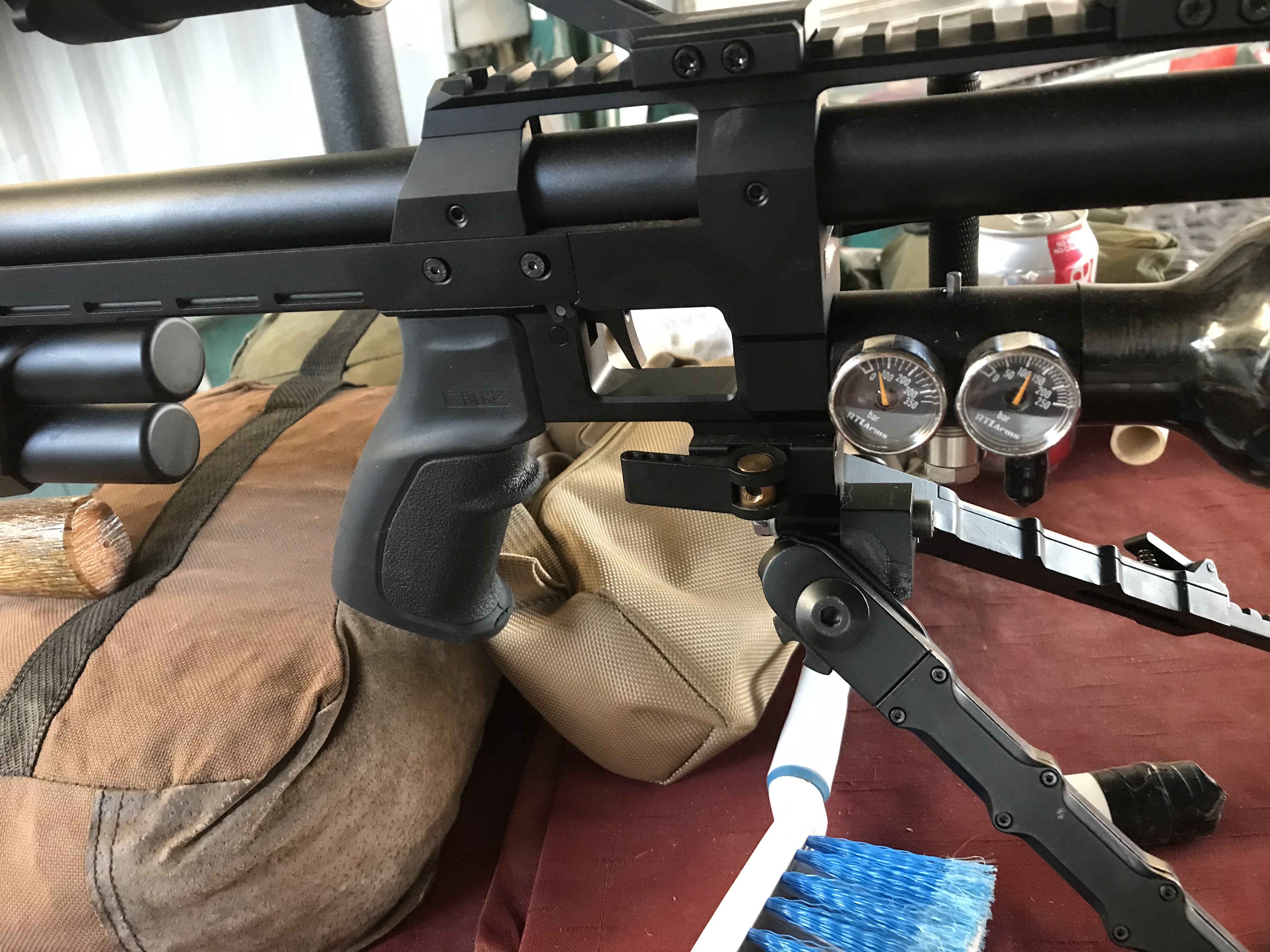

I put two on my Prophet II

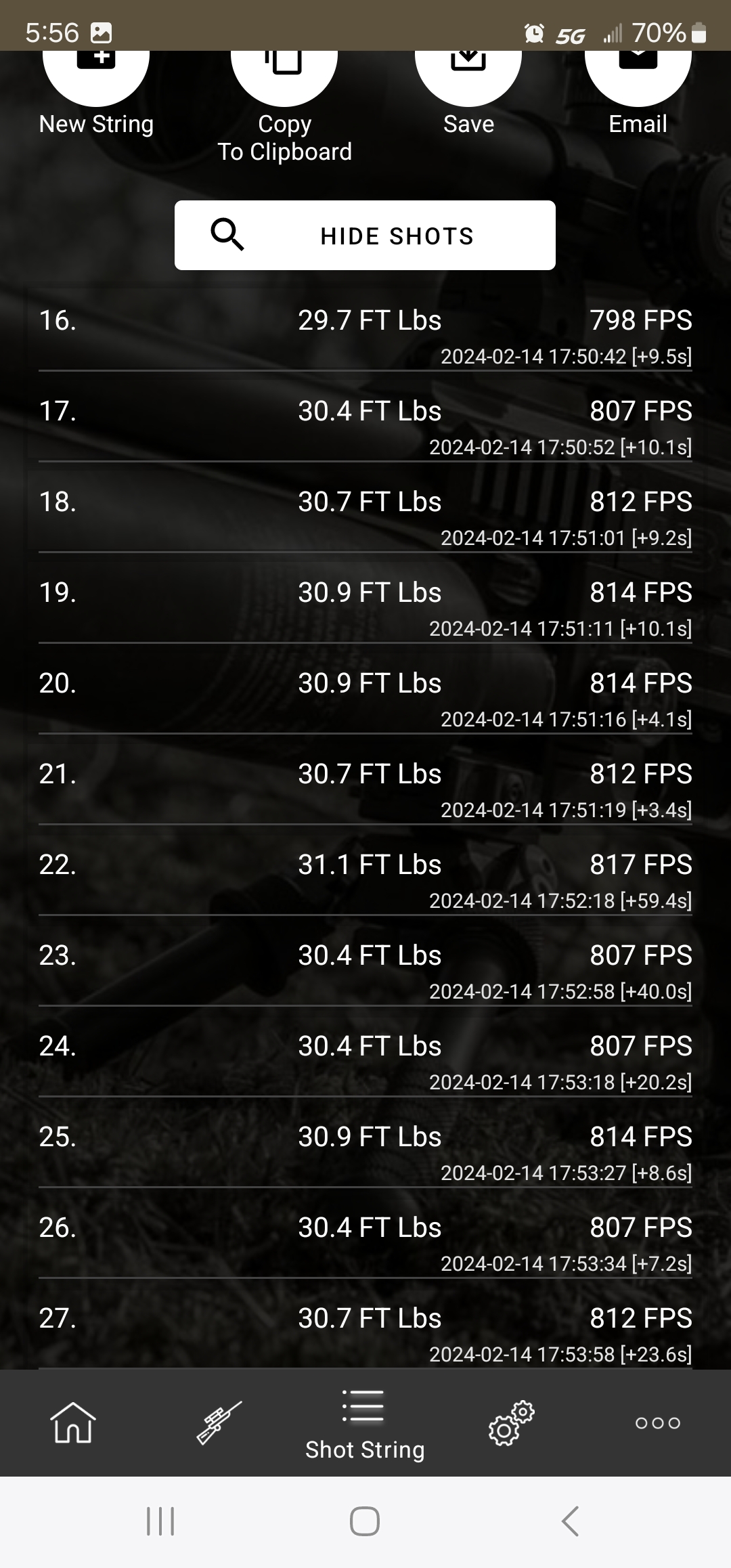

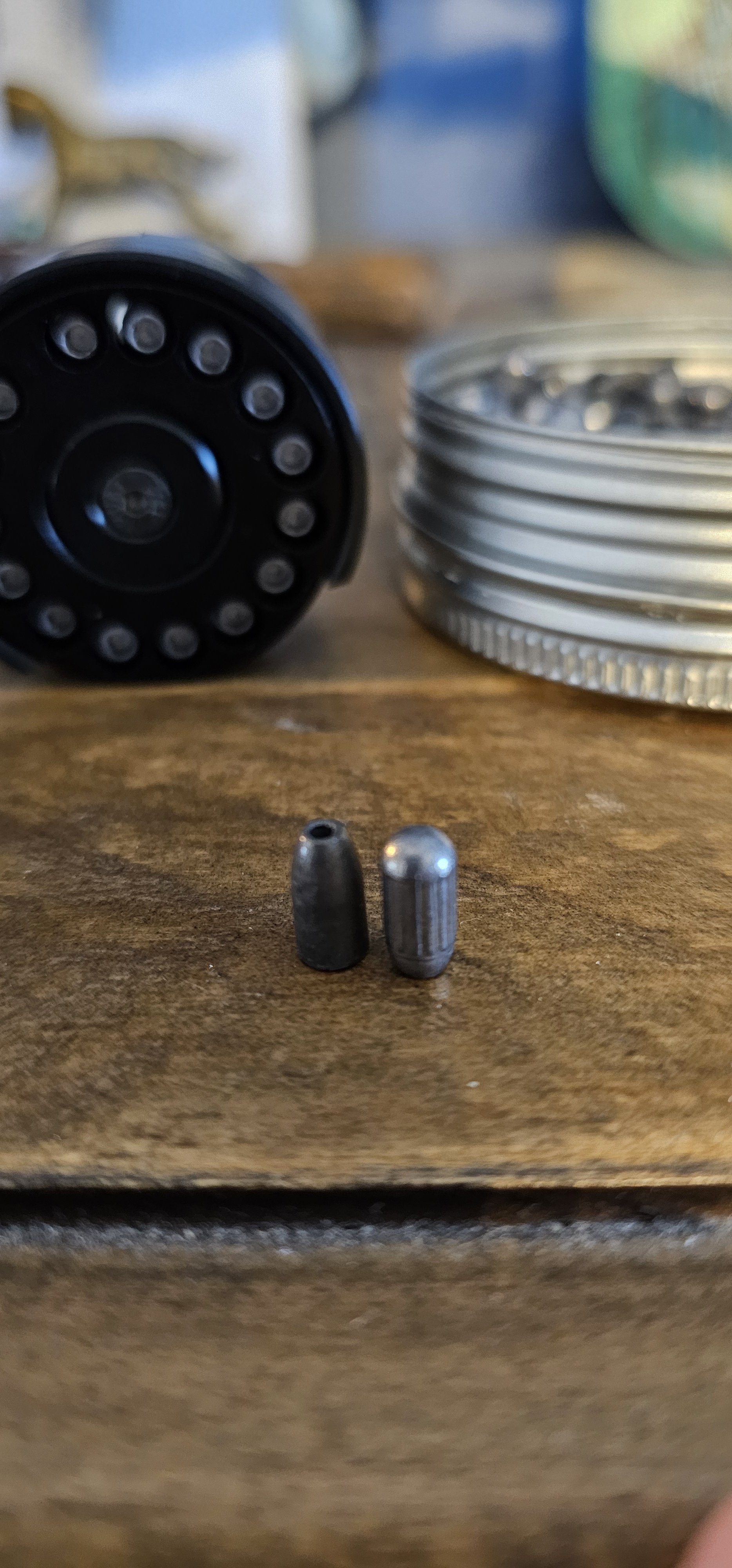

Kinda. It still will not match the 38fpe my evanix rainstorm could do. With 21g piledriver slugs it would punch into my helium tank every shot if strait on. Reg at 180bar stil stall out at 32fpe and just wont penetrate. Wildman 21g slugs are too fat .178 and only do 22fpe at the same settings. I get a pile of shots even at 180bar, but would like to get just that bit more to help me not miss the old evanix again. This string is reg at 170bar on the reg, starting at shot 17, after adjusting the hammer spring, ran out of usable spring at 180bar after this went back to 170bar.
