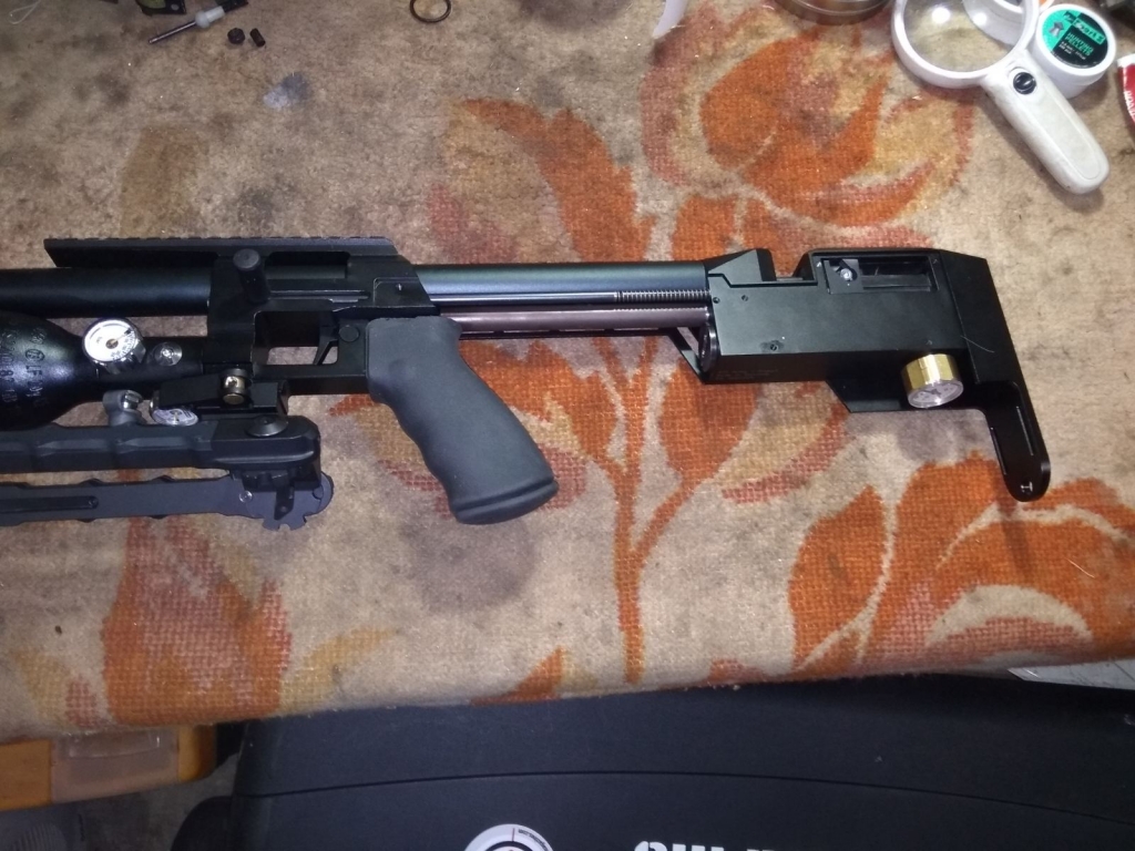

If you have paintball regulator you can unscrew your bottle. I usually put handle between my legs and then unscrew bottle with both of my hands.
If you have adjustable regulator you can screw it in until it closes airflow and then you can unscrew a little bit niple near buttplate to let air from plenum.
I put wika guge instead of niple and when I need to degas plenum I unscrew wika a little bit to degas. But before doing that I close adjustable regulator.
P.s.This is the mk1 but they are almost the same.
