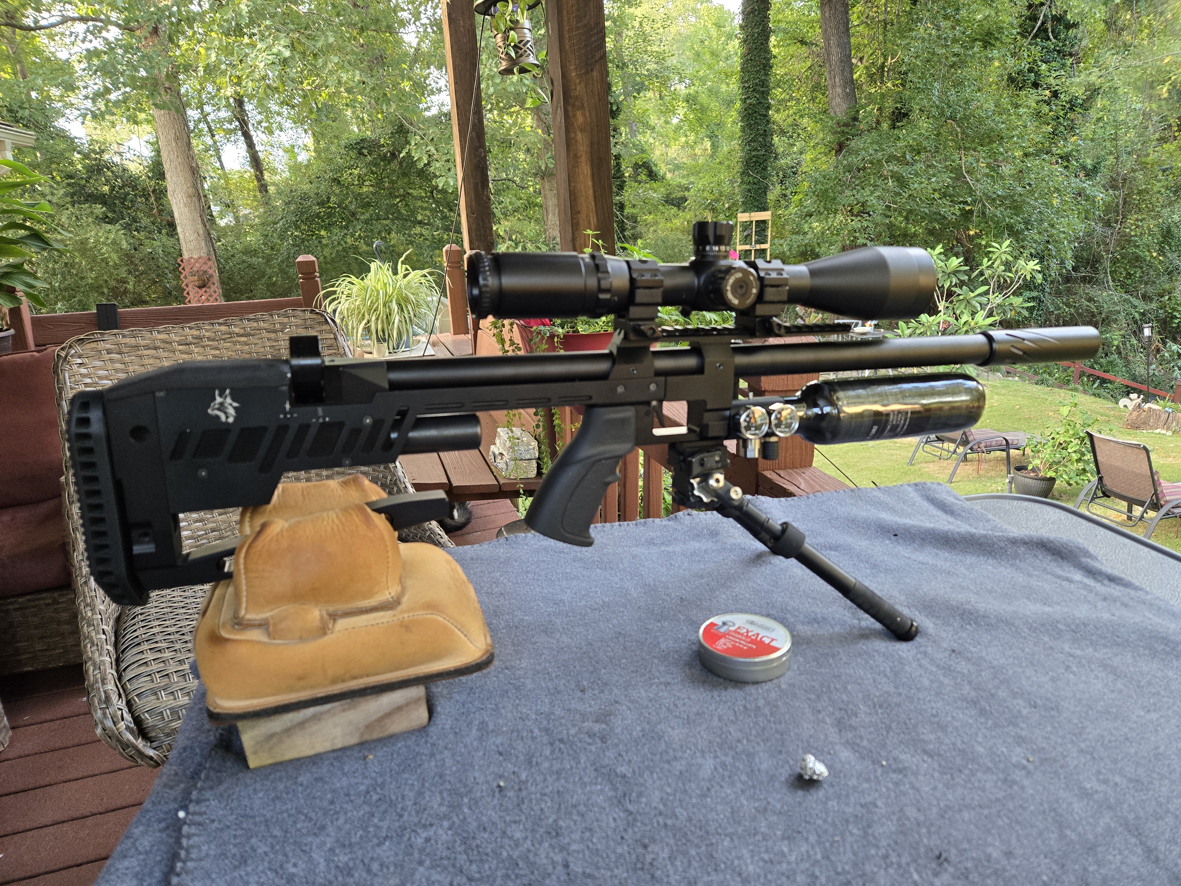

  • Got a 3D printer cheek riser from MRSHOSTED, and it is perfect to get that mag further from my face and allow me to have a better setup. Cheek risers are something I must have on any rifle I have.

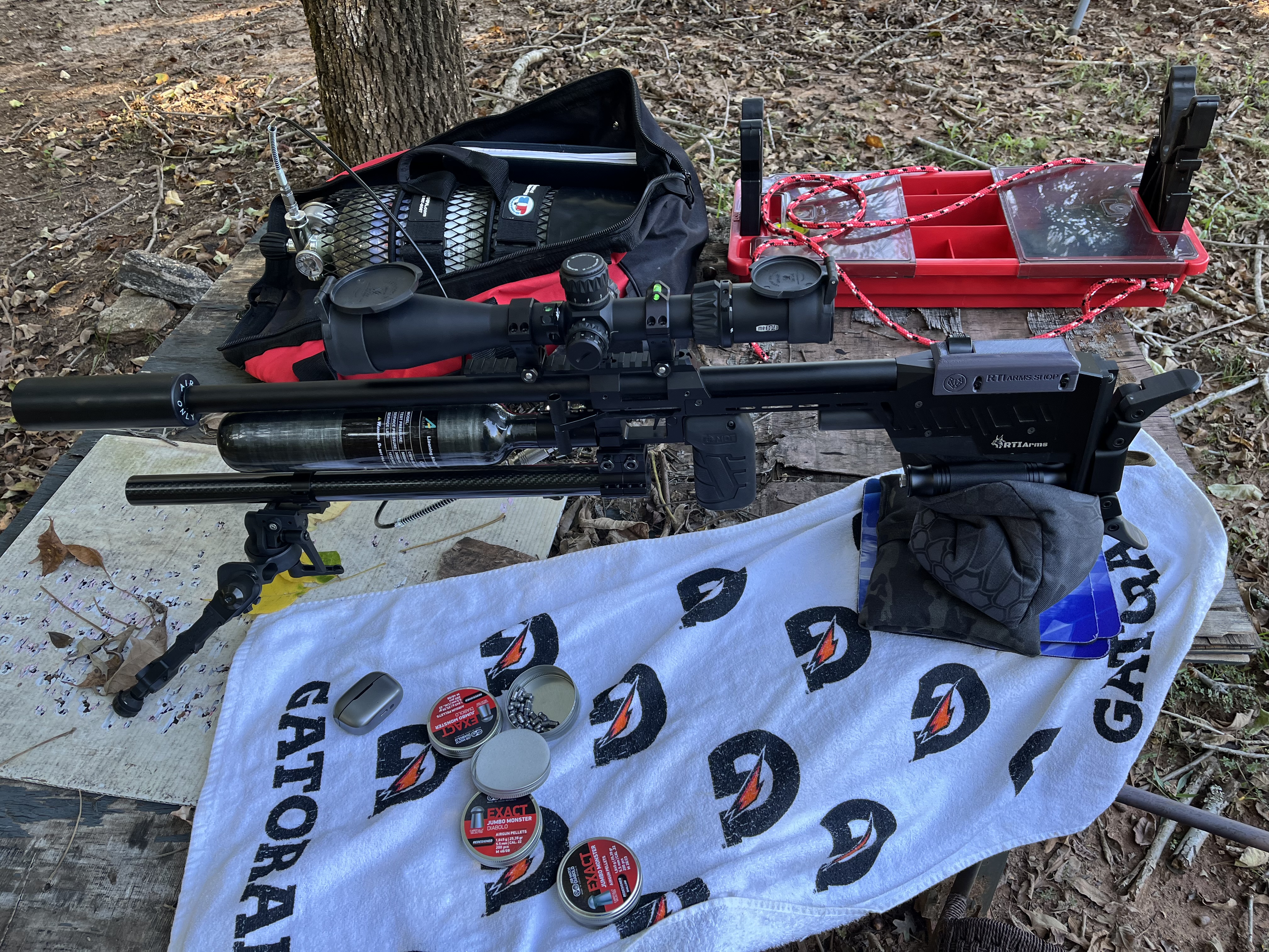

  • I usually don’t like the pic rail way back next to the trigger guard, but the rifle isn’t too tall, so it wasn’t bad. I still used a carbon tube to move the bipod out and to use thr FX Chrony.

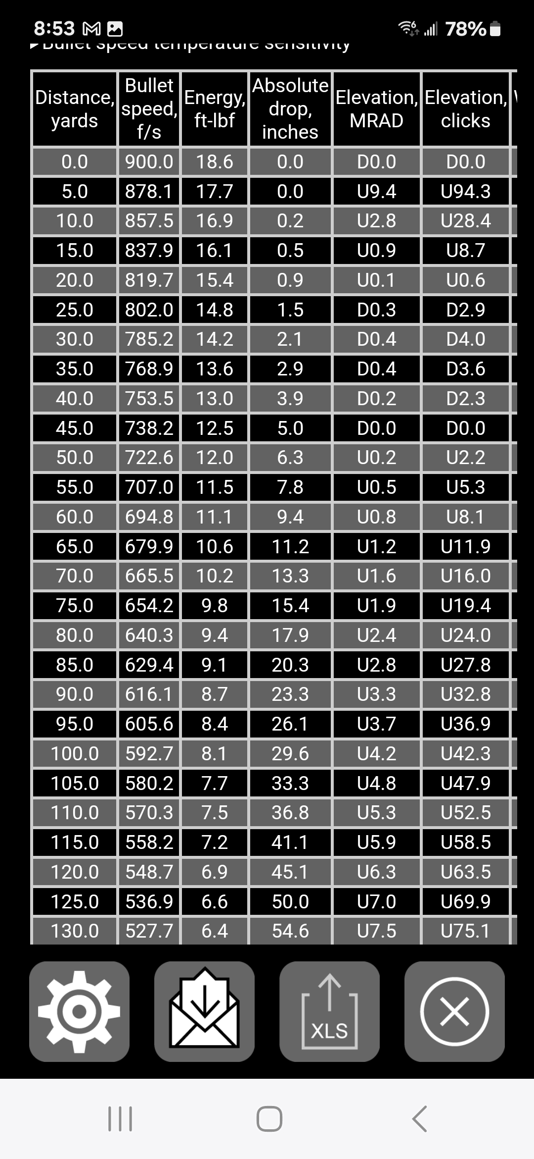

  • Barrel does like 25RD’s… shallow version around 970. The deeps aren’t as good consistently, but are still pretty good most of the time. The AEA version was pretty good too. I tried some of the mid weight pellets, and it liked the JTS 21.53 pellets A LOT on the same setting around 1000. Didn’t do a lot of testing, at many different speeds with all those, but would buy some more of these to test.

I added a Saber Tactical Pic rail to mine. Tried the CF Tube idea, but mine just did not seem solid enough and raised the rifle a little too much for my tastes, but I do like the look of yours.

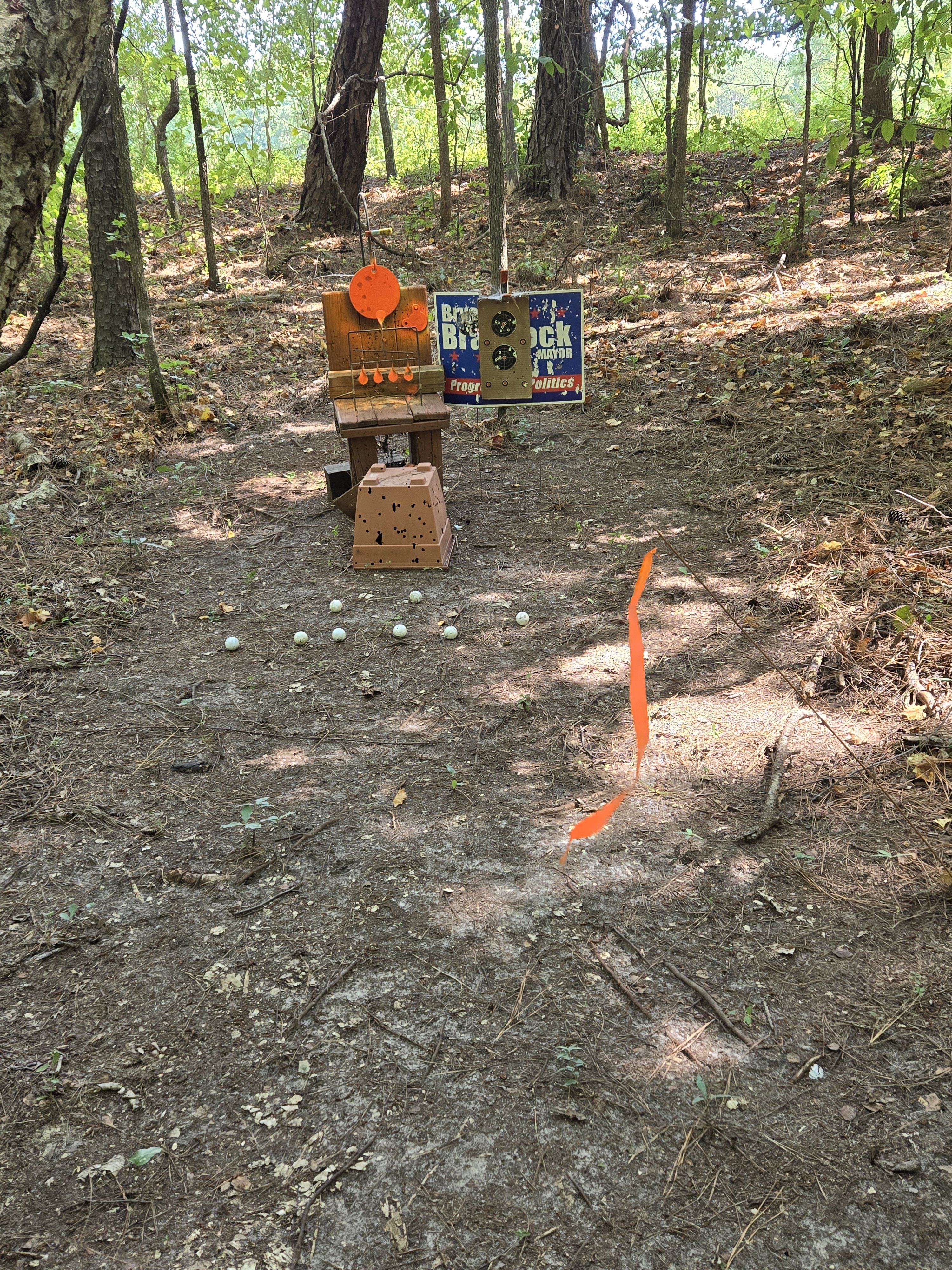

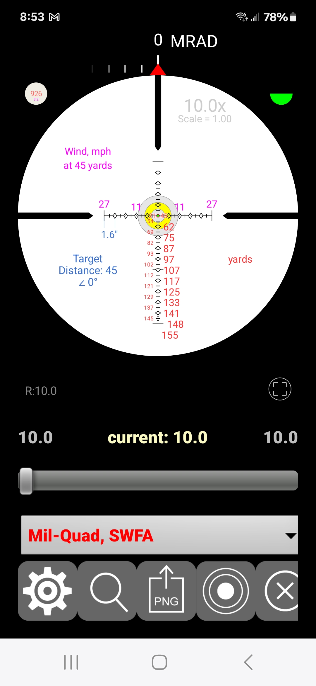

Had my prophet performance 1 compact out yesterday. Golf balls @ 100 yds. Jsb 10.3 @ 900. Zeroed @ 45 yds after a couple shots for elevation nailed them. The cz 400mm .177 bbl is lights out accuracy. Will stack then @ 55 yds and small clover leaf @ 70 yds. Sweet little gun.
