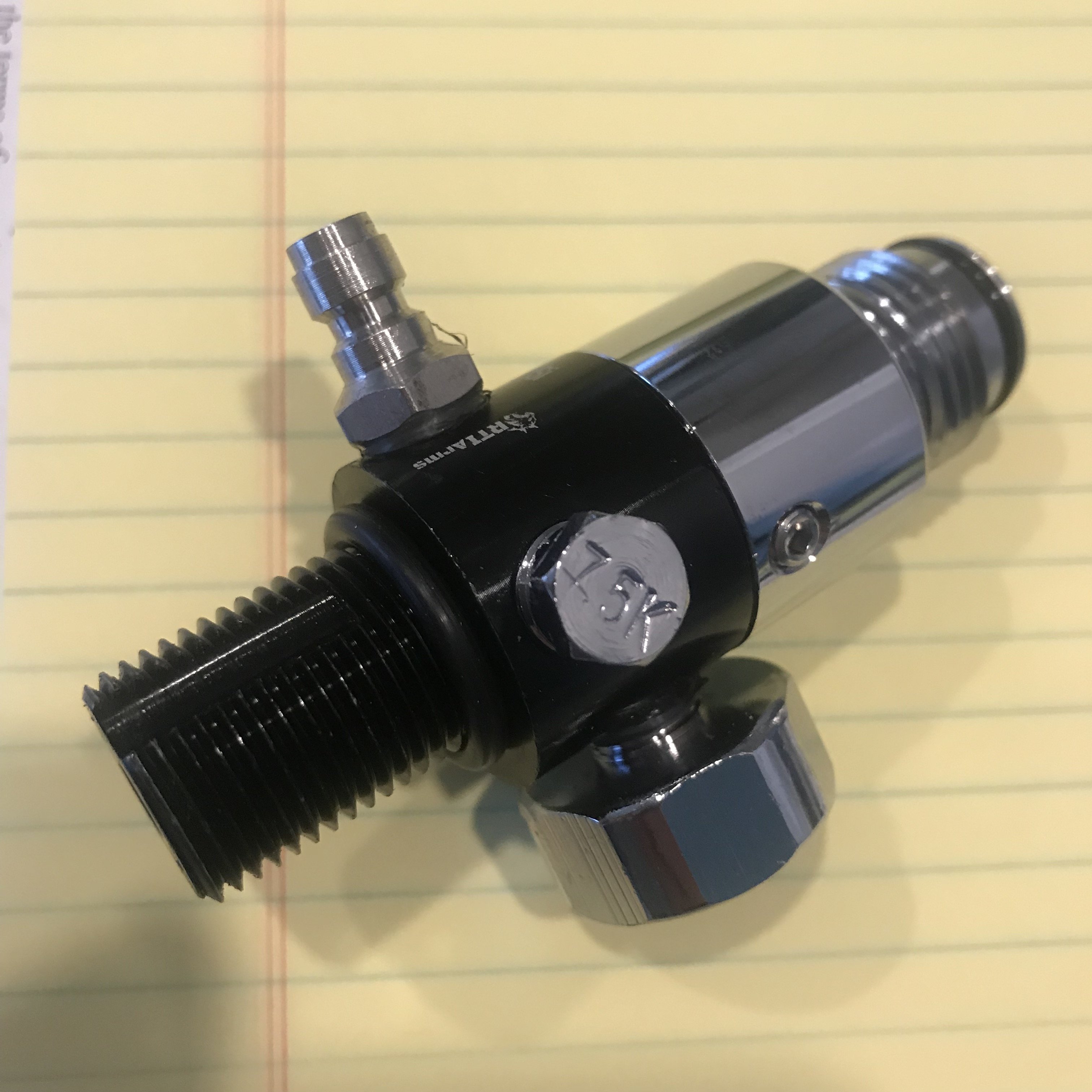

Hi.. Another RTI question. I tried emailing the RTI guys in Spain, but I think there may have been a translation error..anyway

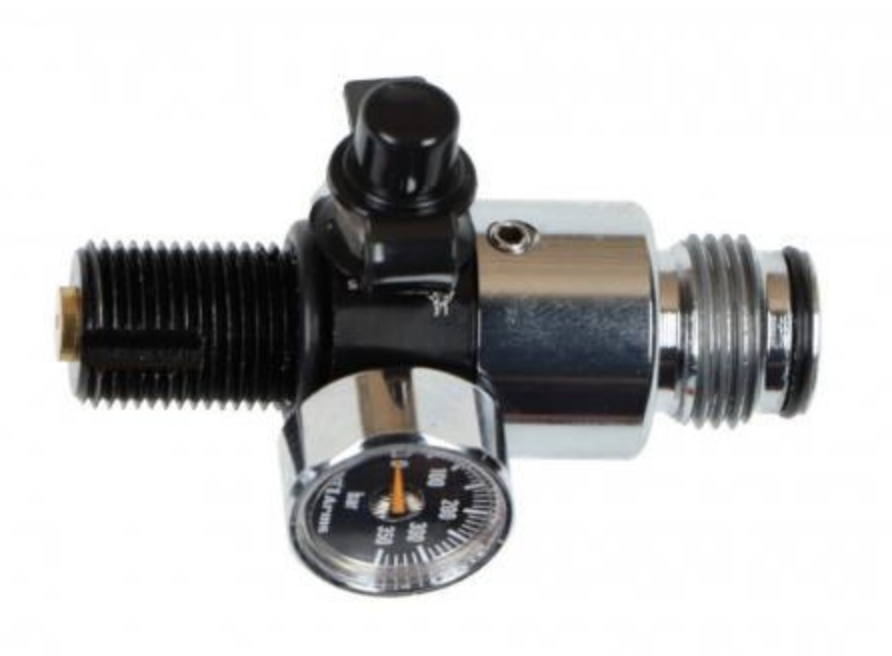

The question is regarding the positioning of the Foster Fill and the Pressure gauge. All the photos I seen of both the adjustable and standard regs have the Foster and gauge at 90 degrees relative to each other.
Picture of Standard Fixed regulator from the RTI website..

When I received my Prophet1 Standard from them my regulator looks like this...
The Foster and gauge are at 180 degrees to each other.
I need the Foster and gauge to be at 90 degrees. Can I just unscrew and swap the Foster and the hex nut (plug?) marked 75K? Anyone know the o-ring sizes each requires? It really looks like the o-ring under the Foster fill is squished pretty good..or maybe that's rubber cement..IDK.
Any help or suggestions would be appreciated.

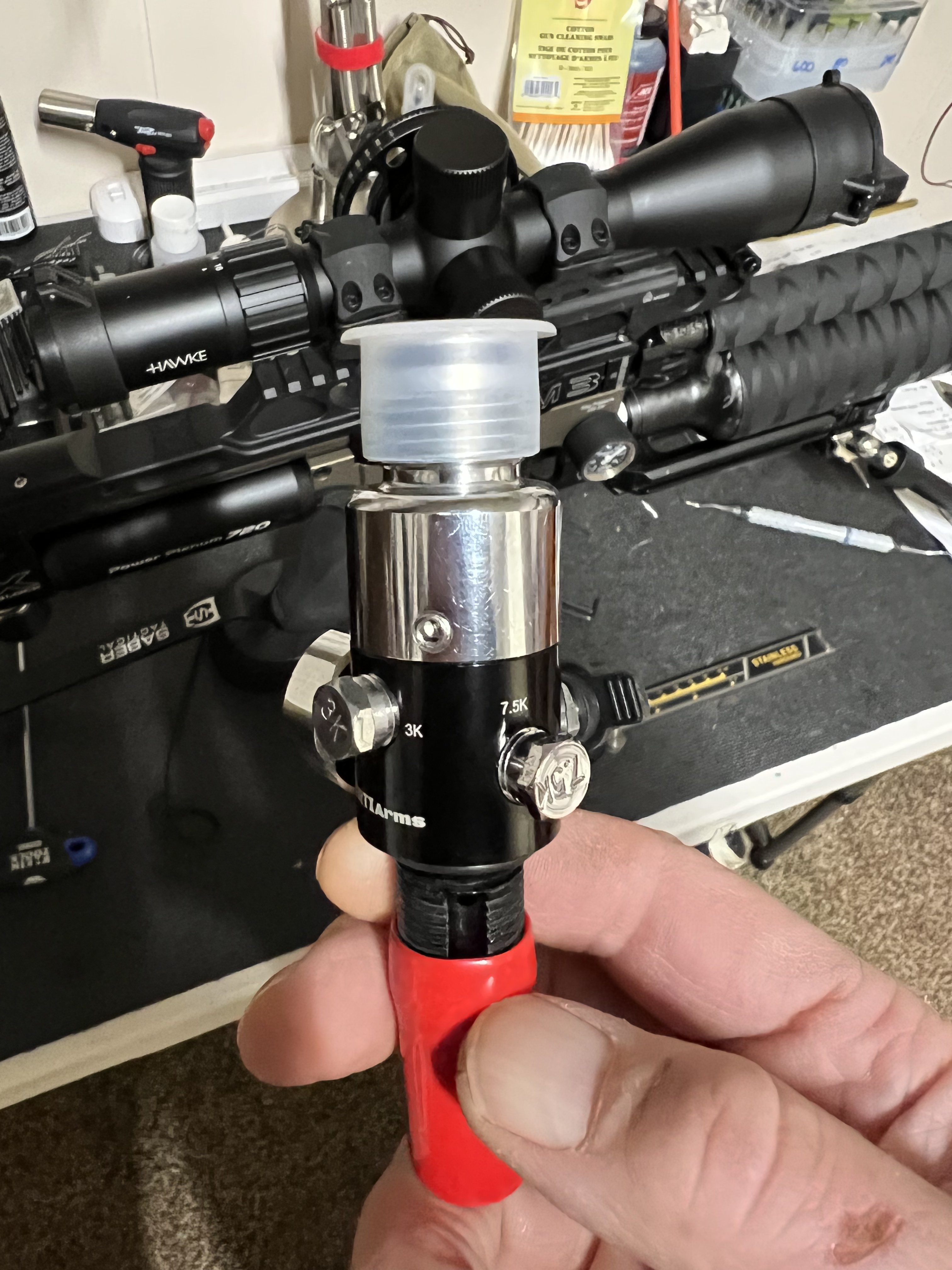

Here is one of my fixed regs. Yes you can swap the 7.5k burst disc and the foster. See how they are in line with each other? Your 3k burst disc should be screwed into the low pressure side of the reg. Your gauge, foster and 7.5k are all on the high pressure side of the reg.

This is my regulator
And there are 12 in mine. It’s set for 134b.
