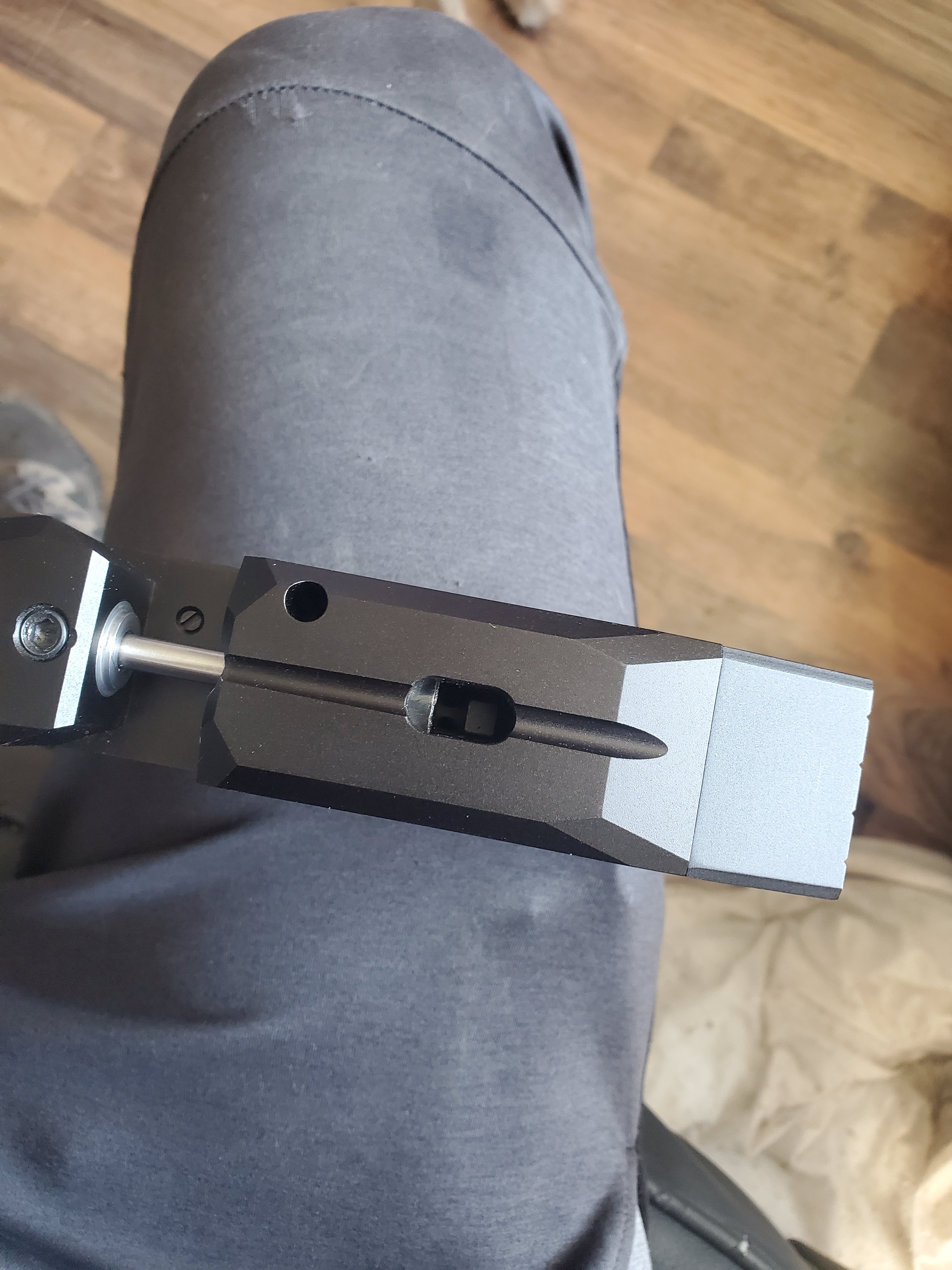

Looking for some advise I have a p2.1 that's blowing air from the hole above hammer/probe where you can see into the action. It's a blast of air with every shot fired any ideas what it is ?

It's not coming from there it's from the hammer vent hole I'll see what rti say and let you all know the outcome

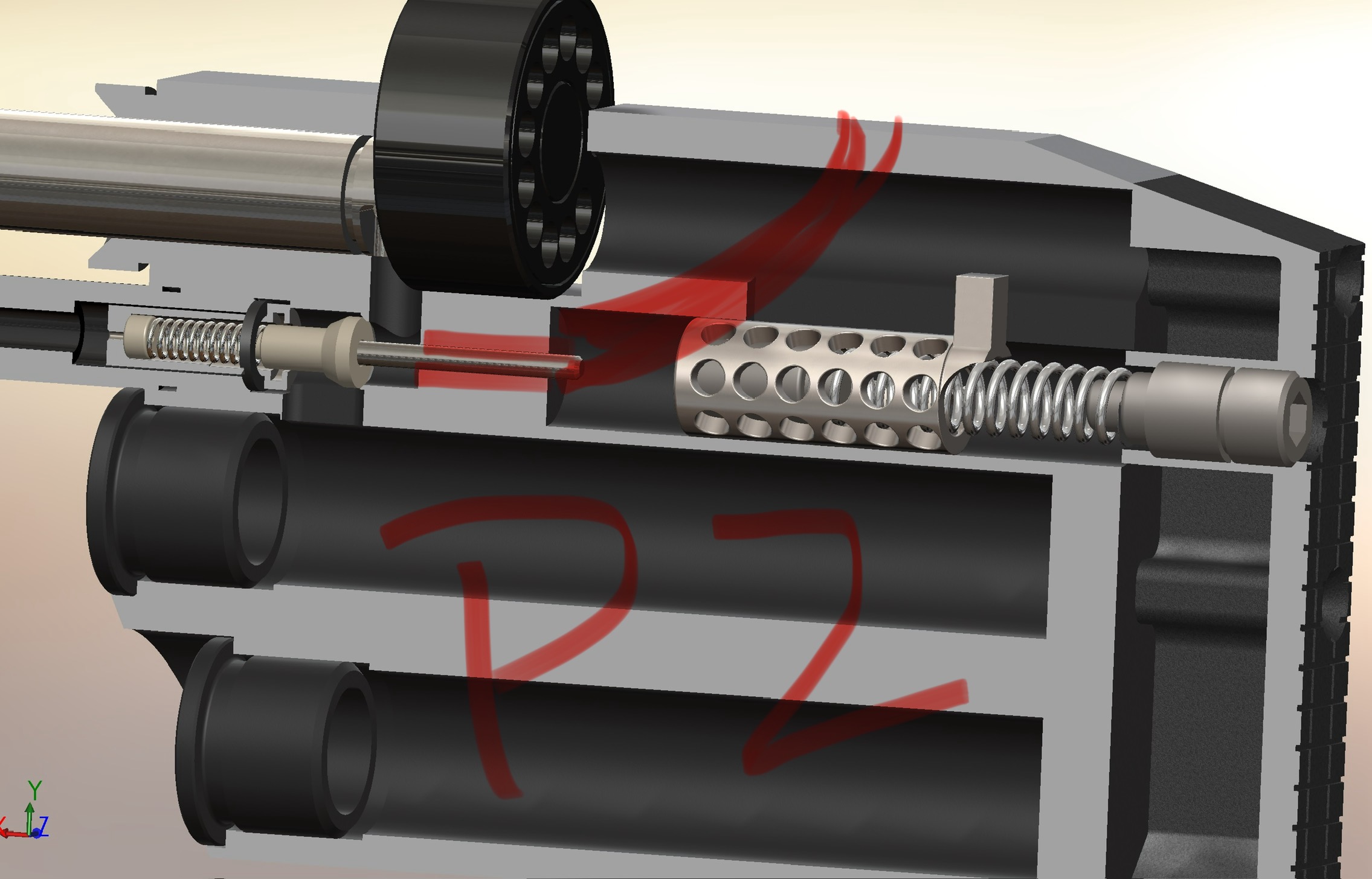

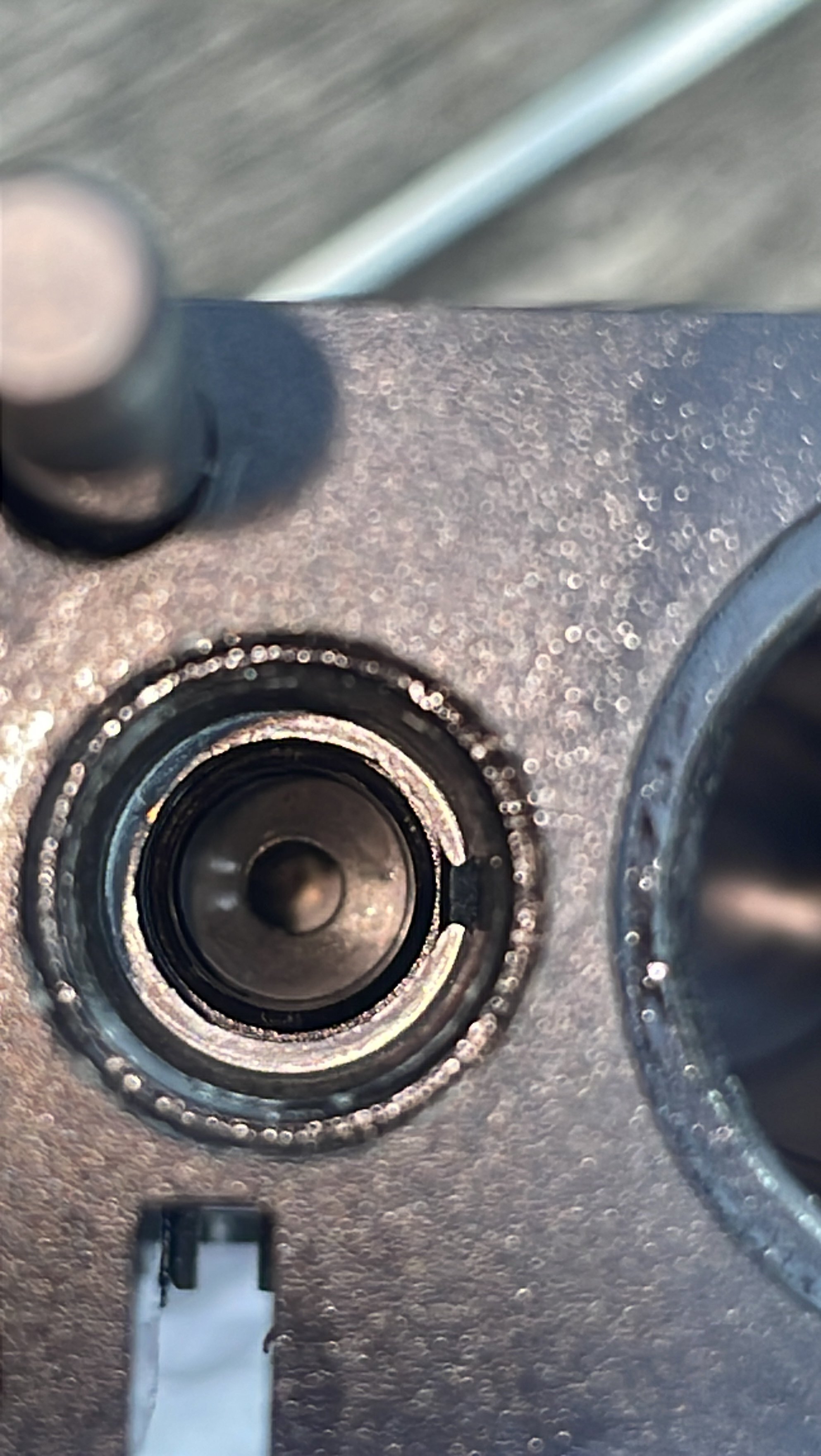

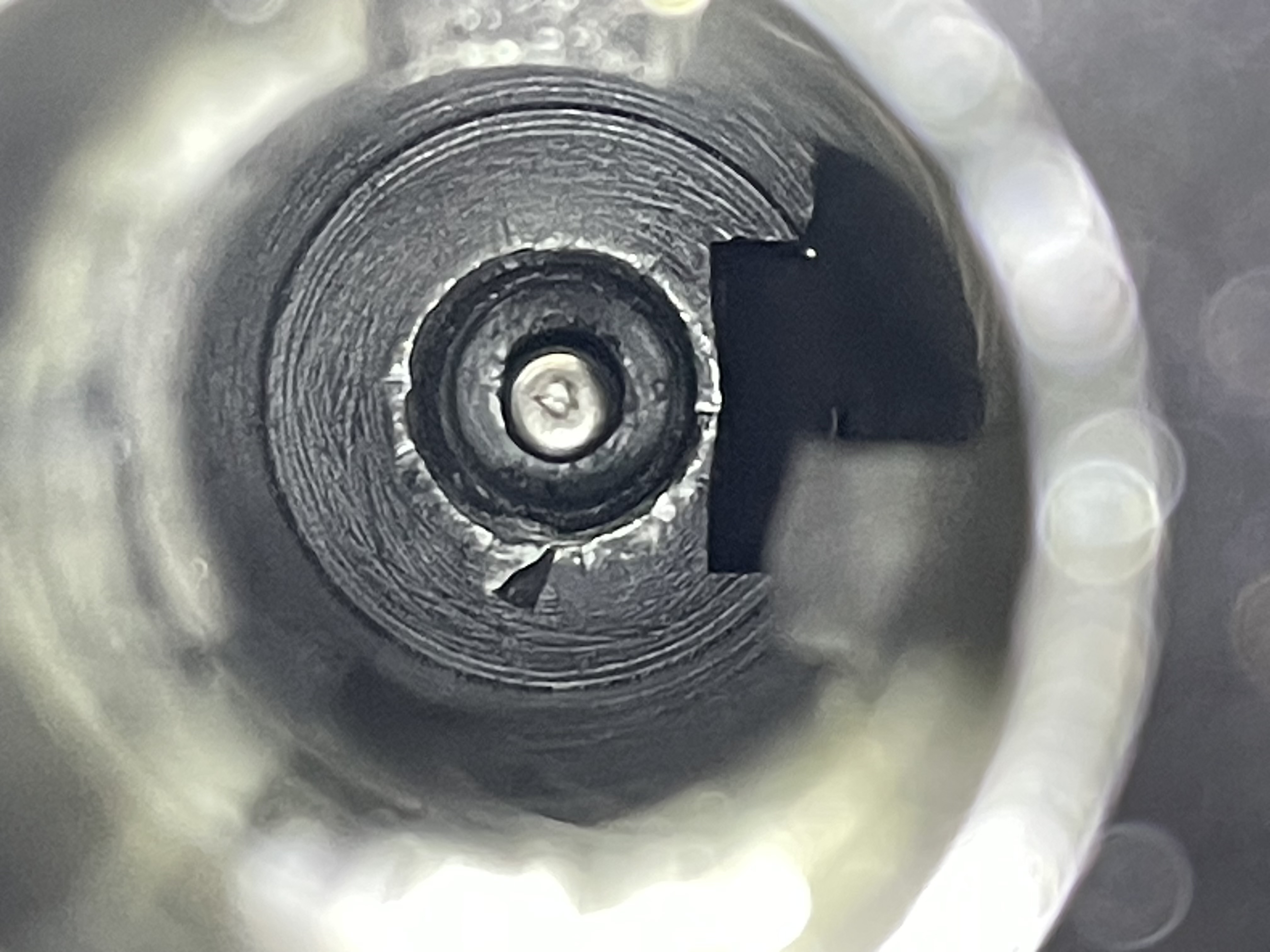

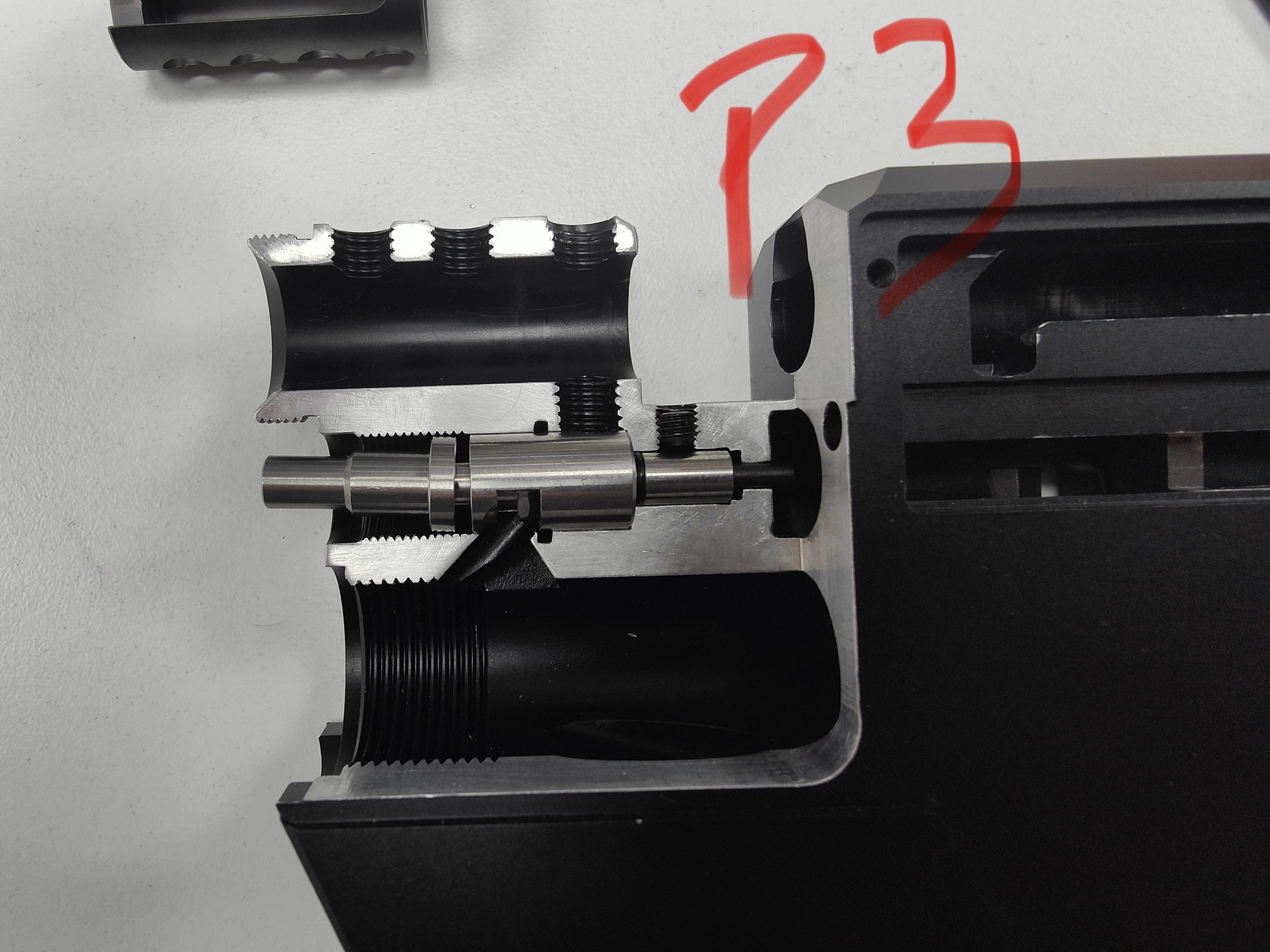

Hello. It is air that leaks through the throttle stem that passes through the block. The picture of the p2 (from the internet) is not accurate, it differs from my P2 in that the valve seat and internal block are not flat, but it allows you to understand how the stem and the block are joined. According to my crony, nothing to worry about, although it is somewhat annoying. The design of the p3 (internet picture) is improved. There are also photos of the valve seat and the inside of the block on my PP2
