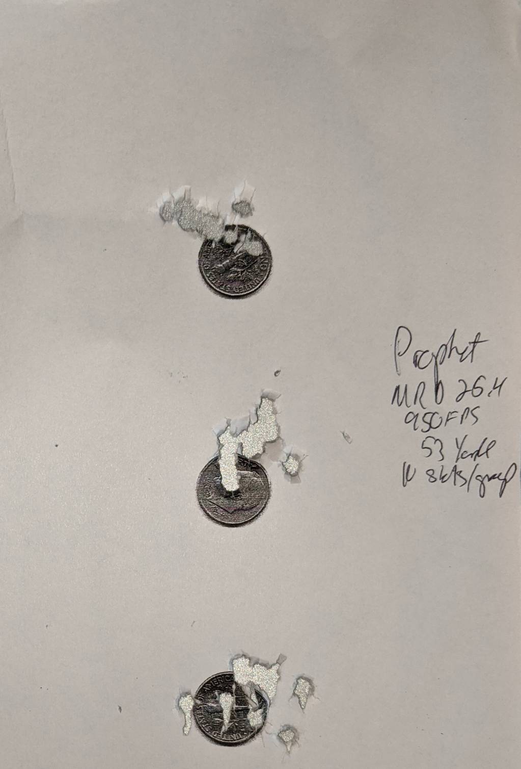

3, 10 shot groups @53 yards. Power still around 51fpe. Winds 5-10mph from right to left.
30 consecutive shots
"Dimes" are true to scale dimes.
Pellets straight from the tin, and what a rough tin it is-nearly every pellet has a mangled skirt, some REALLY bad.
I think this gun is going to do impressive things at 100 yards.

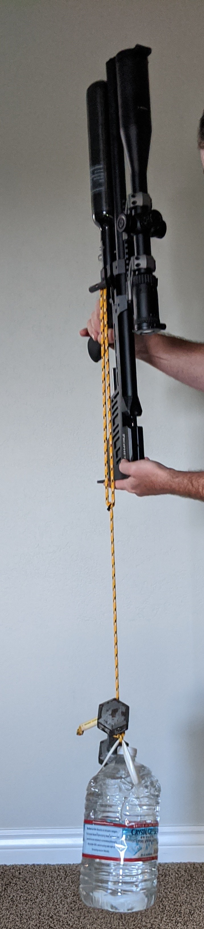

For Steve and anyone else curious about the cocking effort......
Been thinking for a few hours how I could somehow measure it to give someone a better idea of force required, not using subjective terms.
I checked the specs on my Lyman trigger gauge and it said max 12#. I didn't want to overstress it either......
Came up with this......
Still less than ideal but at least some sort of data.

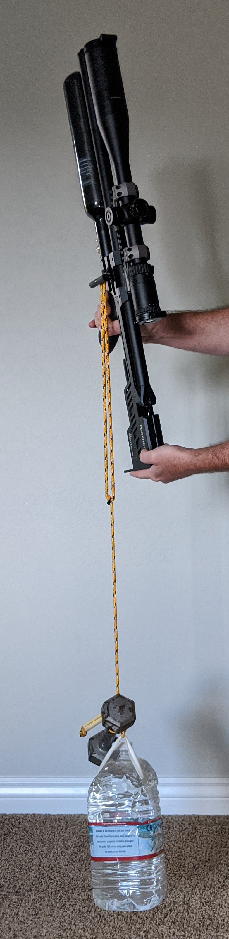

The wife's dumbbells are marked 5# each. I tried it first with two and couldn't get it to cock.
It would, however, cock with a 5# dumbbell combined with 1 gallon of water (which the internet says weighs 8.34lbs).
So, my best guess at cocking effort @ 50fpe....... more than 10lbs and less than 13.34lbs.
I played with the angle a bit, and also have the loop of the rope not quite on the cocking handle but rather the shaft, so it'd be a little more accurate 1/2inch further out.
Also gave the gun a very slight bounce to simulate cocking by hand (like we would when cocking the gun-at least I know I don't creep up on the cocking handle with slowly increasing effort).
It's not a perfect method, but I was pleased to see that I didn't have to hang two 25 pounders on there to get it to cock.

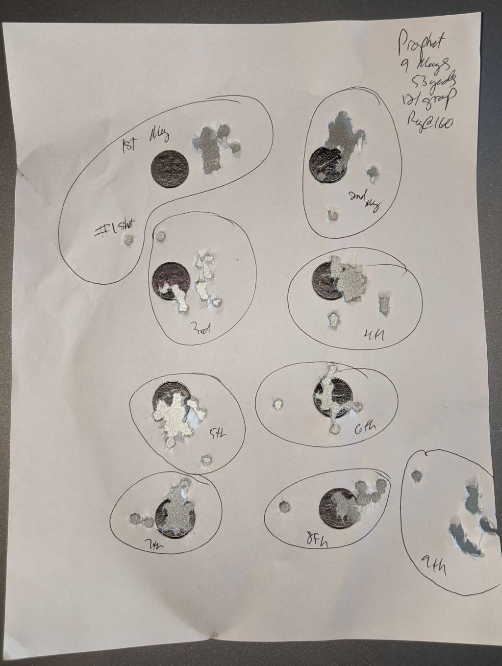

Well, I just put 9 mags through the gun (108 shots), over the chrono, and at paper at 53 yards. 1 mag per group.
Pressure from 260-115 bar. Reg pressure still @160 bar from before.
I'll do some data plots and get the string analysis posted later this evening.
Cursory glance looks like 72, 50-52fpe shots "on the reg", then the fps goes up to roughly 980 for about one magazine, then comes down to 50-52fpe for another mag, then drops off a cliff.
So, six good mags, another two with a bit bigger spread, and then Wiley coyote and an anvil.
(The spread isn't great, even for the 72 "on the reg" shots.)

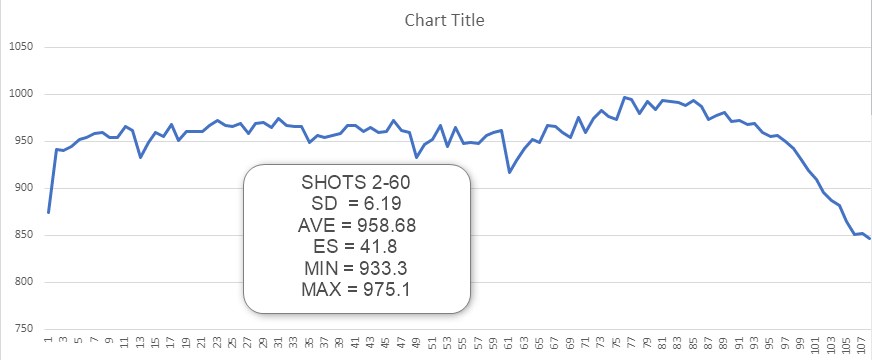

First off, data for shots 1-100
Shots 2-72
Shots 2-60
Analysis
Generally we can see that the fps rises after shot 72, which happens to be when it came off the reg. There are also some outliers really wreaking havoc with the consistency, for example shots #1, #13, #49, and #61 were low fps.

Oh yeah, here are the shots above, on paper, @ 53 yards, WITH those junky pellets. (the last 5 or 6 shots were hitting so low that they were below the paper so technically there are only about 102 or so shots on here). Dime target/aim points are true to size (about 0.7inches). Shots were taken just holding center of dime, best I could.

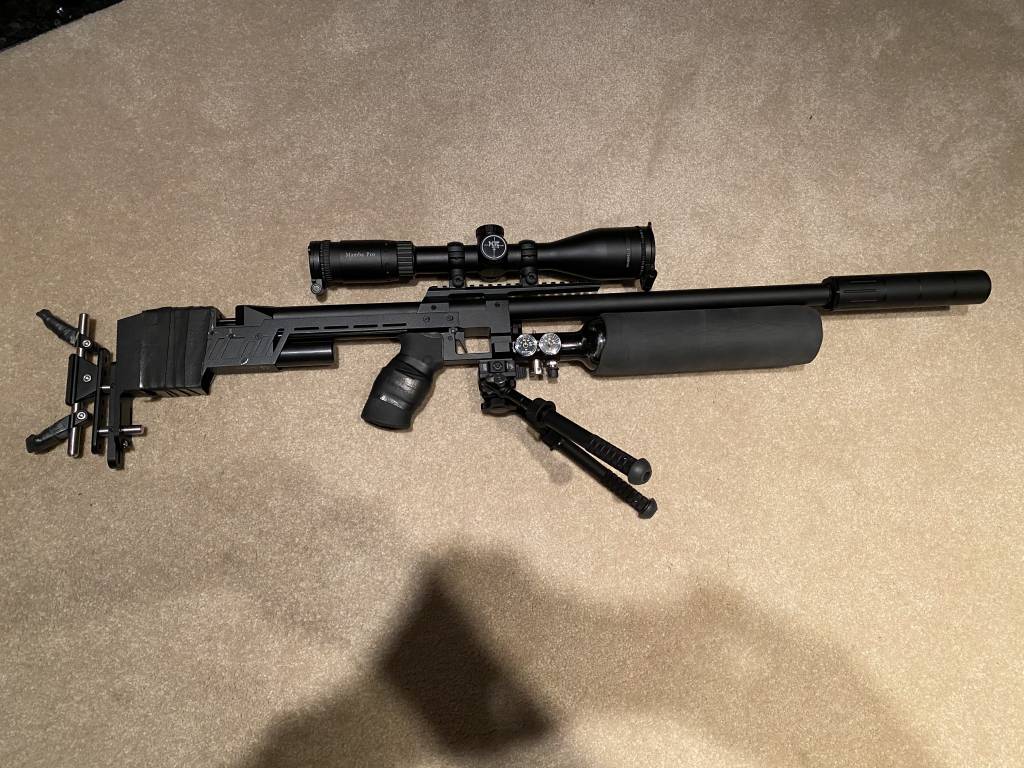

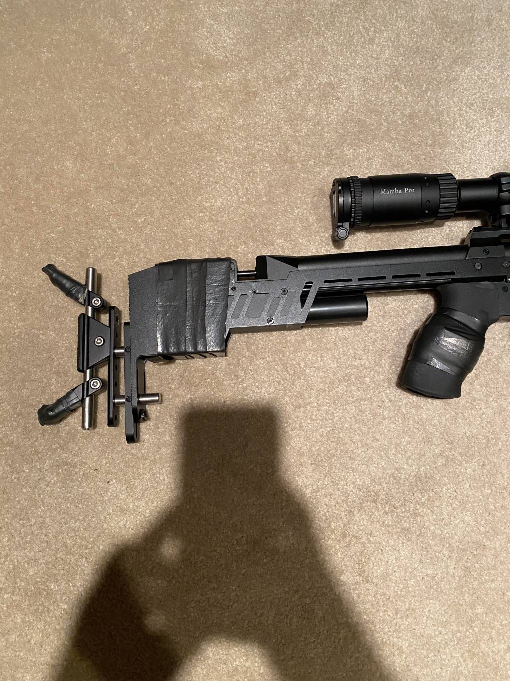

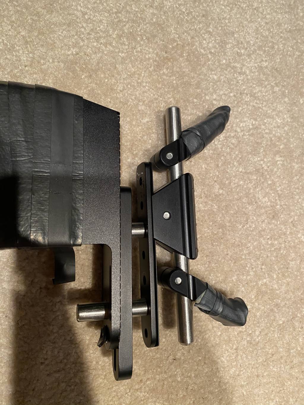

Here is my 25 cal Prophet with a fix for the stock now fully adjustable similar to what's available for the FX Impact from Kraford and Lypt . This is all aluminum and stainless steel . I wrapped the blades of the stock with 23 mm road bike inner tubes for extra grip and comfort .I also wrapped the stock pistol grip with Racket ball tape to build up the palm swell. Also added same racket tape to create a more comfortable cheek area. Planning to change to a black leather cap style cheek area cover .. Also added a neoprene cover for the carbon bottle for protection.
That's making it your own right there.
I've installed a similar winged butt "pad" on a springer and it equated to much more consistent shouldering and therefore point of impact.
You made a nice addition.
