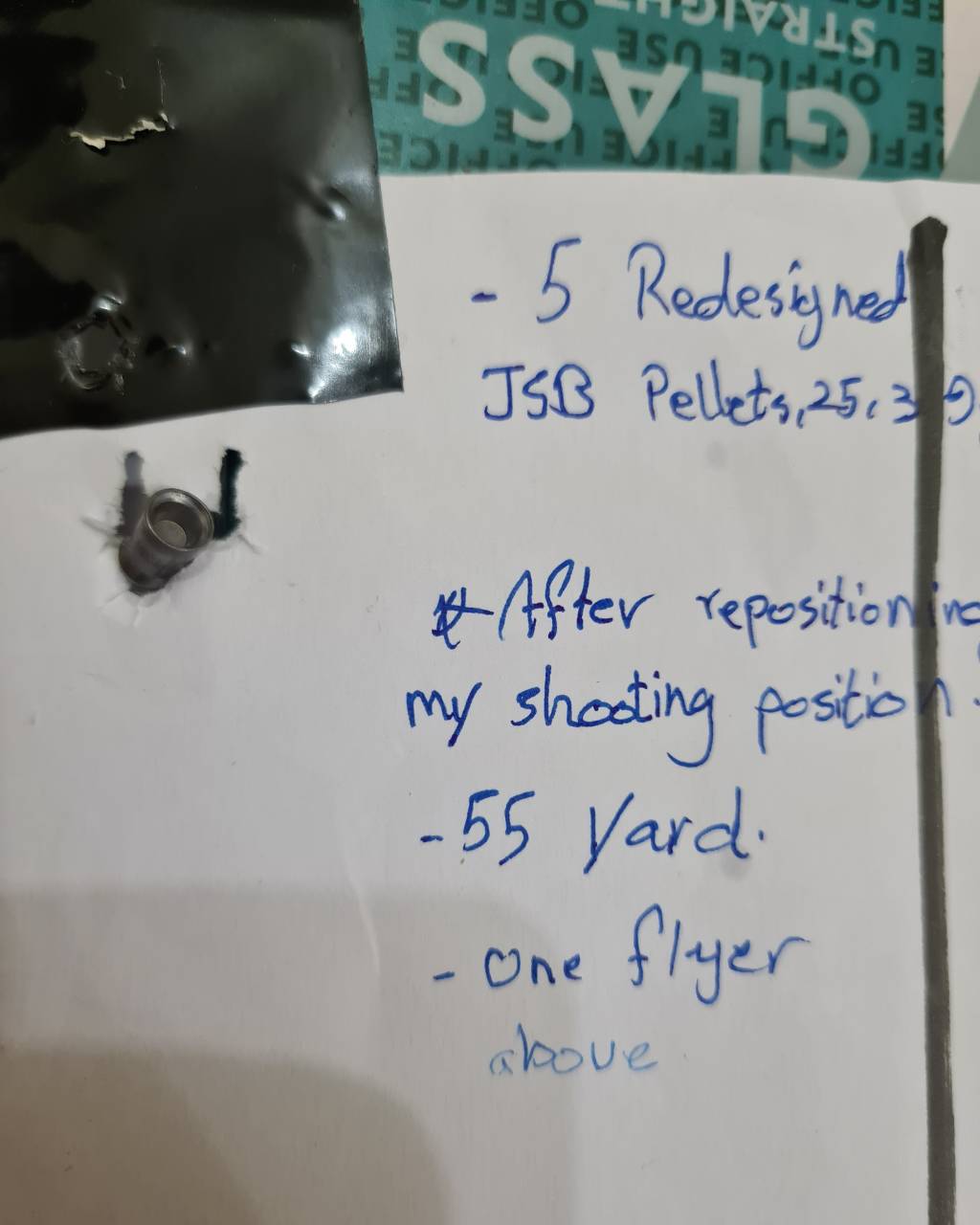

Okay , I have proceeded today to
test the accuracy of the Prophet Performance .I re zeroed my cheap scope and then things started seriously .I made one group , while I was feeling uncomfortable,it was fine though ,but I realised I was not giving this nice airgun its due.I repositioned my shooting position ,and I easily made the 5-redesigned- pellet group ,one flyer or mistake was above the group ,in fact lam not sure if it was a flyer ! The size of the group is the exact size of the Redesigned Jumpo Monster Pellet.All from 55 yard. Not 50.

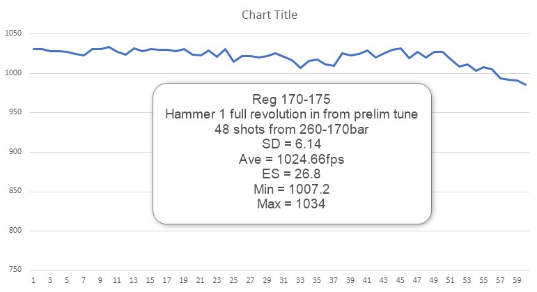

I finally had some time for another go at it late tonight after work.
The goal--->greater consistency (as indicated by a smaller extreme spread)
The general plan was to use RTI's suggestions (per Robert) for settings for the JSB 25.4gr MRDs. That meant a reg pressure of 170-180. So, first order of business, increase the reg from 160-170 bar. Easy enough, about 1/8th of a full revolution (clockwise) with a 5mm allen in the reg adjustment. I also gave it one full revolution on the hammer tension (6mm allen key), as a complete shot in the dark, why-not starting point.
60 shots/5 mags with above settings
Hey now! those numbers look much better (above) than what I had a few days ago. BUT, I was curious if I could come down on the hammer tension a bit, hoping for easier cocking and greater air conservation. So I did just that (same reg pressure as above but 180 degrees/0.5 full revolutions LESS hammer tension). Here is how that looked:

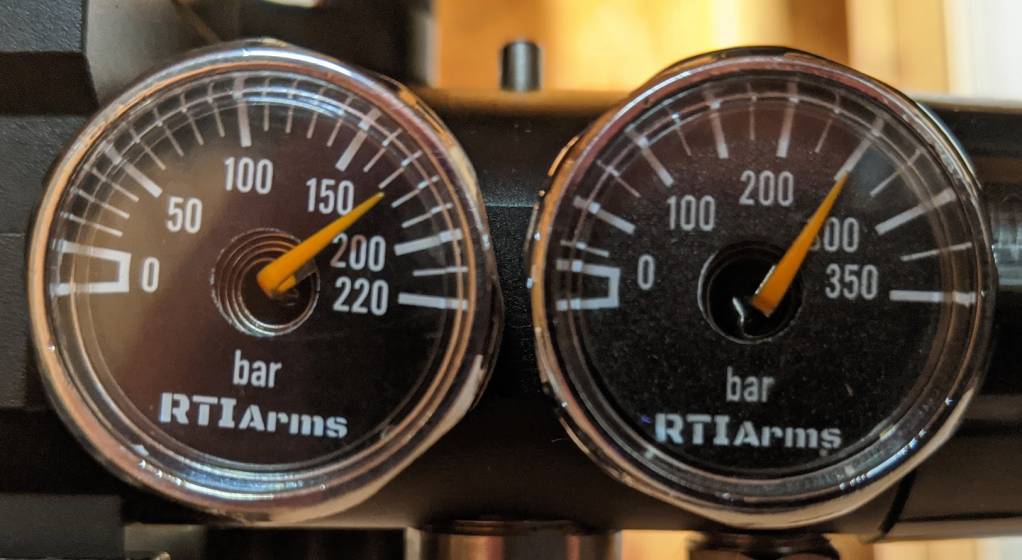

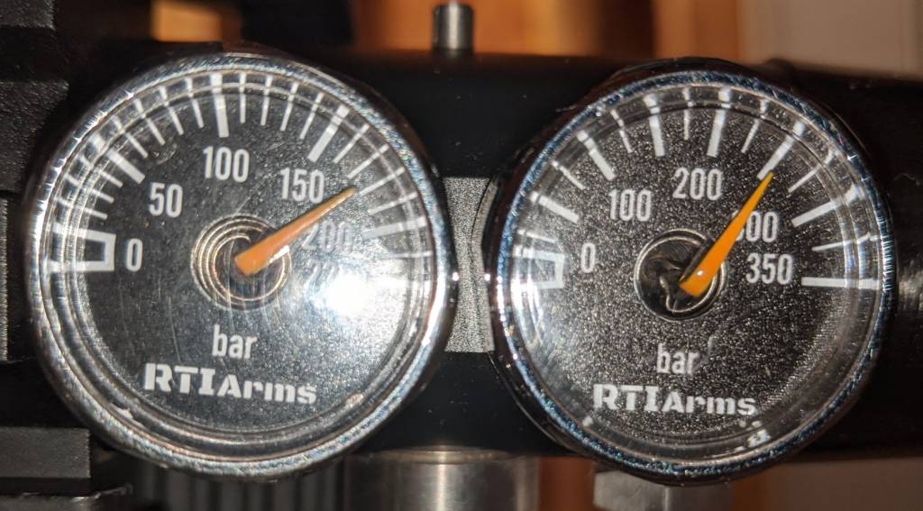

And a look at the gauges at the beginning of the above string:

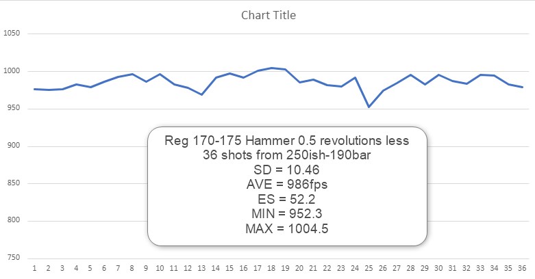

That ES is not so great again, SD is also higher.......hmmmmm did I get lucky with my previous settings or were those parameters truly a good place for a consistent string?

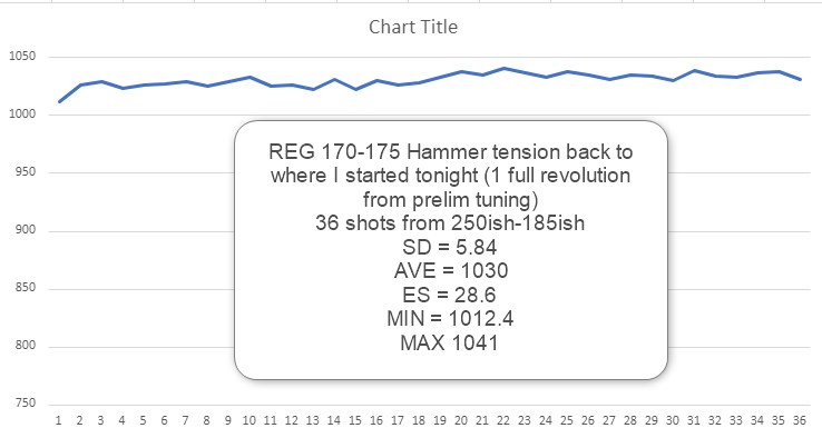

Back to the original settings from this evening (same reg pressure but hammer tension back in 1/2 turn to be 1 full revolution from where I had it when the reg was set at 160 bar.
Another 3 mags over the chrono with duplicate settings from the first string from tonight's testing. This was mostly a test to see if the consistency could be replicated.
This is how that looked:
Gauges at beginning of third string:
Dang, very similar numbers to the first string. It seems like the gun wants to live in this area, at least at this high of a reg pressure.

We're talking about 1025-1030 fps on the first and third (identical) tunes, and about 985 for the second tune. That's right under 60fpe, and right under 55 fpe, respectively.
From 250bar down to reg pressure of 170ish, it'll get 48 shots (4 magazines). The gun is a 300bar rated pcp, so, shot count is going to increase as a guy gets closer to that max fill of 300bar. My tanks are needing a top off so testing tonight was with fills starting at 250. For folks that are relying on a commercial location to fill their tanks, these 250bar and down fills are actually probably a lot more realistic than false hopes and dreams of filling it to 300bar on a regular basis.
The gun's firing characteristics are so much more crisp with tonight's higher reg pressure and hammer tension than it was with the 160bar tune. And there was a noticeable difference between the tune with the lower hammer tension ("1/2 rev") tonight than the tune I'm calling "1 full revolution." Everything felt more balanced with the tune putting out the better numbers, 1st and 3rd strings above (maybe placebo effect, but I noticed it before I crunched the numbers too).

The reg gauge isn't just PINNED on the exact reg pressure. You can see it's a bit over 170 in one of the above pics, and maybe closer to 176 or so in the other pic. So, it moves around a bit. Frankly I don't care what the gauge says so much as I care that it's spitting pellets out consistently enough to hit what I'm after, and it seems like the consistency is there now.

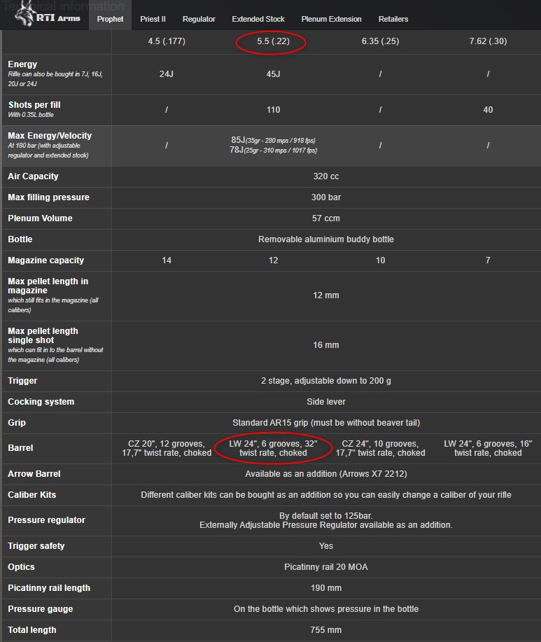

I also had to shine a light in there out of curiosity of RTIs specs listing a 6 groove LW barrel. As suspected, it sure looks like a poly profile to me, which agrees with the 6 land and groove LW since that's how my LW poly on my field target gun is configured. I was originally thinking that a 6 land and groove traditional rifling LW would indeed be an odd beast. Turns out though, that it's a poly with a slow twist rate so more in line with what I've generally seen with Lothar barrels.
Hard to see the rifling here but looking at the dark edge of the bore it's got that gently dented in circle effect that poly's have (vs a harsh, clearly defined circle within a circle appearance of a 12 land and groove traditionally rifled barrel.
This is all promising news for 100 yard accuracy. The Daystate Red Wolf HPs have poly barrels and they've lately been at the top of the heap for the EBR challenge paper game going on over in the benchrest section of AGN.
Tbh,I thought that this pcp has got a 12 grooved barrel which contributes to accuracy,but it turns out the opposite,the fewer the grooves,the more accurate the airgun !?

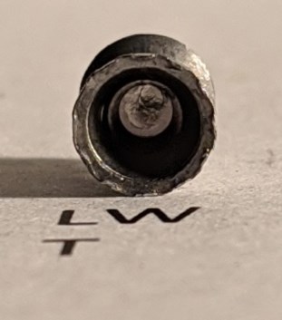

I double-checked the specs on RTIs website to make sure I hadn't invented something. Found this:
As for your other question about fewer grooves being more accurate....no, I'm not going to make that claim. Completely my opinion here, but I feel like every particular barrel is a very unique entity, with a preference or distaste for certain projectile at specific speeds/distances/wind conditions/etc. This Prophet I've been testing/reviewing appears to have a Lothar polygonal rifled barrel. Poly barrels are much more gently rifled than traditional 12 land and groove rifling. The rifling in a poly is so shallow that it is almost hard to discern where the lands and grooves start and stop. Polys are also much more gentle on the pellets than a traditional 12 land and groove.

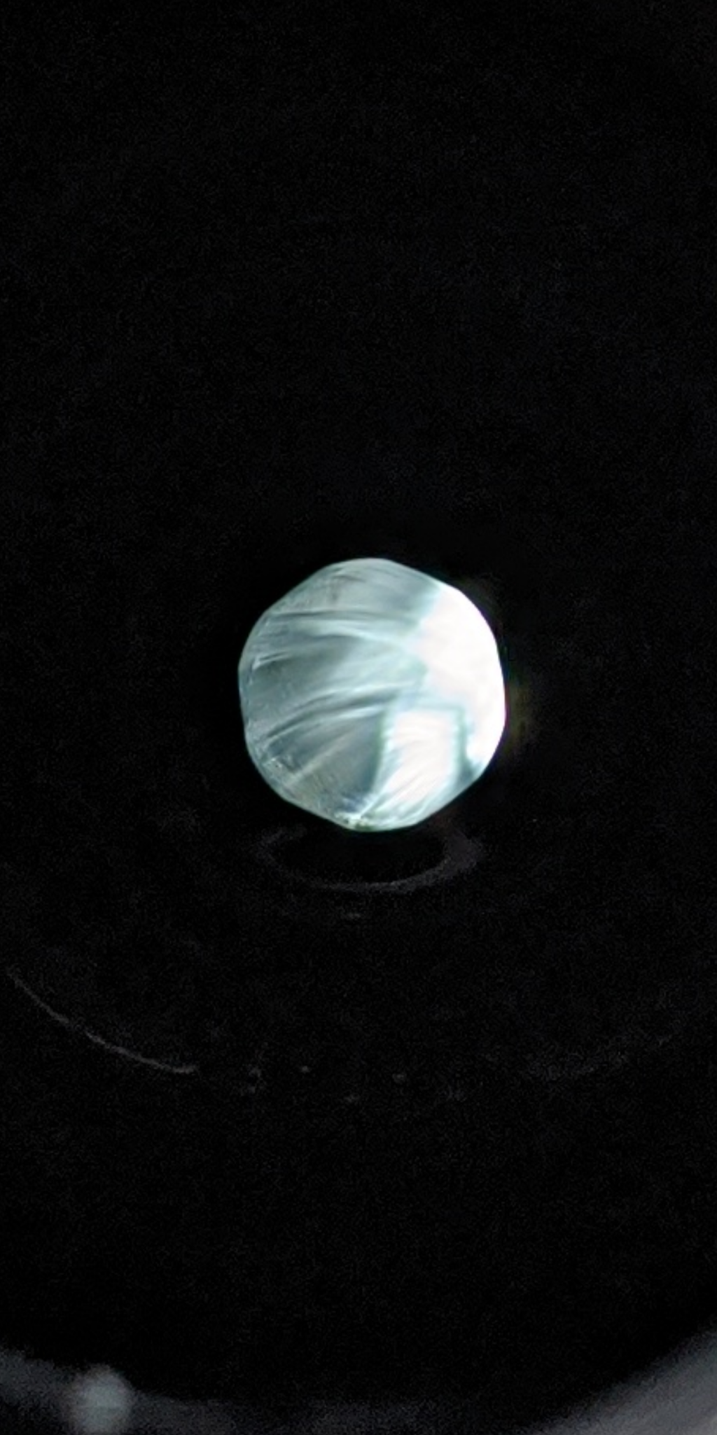

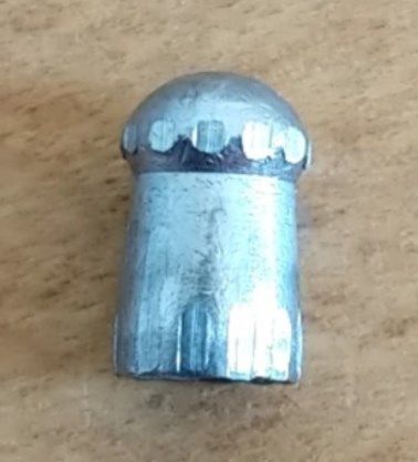

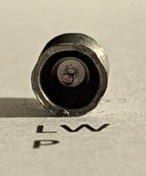

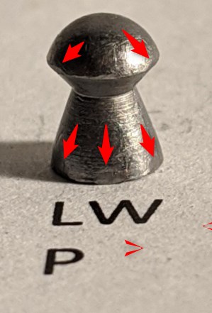

Here are some pics I took and included in a past review for a different gun. Just for illustration purposes here and THESE ARE NOT FROM THE PROPHET.
This pellet (below) was pushed through a .177 poly barrel. I added arrows to help readers see the imprint made by the "lands."
This pellet (below) was pushed through a .177 traditional 12 land and groove LW barrel.
The side profile of the above 12 land and groove is no the greatest illustration because the head size of that particular pellet was pretty small compared to the rifling/choke size.

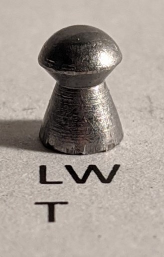

Here (below) is a better side profile of a pellet pushed through a LW 12 land and groove, .22 this time.
The general idea I'm trying to show with the above pics is that there are fewer sharp edges and angles cut into a pellet from a poly barrel than from a 12 land and groove. For some reason this concept always make me think of the "fins" on a propeller. The larger and more aggressive the "fins" are, the more that propeller is going to interact with the water, pushing against it, displacing it, and overall making it's presence known. Basically DISRUPTION.
So, extrapolation of those concepts to a pellet flying through the air........(again my opinion here) logically, the "smoother" projectile, in this case, the one shot from a poly rifled barrel, should be able to make it to it's intended target without being influenced as much as the "rougher" sharp-edged projectile fired from a 12 land and groove.

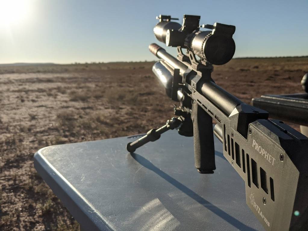

102 Yards, and Some Pesting, and Review Conclusion

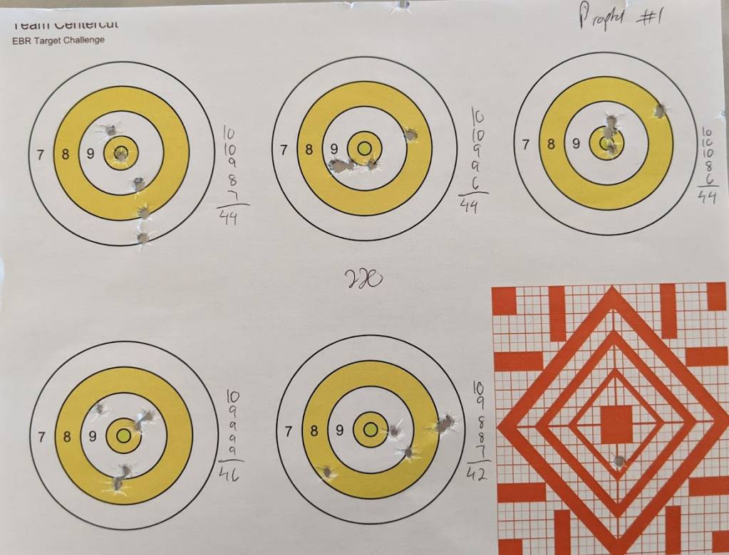

I had a chance to get out for some long range testing with the Prophet a couple days ago. I was set up and shooting at 7am.
Conditions
Clear sky, winds started about 3-5mph from about 4:30-5:00 with occasional shifts to make it coming in from 9:00 but about the same speeds for the first card, which was also the highest score. Winds increased to 8-10 and continued to shift back and forth from about 5:00 to 9:00. No wind flags. Pellets straight from tin. Freshly cleaned barrel. Temp started around 75 but warmed up to about 85 by the time I was done shooting. Bipod and plastic table, left hand under rear of gun.

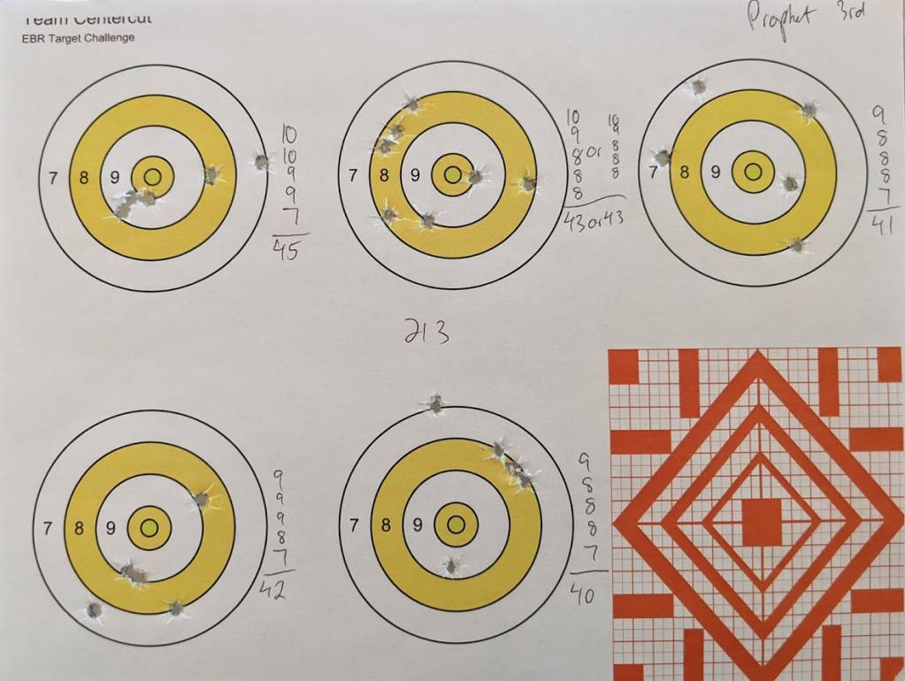

Some of the guys shoot a ton of sighters when shooting these EBR challenge papers. That's not me. Once I start a page I usually shoot all 25 shots, without taking any more sighters. And I typically crank them off pretty quickly. Low patience level individual I suppose.
Shooting the JSB Monster Redesigned 25.4gr at the 1025-1030fps (59-60fpe) arrived at during the last tuning session.
Used Centercut's EBR challenge target (head on over to the benchrest section if interested, quite the lively discussion has ensued over the past few months around this target and shooting pellets for groups at 100 yards).
Results

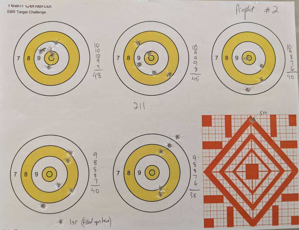

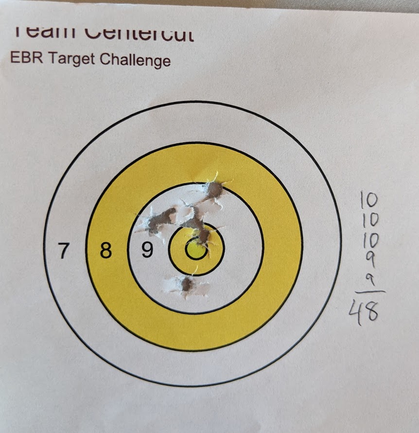

The best 5 shot group: (might be a 47, ripped paper kinda hard to see exact pellet impact point-47 or 48 on the score but group measures 0.952 with calipers so sub-MOA)
The best overall card (also the first one that I shot, before the wind kicked up):
The three other cards, when the wind was more difficult:
Thoughts:
On the third card I forgot to refill so had a low hitting pellet on the 5th shot on the third bull and 1st shot on the 4th bull, so I took another (6 total) shots on that 4th bull, after I filled up the gun.
These are all the cards shot from the gun at paper this morning. There were about 10 more shots, not shown here that I used to get the scope zeroed for this distance, other than those zeroing shots, you're seeing everything the gun shot (at paper) at the 102 yards this morning.
Oh, there was one other shot while sitting there, at a COYOTE!!!! Yeah, unbelievable. I was sitting there scoring one of the groups, having just walked back after collecting it, and caught some movement out of the corner of my eye. There was a half-grown pup about 70 yards out, directly in between me and the targets. I'm not sure which of us was more surprised, but of course we both scrambled, me to get a couple pellets in a mag, and him to get the heck outa dodge. By the time I was ready to shoot he was out around 130 (guessing?) yards. I whistled and he stopped and turned broadside like lots of critters will do. I had no idea on dope, or windage, or even how far he really was, but I knew if I connected that 60fpe pellet had enough to do him in, since he was a juvenile. BUT, alas, it was not to be, pellet hit the dirt about 6 feet short, dust flying. He found another couple of gears after that little scare, and was gone for good.
Back to the paper.....
That first card I shot, the 220 has two sixes, one for the second bull (barely hitting paper, at the top edge) and one for the third bull (also barely hitting paper, right edge). Man, if it wasn't for those two crappy shots, that card would have been in the high 220s.
I measured all 20, 5 shot groups and the average group size was 1.73 inches. Remember, this was my first time shooting this gun at distance. The pellets were not sorted, the winds weren't kind, and I had no wind flag to tell me what they were doing. Overall I was impressed with how it shot, considering the conditions.
The gun is simply built for power. It does not have as much pulse/recoil as other small caliber/big fpe airguns. I think there is a lot of potential here for somebody to extract much more impressive accuracy than these results suggest. Getting to know the barrel's preferred cleaning regimen, perhaps finding a batch it likes better, and maybe even playing with the tune some more to find the most accurate speed for this pellet from this barrel, would all likely improve the results. I'm surprised the pellets shot as well as they did. Conventional wisdom all over the forums says pellets don't shoot accurately that fast, but these didn't do too bad. The gun is certainly capable of absolutely LAUNCHING them, and fairly accurately
